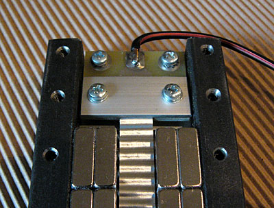

Hello Promitheus,
have done some experimental work with metalized foils from an capacitor but that wasn't too promising: you can't corrugate very thin plastic films, so you have to stretch it and probably get a higher resonance frequency of the ribbon. Afaik traditional ribbons are made of 8 - 11 µm alu.

Standard household alu foil seem to be between 10 and 15 µm thick (this is not the extra-strong variety but the cheapest you can get). So my self made ribbon should hopefully be only slightly heavier (and shurely a bit more strengthy) than a professional one.

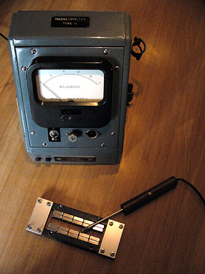

Hello again,
from a friend I borrowed a gaussmeter which measures the strength of magnetic fields with a probe small enough to be positioned in the gap of my ribbon speakers. Here are my findings: Fortunately the field is
a) highly concentrated in the gap
b) linear across the length of the gap; linear part begins after half of first magnet block (some 10 mm) so that total homogeneous field ist just one neodym block shorter than magnet row (9 out of 10)
c) as far as the old gauge is correct field is strong at some 0,5 Tesla (5000 Gauss) in the middle of a 12 mm wide gap between double rows of magnets - see foto.
By the way: I also tested if the field is influenced by the addition of iron pieces across the ends of the frame to close the magnetic flux in the rear of the ribbon. Varnhagen seems to be right in his finding that this doesn't make much of a difference in efficiency - I could hardly see a deflection of the meter pin.
Usually you'll find very thin foil at manufactures of high end audio capacitors. But we warned: thin foil is very difficult to handle! My speaker function well with normal household foil (some 12 thru 15 my).
