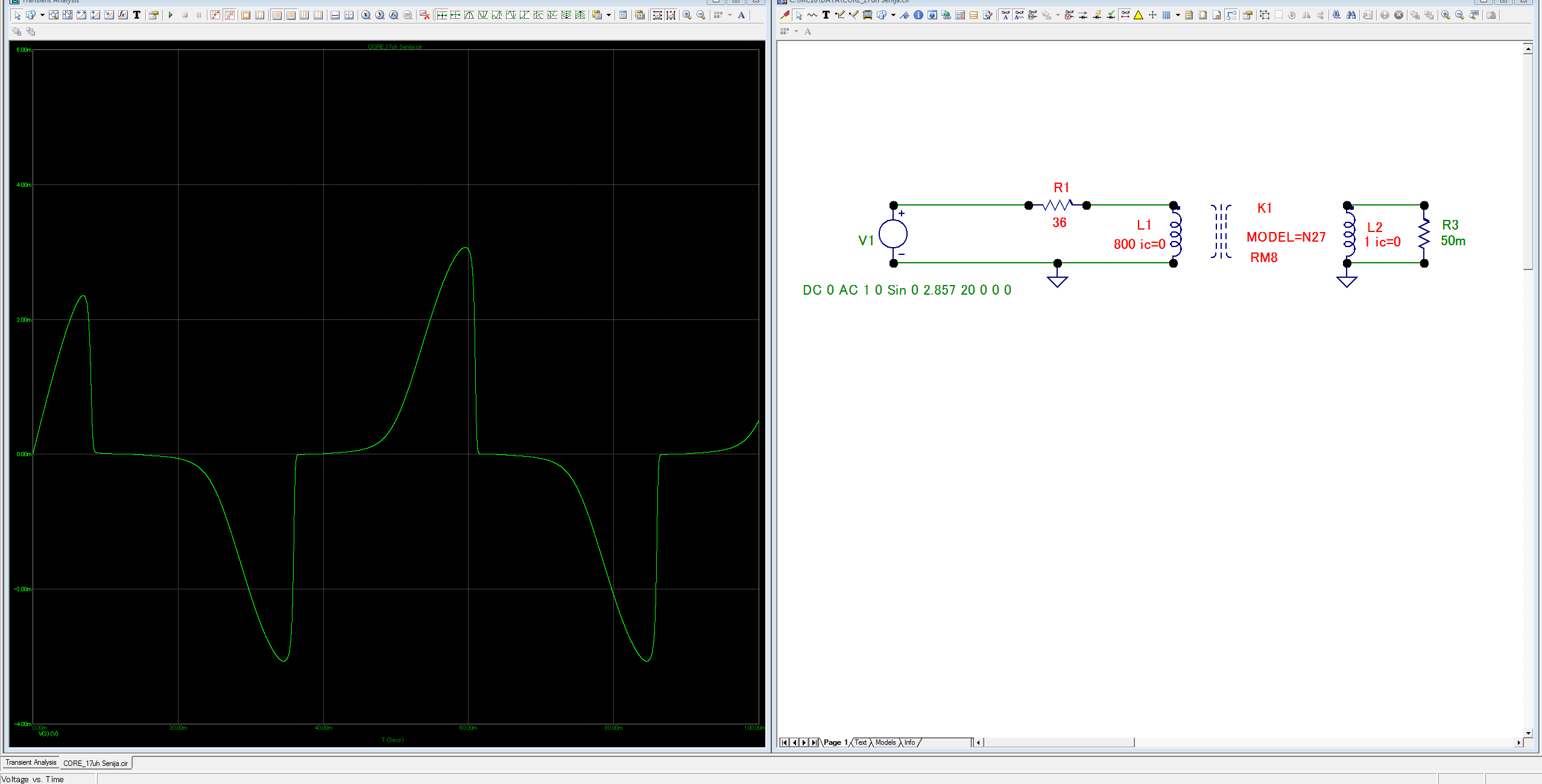

Could you so kind to give me more information on the transofrmer? How many turn in the primary? Have you use some formula ?
My transformer is wound on a ferrite ring core measuring 20 * 12 * 6. It has a primary winding of 800 turns of wire 0.12. The winding is wound with sectioning, it has 8 sections of 100 turns. The DC resistance is 32 ohms. The secondary winding is wound with a stranded wire consisting of many thin wires to obtain a cross section of about 2 square millimeters. It is possible to use a wire as on the primary winding, all wiring is soldered together at the ends. The secondary winding has 8 turns.
The trafo isn't necessary to feed near-zero ohm driver. And actually, when I tried a ribbon mic in the reversal manner(without trafo) it worked surprisingly well as a tweeter. Only as a tweeter, because its small membrane area and I see no way to make it sealed as well(I mean front chamber has to be sealed from rear one, as a planar and static types of headphones does) so you'll never get a deep bass with it. However, I see no one pictures of this thread and can not be 100% sure if I'm right.
PS: I've simulated ferrite ring trafo 20x12x6mm 800/1 (24m of .12mm wire) with an ideal winding coupling(real one <1 will make things even worse), and found that such trafo isn't able to work with a moderate input voltage 2VRMS and frequencies <50Hz. See attached 20Hz is very distorted. In fact, ferrite is the worst core material for such application, the best one probably nanocrystalline or, as I said above, direct drive without any trafo.

You strongly mistaken when you say that the bass is not, the shooting was conducted by a cheap camera, the microphone on which side, these drivers have a sharp focus, and their application implies the proximity of the membrane to the ear, and besides there is no ambushshur. The transformer can be improved by using heartwrappers with a higher magnetic permeability. I also know that an amplifier capable of operating at such low load resistance (current output) is possible. And there are no whistles, you did not listen to them live.
