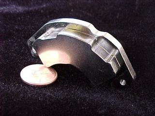

Hi again
Here is a picture of the magnet type.
Peter

Hi again
These are BIG :bigeyes: , but also werry expensive 🙁 . The surplus ones I have considered cost a small fraction of the price of these 😉 . I am thinking of using a lot of them to make somthing like a 150 Cm line source:devilr: . This will take a LOT of magnets so they need to be cheap. Still using cheap surplus Nd magnets will give more power then stardard megnets normally used for making ribbons. I will be making some experiments in the future with these. I will let you know.
Peter Jensen
Yeah, I agree those biggies aren't much use for audio apps.
If you haven't already, do a "neodymium" search of Ebay. I saw what seemed to be pretty good prices there on large lots of small Nd mags.
