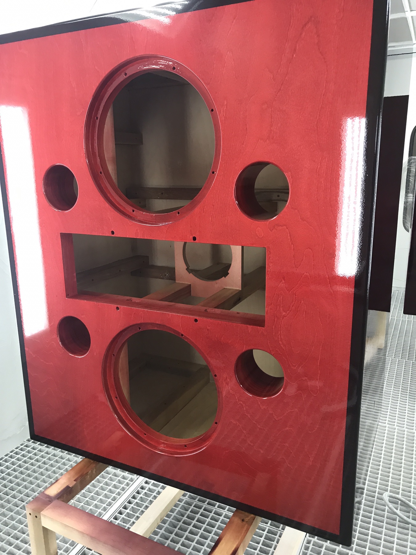

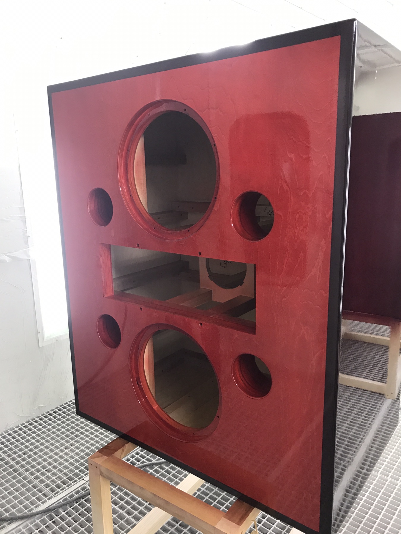

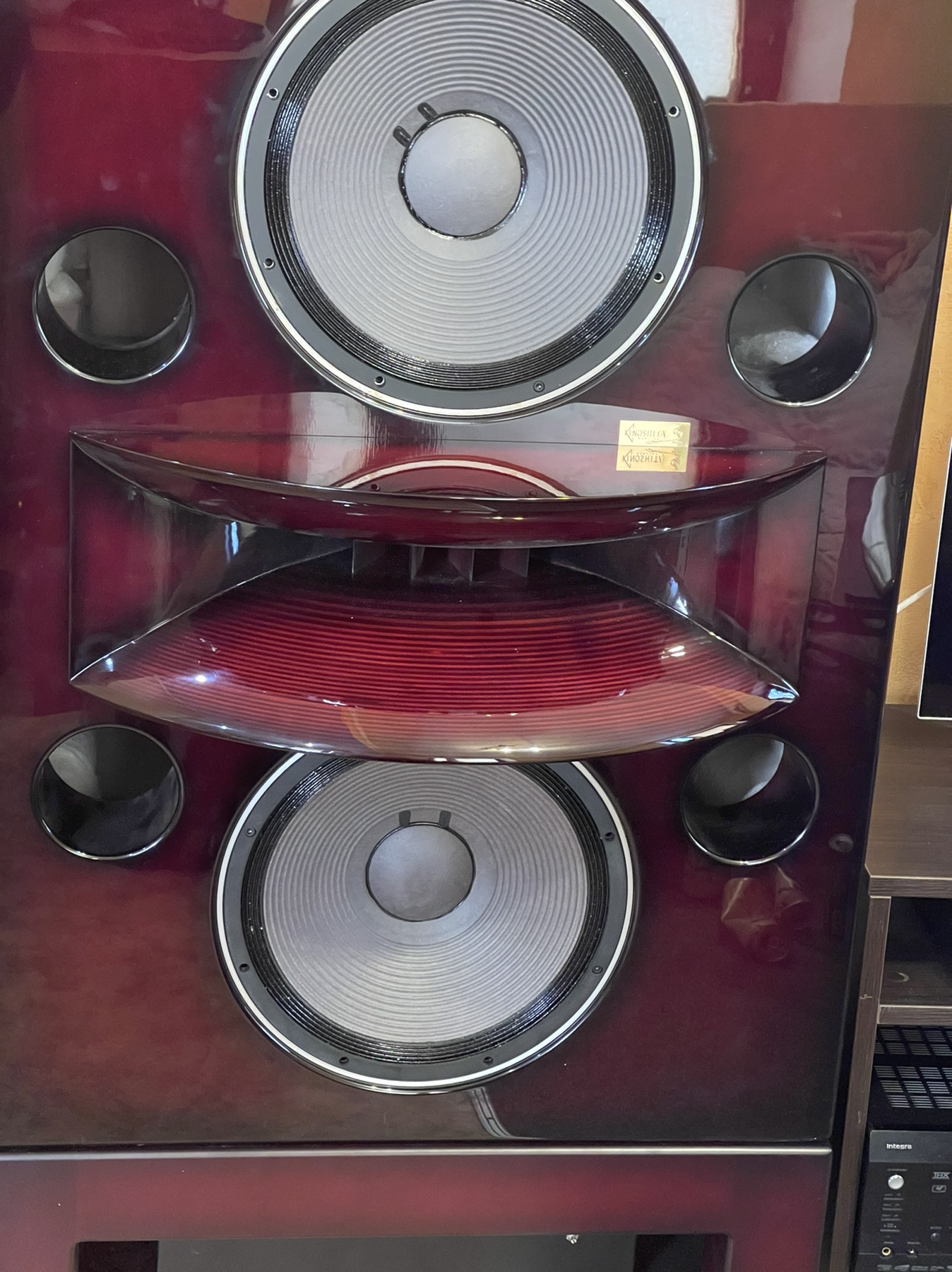

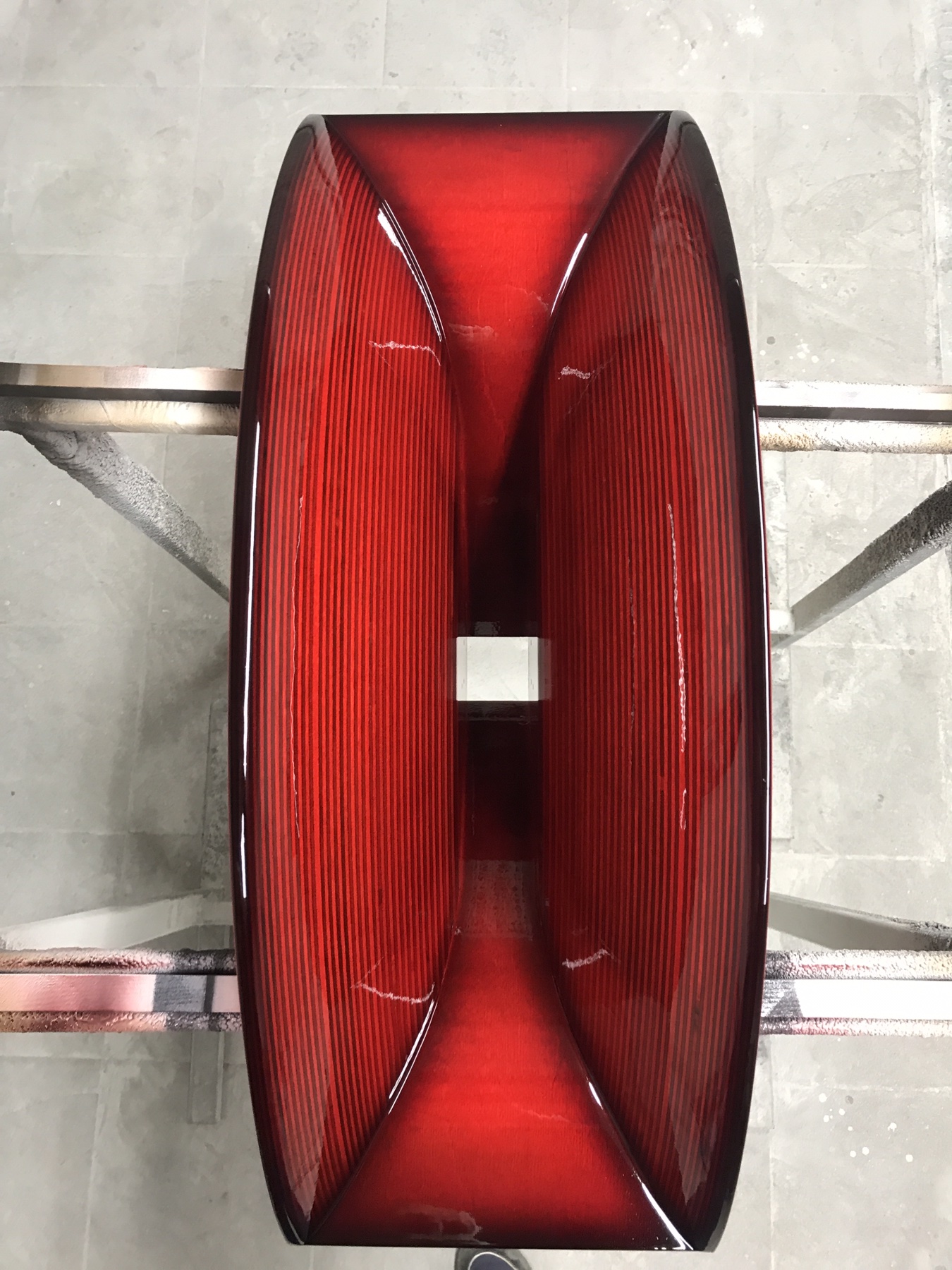

final
color - wine, dark red

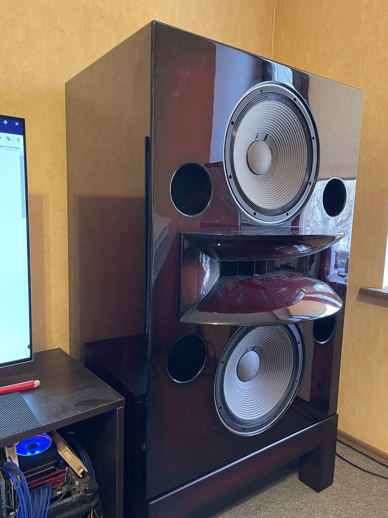

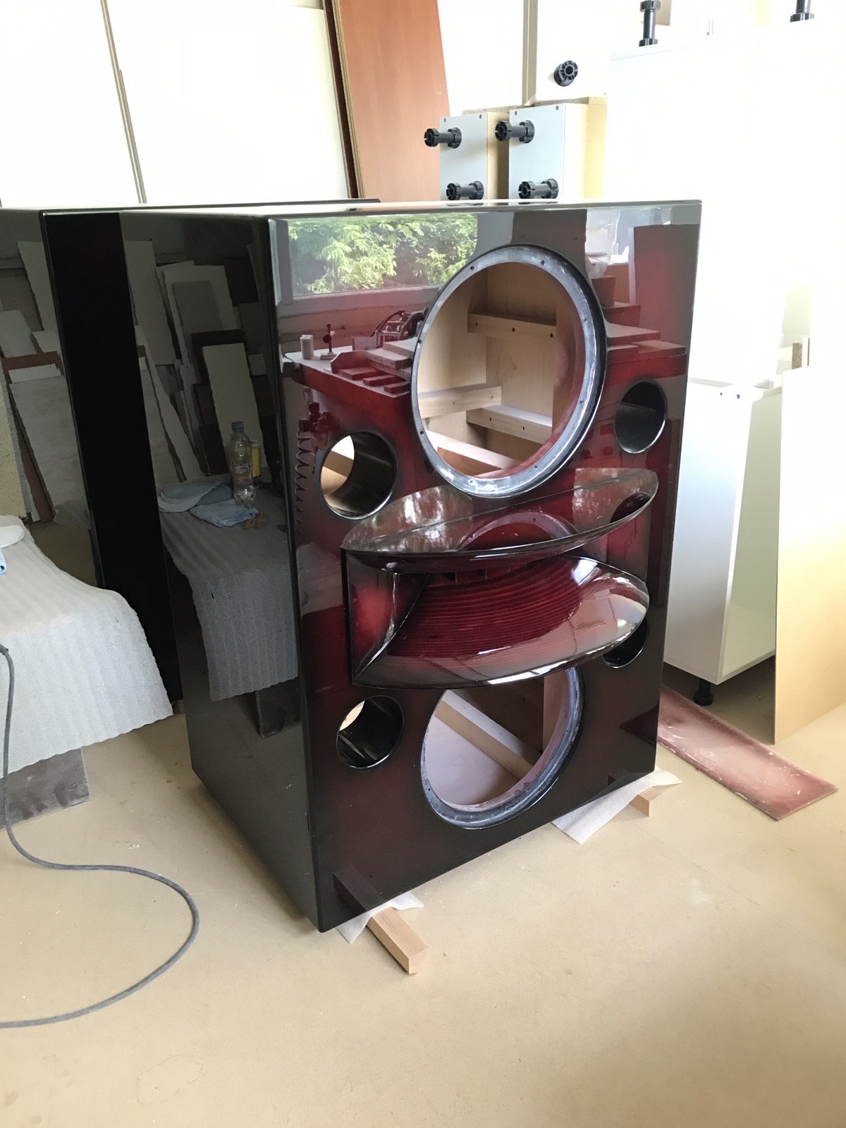

RM-7V Final
Beautiful!

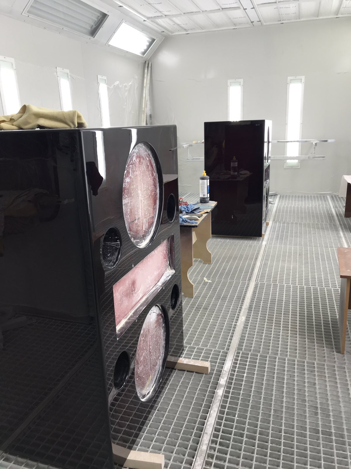

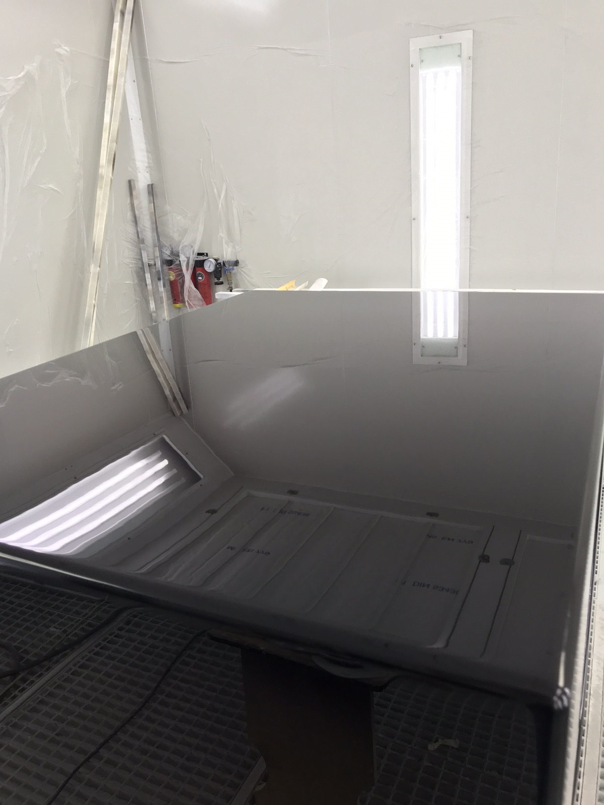

Do you wet sand to achieve your final gloss finish? What grit do you use?

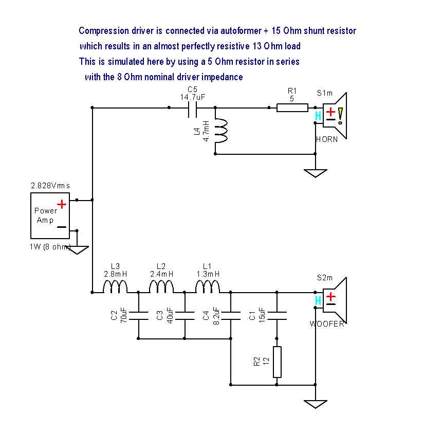

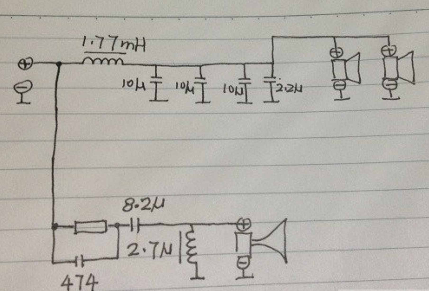

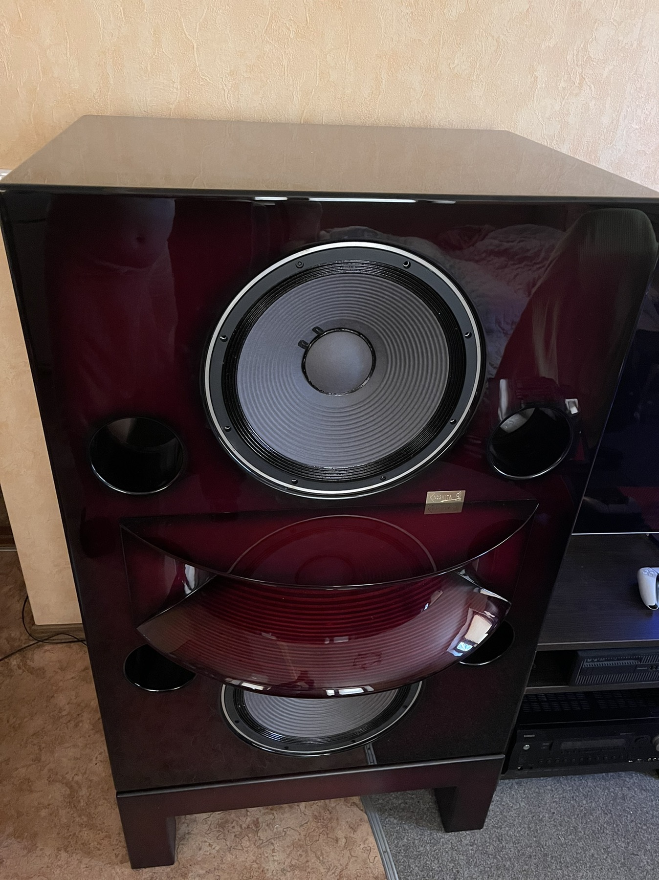

Hi Wacu,Crossover
Do you want to share the crossover schematic for this design.
I have 4 TAD 1601 and 2 TAD 4001.

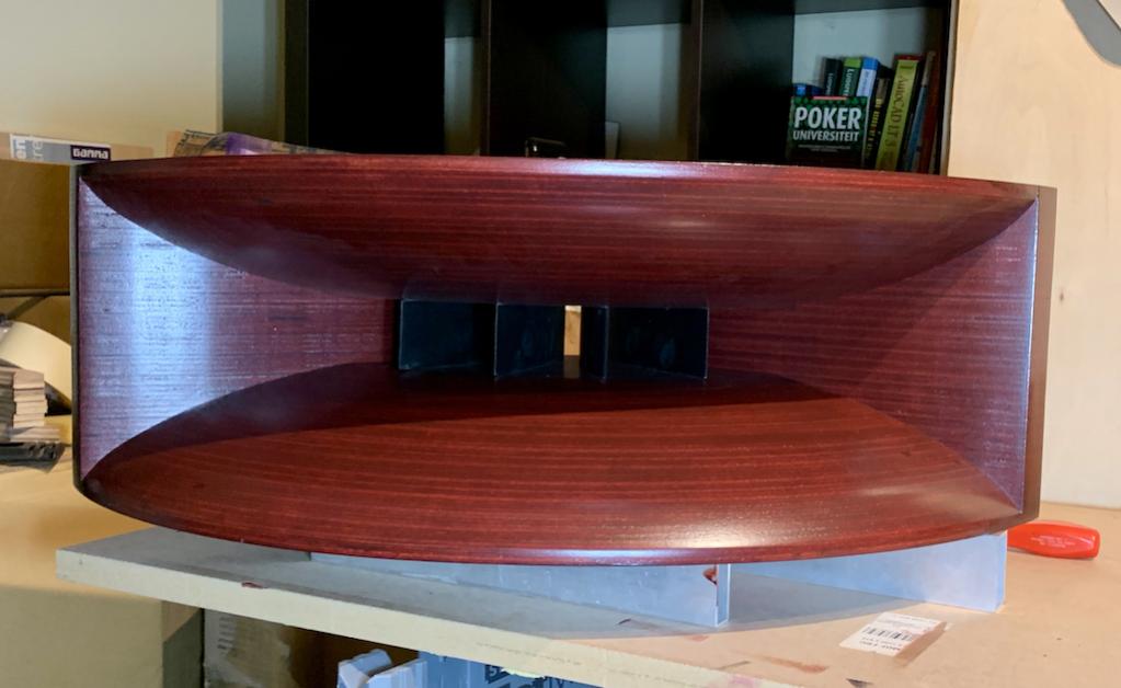

Also made a Yuchi 290 horn.
Don't know what to build but I like the big one like you build.

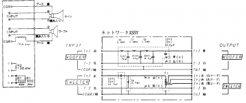

Rob, here's what I've found for TAD crossovers:
Yes I now those schematics but it's for a 2 way with one woofer.
I like to build with 2 woofers.
Rob

This crossover for 4003 models, and not suitable for 4001, as there is no lc chain and peak suppression by 3000HzRob, here's what I've found for TAD crossovers:
Original crossover I can not give, but very well working - pleaseHi Wacu,
