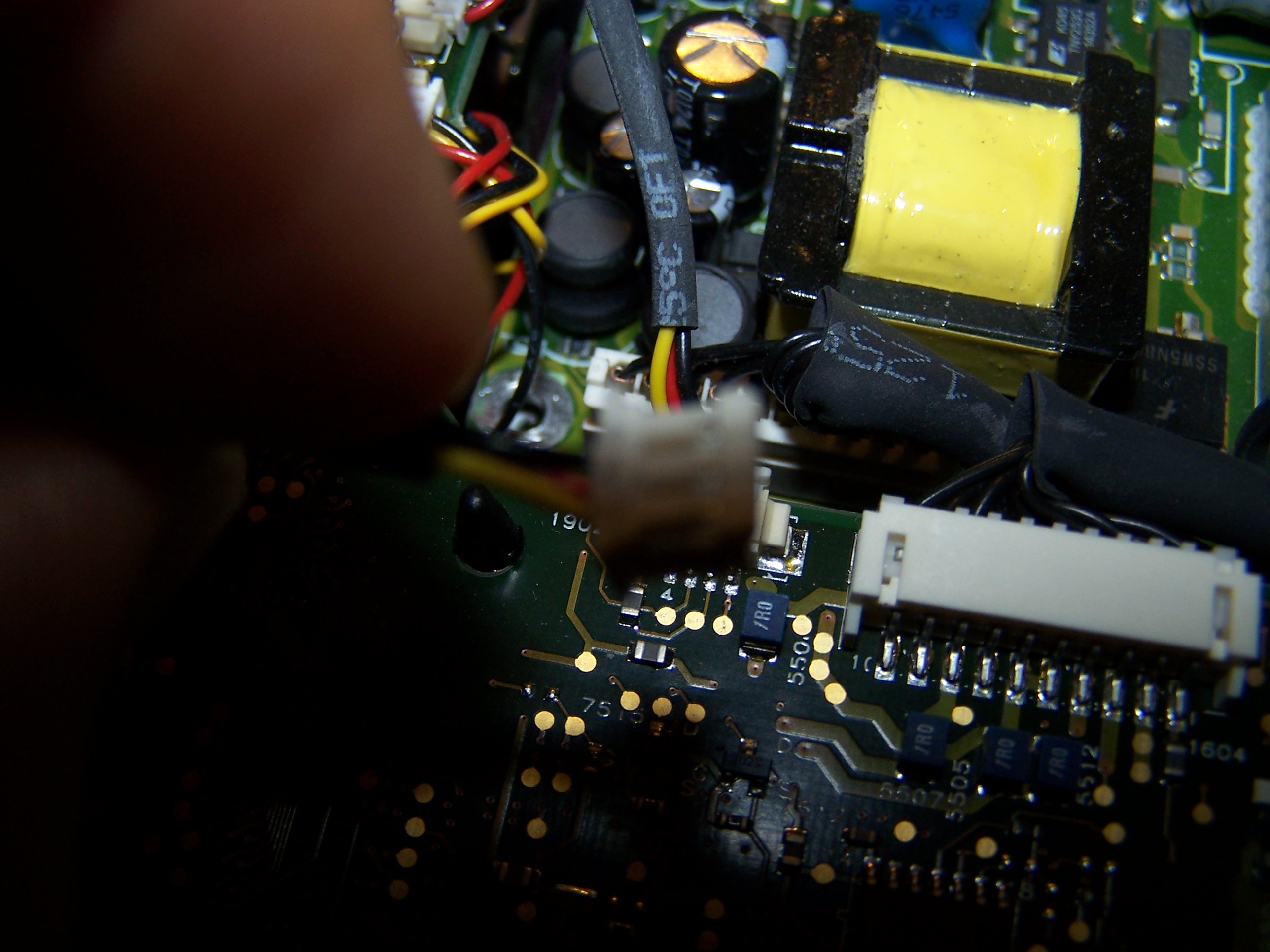

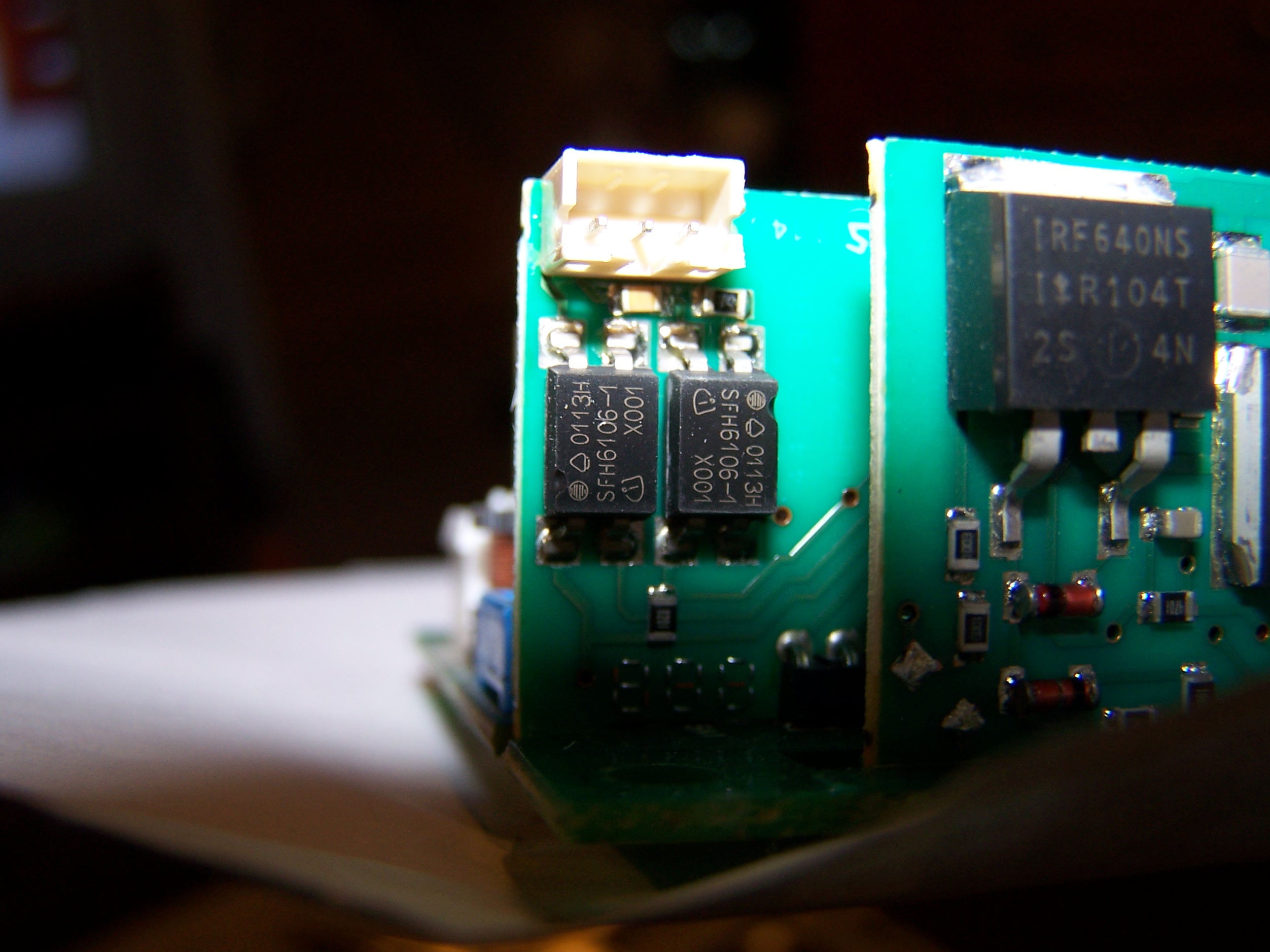

Hello, I am new to the forums. I have just purchased an Infocus LP690 from ebay. I am dealing with similar issues, and have the same 3-wire connector from the igniter board to mainboard. However, I have 3 opto sensors next to this connection.
Tuga notes:
As I said, the igniter and optos are no longer inside my projector so I’ll take a picture when possible.
Based on this, if I figure out what the otpos are doing, and which of the 3 wires are 5v can I remove the entire igniter? If this is correct, what do I do with that 5v line?
Okay so I got impatient and went for it. Probubly not the smartest thing, but it worked. I made a jumper cable and connected the ground and +5v going into the mainboard. Projector came on as expected, now its time to find a suitable lamp.

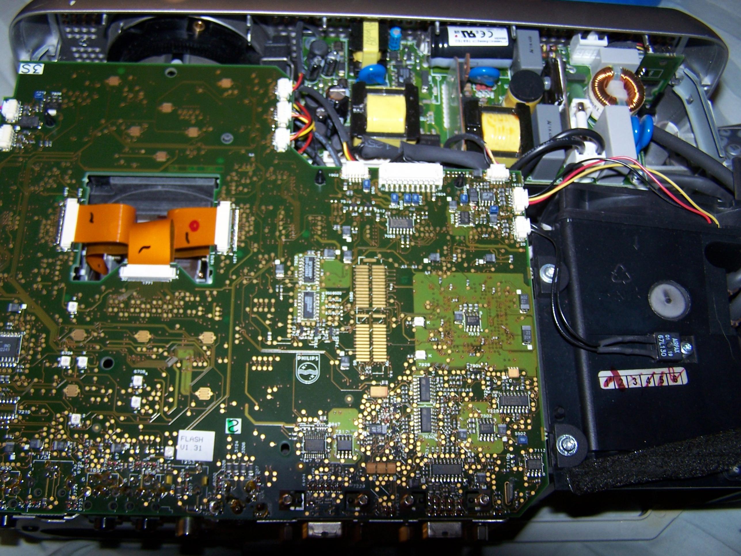

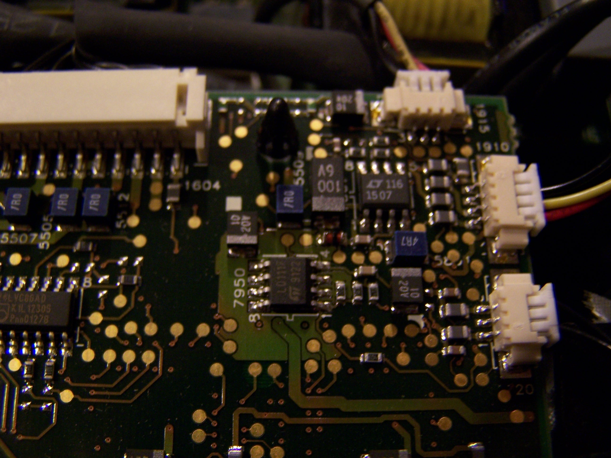

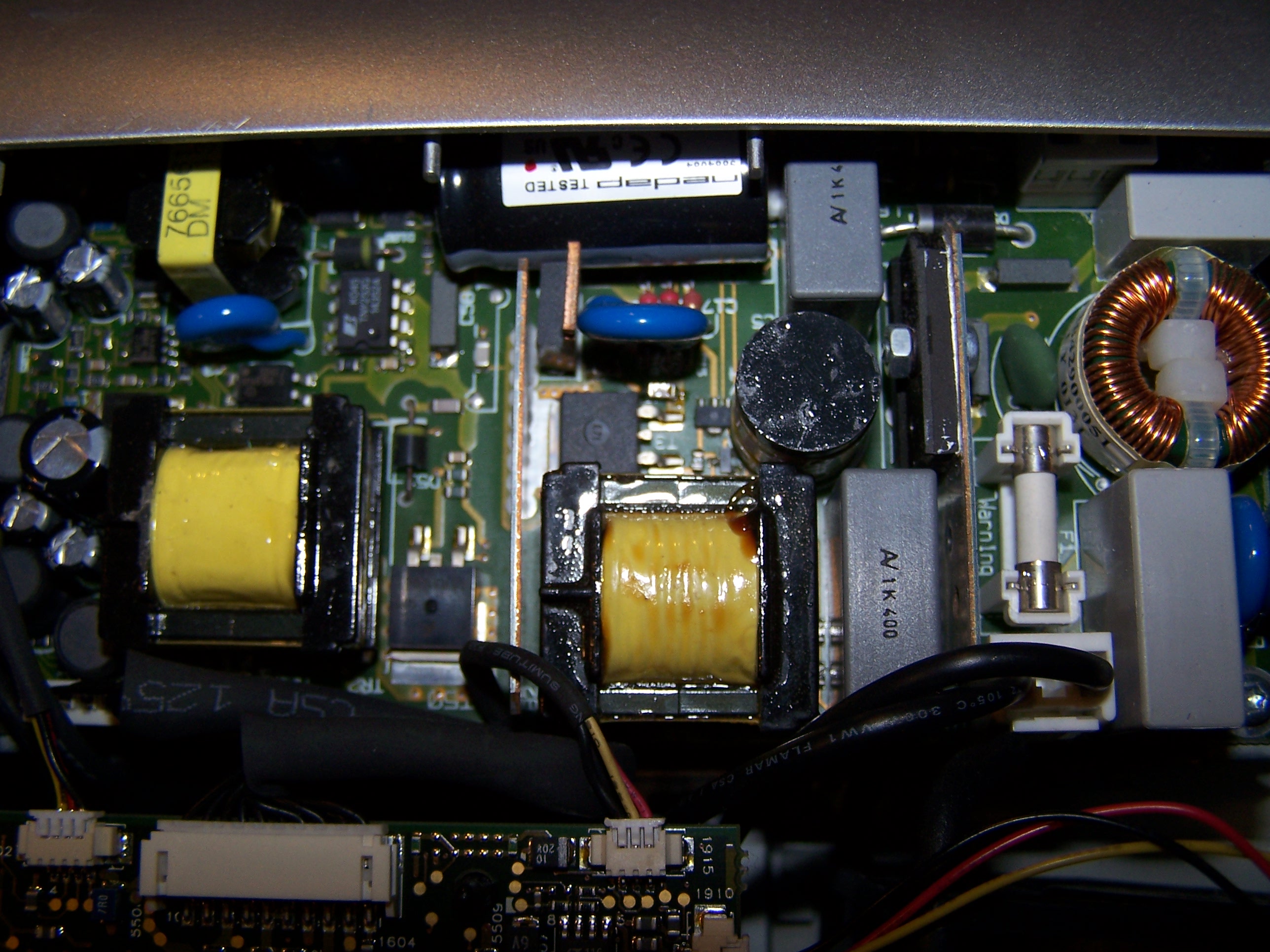

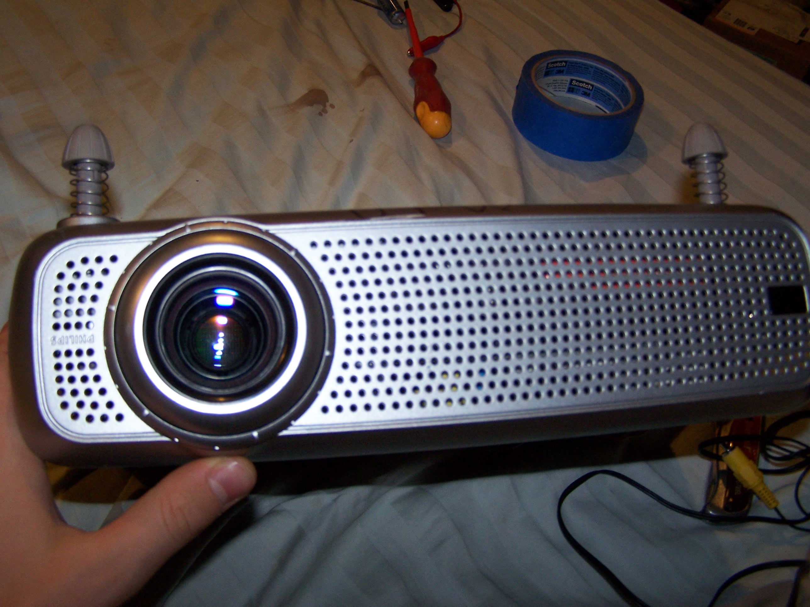

Hey, I bought a Philips LC4431 Projector. I need to bypass the light check, and I need some recommendations for lights and reflectors. I tried a 25w slideshopw light which is barely visable (My projector will show an image until 3 checks then shuts off). Also I got an xenon 80watt 12v automotive light which did better but the reflector I used melted under the heat because it was plastic. I don't have much money and I really want this to work.
To keep the projector on, you need to find he optocouplers and short it. The optocoupler is generally a retangular tiny black component with 4 legs (2 on each side). Some have more than one. Alternatively, look at some of the bypass guides written by CrazyFunGuy.
No, because I bought it without the bulb and reflector. Also I can't seem to find where to short it to get pass the bulb check.[special=]%[/special] Hope these pics give you an idea.

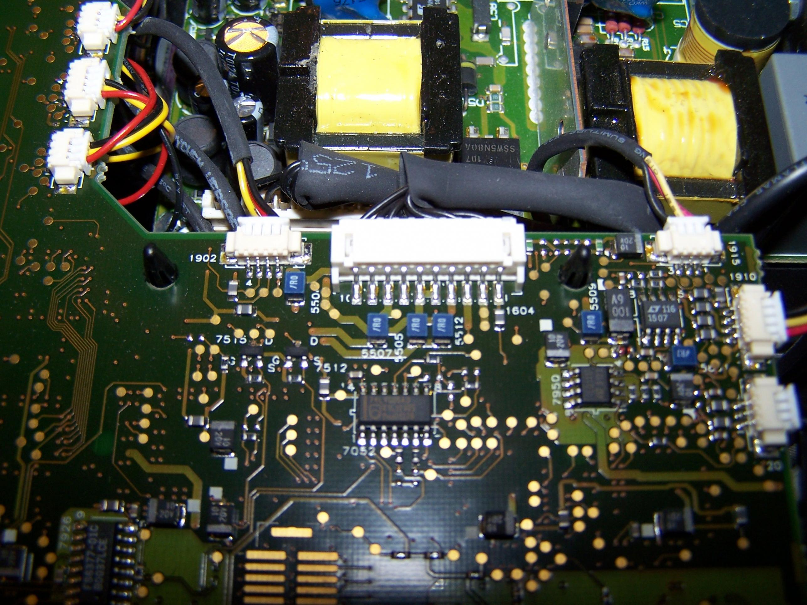

Hey again, I went at it some more and found the basalst and removed it. Found the 3 wires. In my case it seems to me typical to colour. Red 5v, Black ground, and Yellow standby. Now I know I have to short the 5v to ground with a 5v resistor, but what about the standby? Also I heard someone went to home depo and bought a work light and used that with its basalst. Worked great apparantly. I seem set but I thought it would be helpful for you guys.

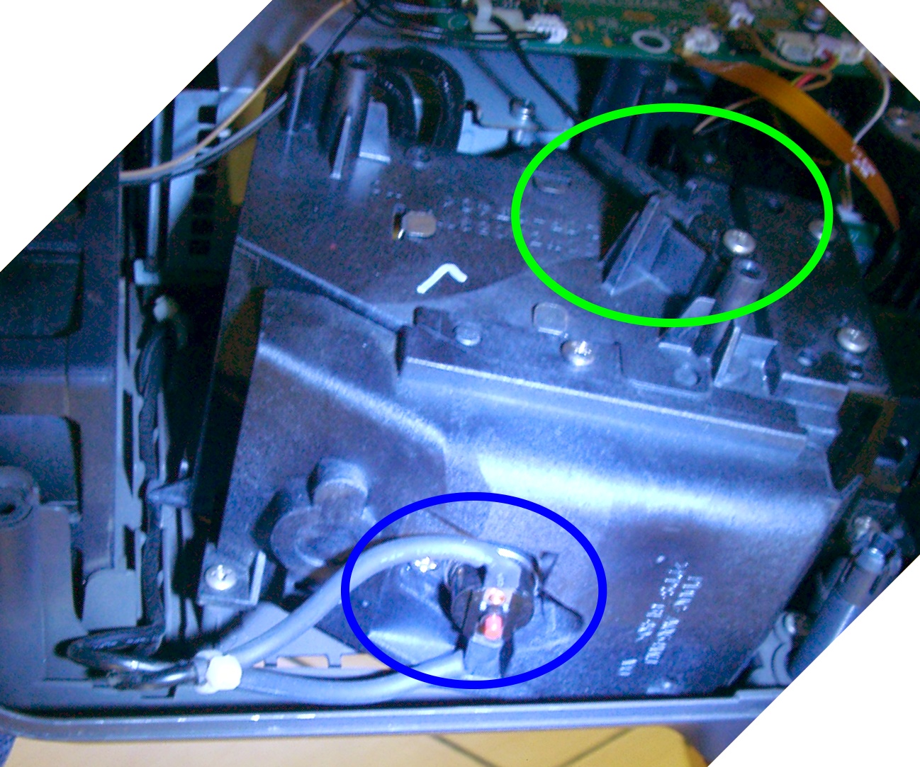

Hi All:
My projector is [SHARP XR-11XC]

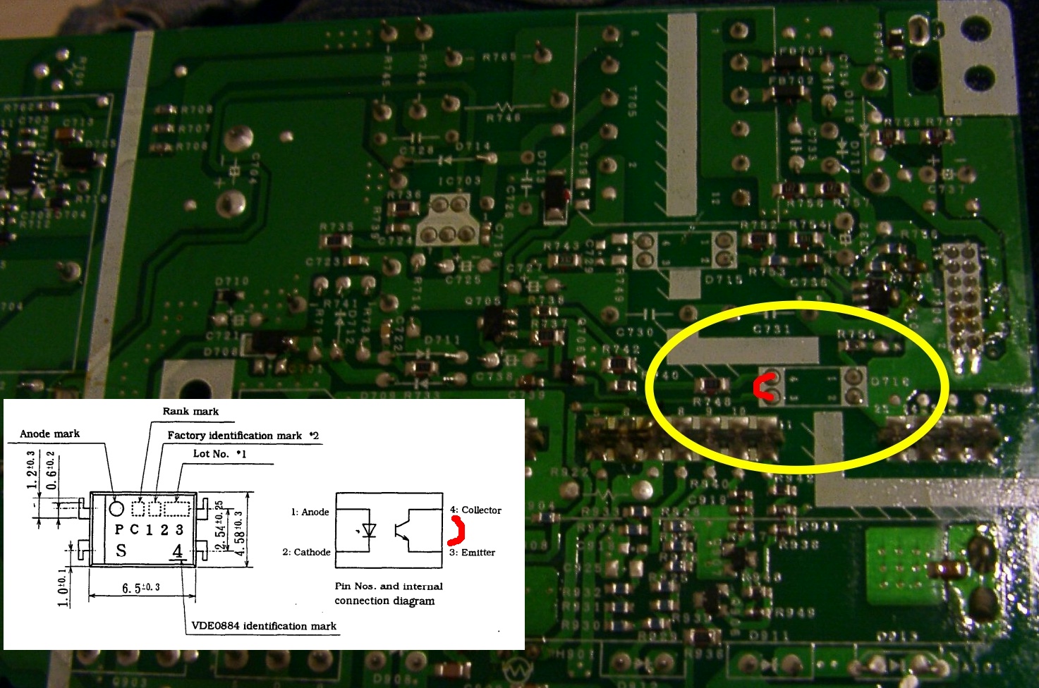

1.
I try to link the Emitter pin and Collector pin together of the PHOTOCOUPLER (I think it's PC123Y) like picture 01.jpg, and it work!! It will not show "LAMP OFF" anymore! But......
It shows "Warming Up, Please Wait...", and after few minutes...it turn off! @.@|||
2.

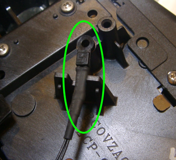

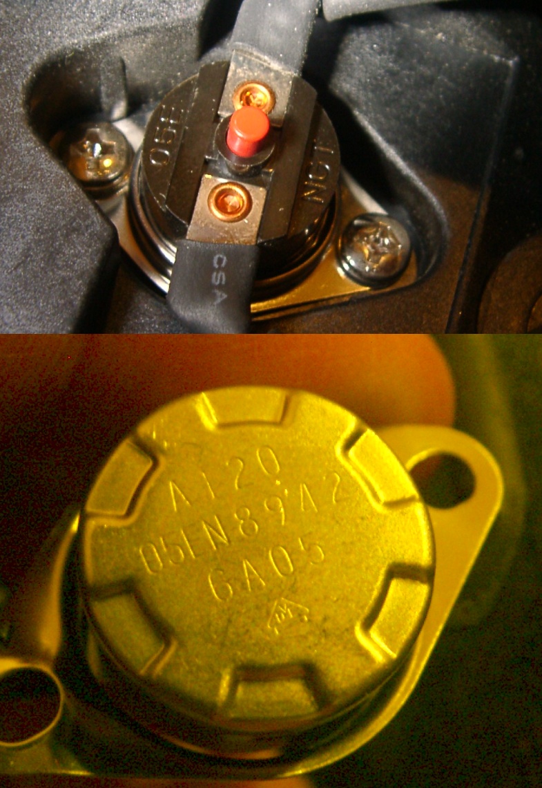

There is two components outside the lamp housing in picture 02.jpg which might relate to "Warming up" sensing I guess.
The close-up pictures are 03.jpg and 04.jpg.
Does anyone knowes how to solve this situation?
PS: I am sorry for the poor english. T.T

Pic 3 seems like a thermistor. If it is then it is likely to be a PTC type where the resistance increases with the temperature. I don't think that the thermistor has anything to do with the projector not staying on after shunting the photocoupler. It is purely temperature related. Pic 04, you may need to take it off and show it in more detail. Somehow I feel you may be shunting the incorrect photocoupler.
Thank You Gizmotech.
You are right! I was wrong!
There is another PHOTOCOUPLER (PC123Y) somewhere else. It setting on a narrow space that i can't take picture. This one is the correct PHOTOCOUPLER! So my problem now is to put a suit lamp in. It's really diffical to find this suit lamp....I'm still searching for the lamp!
