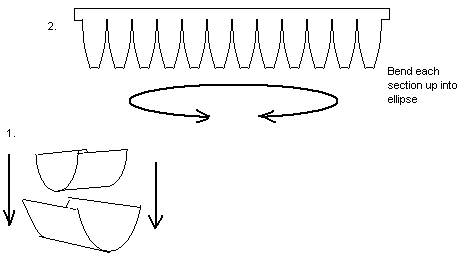

I thought I would start a thread to swap ideas for ellipsoidal (or other) reflector designs or sources.
I've been thinking for a while what I really need in my projector is a stage spot light, a decent one which has an ellipsoidal reflector, and a couple of lenses to produce a really nice almost collimated beam.
These are likely to be pretty expensive, so I thought there may be a cheap way (even if it takes a fair bit of labour) to make a half decent reflector DIY. A good sheet material to use is thin aluminium formed into shape then polished to a highly reflective surface. One idea that has been mentioned before in this forum is using two bits of sheet formed into ellipsoidal shapes, then one cut to fit inside the other. The other idea I have had is to cut radial sections of the ellipse out of sheet material, then bend each little pie slice into an ellipse, then fold the whole lot around so the ends join and form the final reflector shape. Haven't quite figured out how to hold the thing together yet. Hopefully the picture explains what I mean 😕 🙂

Muzzman,
I think it is a very good idea that you started this thread, the reflector is one area that remains a problem for the majority of us out there building projectors.
I've had a look at your idea for a reflector and I sort of get the idea, but not quite. Any chance you could fashion a rough 3D sketch of the #2 design? The sort of image I'm making in my head of that design is a kind of flower shape - a circle of ellipsoidal leaves - am I completely off track here?
I recently fashioned myself a single-plane ellipsoidal reflector out of the type of material you describe, although the finish of material I bought is called 'brilliant' and is mirror-like. This meant I didn't have to spend hours polishing the surface, but on the flipside, the 2'X4' sheet I bought was four times the price of the equivalent non-mirrored aluminium!
For any UK enthusiasts out there, 'brilliant aluminium' is available in 2'X4' sheets (approx.) at B&Q for around £28. I couldn't find sheets smaller than that.
As for the results with this new reflector, I'm still not convinced that it's working as well as it could. At the moment the ellipsoid aperture is wider than my LCD aperture so I reckon I'm wasting a significant amount of light. I intend to experiment with different reflector apertures to gain more understanding of reflector design and placement.
I have learned that when working with this material you need the right cutting gear. You can quite successfully cut through it with a pair of scissors, but it warps really badly along the cutting edge. A jigsaw, or possibly metal cutting scissors (do these exist?) are more appropriate. I also learnt that it has to be treated carefully - it dents real easy and any dents means random light paths rather than the unfiorm light paths we are all looking for.

Vinyljunky, you are spot on with the flower comment.
here's a diagram of the #2 design folded together. Imagine all the vertical lines on the ellipse are cut, then the whole thing is unwrapped and folded flat. (obviously build with the reverse procedure!) Need some fancy cad stuff to figure out an accurate template, but I think the cutting would be ok. I have cut aluminium very successfully with a jigsaw. The thin brilliant finish stuff sounds great, just have to use a fine tooth blade on the jigsaw. Provided you make sure it doesn't jam, the sheet doesn't buckle at all. I was thinking of using wooden jigs cut in the right shape to clamp the individual 'leaves' one at a time into an ellipse segment curve. Then wrapping the whole lot around another wooden former to keep the shape while whatever is used to hold it together is put on.

Muzzman, thats along the lines of what I was thinking too. But how are you placeing the bulb? The other problem I had about it was that the hole deseign is ment to make parallel light source right? Well then wouldnt the outside edge of reflector have to be close to the size of lcd panel if not a smidge larger as to make use of all the light. My thought is that the bulb may be too big to allow this, also how close can a reflector be in that situation without overheating the bulb? Guess you could figure a way to use a fan on it to fix that, dunno. Its a great idea though!

Muzzman,
I am very excited by your design, if you could pull it off you may be on to a winner! I had a thought for the future, if you do manage to create such a beast: Rather than making the actual reflector from the 'flower' design, you could make a mould with that flower, from which a reflector could be poured with some cheap material which would then be sprayed with a highly reflective (aluminium?) paint. This would mean that you would have eliminated light path problems at the points where each 'leaf' meets. This is probably a bit over enthusiatic, but I can't halp it 😀
