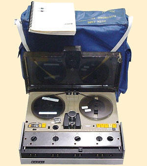

I also have a project given up due to lack of time. It would have been based on an industrial tape recorder made by RACAL. The transport has 8 speeds (15/16 to 60 ips), 3 motors and a capstan roller-less tape drive, optical tape tension control and heavy cast chassis.
I removed the original rec/pb FM boards and heads, and purchased a new set of Revox A77 stereo heads and a bias oscillator board for the project. I intended to build new record and playback amplifiers, but I have not too much motivation since I purchased a Sony TC-645 which I don't use too much these days, either.

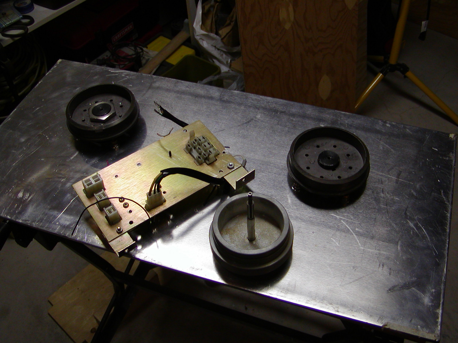

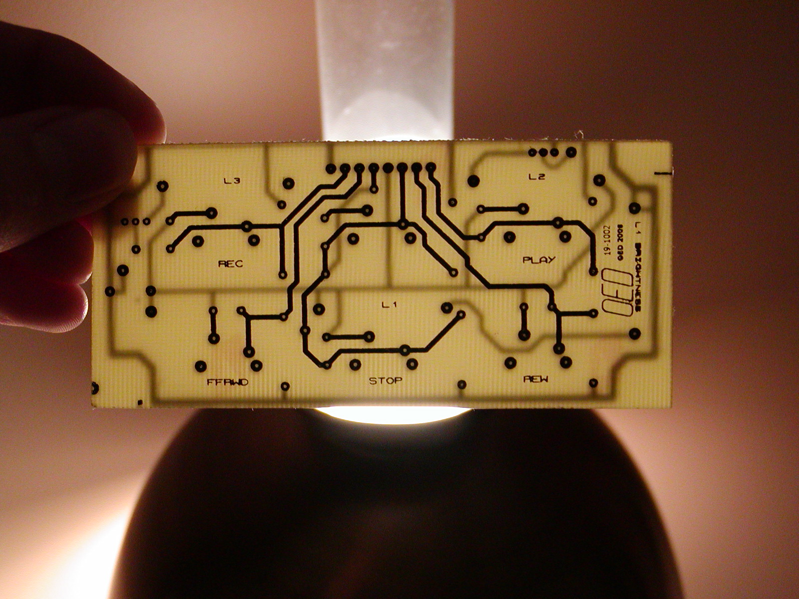

Wow, I am surprised and glad this thread exists. It helps me get through a tough day, I am rejoiced (somewhat😱). Anyway, I too am building an open reel deck, but aimed at studio 8 track recording rather than home audio use. For fun, and because I had the parts. And time. Here are some pictures:
- Analogue Source
- DIY reel-to-reel ?
