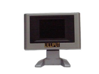

heya buddy sure just time is taking my interst in this feild away right now but its doable with a lilliput lcd, i probally would use a mirror, before the mirror there would be the lcd at the bottom with its light engine, then after the lcd i would magnify the image to a mirror so the image is bigger and u have a larger more even throw area, then it should project onto the screen from a right angle, u would need a short focal lens for this and a very bright light, if u wanted to get the best results maybe use a frensel behind the screen the same size as the screen but i gather this may give u a viewing angle problem, but without the frensel behind the screen the image would be very even if you set the optics up right in the light engine.

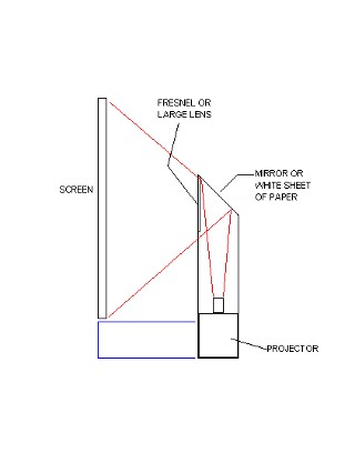

Here is my new design. The projector will project the image onto a mirror or a white sheet of paper. If I use a sheet of paper the image will show up on the paper and be magnified by a large plano-convex lense or a fresnel. I believe this setup will project the image into the fresnel or lense straighten it out so it project straight at the screen, this will allow me to make my screen without a fresnel to straighten the image out. I don't know if this idea will work but I will post result when I get to it.
that is pretty close to what I have in mind but with the projector mounted at an angle right under the screen. I made a drawing of it but how do I insert it into a message? one advantage to your design has is that it allows for a taller screen. will the paper work in place of a mirror?
