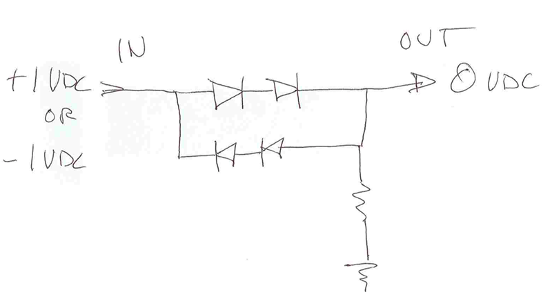

paulmc said:
If you put 1 volt into two diodes in series and a load resistor at the other end, what do you get out?
Nothing.
That's right but connect another pair of diodes in reverse parallel feed it with say 3V AC with a 1V offset and what do you get?
Has the offset dissapeared? Maybe the reduction in hum is due to an increase in mains supply impedance.
You don't have to feed mains into the HB to test if it removes DC offset. The effect will be much easier to see with 10VAC and an offset of 1V.
Uh, nothing as well. A single diode going in one direction has a 0.6 volt drop. Put less than that in and you get nothing out. Reverse the diode and it blocks all the voltage. So, either way you put the diode, it will either block 0.6 volts or all of the DC.
The diode arrangement I'm refering to is the one you described as being used in the HB. I quote:
"Think of four diodes, two in series going one way and two in series going the other way. Now picture the string of two: one with the cathode at the AC line and the other with the anode at the AC line"
The question was "feed it with say 3V AC with a 1V offset and what do you get?"
You don't get "nothing"
And crucially is the output more or less symetrical?
OK, it must be me. I'll try one more time but then I gotta get back to work.
Here's a sketch of a simple parallel string of series diodes that I wrote about. Maybe it's just my lack of communication skills why this wasn't obvious.
When you look at the drawing it'll be obvious to you about blocking DC. This is really simple stuff.
As far as ther assymetry correction, it's the DC that's level shifting the AC. When the DC is gone the AC gets symmetrical.
The trick is getting the AC then to look and act correctly around the zero cross point - where the diodes are not conducting. Our solution is not perfect around this point - it's not bad, but not perfect. The good news is that around the zero cross point you're not really drawing any current, so it's ok.
Cheers! Now back to work for me.
Have fun guys.
The total amount of DC this simple double-diode-resistor circuit is able to correct is equal to about 1.2V times the relationship between the time the absolute value of the mains voltage is below 1.2V on each cycle and the lenght of a cycle
That approach provides correction for, let's say, up to +-20mV DC that may be enough sometimes but not allways. I've seen up to 500mV DC on my mains AC supply
The full +-1.2V correction range is achieved only by connecting a bipolar capacitor in paralell with the diodes

Paulmc, I understand your diagram very well and it is exactly this arrangement I have been refering to all along.
Clearly for pure DC anything less than +/- 1V cannot pass through but we're not really talking about DC, the only way of seeing DC on an AC waveform is by integrating it.
The point I'm trying to make is that if you apply AC with an offset (the reality), this diode arrangement won't have much effect except for reducing the ampitude of both halves of the waveform by two diode drops, it can't possibly remove the offset because the diodes directly couple the input to the output.
an A/C with offset is the same as a DC + A/c with no offset.
The cap will function the same in either situation. and diode really doesn't do anything here in terms of removing A/C.
Paulmc seems to be thinking of simple DC rather than DC which is riding on the back of much larger AC.
The key components in a DC blocker are the capacitors which should be large so that they present a low impedance at mains frequencies, the diodes should rarely conduct if at all.
The claims for the Humbuster state that it's the diodes that remove the DC and this is what puzzled me about it. The capacitors appear to be several thousand times too small to be effective.
