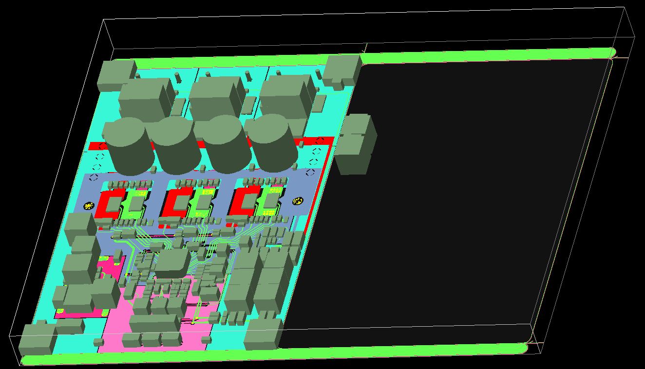

Assume you understand the circuit design,next we will start PCB Drawing,This is a tedious work and will take a lot of time.here I will show you the 3D view first.

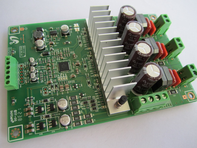

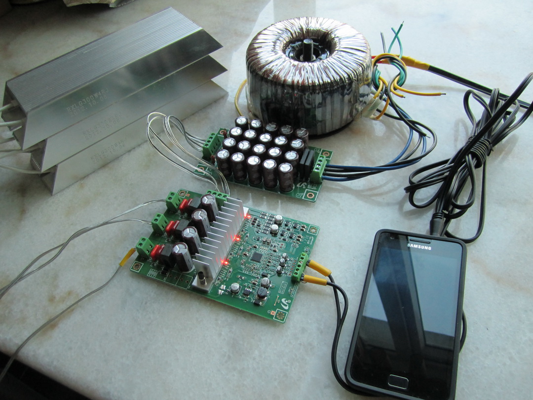

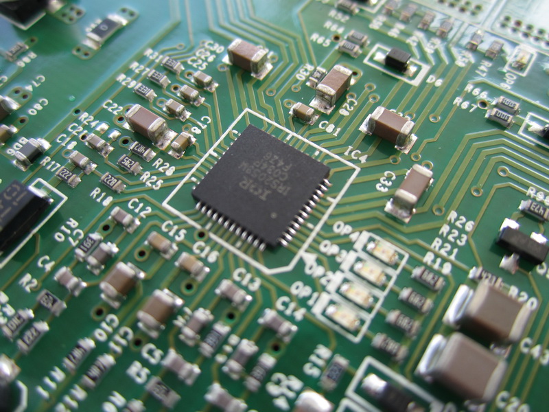

Today i test the amplifier board,it works very well and sounds perfect.
here upload some picture,please refer attanchment.
More pictures and design note are in progress~~~

Hi Airwave,
this is looking like a very nice DIY-version of the IRAUD11.
Don't be frustrated that nobody is replying.
It is hard to get attention.

Exercise patience, your work is clean enough to attract visitors, put some more pics, preferably measurements.

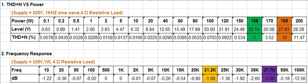

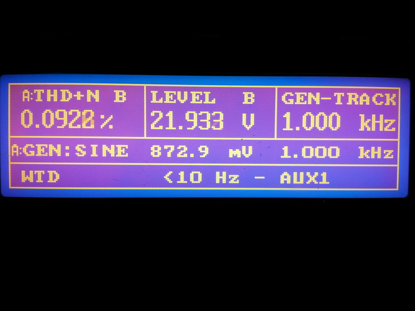

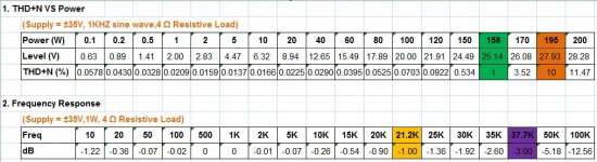

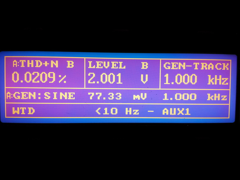

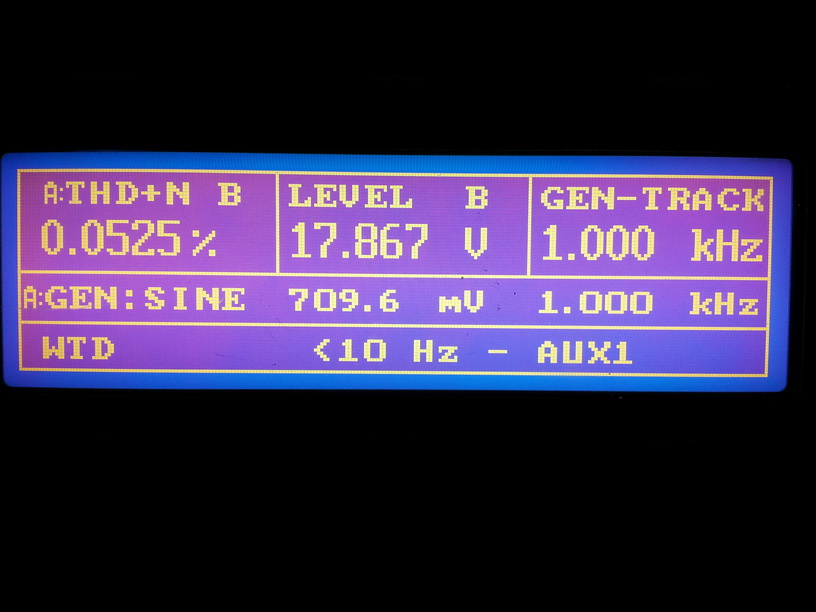

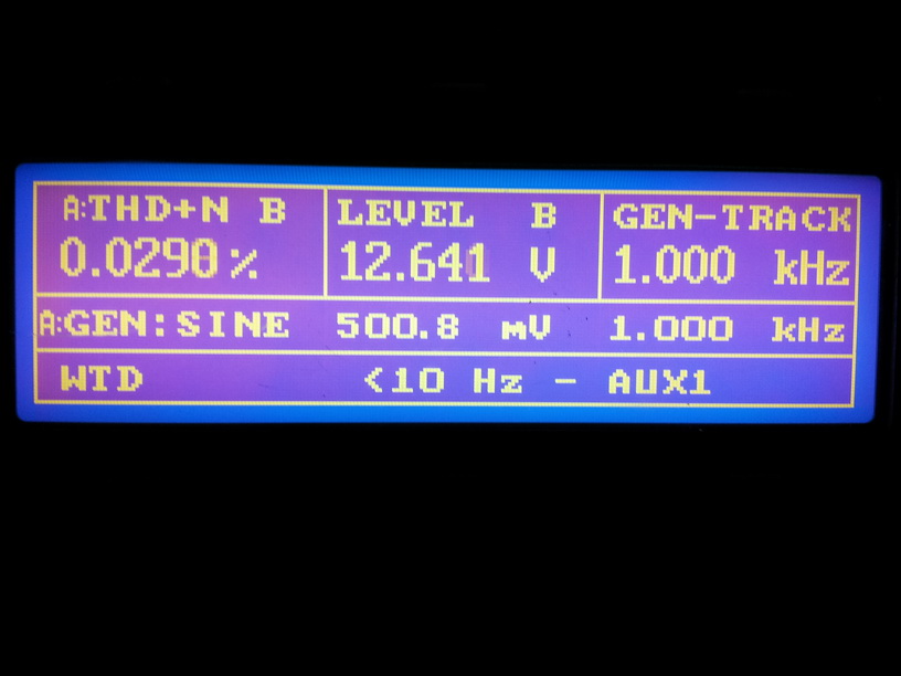

Hi,Dear DIYer,I am busy these days for test and verify this board,
Now I have a good news to announce,that is this board have a good performance.
The most obvious is Output Power is larger that IRAUDAMP11,test data as following.
[mark]
1.Test Conditions: Supply ±35V,4Ω Resistive Load, 1KHz Reference Frequency
2.Testing instrument:ATS-1(AP)
3.Power source:SMPS Module
4.Performance(THD+N)will be better if use Transformer Supply
[mark]
