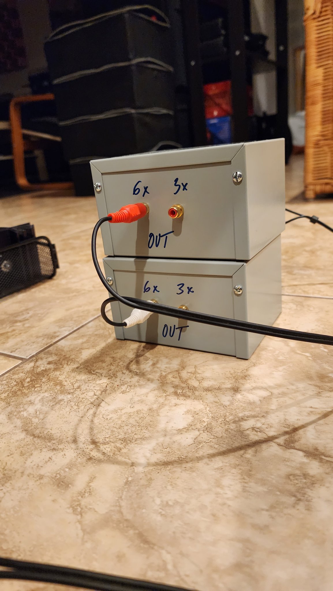

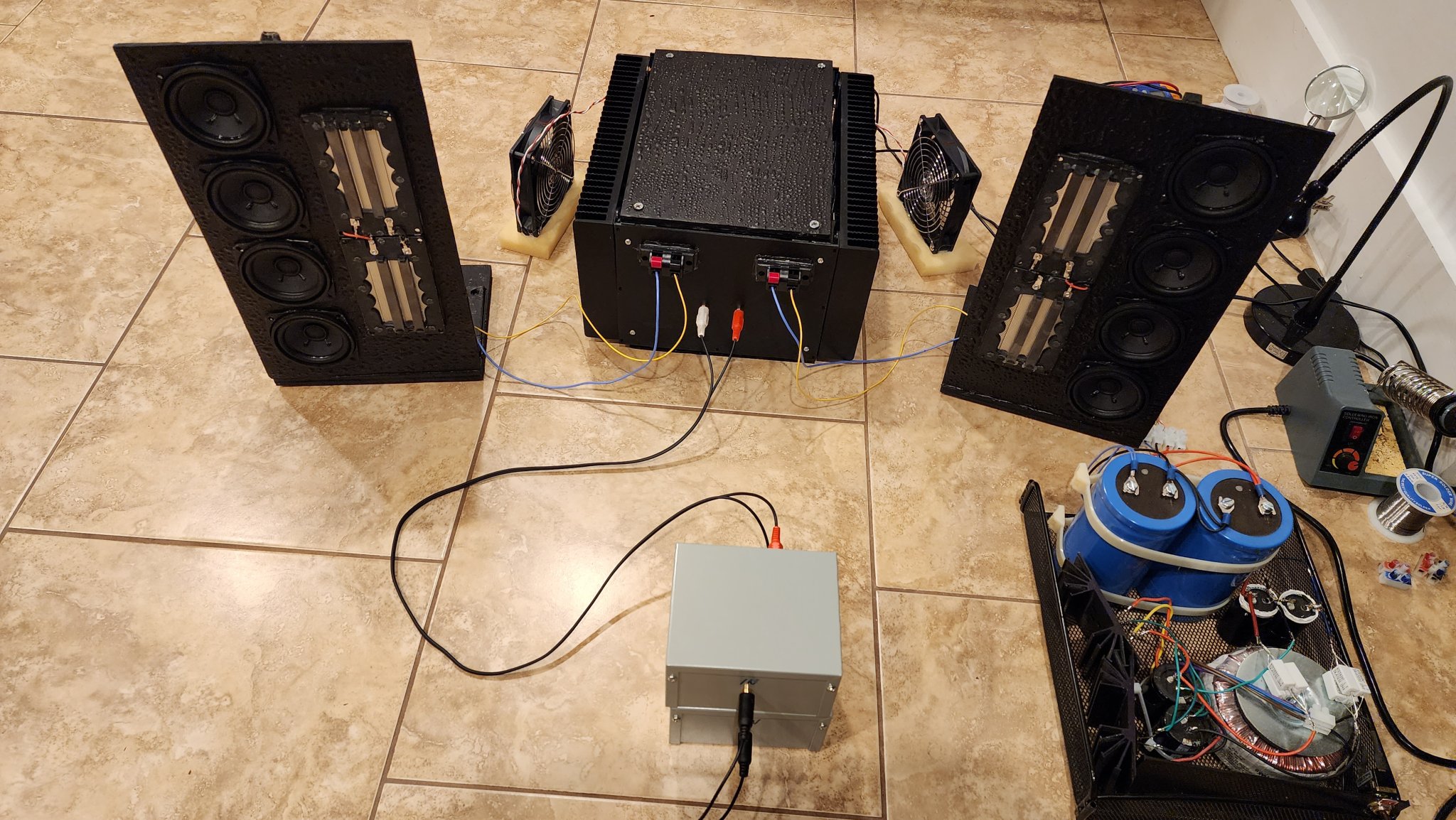

I am using edcor step up between computer and f4/ adason buffer. Without the edcor, i need to put headphone output to max on computer. With trafo, wired for 3x and 6x amplification, i need to turn computer down, about 20% volume. This is just test setup for fun.
Has been experimenting with tvc.

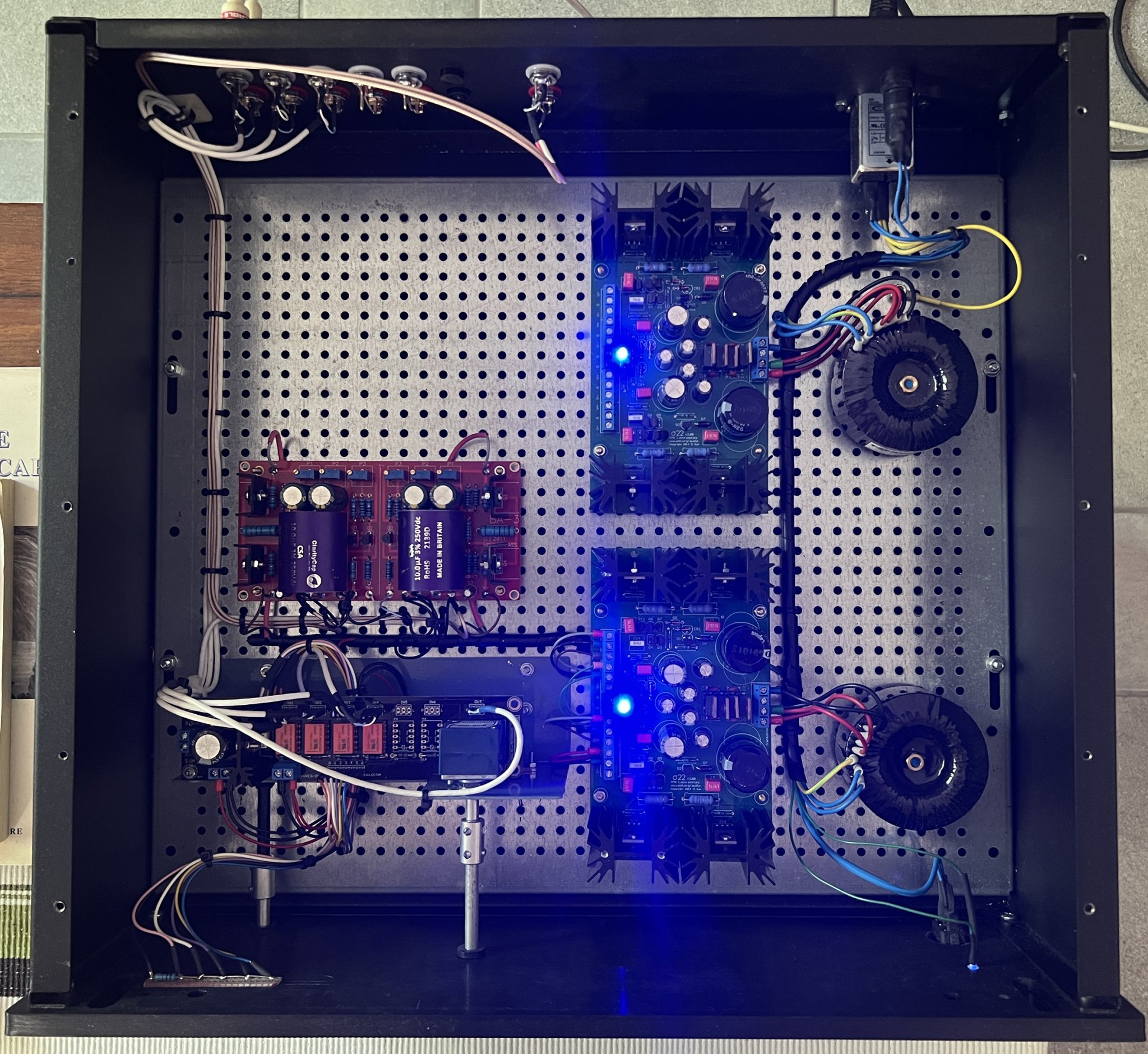

On paper the BA3 should be the perfect match for the F4, I had it assembled with, if I recall correct, about 30V to allow it for both max gain and min distortion, dual mono as well as the F4; the guy who put it together for me added a bonus in the form of a BT receiver so that I could stream music off a mobile device for casual listening, unfortunately it causes a deep and loud hum on the tube amp I own and a higher pitch but thinner hum with the F4, the gain is slightly higher than the Audio Research SP9 but can't yet tell if once in working order it would make it loud enough so that I won't regret the tube amp (which is still there by the way!).
Here you can see the two Sigma22 PSU but only one is connected, dunno why the decision not to wire both, so far he said one is enough to drive the whole thing and I knew that already but the dual mono design at this point doesn't make sense so either connect the second PSU or remove the excess, get a smaller case and remake it as to take less footprint as space here is precious.
I wanted also to have dual output but so far seems the impedance would halve, dunno what would that cause but I left the world as it is and waiting for the hum to be fixed, he said he found an Harman KArdon BT module (it's below the iSelect board the actual BT module) which might work, if you guys think there is else to make this thing better please go ahead.
