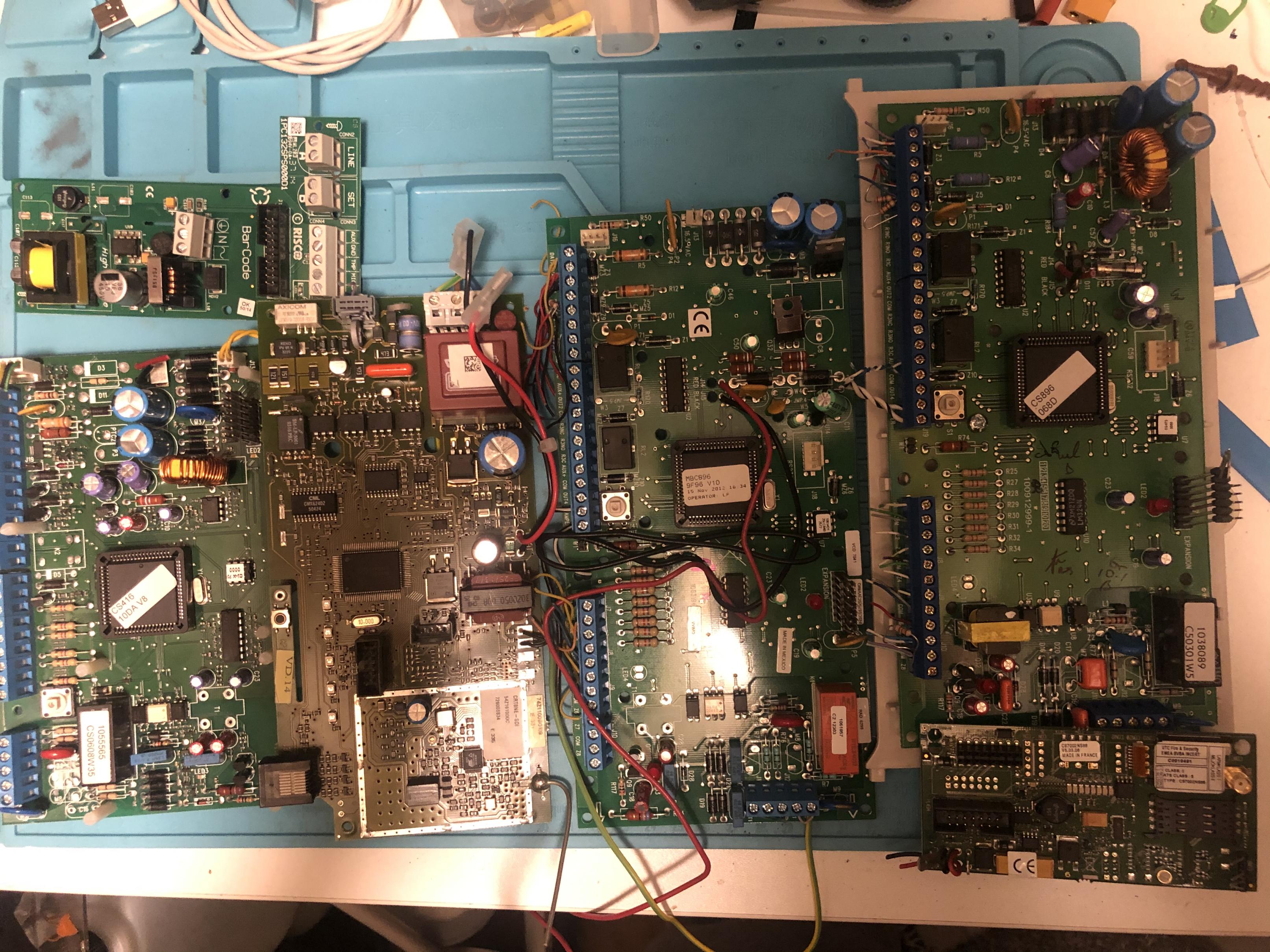

Tnx for the tip well what i got for electronic scrap is this, well alot of the same boards, a few hundred, anything usful ? The blue discs are there at least, a few SR540, IN5401 IN5822 Schottky diodes some volt regulators, and good brand caps like Elna and the blue one that i always forget the name of 🙂 the blue flat disc as well, the only anoying thing whith using old parts is that the leads are so short 😛

Tnx for the reply, yes i will use a fuse, probably one that is in the IEC connector
I live in an apartment so no hanging wires 🙂 okey so they might be owerkill ? Whold it be bad in any way to use them or whold it just be a waste of money ?
Well they arent expensive and i can order anything so if using Shottky whold be the best at this i will use some 🙂
It is free to use. Only your decision. I like to use varistors or suppressors if there is free space (somebody don't like to use them and think it is overkill). But there is strict rules for them, because they can be dangerous to use (risk of fire). So I can say that varistors or suppressors in mains circuits are not for young players.
