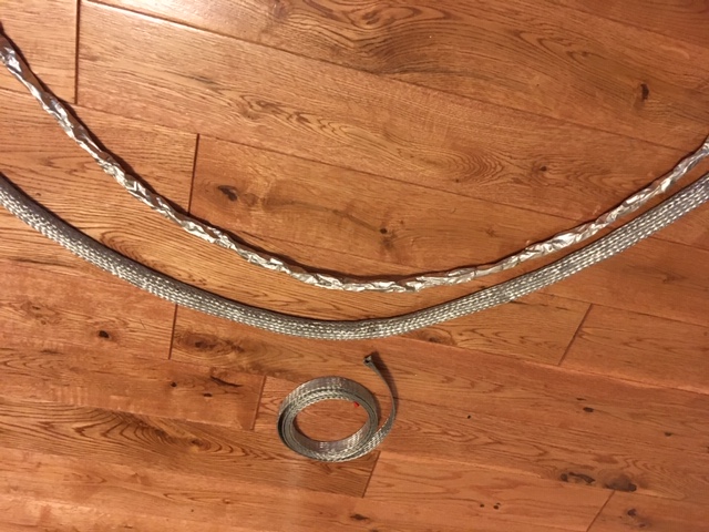

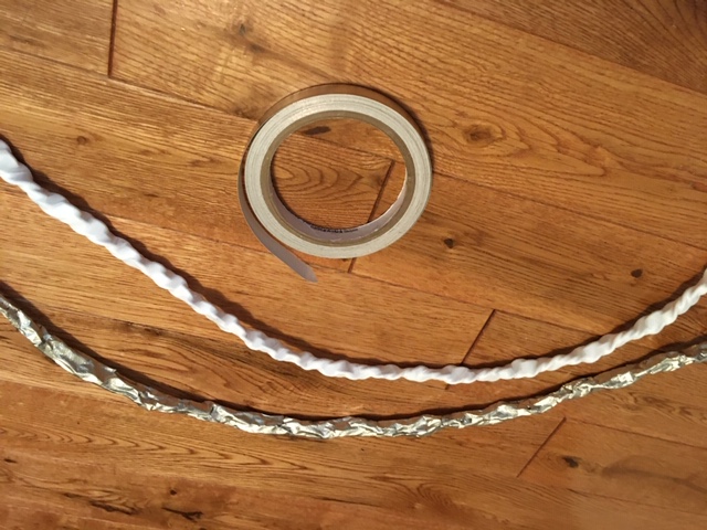

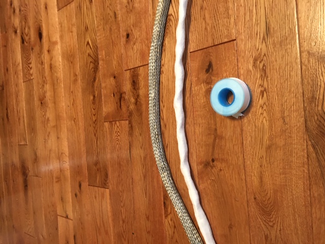

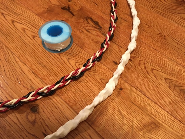

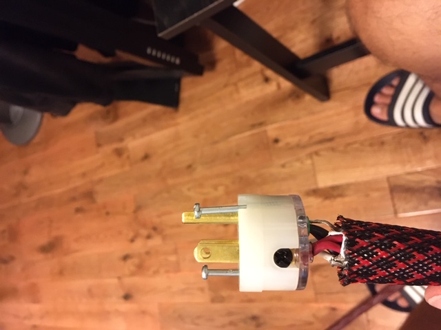

Is there anything other than basic best practices to consider when making power cables? Just want to make sure I don't start a fire due to overlooking something. Thanks.
Here are the steps I took (no fire yet lol):
I used 2 X 18 awg stranded hookup wire for each conductor.
Twisted and braided.
Two wraps of PTFE tape.
A wrap of foil tape.
Braided shield.
Braided outer sleeve.
The braided shield is grounded at wall receptacle end.
I used Marinco connectors on both ends.

I updated my post with the steps I took. And here are pics. By "best practices" I suppose I mean "don't do anything stupid" lol.
OK -I'm boring. But I'll say it anyway. If you need a power lead, use wire designed and built specifically for that purpose and forget about this braiding, twisting and taping business. Better still, just buy one off the shelf, then you don't even need to wire up the connectors. Quality power leads are inexpensive, and when purchased from a reputable manufacturer, safety is assured & your home insurance will be unaffected. If you need a shielded lead to prevent interference in other components, reasonably priced examples exist.
Do you also intend to replace your electrical house installation with cables like these?

I see where you're going with this. And that's not the point of my post. I have not brought up real or perceived sonic benefits. I don't actually expect any. I'm doing this for FUN. Because I enjoy making stuff. So back to my question: is there some safety precaution I'm missing or breaking?
Power leads are always a potential fire hazard, so yes. If you are using wire not designed / intended for that purpose, then introducing further unnecessary potential mechanical stresses by braiding a bunch of those wires together, you are increasing the risk relative to using something that was designed and built for this role. There's a reason insurance companies like power-delivery to be via certified components. Entertainment is good, and the risk may be small depending on the competence of the builder, but if you really want to make a power lead, I'd strongly advise using materials designed for purpose.

Commercial power cable manufacturers make a living out of making them and nothing else, so are very experienced, have then proper materials and test equipment, but most important point, KNOW their product MUST be certified by the approppriate Government Labs to comply.
Sadly, as a Hobbyist, you are not.
I am all for DIY making everything, but in this particular point, safety, I´d rather buy officially tested and approved stuff, THEY have sent their stuff for testing and came back with a seal of approval.
You have not.
Hey, your power cables may work very well, that´s not the point.
Personally, if needing some special power cable, say in a custom length (which in fact happens), I´d simply buy a roll of standard power cable from an electrical supply shop, and connect it to a couple commercial connectors, bought from the same source.
No special operations such as twisting, shielding, etc, just needed soldering or screw attaching, maybe some heatshrink tubing when exiting each connector to reinforce the "neck" where most flexing happens.

Gotcha. Thanks. I suppose I'll buy some wire designed specifically for AC and throw my sleeve and ends on it.
I think there is. Your twisted cable looks single insulated where double insulation is required. And I do not believe that your taping is accepted additional insulation.I see where you're going with this. And that's not the point of my post. I have not brought up real or perceived sonic benefits. I don't actually expect any. I'm doing this for FUN. Because I enjoy making stuff. So back to my question: is there some safety precaution I'm missing or breaking?
