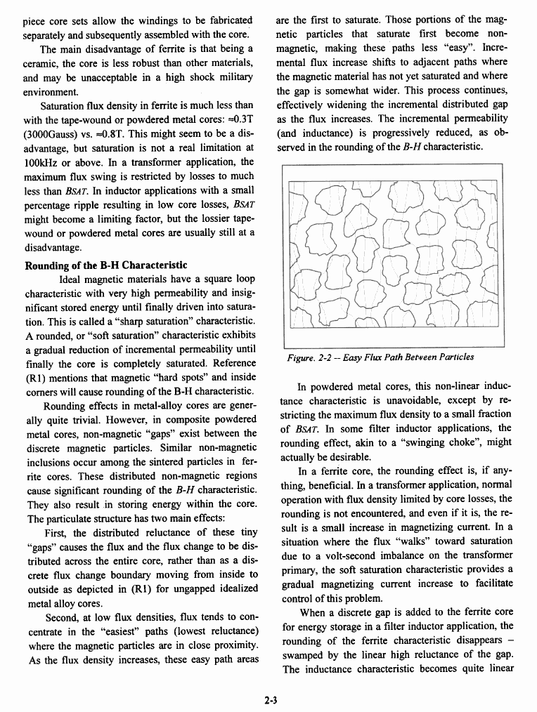

I was under impression that nonlinear BH characteristic of powdered cores is more function of the actual material structure than the material. Attached is third page from Unitrode Magnetics Handbook. This is the only reference describing rounding mechanism of BH curve I have found so far.

smoking-amp said:The non-linearity arises due to the powder particles contacting each other at small contact points. This causes the magnetic field to be concentrated there and leads to premature magnetic saturation across these contact points. This effectively makes the effective core air gap modulate with field level, leading to the non-linearity.
you mean the same thing that happens in a 1X1 alternately stacked EI core?
dave
"you mean the same thing that happens in a 1X1 alternately stacked EI core?"
Hi Dave,
Hmm, I guess it is the same thing, it's just more severe if the contact points are a smaller % of the total area.

jlsem said:
I am still talking about M-6, which is what nearly all decent OPT's use. I don't have any charts for materials with DC bias, so I can only guess, but the DC magnetization curve for M-6 shows a permeability of 30,000 @ .1 Oersteds and 3000 Gausses (about 2/3 the way up the curve).

i think you are still looking at the wrong picture. The BH loops you see are for minimally gapped materials. if you add an intentional gap, the loop shears over and you need to rework your numbers. Many of the loops are from real world samples (exisitng core geometries) but others are from ring samples and in both cases neither apply to anything that carries DC with any "added" gap.
I understand that. But because the core is carrying DC, it is "biased" up toward the region of the magnetization curve where mu becomes very high. It's the gap that lowers the mu and my guess of a factor of ten is very conservative, and leaves a mu in the operating region of the curve of about 3000. The error in my previous post was that I meant to say I haven't any charts for gapped cores, but I do have a representative graph where a reduction by a factor of ten is an extreme case. Again, I am talking about low (60 hz) frequency where high inductance is important. The low figure of initial permeability given in RDH4 is probably for a lower grade of steel at the bottom of the curve at an intermediate frequency.
