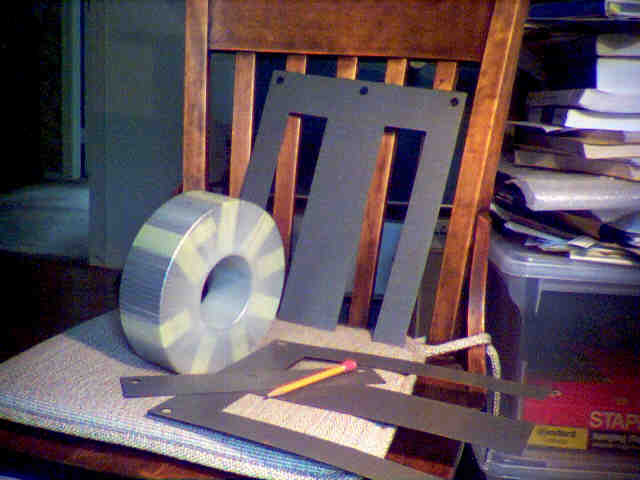

my latest trip to the scrap metal yard, $1.00 a pound
The toroids are 1KW M6 , got a half dozen, and the extra long E -I cores must be a couple of KW, M6 with MgO2 coating, bought a big box of them. I figure, the bigger the core the fewer the turns to wind for an OT and the better the bass, also the toroids are big enough that I can get the wire spool thru the hole.
:bigeyes: Holy magnetic induction Batman!!
A PP 833 in your future perhaps ?
I want YOUR salvage yard..mine is good for parts off of apple sorters ect.🤐
Nice score.
Casey
Those were the ones that were small enough to carry out. Should seen the other ones that got away!
Try around Portland, with Tektronix there, must be something. I've heard the garbage they through out around Santa Clara, Ca is gold plated. Of course, there's always Ebay, but the shipping on iron will kill ya.

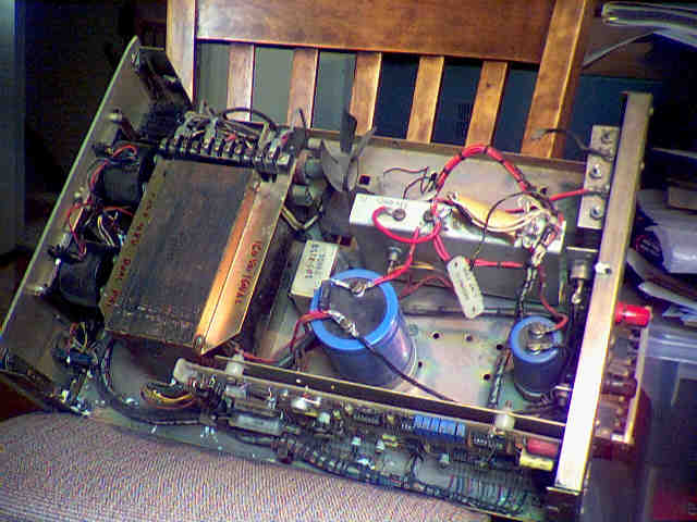

Here's a nice long E transformer, part of a Kepco ATE --- , 500 Watt linear power supply I got on Ebay. Cost me $9.99 and $50+ for shipping. Was supposed to be a working power supply, but arrived with the heatsink/power transistors missing. The usual Ebay -------! It came from Washington state too! The core is really thick, so can probably get two cores out of it. But it happens to have a nice HV winding on it already, so may keep as a power xfmr. or I may just fix the supply. Its also an enameled core, so a bit of a headache to get apart. Haven't checked to see if its M6 yet. But I would guess that the other Kepco ATE --- 500 Watt models have the same xfmr size in them. Can find them cheap occasionally. Low voltage models are usually cheap.
Its not easy to find long E laminations, even new. So this is a nice find. The long E lams have low leakage inductance compared to the usual scrapless ones. Was the secret behind the best AcroSound output xfmrs.
I checked the Kepco ATE 500 Watt power supply xfmr lams, and they are indeed M6, so this is premium long E stuff for winding OTs. (checked using a variac and a current probe to scope)
For those who might wish to consider this route (instead of using powdered iron!) to getting a premo core (enough for making 2 xfmrs with square winding cores), here are the core dimensions:
Overall: 6 inch x 4.5 in. x 2.8 in. thick stack
tongue: 1.5 in. x 2.8 in. thick stack
winding windows: 4.5 in. x .75 in.
Also, I checked on a Kepco ATE 250 Watt power supply and it has the exact same xfmr. but with 1/2 the stack thickness, 1.4 inch. This is just right for making 1 OT with a square winding core.
Using the 1.4 inch stack, 250 W core, this will give about 250/3 = 80 Watts at 20 Hz bottom (flux up to saturation), 250/2 = 125 W for guitar amp rating at 30 Hz (Hammond rating too), and for a true high fi rating at 7500 gauss at 20 Hz, this would give 40 Watts audio power. These are all Push Pull amplifier ratings.
For SE you will have to put a spacer in the lamination E to I gap. This will typically reduce audio power ratings by about 1/4 from P-P rating.
