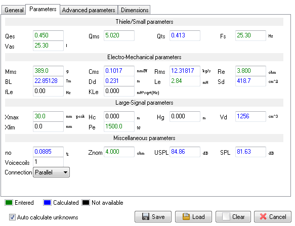

I used the dual 2 ohm, and the specs given are with both wired in series.
Took the power rating and xmax from the v.2 as they weren't listed on the above page. (the 4 inch peak to peak referred to on that page, ie ~52mm one way, is more an xmech rating, which is the point of damage. We want xmax, which is (supposed to be) where it starts sounding bad.)

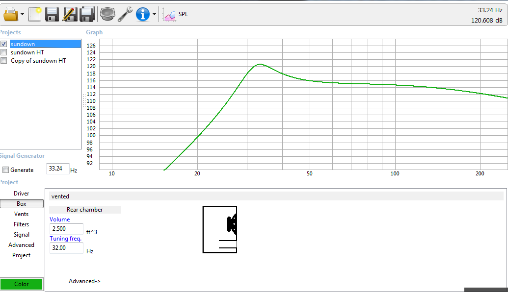

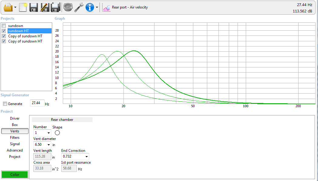

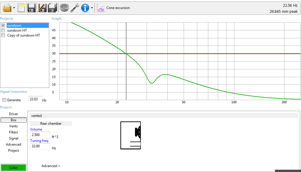

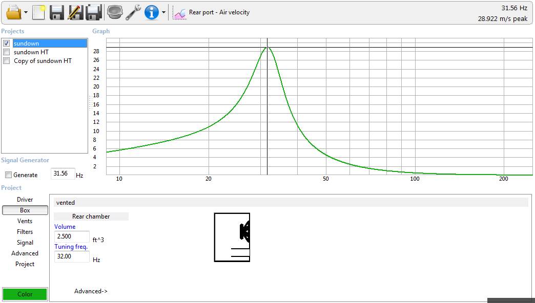

We can take a look at the recommended box size of 2.5ft3 tuned to 32hz. I set 'signal' to 1500watts, and turned on 'simulate voice coil inductance' under advanced to help with accuracy. The native response (outside of a car: to be specific, WinISD assumes flat on the ground with no walls nearby, aka 2pi space. Some simulators can change this as a parameter) has a large peak at 33hz. The excursion looks fine. It will sound great for all normal music, and stays under the damage range all the way down to 10hz. Since they gave a recommended port area we can also check vent speed, which is a little high but not absurd; they let it go up to 30m/s (assuming 1500watts) whereas most people here steer for under 17-20m/s as a broad target to avoid audible chuffing.

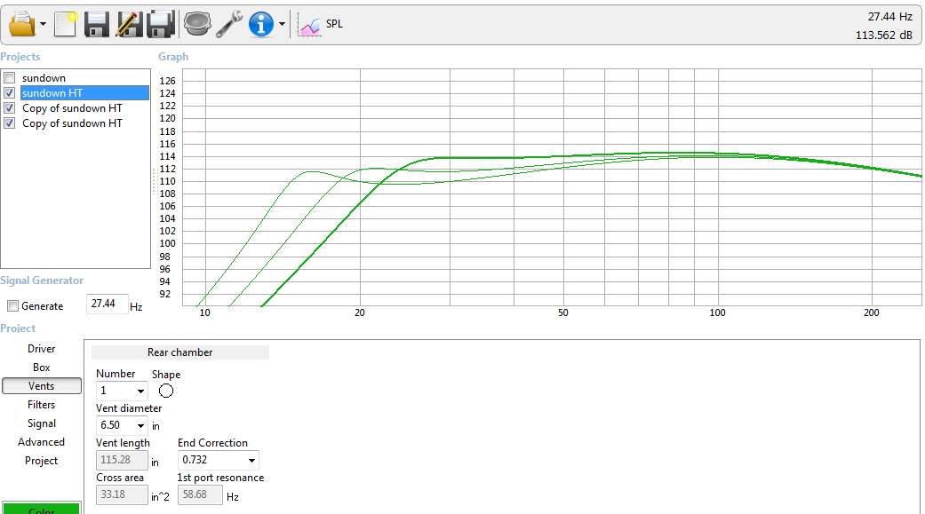

I modelled three possible home theater tunings. Generally for home theater we want a smooth 2pi response down to 30hz or so, for in-room response to 20hz or below (room gain should kick in below around 30hz, so it can roll off under there and still sound flat to more like 20hz, but you don't want any giant peaks or dips above there, as a general goal). All three have a problem which I will get to in a minute.
1.18ft3 25hz
1.74ft3 20hz
3.00ft3 16hz

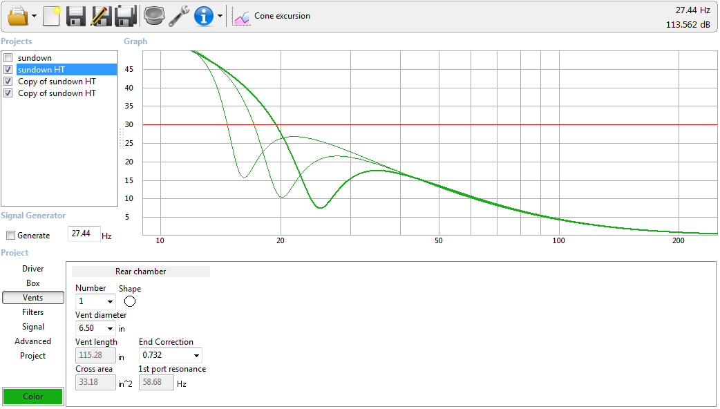

Excursion is fine though movies sometimes have content under 10hz, so some high pass filtering would be nice if run at the full 1500w. They have lovely SPL. 25hz is the flattest; the lower tunings won't flatten out no matter how large you make the box. These boxes are tiny, because this is a car audio driver made to work in a tiny box with high power (low VAS, I think?). So the problem is, when you go to vent it, you have to keep increasing the vent area to get the air velocity down. As you do that, the vent gets longer. All three of these boxes would require giant, 8+ foot long ports. Which would create problematic resonances inside the frequency range you are trying to produce, besides adding a huge volume to the boxes (port volume isn't included in the box volumes above) even if you wanted to fold them up and pack them in. This is a common problem with high-excursion, low VAS (I hope I'm getting that right) car audio drivers. This is exactly where passive radiators shine; tiny boxes tuned low. They let you trade money for space; they work almost like a port, but with their own weight being the equivalent of the weight of the air that would be in a port tube. So all the length gets compressed to (nearly) zero!
Anyway, if you want to see how big the final boxes would be if vented, I use this box calculator web site, and just try numbers until I get the same net volume and vent areas: http://www.bcae1.com/spboxnew2.htm
You can also try targeting a higher vent speed, using less power, and/or adding a high-pass filter (under 'filters'), to get the port shortened. Flaring the ends also allows smaller vents with equal noise, see https://www.subwoofer-builder.com/flare-testing.htm for details.

Holy cow thanks a million! You went above and beyond and its much appreciated. I will definitely check out winisd and some tutorials. I do use a very simple box tuning program so it wont be completely alien. I dont think it would affect anything much but the v1 rms rating was 1250w and the one I have is a d4, I should find out when I get to playing with winisd though🙂 I also noticed it looks like you used a 6.5 round port which comes out to 33.2insq but the recommended is 40insq. Just curious if that was for a particular reason like trying to adjust the vent speed or something else? I didnt realize how long the port had to be to get into the lower frequencies. Thats pretty crazy. What qualities should a sub have to be considered a good candidate for a home sub? And not sure what typical ones are tuned to but how do most manufacturer made subs get away with small enclosures and short ports? Thanks again for the help.

The 6.5 inch port is one of the HT tunings; I adjusted each until vent velocity was around 17-20m/s. I didn't show the details of the other two, and I see I didn't show the details for the 'recommended' box at all. It was 7.2" diameter iirc.
