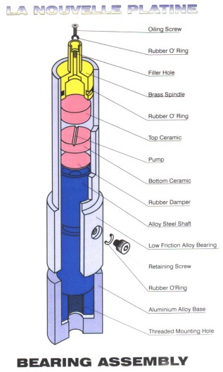

Verdier Nouvelle Platine bearing Assembly
Look here:
this is an example of using an oil pump instead of the usual ceramic ball and teflon thrust plate assembly
best regards,
Hartmut
