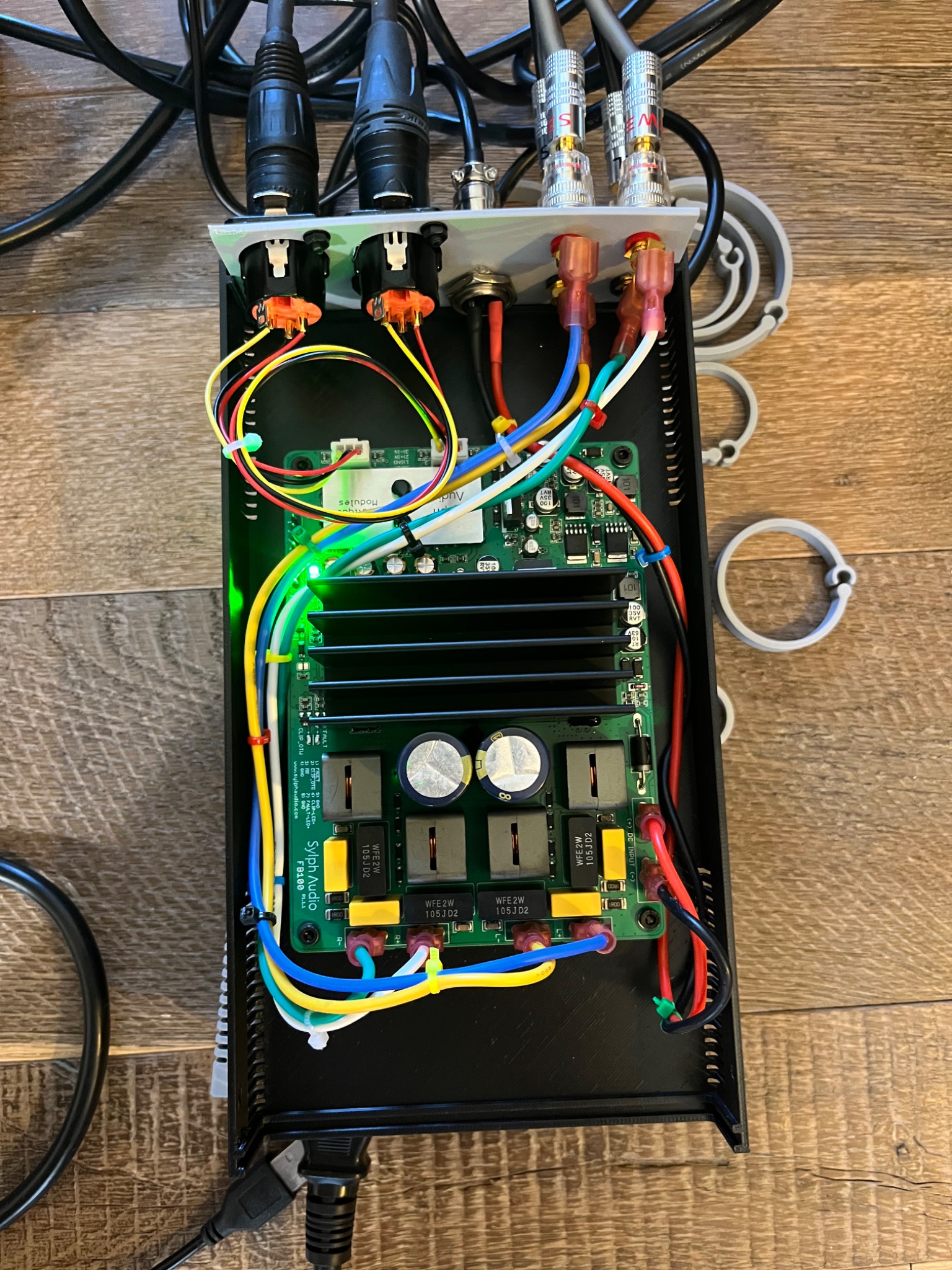

3D print your enclosure? I have questions about the lack of any faraday cage benefits however? Anyone have any thoughts about that?
I can find the link to the parametric amp case I used in the photos if you’re interested?

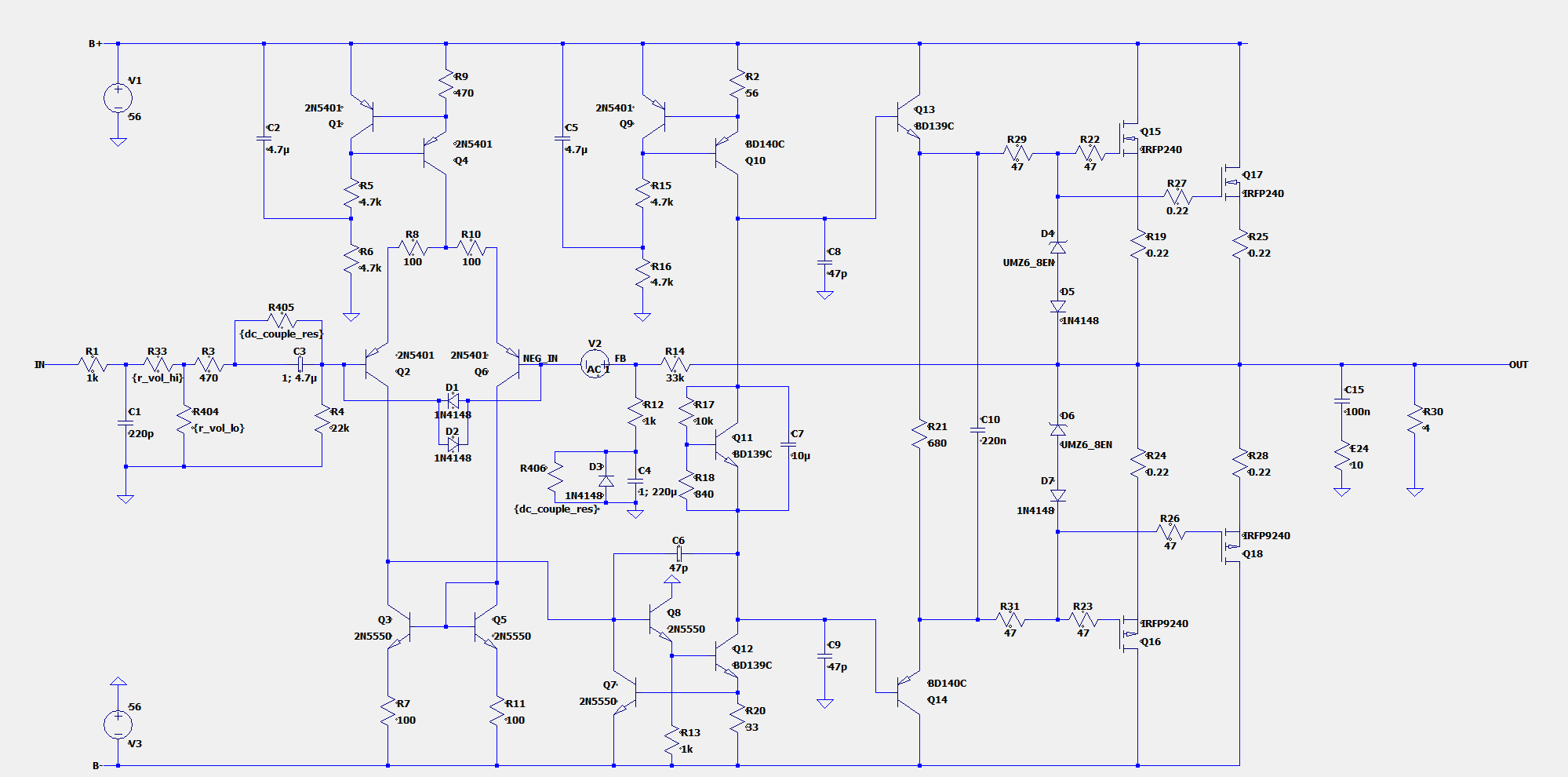

Here's a quick mod of my go-to Class AB design to make it produce 200W
Getting to be a fun straight forward amplifier.
Gets even more fun fine tuning.
You'll be around 112 to 118 volts so start getting past 80 volt BD139/40
I love the darn things, but higher power amps start having to let them go.
For Vas Q12 the classic KSC3503 is getting hard to get but KSC2690 is still available.
So NPN Vas we still have decent transistors.
PNP is the hard one, they dont do the matching pairs.
Then the drivers for mosfets, is possibly switch over to the Toshiba for 160 volt devices
with good speed.
TTA004,Q
TTC004,Q
I think you have the gate resistors in series. So each mosfet should just have a single 47 ohm.
Then with 6,8 volts for zener. I would sim 2.7 to 3.3 ohm loads and make sure they aren't clamping
to early near full power or clipping. Since "4 ohm" speakers will dip that low.
Much like a VI limiter you get flyback voltages if they clamp when music is playing.
If so no biggy just open them up to 8.2 volts or higher if needed.
Then if the amp is shorted they tend to offer a little current limiting as well.
Just dont want current limiting while music is playing and get flyback.
I havent simmed mosfet amps in awhile at 56 to 63 volts. Woo getting good.
I think 6.8 volts was ok on 42 volt rails.
Reactions: njswede
Well, it’s a Blameless-type, so it’s about as straightforward as it gets. 😀
The series 47 ohm before the zeners is there to allow for some voltage drop when they start conducting. Without them I don’t get much overcurrent protection. They can probably use some tweaking, but current configuration limits current just above 200W.
As for the BDs, none of them should ever see more than half the rail-to-rail voltage. At least when things work as they should. I’ll check out your suggestions. I’m a bit of a one trick pony when it comes to transistor selection. I tend to stick to my 2N5551/5401 and BD139/140. I’ll widen my horizons. 😀
Im with yay, 5551/5401 139/140 are my go to, love the things.
Id rather use BD139/40 as well. For the 2nd stage /Vas that does swing past 80 volts
Worth the quick download for the spice file
For the KSC2690
THD might actually drop a little, maybe.
Most the reason is voltage tolerance
Slam it with a" 6 pack" lol.
I hardly run even 4 ohm loads in real life.
But 6 output devices would be rather sweet.
Any load any day with good swing
Reactions: njswede
Hypex got it right when they decided to ventilate their plates. The air space of the amp should be separated and air tight relative to driver air space, seal of wire passthroughs. Then add openings to bottom and top side of the amp air space to allow natural cool intake hot exhaust into the room. This approach will solve most amp heat issues. You can even add a small fan to reinforce air movement. Such fan should direct air flow to blow hot air out of the enclosure in order to avoid dust build up.
At this point, while making such amp compartment inside a speaker cabinet is a good option, you should also consider putting the amp into a separate enclosure in a classic passive speaker way. Whatever fits your available space best and if you are planning to change any components often.
Another option would be to attach such amplifier enclosure at back, bottom or top of the actual speaker, if that's OK for your plans.
