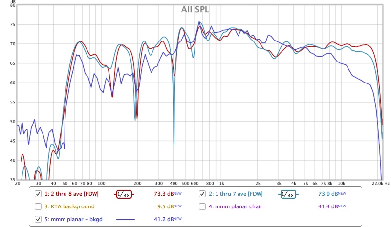

Working through another measurement session. It's nice to have the Christmas tree out of the way!

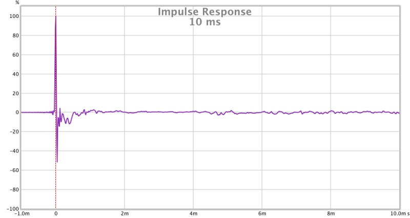

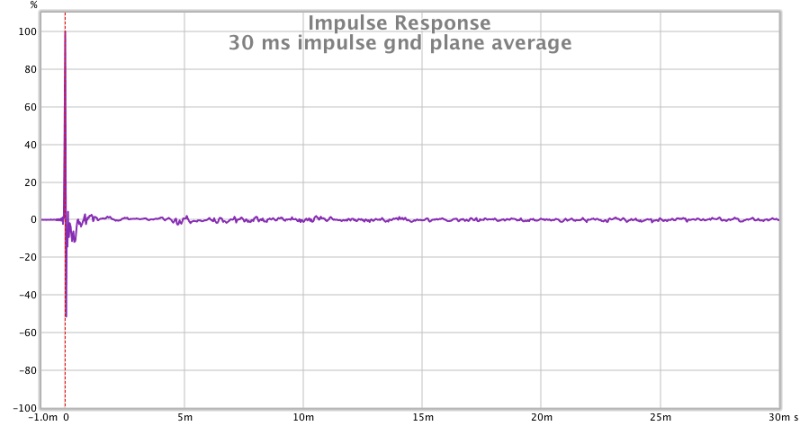

I worked a bit more with ground plane measurements, and now that I know how to average measurements I've gotten cleaner looking impulse response measurements. These are for one planar magnetic tower (no woofer contribution), no equalization or windowing, just a LR 60 Hz high pass to protect the speakers (which will be crossed over around 150 Hz or so to the woofers). The tower speaker was tilted toward the floor by 7 degrees.
I'm including both a 30 ms time span and 10 ms one as well so the early details are more clear. I'm surprised how little the room intrudes into these averaged results considering it's not what you would call anechoic! In the photo the mic is lying on the acoustically reflective polished concrete floor at the left, the wall of acoustically reflective windows reveals the local weather beyond, and part of the tilted planar magnetic tower is visible in the foreground.
All this raises the question of whether these nicer-to-look-at impulse responses have any relevance to the way I should equalize and crossover the speakers, or to the way they'll sound if I don't lie with my ear against the floor.
In any case, I'm going to make my first attempt to adding rePhase to the mix once I take a few more measurements.

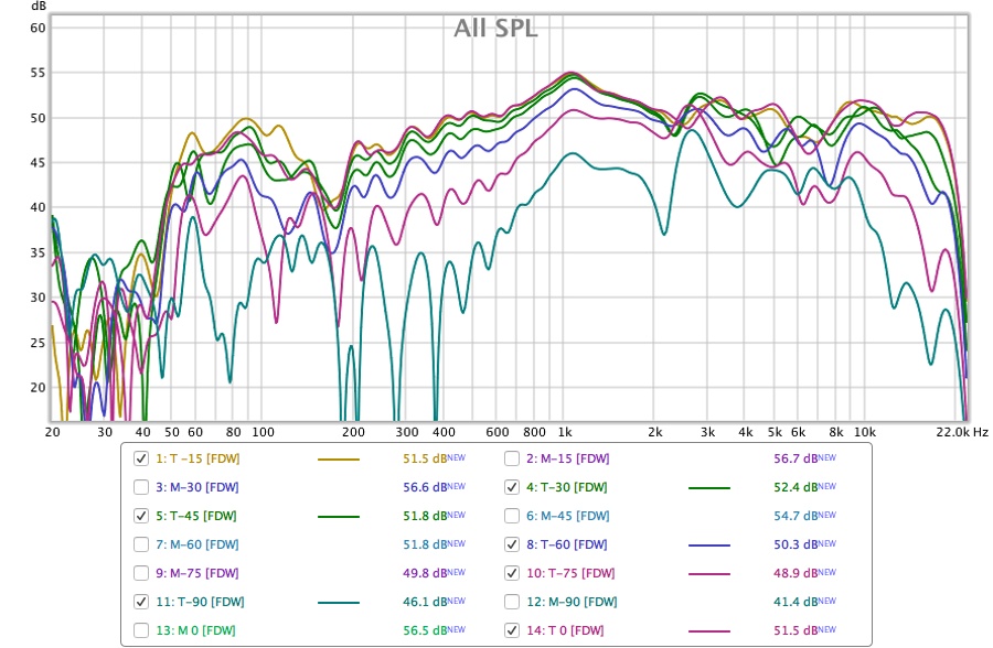

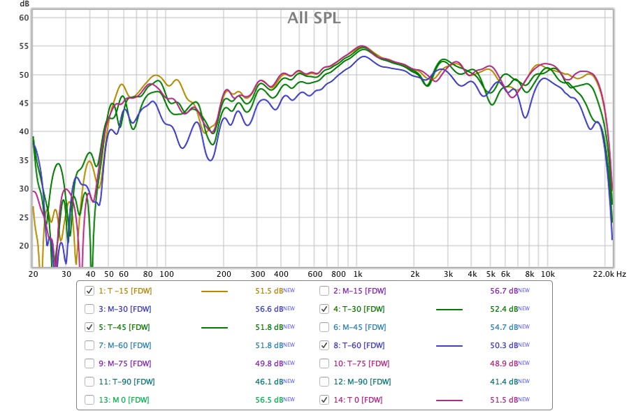

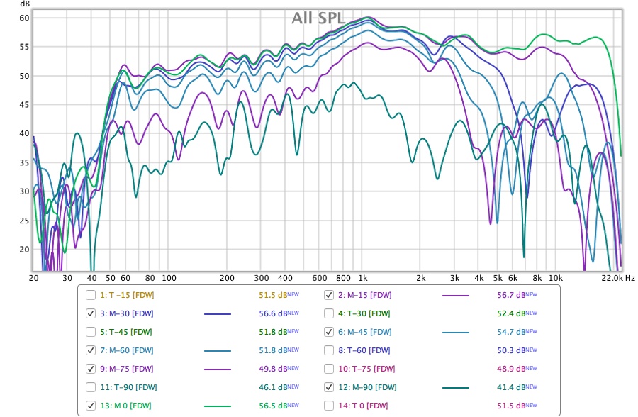

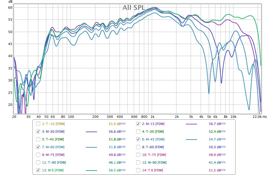

Nice.
Now that you have that battle won and in the bank, how about some on and off axis. Your nearfield measurements are nice.
The off axis are the ones that can tell you quite a bit about the sound.
Vertical polars would be interesting. But as most peoples ear height is around 37 to 39 inches from the floor that height from the floor is of most interest.

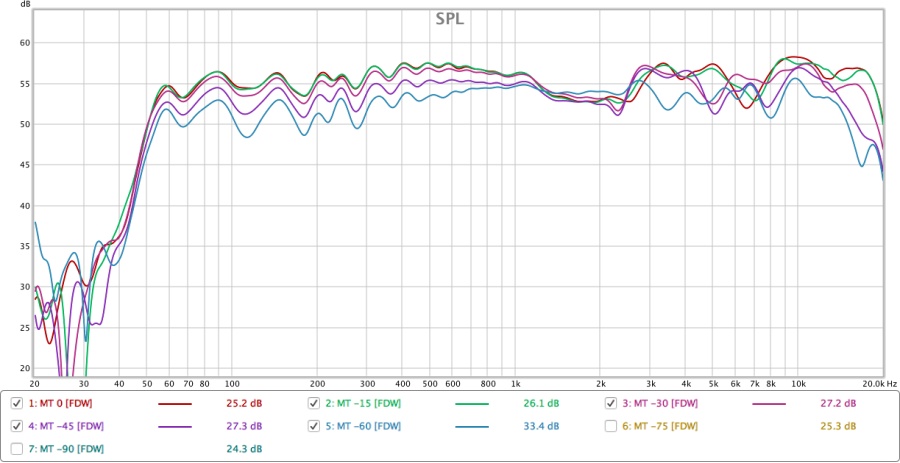

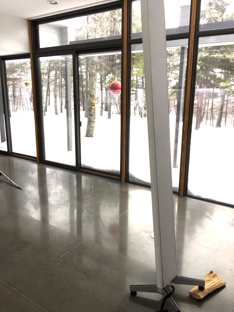

I agree directivity is one of the next questions. I haven't yet explored whether my two-trace conductor pattern will actually do anything useful in that regard so that's a big looming question. I need to try just driving the central "tweeter" section of the diaphragms and see if there's broader directivity in the high frequencies. (I'm not sure that's the right way to use the word directivity but I don't like "dispersion" in this context because that already has a very clear and very different meaning when it comes to wave propagation.)
By the way, I found that if I put the mic where the wall of windows meets the concrete floor I can get clean impulse tails with fewer measurements averaged. Just 3 or 4 measurements with the mic moved a few inches between measurements yields quite clean results for 30 ms or more. Now I need to clean up the response in the first millisecond. I know that a couple planar diaphragms had their tension disrupted during the mounting process. I can hear a buzz now and then when making frequency response measurements and I'm guessing it's from a loose diaphragm. I really don't like the way I mounted things but I was eager to get things together so I could see if any of this was going to work! I should do some refining now that I know the speakers will make music.
A few questions have arisen through this process, two hardware/software questions and one that's about where the theory's rubber hits the road. I welcome any insights.

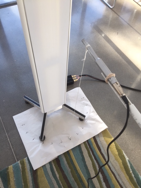

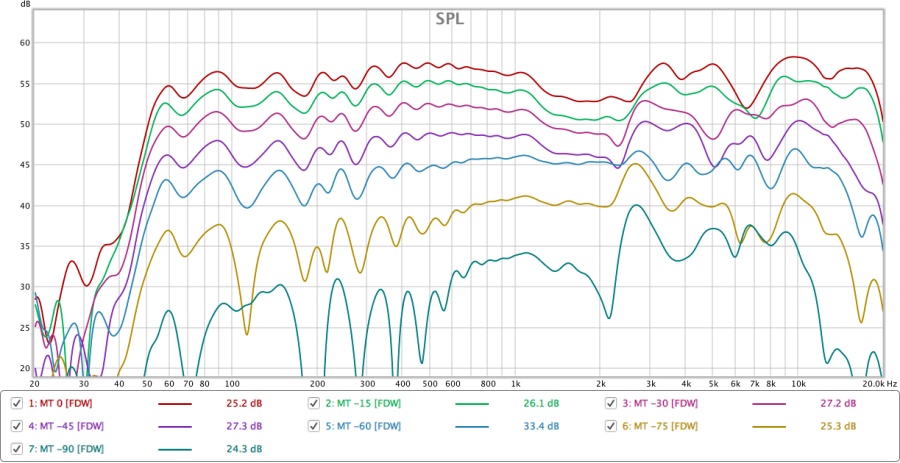

After reading the first few pages of this thread I decided to give the moving microphone measurement technique (another) try. I say "another try" because I did a less thoroughly thought out version of this many years ago when I needed measurements on short order and the tools available to me at the time made it tricky to get good gated measurements. I found I could get good reproducibility by using steady state noise and moving the mic around randomly in a volume around the listening position. I haven't used it much since that time but my interest was rekindled by the thread linked above.
The bottom line is that I found the measurements to be highly reproducible, and perhaps more importantly, when I used the resulting magnitude response (you get no phase information) as the basis for IIR correction filters, the resulting sound was much better than what I had achieved when basing my filters on gated measurements. Clearly there's more to be learned here, but that by itself is very interesting.
I'm also sure I have more room for refinement---I still need to do a directivity study and I'll have to readjust the corrections once I push a bit more along the "tweeter"-midrange approach. As I mentioned before (I don't want to assume everyone reads every word of every thread) my plan is to run the central conductor of the planar magnetic units full range, meaning ~150 Hz to 20KHz. The perimeter conductors will be rolled off at the high end to prevent the high frequencies from beaming or getting "lobey" off-axis horizontally.
One thing that tripped me up a bit at first was the pink vs. white noise choice. Just in case this is useful for anyone else, here's what I concluded about how to use Room Eq Wizard to do the moving mic measurements. First, recall that pink noise has equal energy per octave while white noise has equal energy per unit frequency. As a result, white noise has more high frequency energy.
In Room Eq Wizard:
1) Use the RTA (real time analyzer) tab to make the measurements
2) Use the generator to create either "white PN" or "pink PN" noise as a stimulus. The PN indicates these are periodic noise with a period chosen to ensure the averaged results converge quickly.
3) The RTA works in one of two distinct ways, spectrum or RTA. Use spectrum if your stimulus is white PN, and use one of the RTA modes if your stimulus is pink PN. Spectrum uses bins of constant frequency width, suited to white noise if your goal is a flat log-log plot. The RTA modes (expressed as fractions of an octave) use bins whose width are a constant fraction of an octave wide and therefore yield a flat spectrum when plotted log-log.
4) Set the averaging to "forever."
5) Start the noise signal, start the RTA running, and after about 30 seconds of tai chi while holding a mic near the listening position the result stabilizes to a remarkably reproducible result.
I found that this approach suggested my previous results had left with me with a response that dropped too much as frequency increased (not just at the popular house curve rate). When I flattened my moving mic results I felt like i had a new set of speakers! They now have the snap I thought I had given up by abandoning electrostatics, and they have just remarkably satisfying bass response. Such pace, rhythm, and timing!!😛😉
Few

I'm still working my way through the thread on the moving mic measurement technique. There's quite a bit of discussion of what each measurement technique tells you, which correlate with what we hear in a room, and which are useful starting points for equalization. I'm finding it worthwhile---you might check it out if you haven't yet.
That reading caused me to compare windowed frequency-scan measurements to moving mic measurements, all taken in the vicinity of my listening seat. These are measurements of the planar tower with no equalization, just a 50 Hz high pass to attenuate very low frequencies.
There are two sets of frequency-scan measurements, both displayed with an 8-cycle window applied to the impulse response and no other smoothing. One measurement was made about 2 feet in front of the listening position and the other was made at the listening position. At each of those distances from the speaker I moved the mic vertically from the head height of a seated listener to that of a standing listener and averaged all the measurements made at the same distance from the speaker. About 5 or 6 measurements were averaged in each case. All of the measurements were made on the speaker's main axis.
The moving mic measurement was made in a volume that included both of those locations. I used periodic pink noise and set the RTA mode of Room Eq Wizard to 1/12 octave. I did not restrict my tai chi moves to horizontally---both vertical and horizontal hand-waving within roughly 1 cubic meter.
To ease comparison I offset the RTA measurement to match levels of the two scanned frequency measurements. The agreement looks decent to me, with fewer sharp dips evident in the moving mic result. There's a dip between 2 KHz and 3 KHz in the windowed measurements that doesn't appear in the moving mic results. To fix or not to fix? That is the question. There's also high frequency roll-off in the moving mic result but that included more off-axis mic positions than did the windowed measurements so the roll-off is not surprising.

I finally did some directivity measurements and I was pleased with the results. It appears driving the central conductor full-range (above 150 Hz) while driving the two peripheral conductors only from 150 Hz to a few KHz is likely yield the constant directivity result I was hoping for. So far I just have raw data showing that driving the central conductor (which I'll call the tweeter even though it covers a wide bandwidth) spreads the high frequencies much more uniformly than does driving the two peripheral conductors (which I'll call the midrange). I don't yet have the mid-tweeter crossover, or a new set of equalizations to match, but these raw results are very encouraging so I'm sharing them in case someone is interested.
I've attached a photo of the experimental set-up. I didn't want to make a fancy turntable unless I end up doing a bunch of this so I devised a high-tech alternative. I can make one for you if you want to duplicate these measurements but expect to pay a pretty penny.😉 Basically, I marked out an arc around the speaker hung a plumb-bob from the mic, and moved the mic until it was positioned over the desired mark. I used 15 degree intervals, and a 12 inch measurement distance. I realize that's short but I wanted to minimize complications from the signal arriving from distant parts of the tower.
To make the measurements I used a swept frequency, and an 8-cycle window on the impulse response---no other smoothing. I sent the signal either only to the tweeter, or only to the midrange. Both were unequalized, just a 50 Hz high pass filter.
In the first two sets of measurements I show the results from 0 degrees (on-axis) to 90 degrees off-axis, in 15 degree increments. The first set is the tweeter and the second set is the midrange.
Because the results look a bit cluttered, and the 0 to 60 degree range is of particular interest, I'm also showing the same results but over that more limited range of angles.
The main conclusion is that that tweeter's directivity is fairly constant up to the highest frequencies I can hear--and then some. The midrange's directivity is quite constant up to about 2 KHz. Above that frequency the midrange starts to beam. Based on this, I'll try applying a low pass filter to the midrange to attenuate frequencies above 2 KHz, and boost the output from the tweeter above 2 KHz to compensate for the reduced high frequency output of the midrange.
It's an interesting question how quickly I should roll off the midrange. I'd like to avoid funny business at a sharp knee in the response so I may try a more gradual roll-off starting at a lower frequency. This is a different situation than the usual mid-tweeter crossover because I won't be applying a high-pass to the tweeter; just a low pass on the midrange. How do I avoid nasty mid-tweet interferences caused by phase shifts in the midrange output?
Once I get that crossover worked out, I'll have to re-equalize to flatten the response again.
In the meantime, I'm more than a little relieved to find that my central tweeter idea works even without mechanically decoupling the midrange and tweeter diaphragms. That makes construction FAR easier. I went this route because I really wanted to keep the tweeter central (sort of like an MTM arrangement turned on its side) so there wouldn't be complicated and asymmetric horizontal interference patterns from the overlap of the midrange and tweeter outputs. That kind of interference feels like it can't help imaging.
At some point I may try to create fancier looking directivity plots but for now I think these get the main point across. If anyone has a convenient way to display the directivity data please let me know. I have access to, and some familiarity with, Matlab so that's likely what I will explore when time allows.

As a raw measurement that is stellar. Might sound a wee bit bright, but that will be fairly easy to tame with rotation of the cabinet or even a little bit of EQ.
You have done what only a few ( no pun intended ) other companies have succeeded in.
I think you are listening to some very nice sounding loudspeakers.

At this risk of pushing my luck, I took a first stab at a mid-tweet "crossover". Again, I'm just low-passing the midrange, not high-passing the tweeter. I'm a bit surprised by the result so I'll stretch everyone's patience by adding it to today's verbosity.
Using my miniDSP, I set a Bessel low pass filter on the midrange to 1 KHz. For some reason there's no way to choose the order of the Bessel---there's just one option. No doubt somebody can explain to me why that is.
In any case, I also added a high shelf to the tweeter to compensate from the lost high frequency output from the midrange. It's a 6.5 dB boost, 1200 KHz, Q=0.5 adjustment.
Then I repeated my super-fancy directivity measurements, this time with both the midrange and tweeter driven. The results are attached, first the 0 degrees through 60 degrees measurements, and then the 0 through 90 degree results with vertical displacements to separate them visually. It isn't perfect but...hey, that ain't half bad! This is still with no equalization. Just the 50 Hz high pass on everything, the two filters described above, and 8-cycle windowing on the impulse responses (no other smoothing).
There's a little funny business between 1 and 3 KHz, which of course is right where I'm doing the filtering. Perhaps I can refine that through more experimentation. In the meantime I'll try some overall equalization and some music listening and see how it looks/sounds.

So looking at your horizontal plots i'd say smoothest response with about a 15 degree toe in.
Still looking good.
