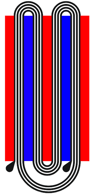

Step 1:
Tracing diaphragm
Please look, current in all 4 groups of traces flow in the same direction.
Step 2 - placing magnets between group of traces. How I made it I've shown on picture.

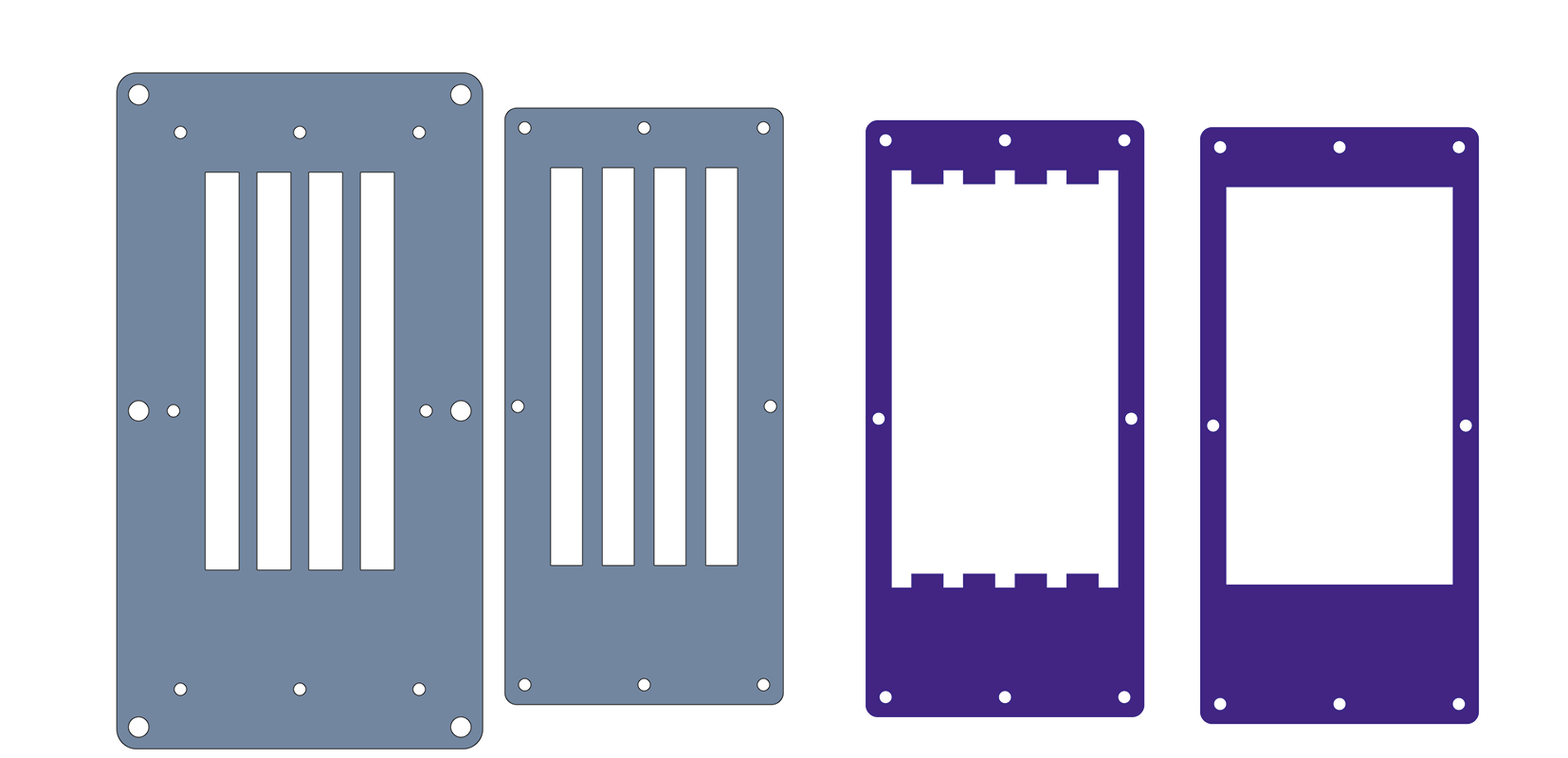

Step 3 - making a housing. That's the most simple. Just draw anything you want in any vector editor and cut it with laser.
Gray details are from steel, purple are from plastic.
