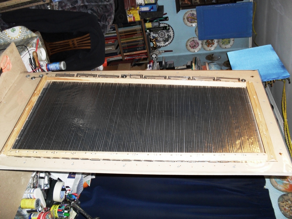

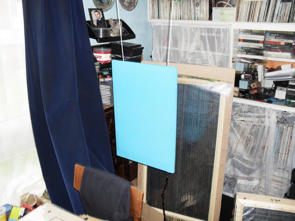

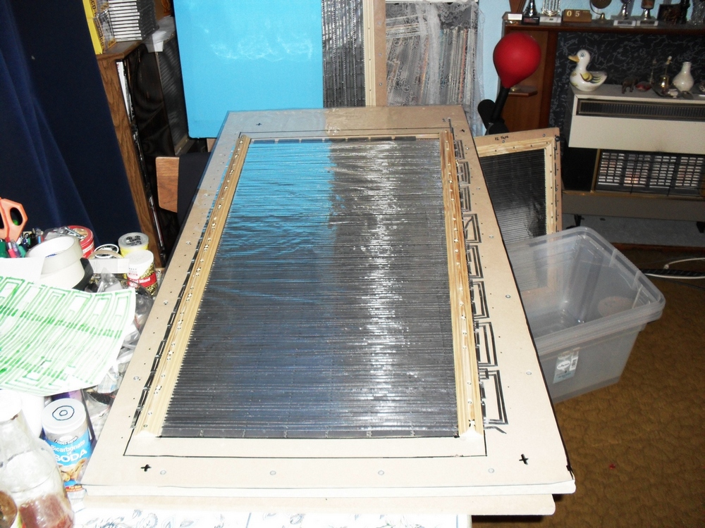

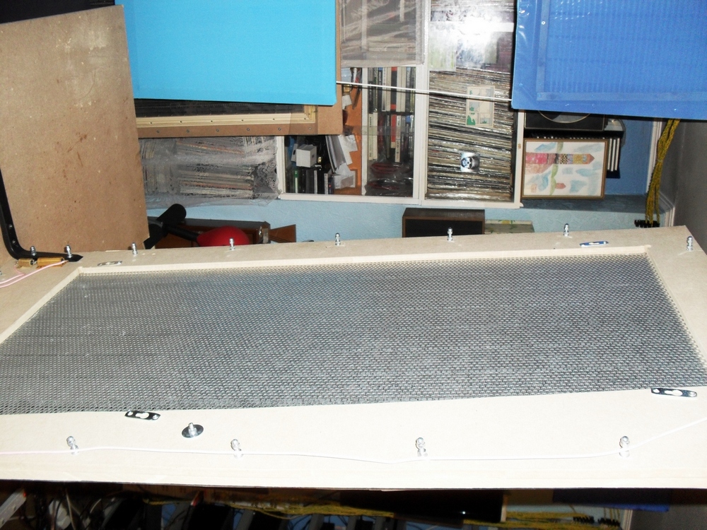

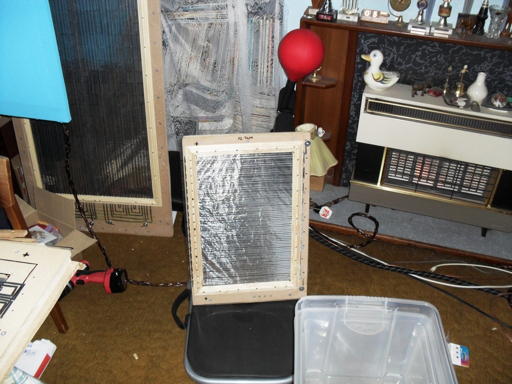

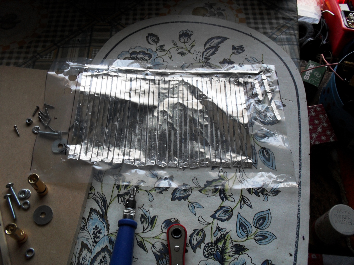

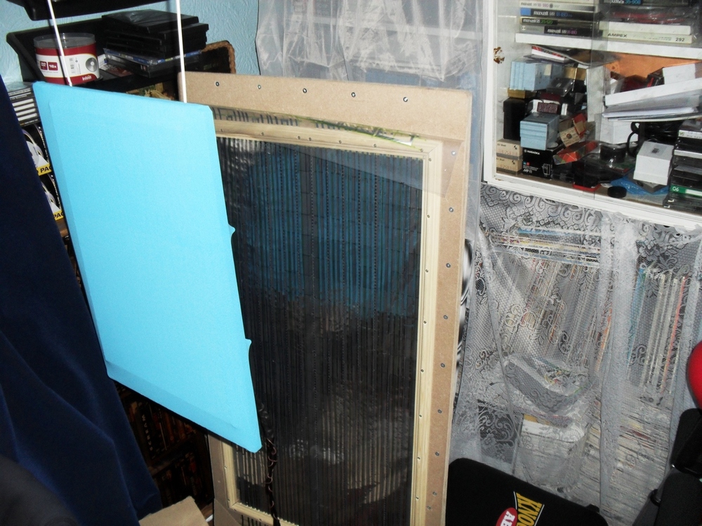

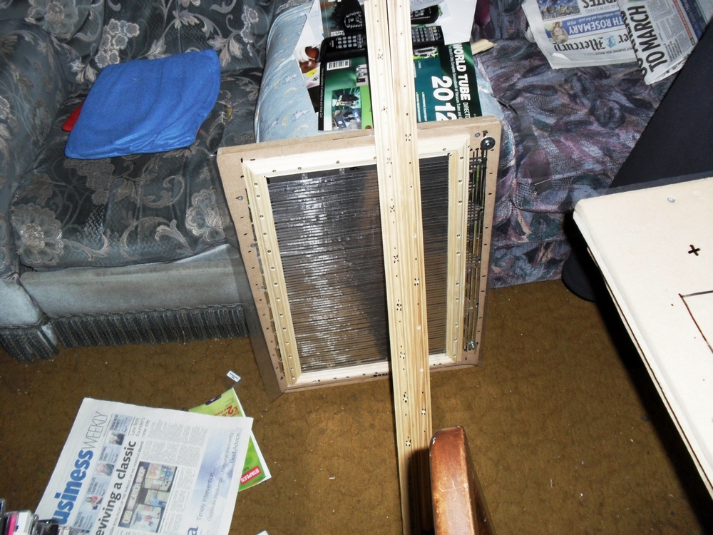

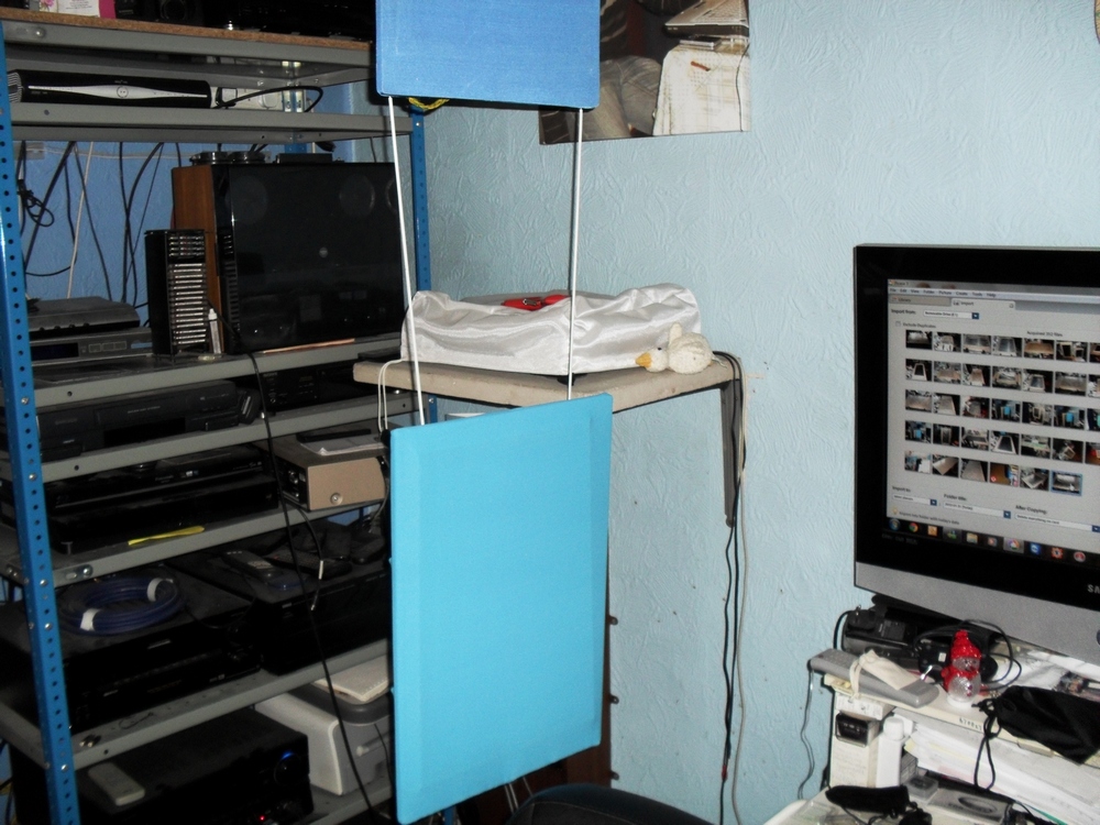

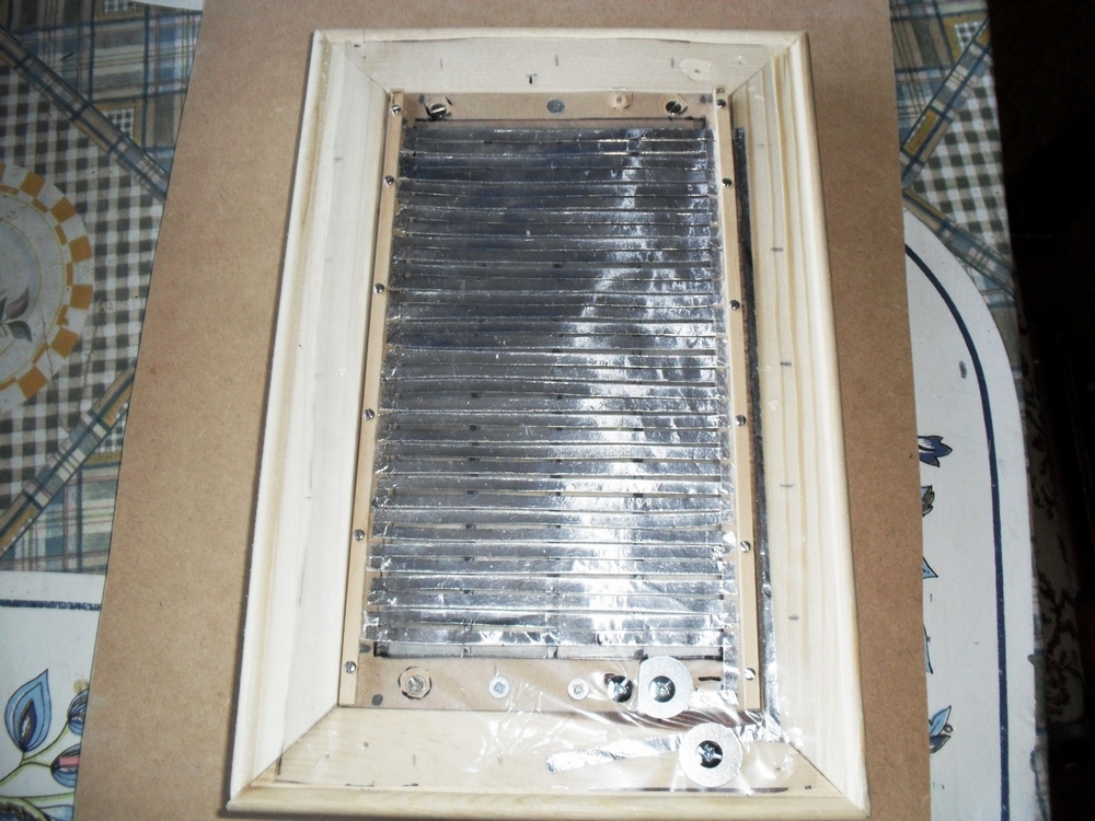

a few diy full range planars
some of my work over the last 10 years

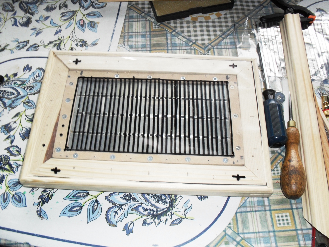

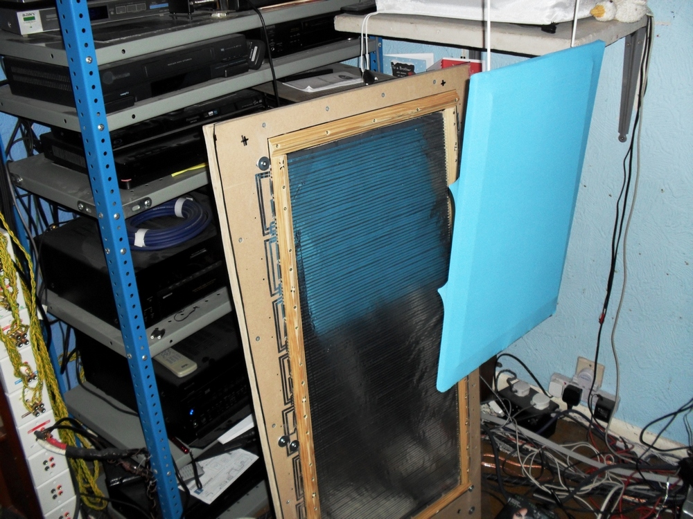

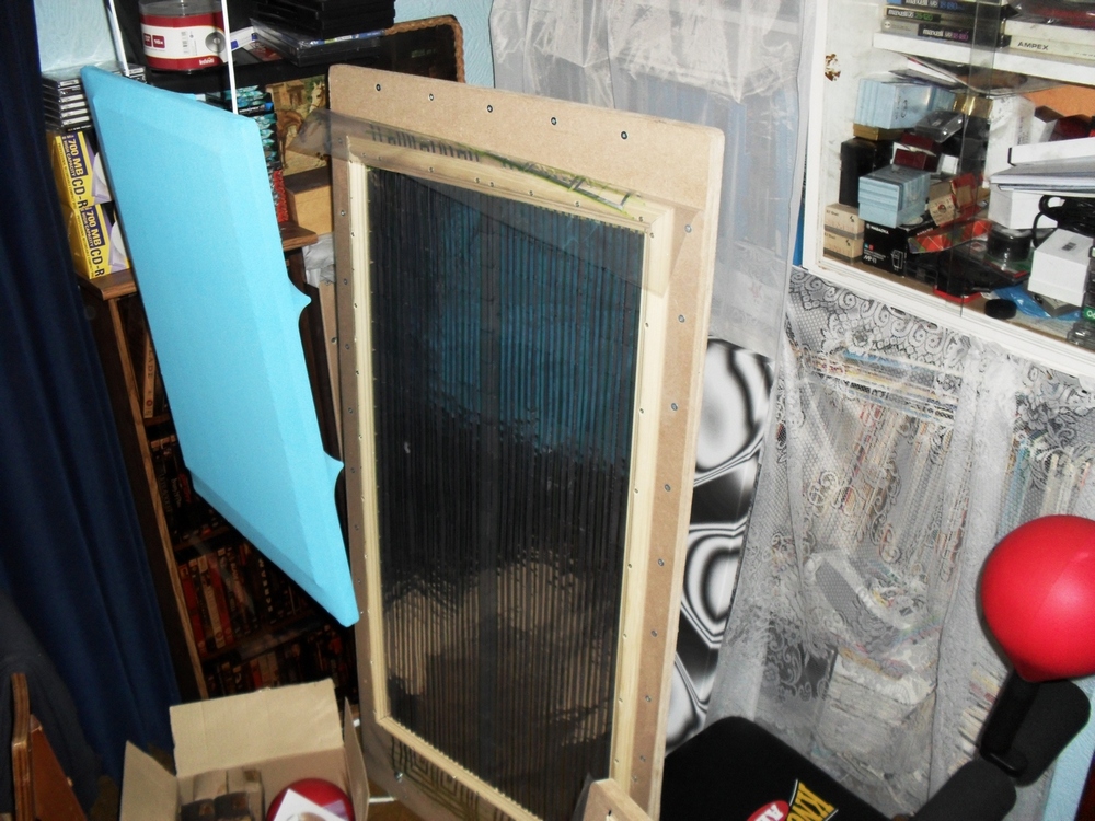

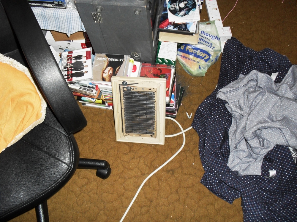

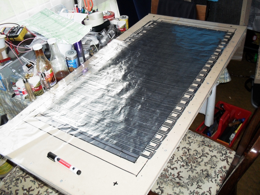

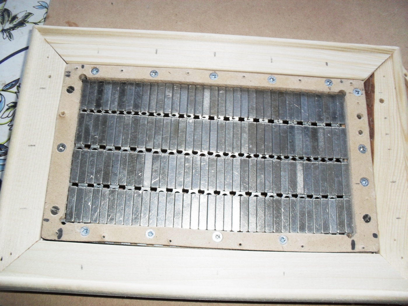

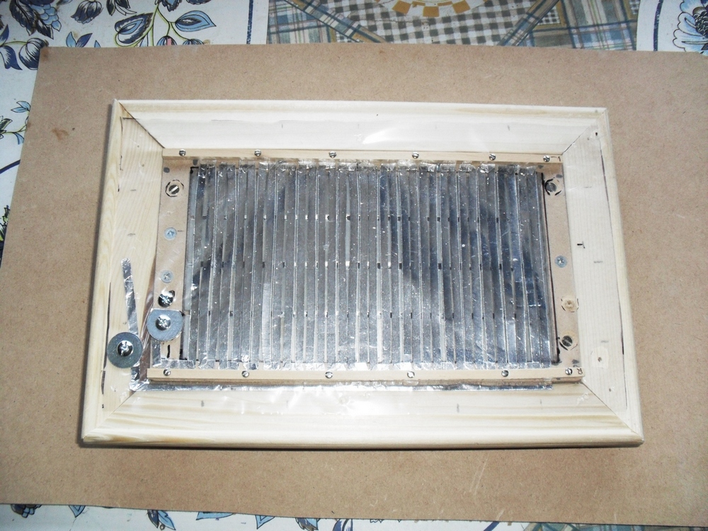

ditto

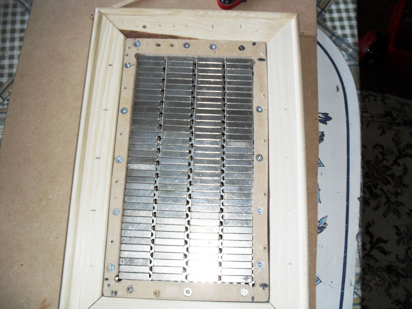

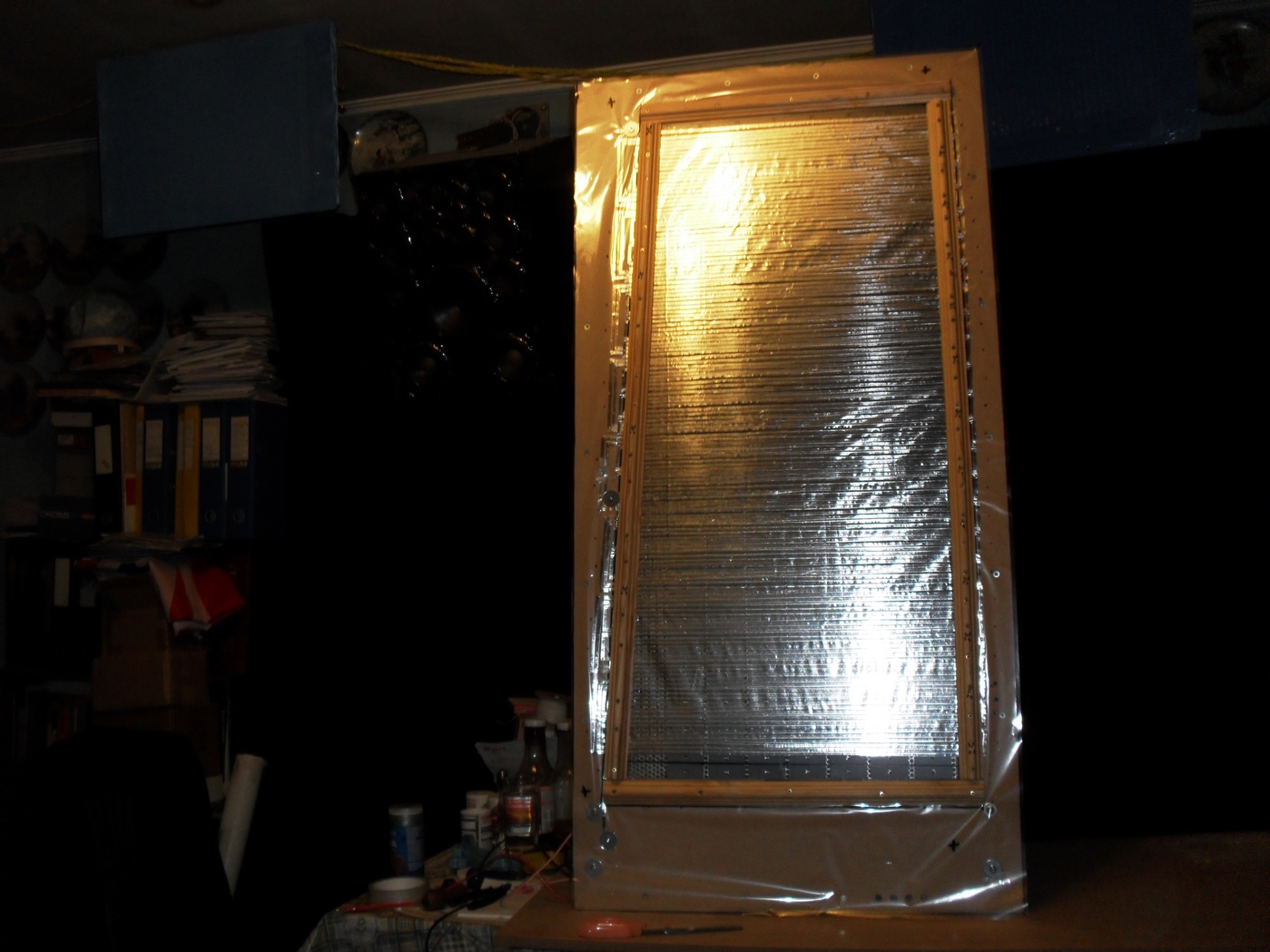

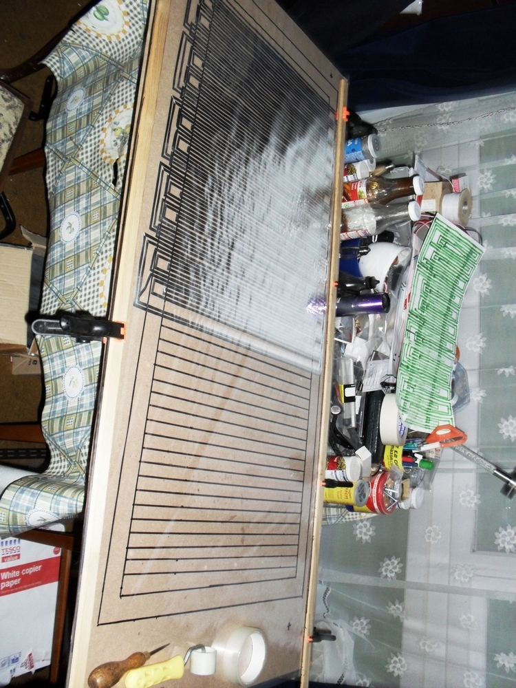

some more
some more
