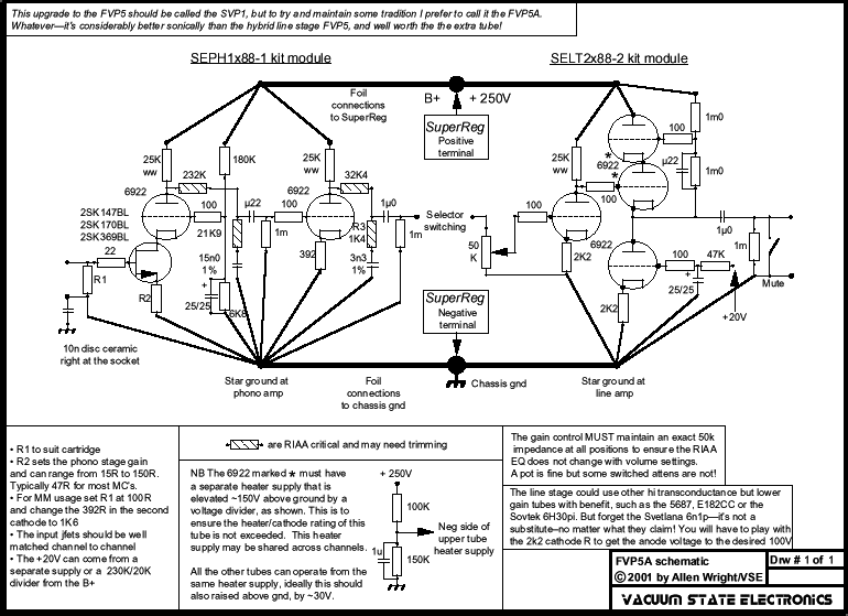

Doe's anyone know of a phono stage using 6922/ecc88. Im pouring over Bruce Rosenblit'z book at present, but it looks a bit too much to build. Not so sure about all that voltage rattling around ! And don't worry im an electrician by trade, so schematics would be usefull.
I've built this one. It's definitely the best single ended phono amp I've ever heard, and by no small margin.

To me it still looks as a desperate attempt from an otherwise brilliant designer; it says to me: I wasn't able to solve that part so I resorted to a FET.
Good sounding as it may, it's still a failure to me.
And that's just my opinion.
Cheers, ;)
Bollocks. It's a brilliant design that uses the best of both to get lots of gain, low distortion and low noise in one stage. Still haven't ever seen a tube design with noise anywhere near the cascode's or a transformer with it's resolution. It's cheap (the FET) too.
Don't tell Allen, but subbing in an ECC99 for the second tube makes it even better.
O Frank,
You are otherwise such a tolerant, friendly and clever beast, and here you go saying Alan has failed because he used a FET!!
I've been there....... with Mick Maloney's Supratek design (I had input on the power supply). I can tell you the FET pulls back noise by a huge margin - quite audible - even with selected tubes (Mick used 417A) the addition of the FET reduced noise by around 10dB. This is no small thing, particularly on a MC phono, and it was achieved with SS, one thing it's good at. And the tubes still add that indefinable something which makes the design instantly recognisable to the tubophile, I promise you.
Not at all. I'm just saying I'd feel as if I'd failed...:D
I know, Hugh. I've seen the traces of that on the net at various places.:)
I won't tell him... but it makes perfect sense to me. Well done, Brett.:cool:

Allen's design is very nice, but if you want to try something different that has some good noise cancellation features, try this (schematic at bottom of page):
TubeCad Journal
I recommend that you read the entire article and also Part 1 (the previous month).
To get good PS noise cancellation C1=22n and C2=1u. If you change anything, these values will have to change. But, with these values you can get close to 60db noise reduction below the noise floor coming from the circuit and PS. If you build a good PS the total noise should be very much below the signal level.
Yes, -90db is almost required. I did not say what I meant to say correctly.
Without the noise concellation circuit, the PS noise may already be considerably below the signal level, depending on the nature of the PS. Let's say it's 60db below for example.
The noise cancellation circuit in this design allows you to drop the noise floor more than 60db below that. So, hypothetically you'd get -120db. In practice this is hard to do, but the noise cancellation circuit will make whatever the raw design does a whole lot better.

In this particular phono preamp, the output stage is a common cathode diff amp. The second grid is normally grounded, but in this case Broskie feeds the PS noise into the second grid and this noise, in phase with the PS noise introduced normally into the rest of the circuit, cancels the normal PS noise (similar to the way NFB would be employed in this topology). This design is very clever (at least to me) and with the right values of capacitors should have an extremely low noise floor.

Better still would be to apply the same technique of noise cancellation in the PS in the first place.
Which is excactly what you do by using series regs.
That, in a nutshell, is my major quibble with TCJ; if your not savvy or an engineer you're just left second guessing.
Now, combining both appropriately could yield very high noise reduction indeed and hopefully a very good sounding phono preamp.
