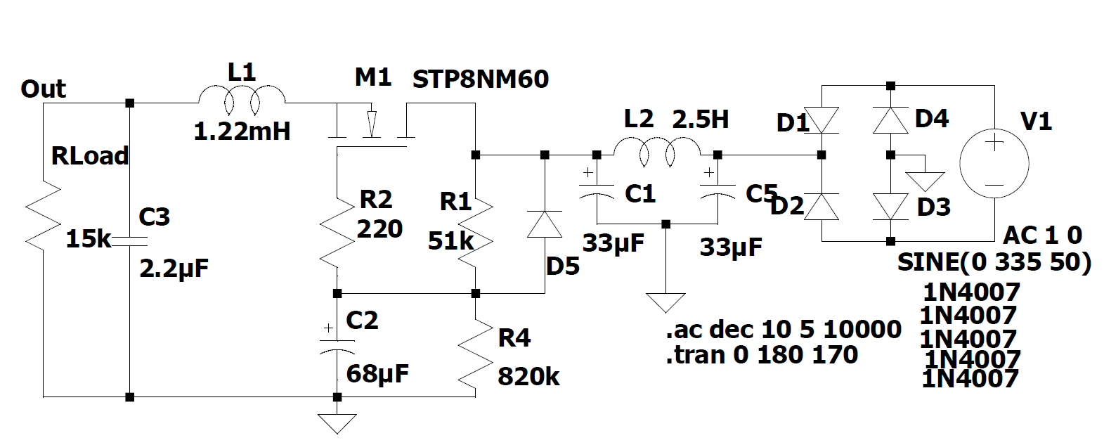

Parametric power supply (zener diodes and a lot of RC filters) is not a great idea because of zener noise and output impedance. Perhaps 3 opamps are used in next way:
1 - gain stage on INA103 (instrumental amp for MC cartridges and microphones)
2 - OPA134 as ARC (active RC filters) network
3 - OPA627 as output buffer, because it stable on unity gain and sounds great, I’ve used it same way in my DAC.
My suggestion is to replace a RC garland in PSU by simple active filter (few resistors, capacitors and transistor), since the supply current and voltage are not high you can used a JFET transistors instead of MOSFET. You can look at PSU schematic in my phono thread

I meant ARC filter for RIAA equalization. In PSUi suggest to use mosfet or jfet based rc filter (capacity multiplier other words).

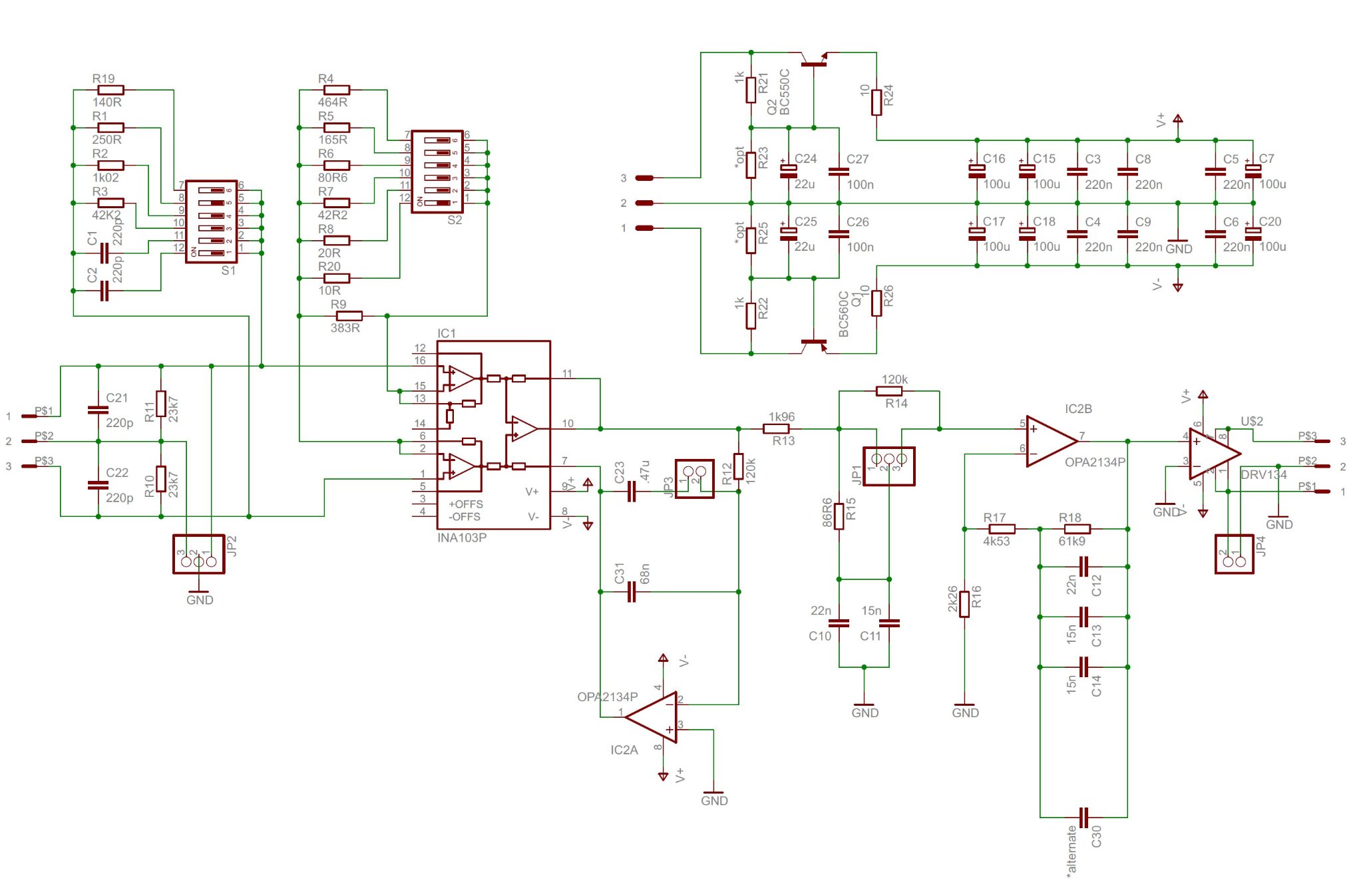

attached You find one of the many versions of a balanced input phono stage, as it is used over here, utilizing INA103, INA163, SSM2017, or THAT1570.
I prefer the INA163 over the INA103, as it is the slightly refined successor of the INA103 (which is quite old now ...I used it as part of my Thesis in 1993 already).
SSM2017 is also now a >20y old device. The THAT is practically identical to the INA163.
The latter two ones might be easier to source also and generally cost <10€/$.
Anyway ... the big pro of those INAs is that they allow for very high flexibility with regard to what Pickups one could use, variable input impedance, variable input mode bal/SE, and variable gain.
The attached circuit is a proven example and easy to build.
The INAs are optimized for input resistor values around 200Ohms and their en and in values are sufficiently low to accommodate for low output MCs (>150µV) up to high-output MMs (>5mV).
Spezialized OPAmps may have a light edge over the INAs, but in praxis INA-equipped Phono stages -DIY as well as commercial ones- typically belong to the top group regarding noise figures (see Clearaudio balanced, Lehmann, audiospecials, et al).
I couldn´t find a pickup and setup yet, where those INA-stages didn´t perform exceptionally well.
- the input may be switched between balanced and SE-mode depending on JP2 setting.
Balanced mode is advantageous for MC useage, while (some) MMs come artificially unbalanced by the manufacturer and may need user modification.
Also SE-inputs utilizing RCA connecors are the standard.
If You don´t require or want the balanced-input option then other OPAmps may fill the bill.
- with S1 You can vary the input impedance in 4 capacitive steps and 16 resistive steps.
Of course you can opt for different values und numbers of settings after Your fashion.
- R9 defines the lowest gain of the linear INA-Stage IC1.
Adding resistors in parallel with S2 increases gain from 16.7x (S2 all Off) up to 1180x (S2 all On).
- IC2A a JFET-in OPAmp drives the Ref pin of the INA with a DC-servoed signal.
Due to the possible high gains of IC1 there may occur considerable DC-Offsets ... so the DC servo is a requirement.
Here the Xover frequency can be chosen between 16Hz or <1Hz (JP3 closed)
I personally use the 16Hz setting as it forms a rumble filter, preventing excessive amplitudes of the woofers.
Also the Ref input pin should be driven by a low impedance, which the IC2As output provides for.
- R13 to R15 and C10, C11 form a passive 2120Hz network, which my be switched between standard RIAA (JP1 2-3 closed)
and a extended, higher linearity amplitude response (sometimes, but falsely so called Neumann, JP1 1-2 closed).
I typically use 0.1% NiCro thinfilm resistors here and low tolerance silver mica caps (of 10nF paralleled and different matching resistor values)
- a split RIAA network with a second active filter stage is chosen here as it offers higher replay precision, lower noise, lower THD
as well as 20dB less required gain and it offers more flexibility in the choice of parts and parts values.
- UC2B forms the 2nd gain stage with a 50-500Hz shunt feedback network.
Again a JFET-In OPAmp is a good choice when low Offets and noise are required and input impedances not only differ but vary in value over frequency.
Gain is set to ~10x @1kHz and I like to add a cap between R16 and gnd to set the DC-Gain to 1.
The HP-filter formed by this RC network I choose to be ~16Hz also, so that overall a 2nd order HP/Rumble filter response is achieved.
- If nothing else is required, a series output resistor of 27R to 47R suffices, followed by 100k to gnd to help IC2B drive capacitive loads.
Here though a SE-to-balanced driver IC is added to create a balanced output. TI, ADI and THAT offer several different suitable ICs.
If one wishes for a standalone Phono-setup a Volume Pot may be added between IC2B and the SE2Bal IC.

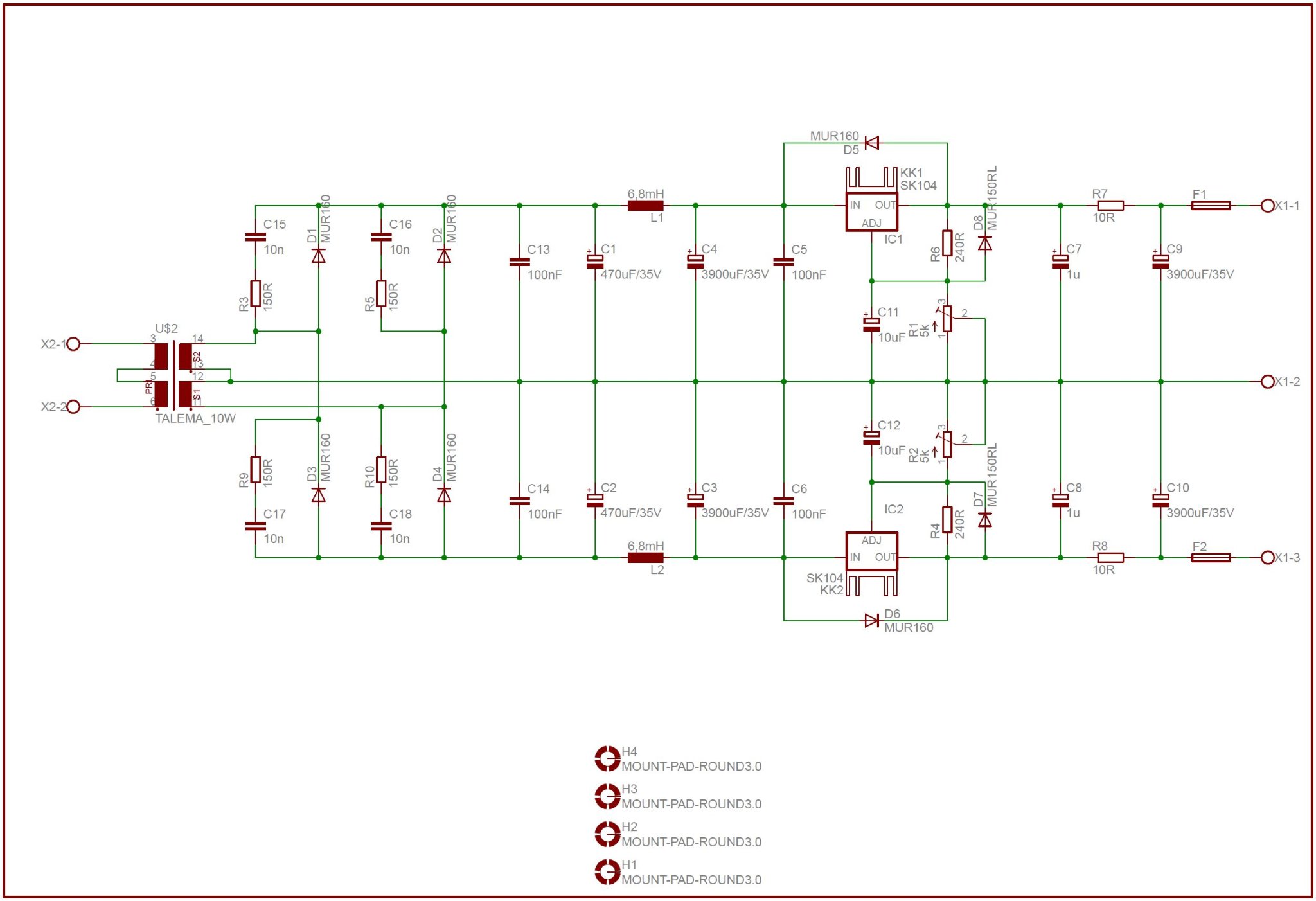

A rather common -still though at the edge of overkill- supply schem is attached also.
A small toroid, followed by discrete, denoised low trr rectifier diodes and a CLC smoothing stage.
Regs are the proverbial LM317/337, followed by a CRC filter.

INA103 has significant current noise, 2pA/√Hz compared to 0.4pA/√Hz for NE5534A, and used differentially that makes it upto 17dB noisier at high frequencies for a MM cartridge than a straightforward single-ended NE5534A circuit... Fine for MC, not a good choice for MM though in my book.
INA163 is better in that sense; about the same noise voltage specs, but only 0.8 pA/√Hz typical.
For some reason, the typical noise current specification for the INA103 is much higher than the shot noise of its input bias current, even though it doesn't seem to have bias current compensation.
For the INA163, that 0.8 pA/√Hz typical is simply the shot noise belonging to its 2 uA input bias current. Chances are it gets √2 times better with a balanced source.
I think INA163 is a good compromise for an amplifier that has to support both MM and MC without switching input stages, if you don't want to use big JFETs.
MM: RIAA- and A-weighted source impedance about 12 kohm, so 0.8 pA/√Hz has as much impact as 9.6 nV/√Hz. The voltage noise is negligible compared to that.
MC: very low impedance, so only the 1 nV/√Hz voltage noise matters.
MM cartridges produce about 10 times more signal voltage than MC, so the signal-to-noise ratios are about equal.
If you think that compromize is worth it - a ZTX951 MC stage plus NE5534A MM/RIAA stage takes a lot to beat and are actually significantly cheaper than INA103/INA163 and are available through-hole too which matters to some people.
Also having separate MC stage allows more reasonable gain staging through the preamp so that high frequency performance isn't compromized by running out of GBP in a single high-gain stage.
It won't be terrible, but its possible to do better, cheaper, which would worry me as missing a trick.
