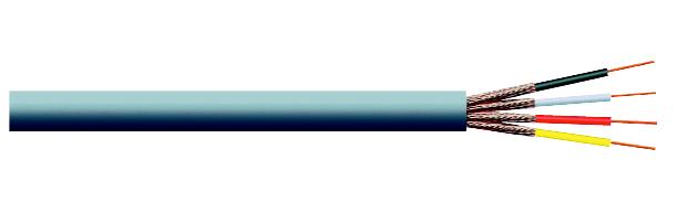

Guys,
I see emotions are running high 🙂
If I can stear the subject of discussion back to original question:
Any suggestiosn on DIY phono cable?
I undestand that MM cartridges have high inductance and impedance. All this make them very dependant on capacitance and resistance of the load.
I see that commercially available cables cost 200 $USD and up. Too expensive for me. I would like to make my own phono interconnect.
So, any suggestions on construction and parts for DIY phono interconnect?

I used to use this stuff :
4-Core Individually Screened :
A four-core screened cable having each core individually screened,
thus keeping crosstalk to a minimum. Stranded cores, 7/0·1mm
copper conductor with yellow, black, red and white polythene
insulation, lap screened and sheathed overall in grey PVC.
Overall size: 5mm
Nom. conductor area: 0·055mm2
Capacitance (core to screen): 95pF/m
Using the screen for turntable ground and the
4 cores for L+, L-, R+, R -, each pair opposite,
and twisted together after tapping the ground wire.
At the time I could find anything with lower capacitance.
Once you tap off the ground wire the remaining wires
need reinforcing with heatshrink or easier electrical tape.
Not the most exotic looking cable I'll admit.

I should explain that my assumption was the capacitances to
the screen would be in series for each pair, giving I assumed
47pF per metre for each L,R pair.
Specialised low capacitance cable is 13pF/ft, and doesn't suit
the application half as well, L- and R- have to be used for
screening purposes, you need a seperate earth and they
need to be formed into a single run.

I use standard microphone cable, the flexible type with cotton inside. Two runs, one for left one for right, with XLR connectors. Both screens connected together at the TT side only, not connection at XLR side. Separate GND wire outside the mic cable, everything tie-wrapped together. You need to have both conductors of a pair inside the same screen, otherwise the twisting is not functional. (I could not make this out 100% on sreten description, but I think his construction gives the capacitance in parallel, not series) Soldered to twisted pair made from 0.1mm laquer insulated wire used in the arm itself.
Next will be the arm wire as before, but directly to the preamp inside the base.

With further thought I don't think this is true.
At the amplifier the earth wire, R- and L- will all be joined together
on nearly all phono input circuits, so more likely 95pF / Metre.
🙂 sreten.
