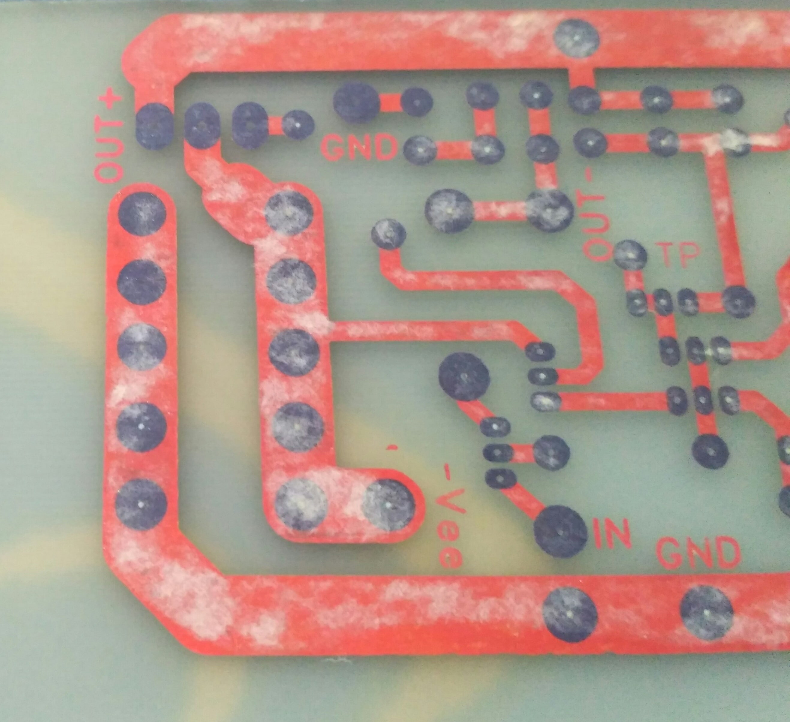

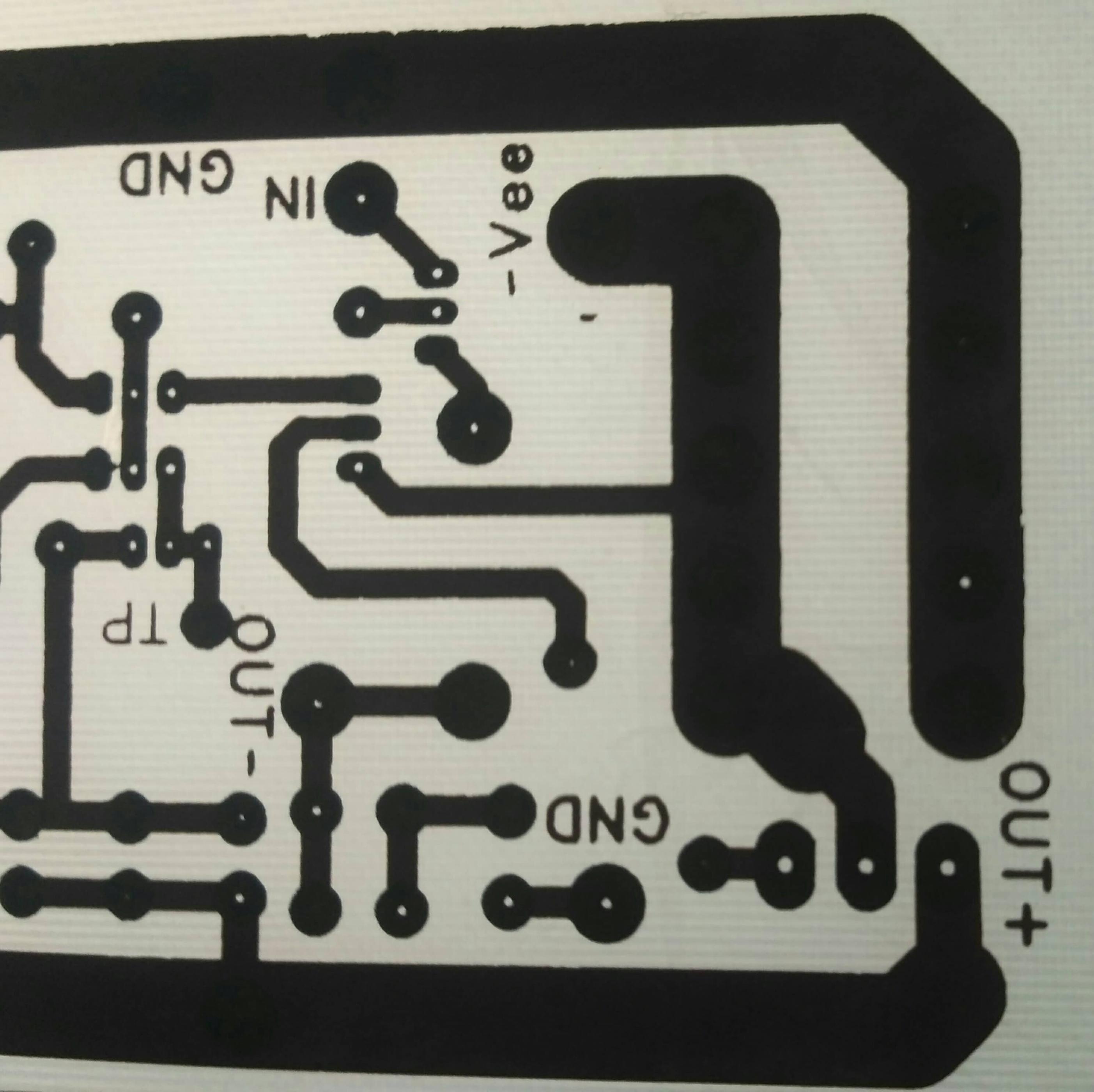

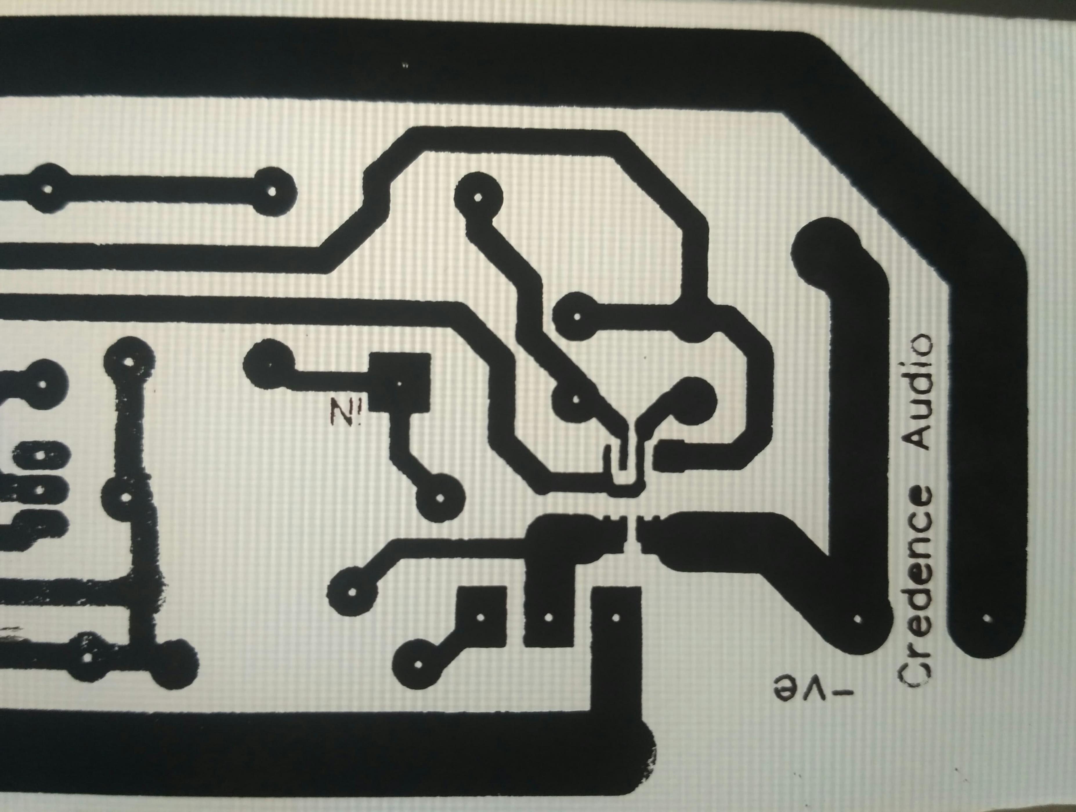

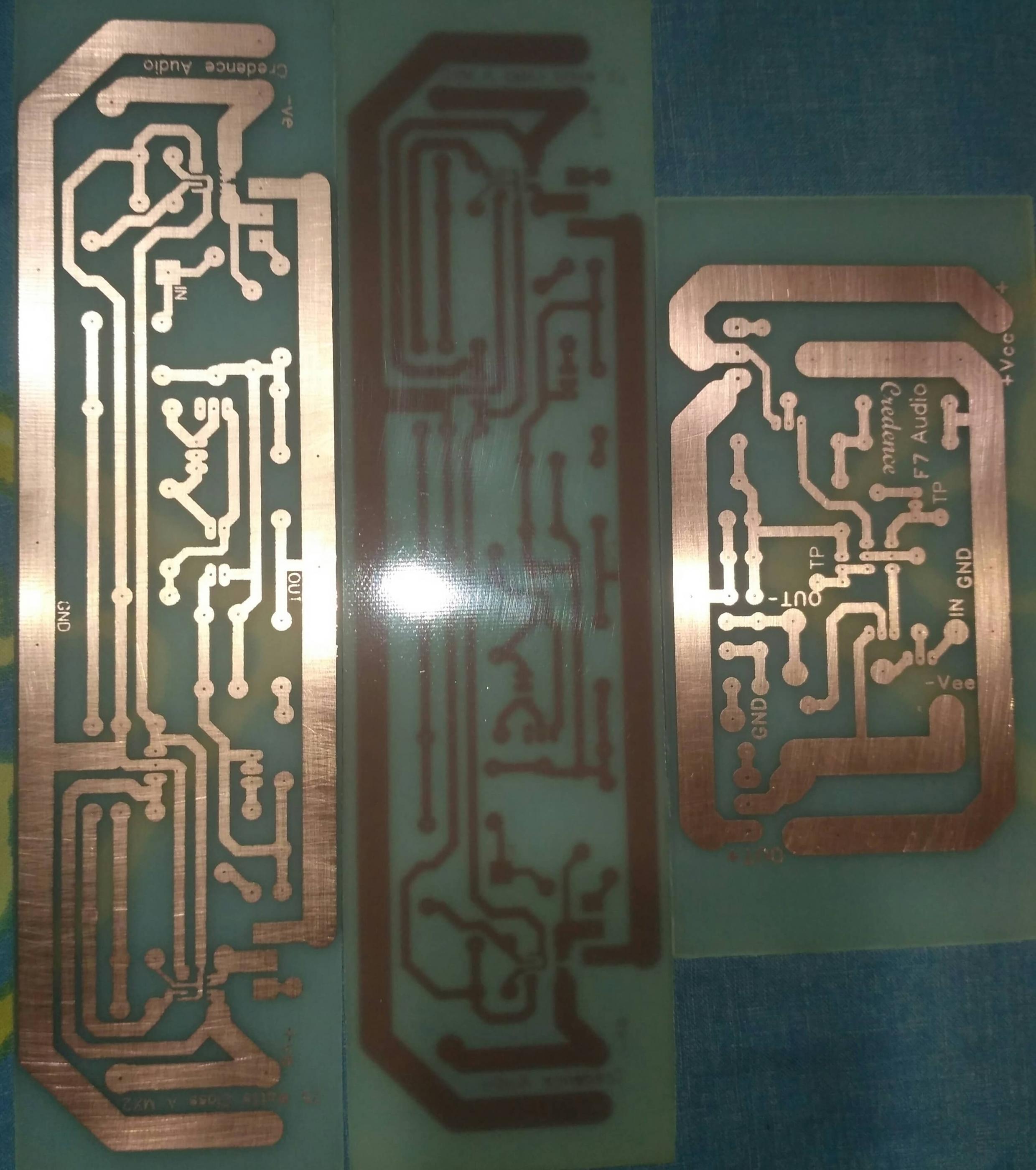

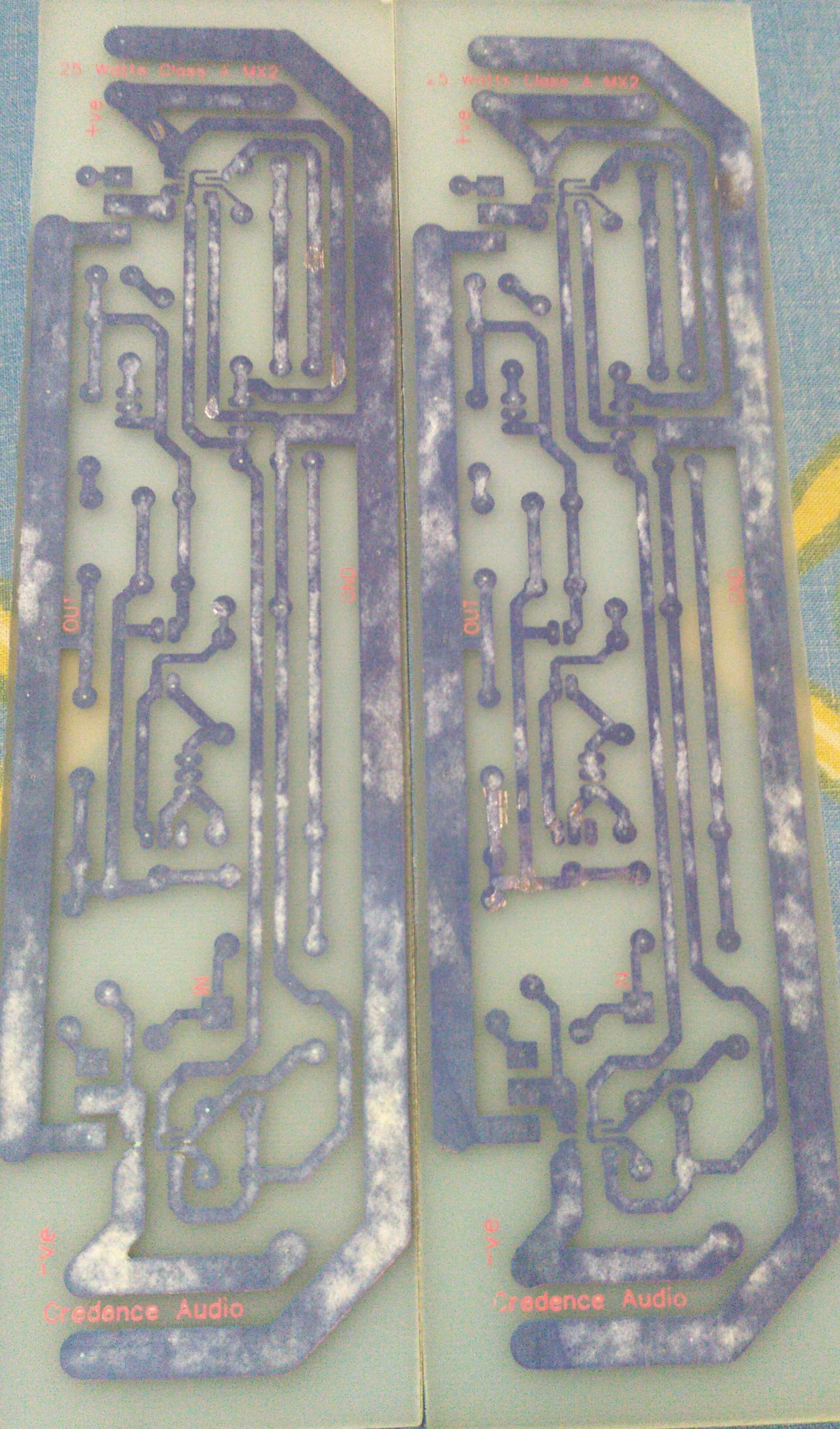

Interesting discussion on home PCB fabrication. I use DIPTRACE on Windows 10. I use a HP 1215 Color LaserJet. Found that colour prints work better than monochrome. I use the printer dialogue box, choose paper type as HP glossy 130gsm, set Color to Vivid and print.
I do the layout using manual mode in DIPTRACE, meaning I set X and Y axis grid to 0.1 inch, lay out Pads and Trace Lines as per size specified by me. I do use Pads from the Library for SMT. Use differ colors for Top and Bottom Assembly. I have done Double sided PCBs too.
The iron should not be too hot. Next time I am making a PCBs, I will measure and post temperature.
I am attaching pictures of PCBs recently done. I use NC thinner to remove the toner from PCB after etching.
Use a scrub and shampoo to prepare the copper surface. Do not allow time for oxidation. Use a paper napkin to wipe the surface clean before placing your printed artwork. Using the tip of the Hot Iron to ensure pressure and transfer of toner is important.
Here are pictures. Toner is not yet removed. After removing toner and wiping the PCB dry, I apply two layers of wood Polish to prevent oxidation before drilling.
Had to resize images.
