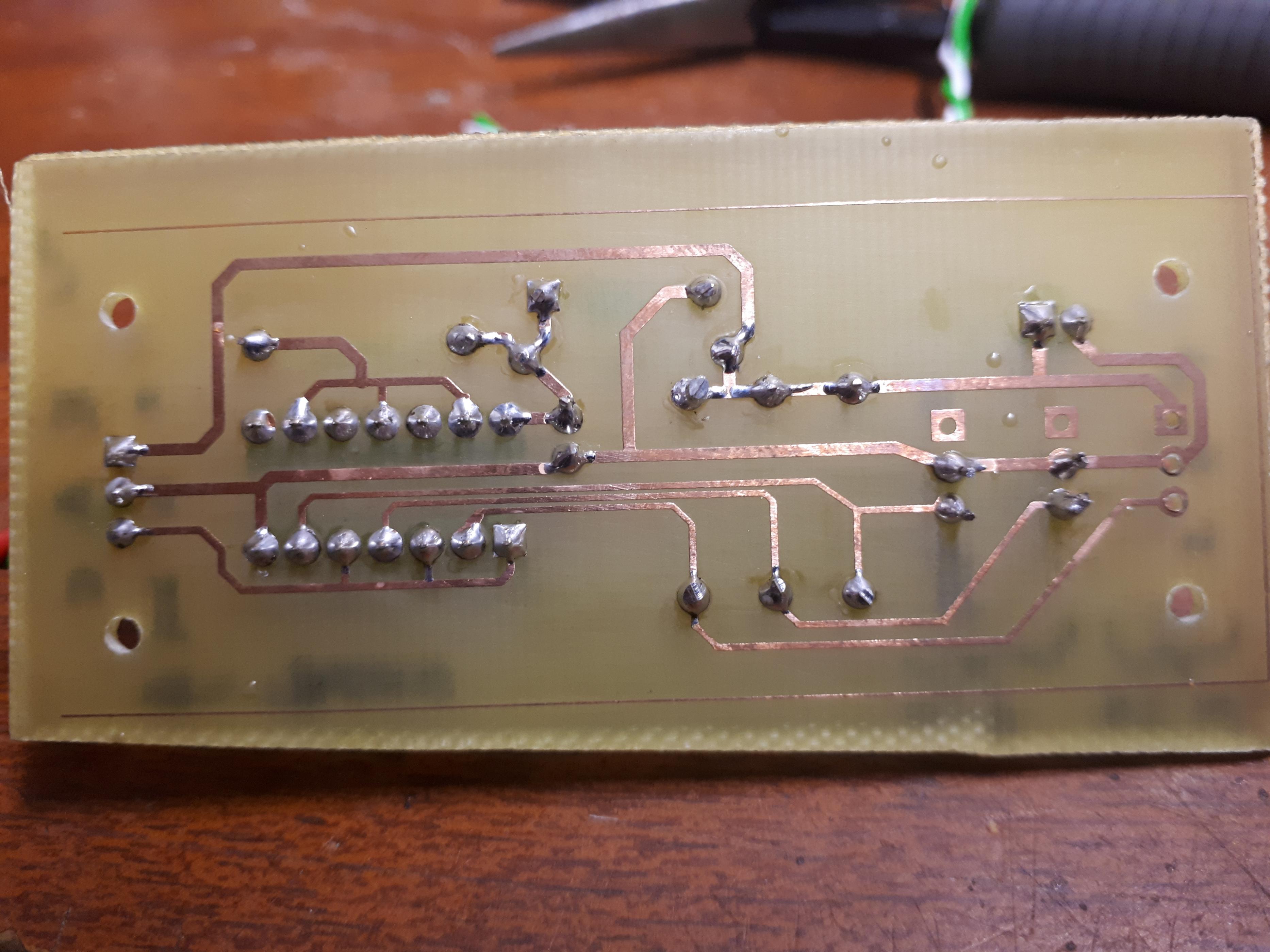

After many many attempts at trying to achieve good results with various paper and heat transfer I gave up.
However, I've just been surfing the internet and came across this ingenious and simple solution. I've yet to try it but I can't see why it shouldn't work.
I also imagine that the same technique could be used to print front and rear panels.

I've just got home from work and thought I would give that method a try.
I got almost zero toner stuck to the board.
I used the blue plastic sheets "press n peel" to do several pcbs, no probs, see www.ronlin.co.uk
a couple of tips:make sure the toner powder is "fresh" as this adhered to the pcb much better, and set the laser printer to maximize its toner output ie turn off "eco mode" etc it should print very dark, some printers just cant print solid black in over large areas.
I've had problems with them too as all of my printers, (laser, inkjet & gel transfer) do not make an image opaque enough.
I find laser printers work best, and regardless of which printer type (and corresponding transparency) I have found the same.
However the solution is simple. Use two transparency overlaid, taped together to align.
Using this method, and a suitable UV exposure box, I get near professional finish, down to trace widths of 15 thou, with CIF etch resist boards, 210 seconds exposure time.
Under Windows 10 I can't seem to alter the print quality on either my Epson InkJet or my Samsung Laser.
I am *successfully* using a cold/solvent based transfer, works very well and gave up ironing, I get perfect toner transfer, but the one you showed does NOT work, except by sheer chance, because it applies solvent to the unprinted side, it must go through toner, then fully dissolve it (or the face touching copper will be dry) or at least sneak around tracks and pads (notice he uses *narrow* tracks) and only then melt and make sticky the contact surface, a mess.After many many attempts at trying to achieve good results with various paper and heat transfer I gave up.

I´ll search and post here the method I use for prototypes (before actually comitting to silkscreening for real production) but it basically wets *copper* surface with a mix of ethyl alcohol (94% or 190 proof medicinal/grain alcohol) and a toner solvent.
They use acetone, I found it too volatile so mix % changes all the time, so I use far slower evaporation Toluene, which to boot is an excellent Toner solvent.

My laser printer doesn't seem to print solid black very well, it is a Samsung ML-1665. I haven't used it for a few years, might the toner cartridge need replacing ? It's been kept indoors.
Toner always has minor pinholes, and on an old printer even minor scratches, "fingerprints" on the drum, dust, whatever ... plus plain basic being out of toner.
That said, both ironing and solvents partially melt toner so it slightly spreads "sideways" so it fills small scratches and pinholes and in general covers better.
In fact, you´ll find in Graphic Arts shops a "Toner Blackener" spray, which actually does that, and shouldn´t be too different to the alcohol/acetone mix.
I pull the toner drum and shake it sideways a couple times to loosen old caked toner and to improve getting an even layer, if it´s real low you may have it reloaded or plain buy a new one.
My old trusty Lexmark is getting into the "letters only" duty and just bought the smallest cheapest Samsung *just* for Toner Transfer and silkscreen transparency printing duty, go figure.
