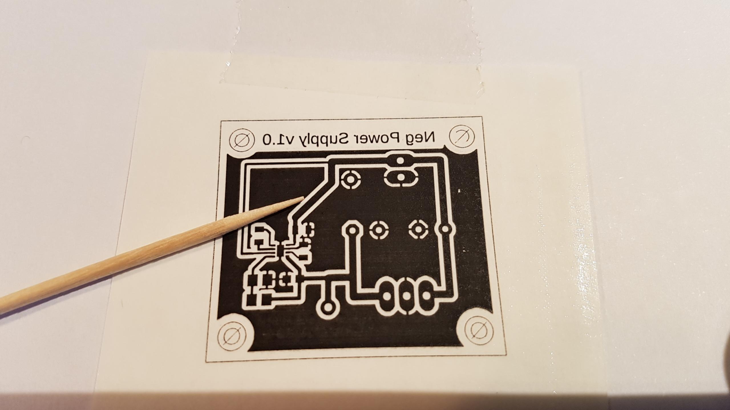

  1. The paper! What I use is the backing paper of vinyl rolls used for making signs. These rolls can be bought fairly cheaply from a hobby store carrying stuff for the Silouette Cameo (a hobby vinyl cutter) and similar. The same vinyl rolls are also used by all of the sign making shops that are available in every city. The backing paper is scrap to them, so it should be possible to get for free. If you have a roll with vinyl, cut out a part that is slightly bigger than the PCB card, remove and dispose of the vinyl and tape the paper on the center of a usual A4/legal paper with glossy side up. Standard office tape will work fine, no need for special heat resistant tape. The paper has some coating on it, it looks like vax, and is what makes this paper so special. The toner will just barely stick to the paper, and during the heat transfer process, ALL of it is released. Just peel it off and you are done!

  5. If all went well, the print should yield a dense black image of the circuit. Remember to choose the right layers and mirroring as usual to get just the traces and pads and no silkscreen etc.

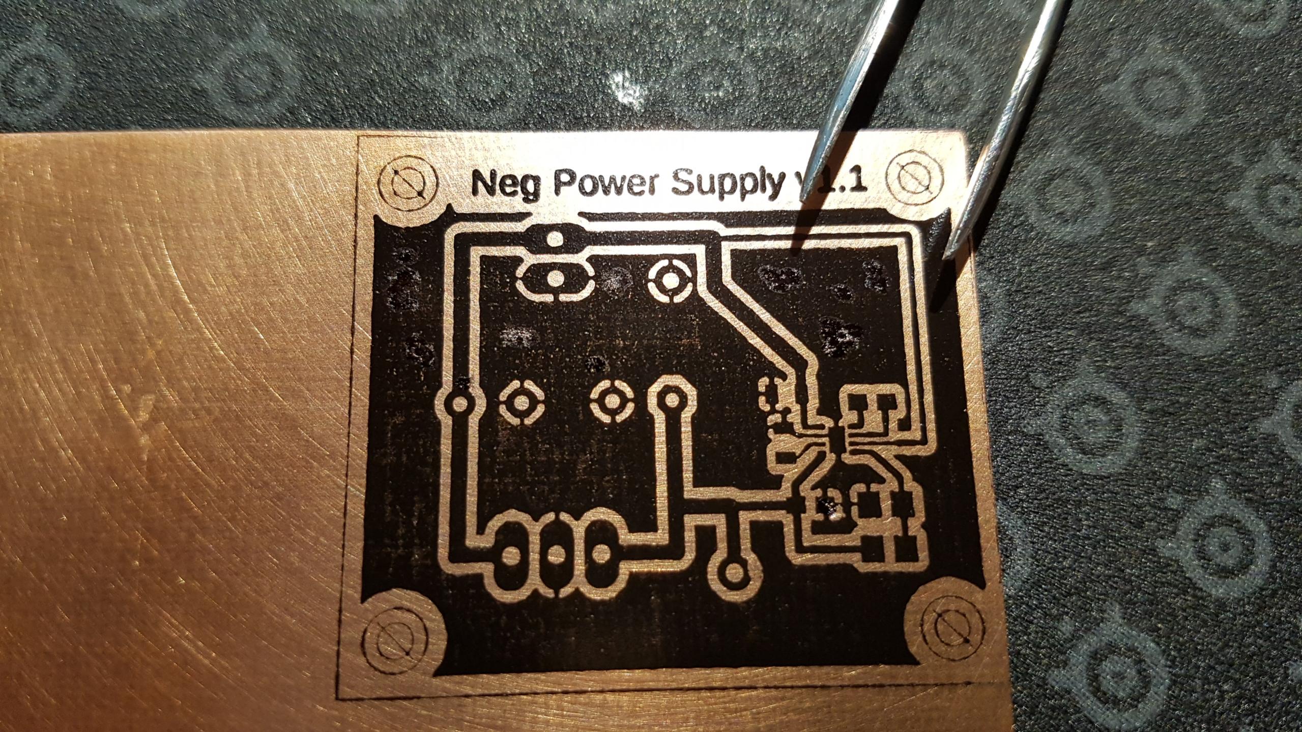

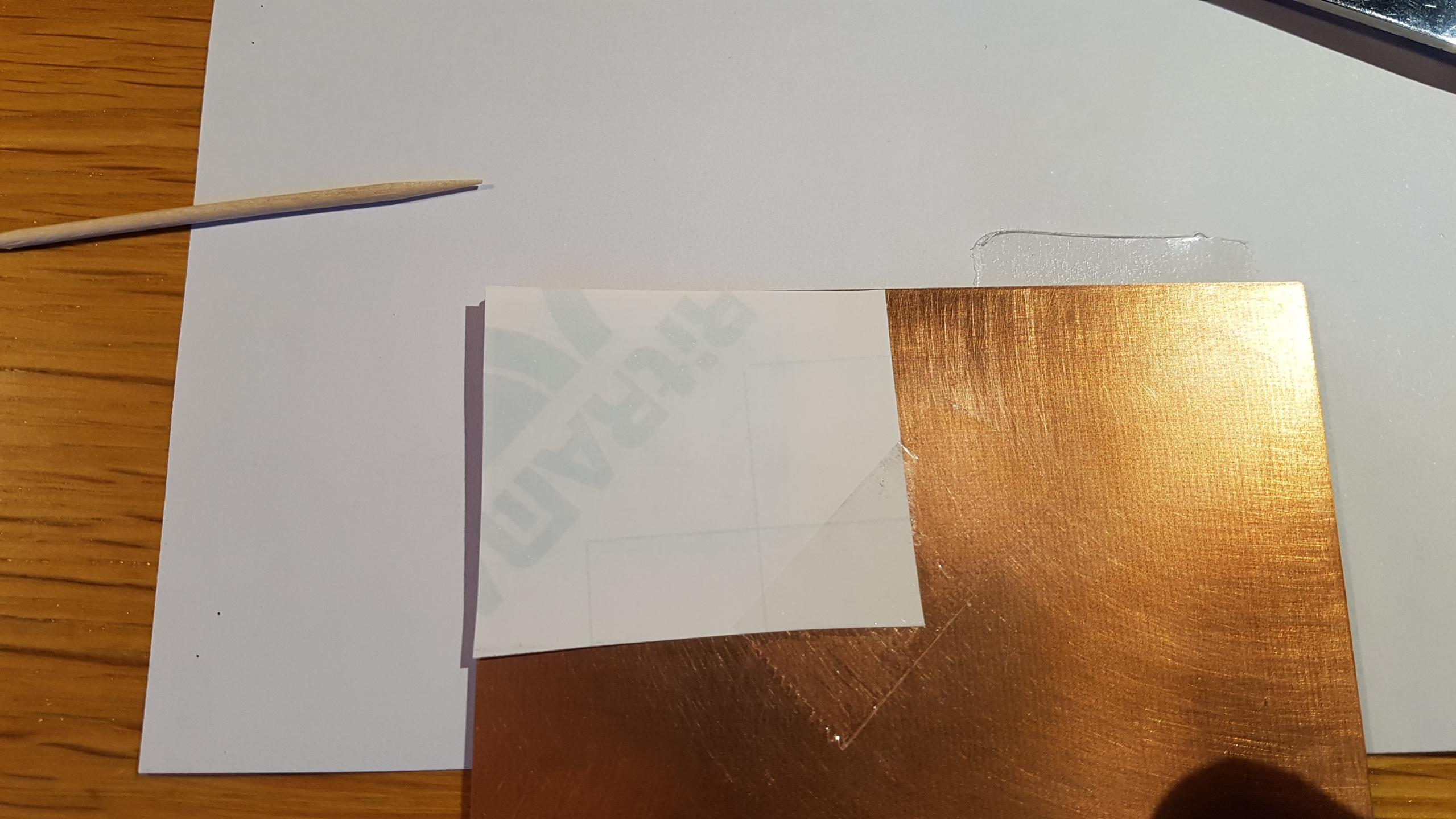

  6. Move the backing paper to a prepared pcb card with a shiny and clean copper surface as usual when doing toner transfer. Use some permanent ink to touchup any minor dropouts if any.

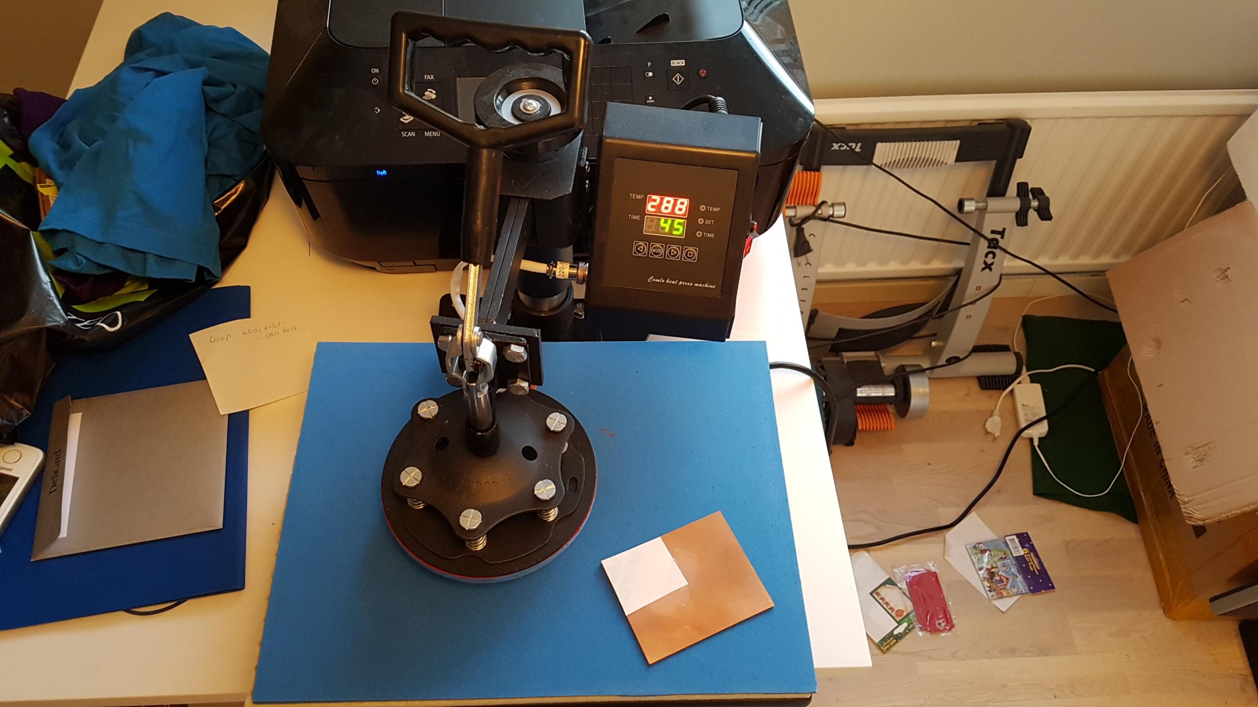

  7. For the actual heating I use a heat transfer press, that normally is used for making T-shirts with heat transfer vinyl. I have a chinese brand that came really cheap and also had a plate press. The plate press was actually perfect to use for pcbs, but the usual t-hirt press works nicely too. What this machine gives is a way to set distinct values for pressure, temp and time. What worked best for me was 50s at 285F. That made the transfer complete, and very minor smearing. To short time or low temp and the process isn't completed resulting in dropouts, to high temp or too long and the result is a bit smeared out. Actually just a (very) minor bit of smearing worked best as it the allows the toner to melt down into the copper and produce the best coverage and etching results.
    You may need to run a few tests to dial this in. In general it seems time is shorter with this paper than with standard glossy paper.
  8. Let the pcb cool a minute and then slowly peel the paper off. It should come off leaving ALL of the toner on the copper.
    NO water, NO rubbing, No paper fibres left! :)
  9. Etch as usual and clean toner off with clean acetone - it comes off really easy. Remember that acetone is bad for your skin and no good to inhale.

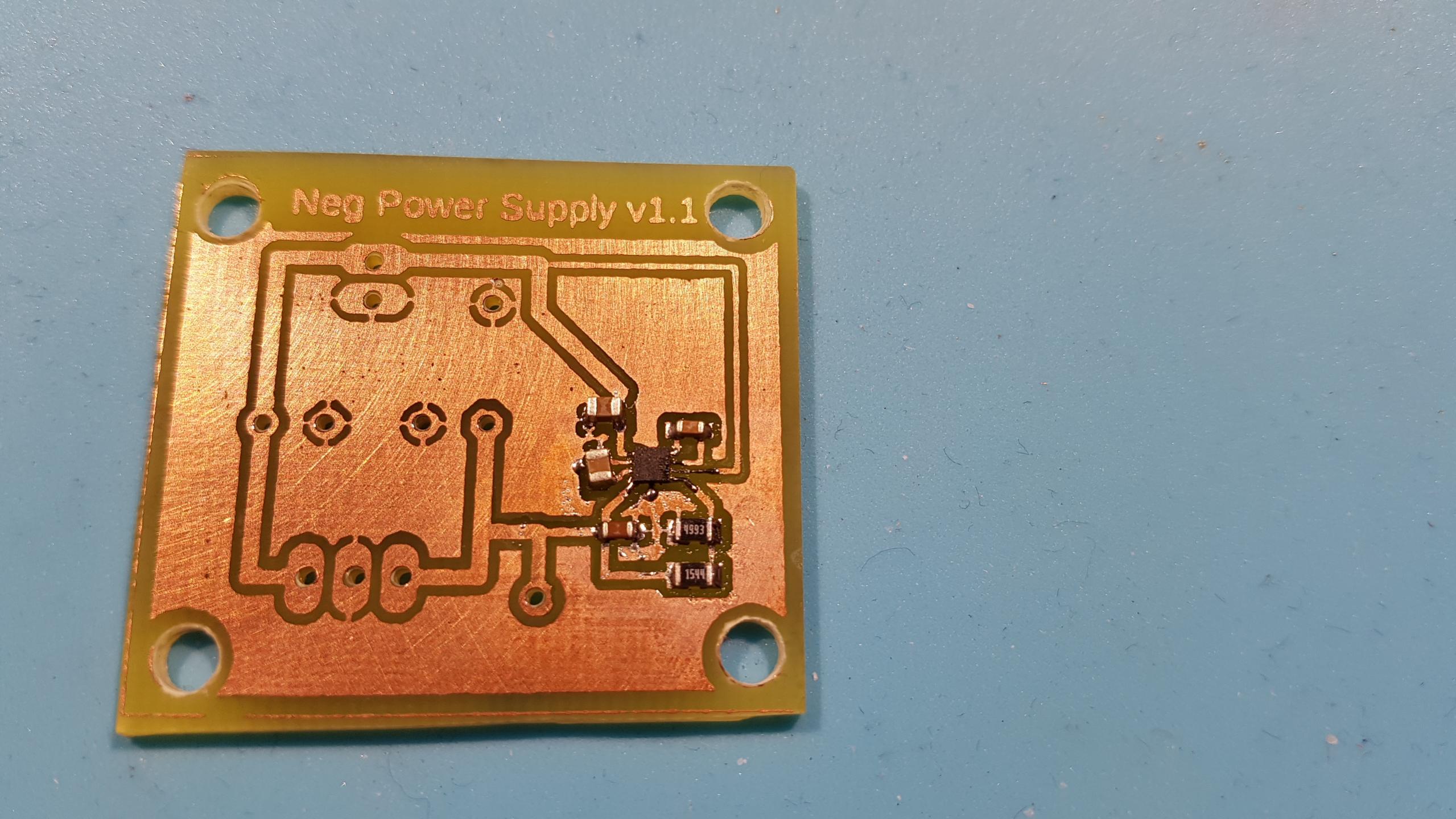

So, that is it! With this method I have produced three versions of a single-layer pcb for a WSON-8 package and some 0603 parts. The tinyest traces was 10mil, but narrower is possible! The WSON-8 is a non-lead (all eight pads underneath) part that is 2x2mm in size. Thats tiny! And, the PCB worked on my first attempt! Of course, soldering with a hot air gun and solder paste is needed here.
