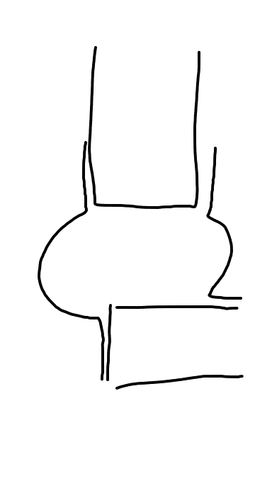

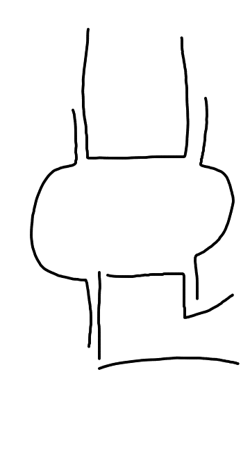

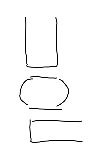

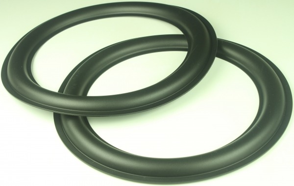

For making a big diy passive radiator I used surrounds and cut out wood from one panel.
One easy way to do it.

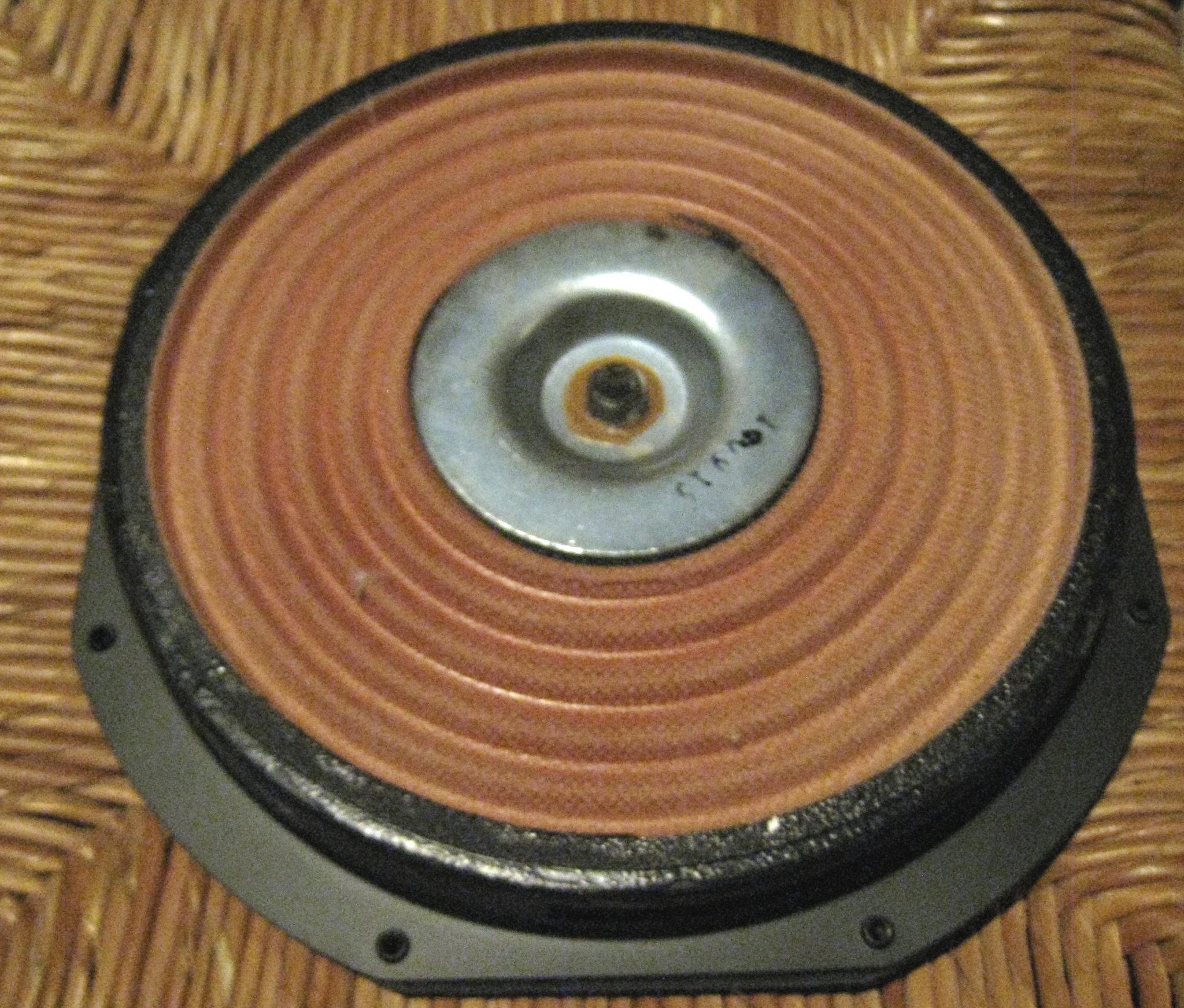

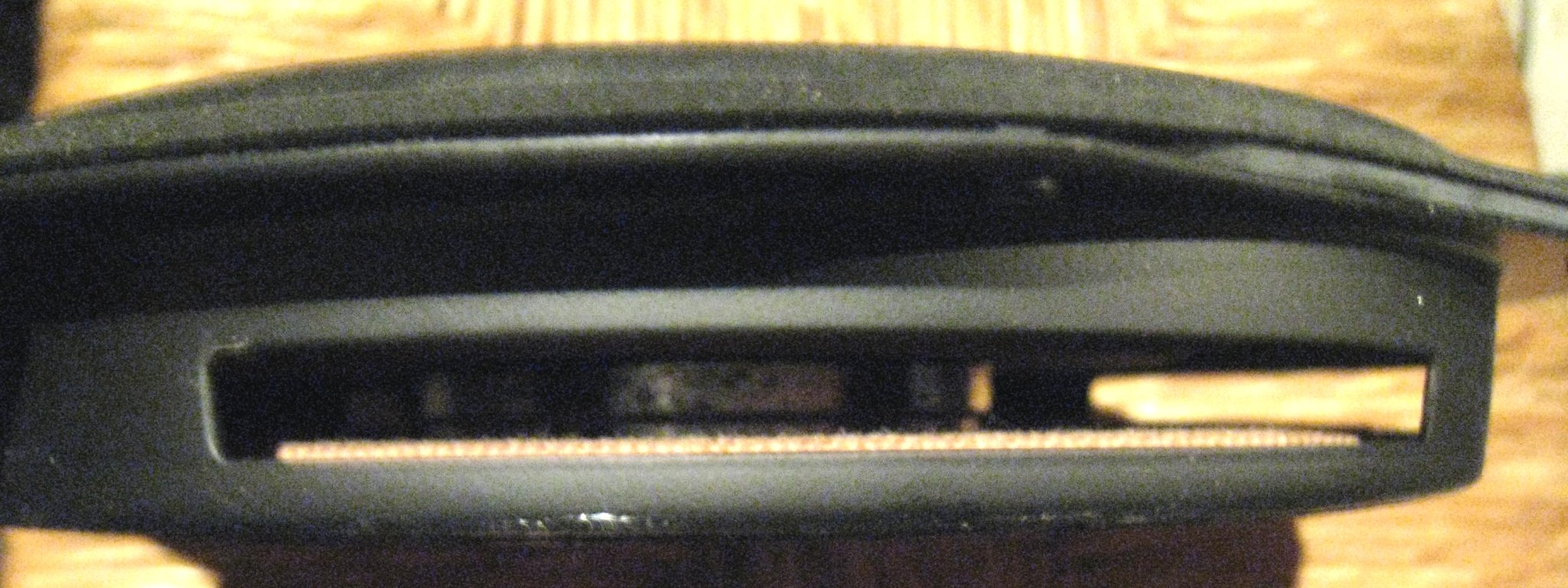

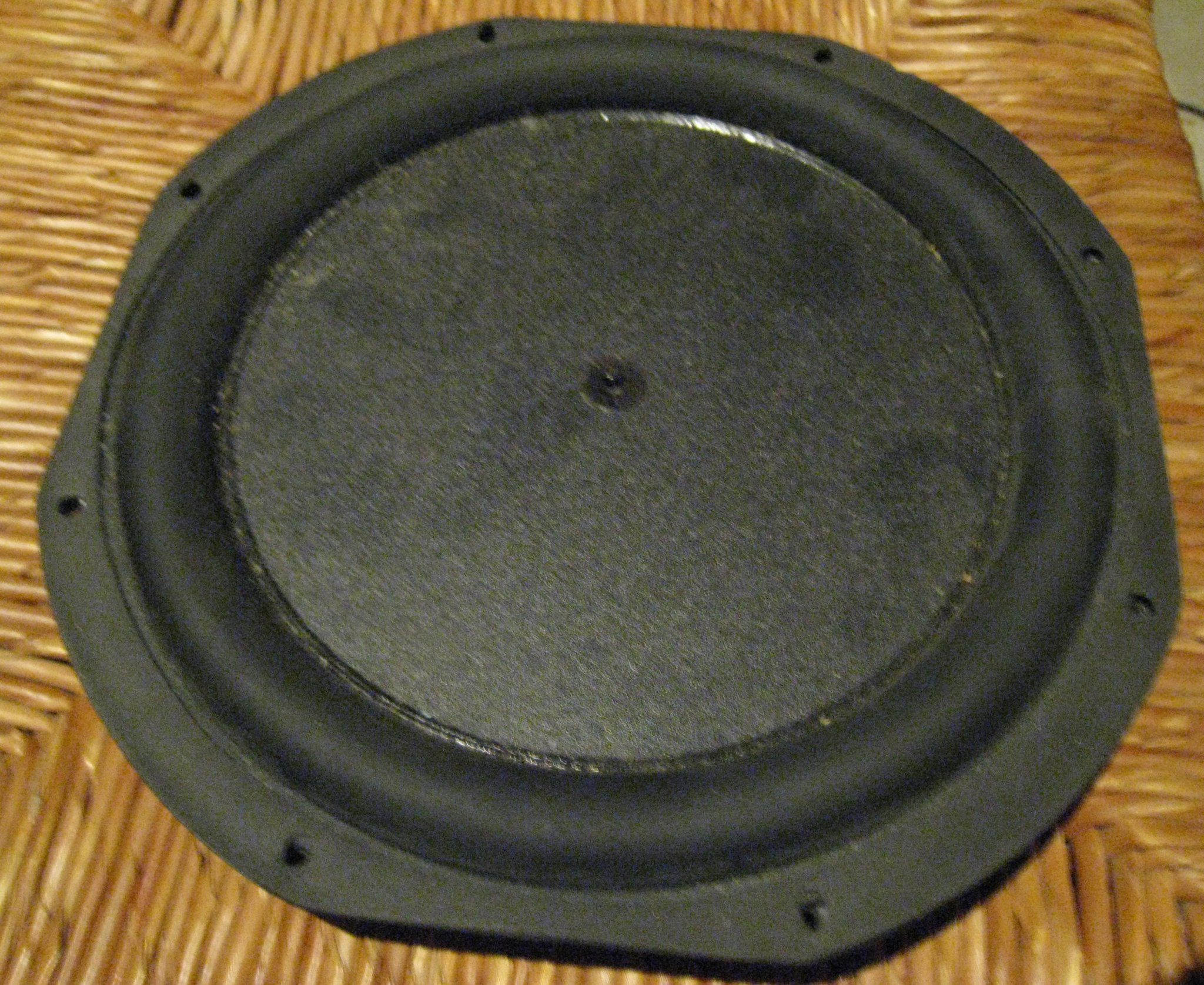

I bought someone's cube sub at a thrift store; 3 of six sides were 'cone'; one driver and two passive radiators. They look like this;
Notice how their construction forces a pistonic movement via two suspensions with a distance between. I think you'll need this, for a DIY idea to work -

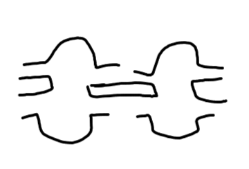

@jjasniew
Pistonic movement is better.
Passive radiators are sold which are not built like this.
Are they sounding less good?

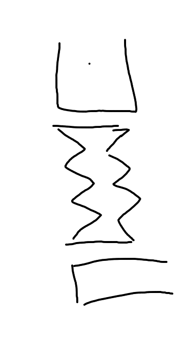

It can be that long stroke drivers need PRs which are more linear in travel.
If you have a main driver not being long stroke and big passive radiators the tumbling motion is less.
In post 2 the tumbling motion can be less with this construction.
