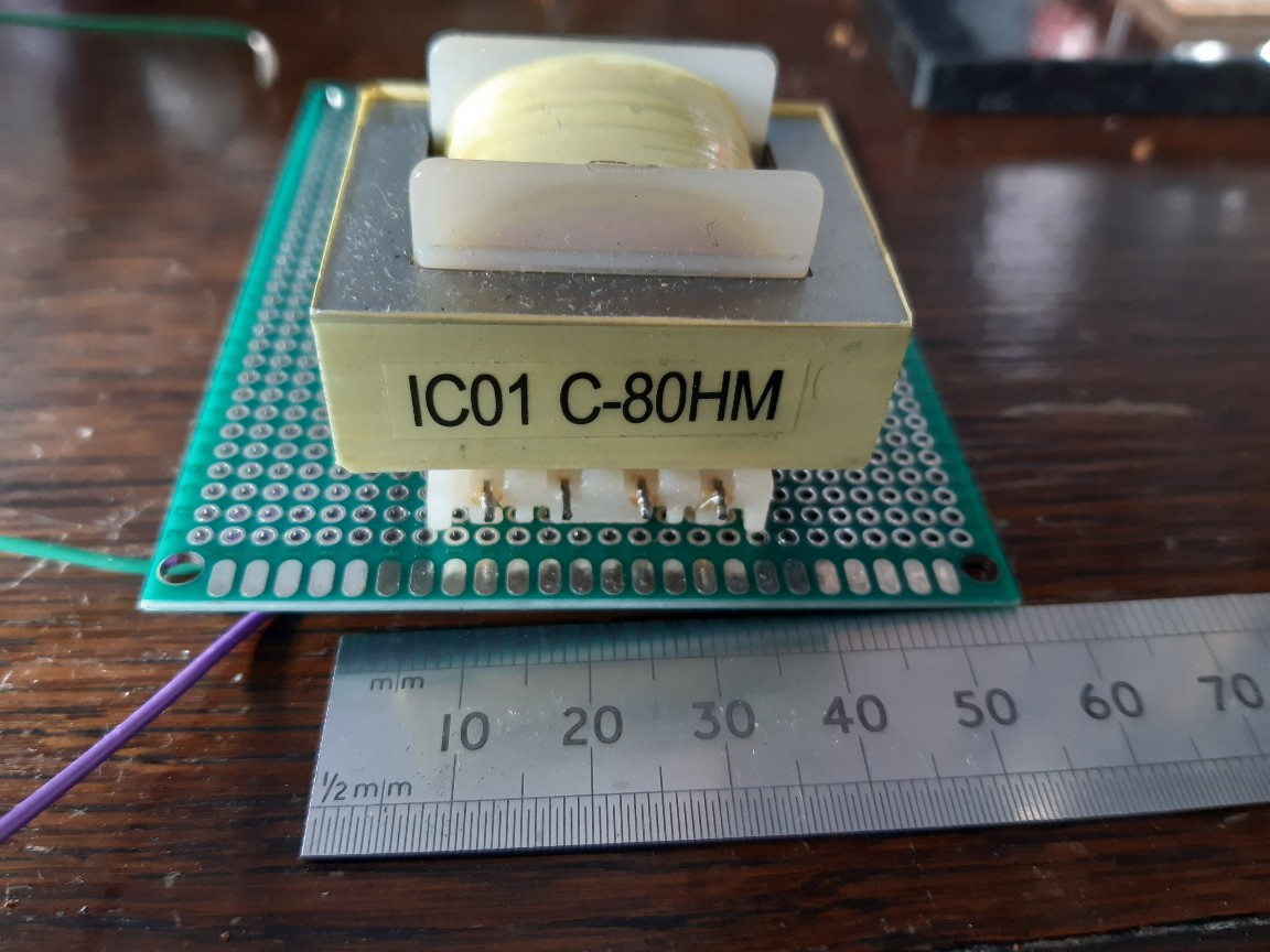

These are 100V line transformers, with a 2k:8R ratio, which would give about 8k:32R.
Photo attached.

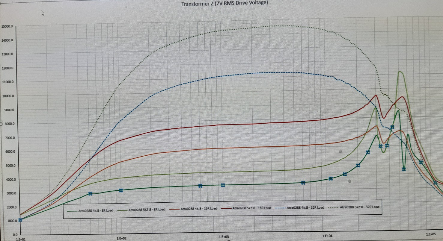

Shoog,
I am not disagreeing with your points, merely a little perplexed by my testing results, which don't seem to agree.
I have tested a 'nice' SE OPT, using 10k source impedance, and my impedance curve data is the opposite of what you have stated, or my interpretation is flawed.
The OPTs were loaded with their intended secondary load, result: huge ultrasonic resonance peaks, 2 or more.
Increasing the load R, doubling each step, and the resonance is damped more and more, until at 4 times the secondary load, the bandwidth is reduced.
Of course this may be an artifact of the particular OPT (Jan Western Atra0288), and besides I didn't test using half normal secondary load - which would increase bandwidth, and also severity of the resonances.
Nor have I ventured to try a snubber across the primary...

These things are always going to be unique to the particular transformer so your results make perfect sense in that context.
I have just personally experienced best result with toroidals when the rp is low and the secondary is heavily loaded. I have used toroidals in very suboptimal phase splitter duties up front or interstage where all their deficiencies are most apparent. Up front I only ever tamed the resonance peaks by parallelling the load with a fixed resistor - often as low as 1K. Interstage I had to use parallel 5687 to get any sort of high frequency response.
Shoog

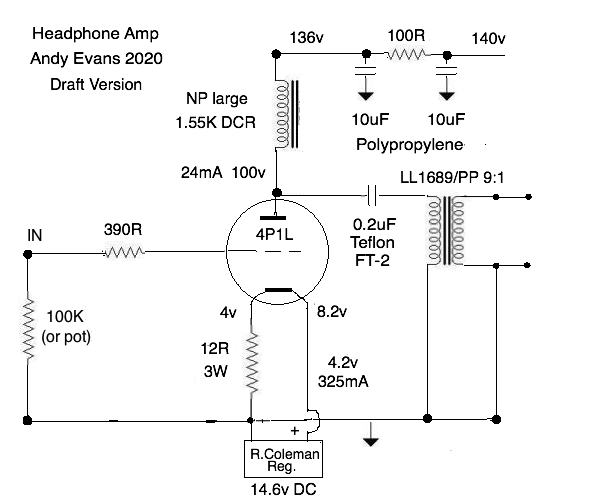

Update: I'm now on Version 3 of the parafeed designs, first being 6N30 with mains transformer output and second being 6J1P with NP amorphous plate choke and LL1689 OPT. Version 3 uses a 4P1L in filament bias with a large and OTT choke input filament supply. This is the stuff that's in my usual audio system. Kept the NP plate choke and LL1689.
Sound is pretty much there now. Clean and very detailed. The K701s are light on bass so I turned to the equaliser in iTunes, which I haven't used before. I looked at the K701 frequency response in Rtings - very useful site for headphones - and corrected it to flat as best I could, though only boosting the bass part way. Pulling the high treble down helped flatten the peakiness around 10K that seems to bedevil both headphones and microphones.
Volume is just about right. I have enough. The other improvement is putting more current through the tube. The 6J1P is rather wimpy and I was running it at 12mA. The 4P1L is running at 24mA.
I'll stay with this setup for a while. Possible changes would be SIC diode bias and using a gyrator. I want to try both but right now doing a lot of listening to my iTunes playlists. Sounds good on everything - classical, jazz and rock/electronic. Smooth and neutral. Easy to listen to and makes you forget the headphones are there, they don't seem to be in the way of the music.
