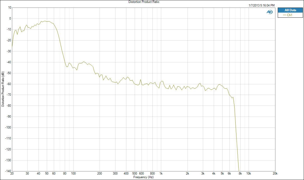

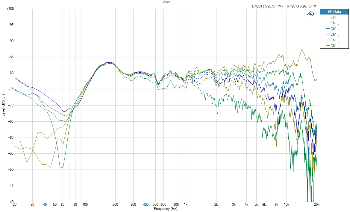

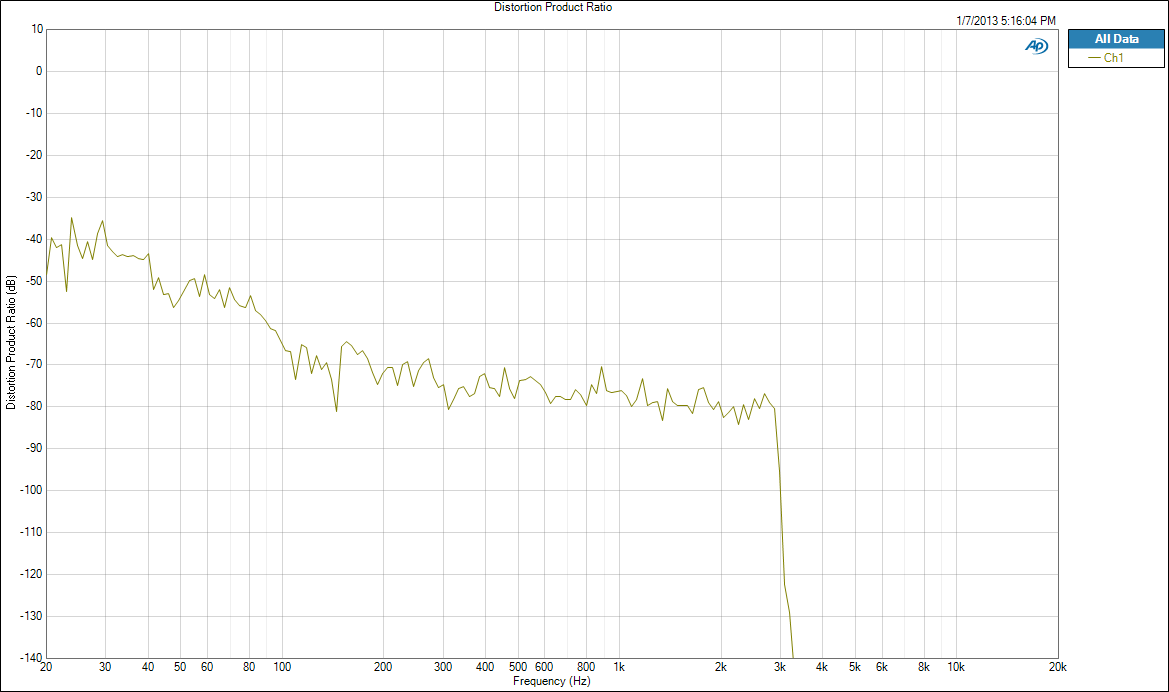

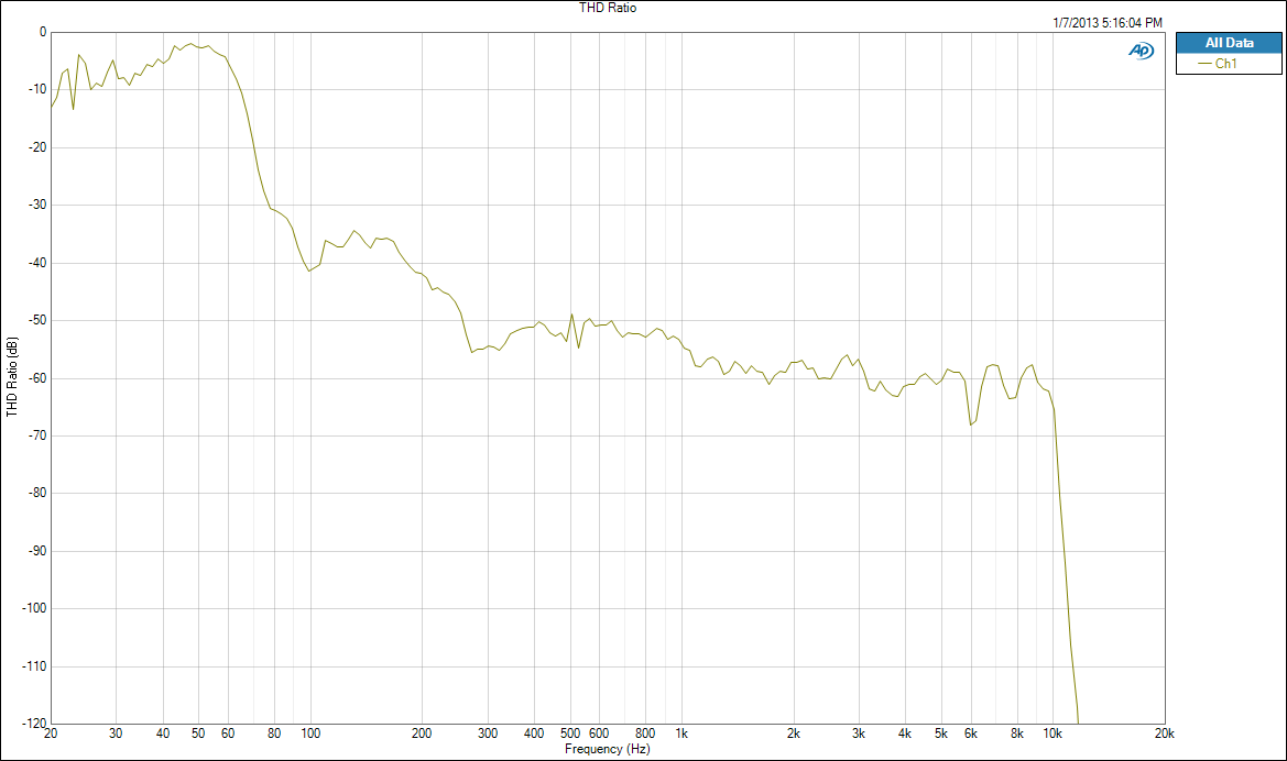

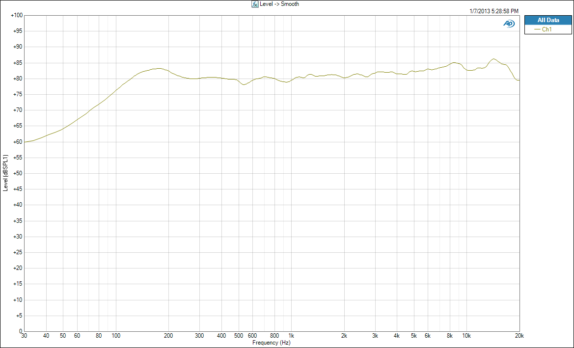

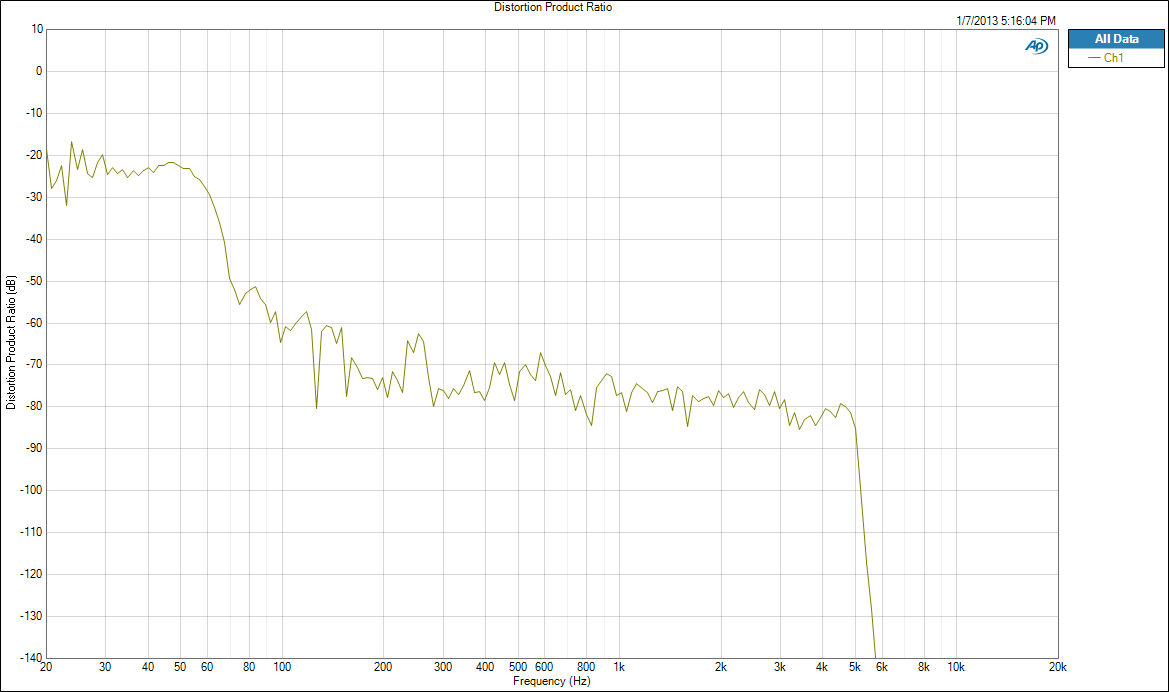

Hi David,
No apologies needed! They were not covered in any detail here, so you didn't miss anything.
The full plans, measurements, crossovers and box design are here:
http://www.vifa.de/bausatz/starter/kitPC/BVStartAirKitPC.pdf
They are all in German, but google translate makes short work of that.
I have some personal measurements done in an anechoic chamber and they are attached. All measurements are done with calibrated HW at 2.83V and 1m.
Overall, response and distortion are both excellent for such a small full range design. My only complaint would be the slightly peaking LF response, but it actually helps a little bit seeing as such a small driver doesn't do a whole lot below 100Hz.
I really like the way they sound, but unfortunately I missed the audition with these, so others here will have to comment on how they did in a much larger space 🙂
Owen
