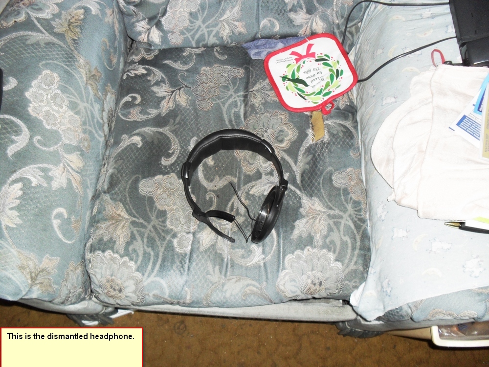

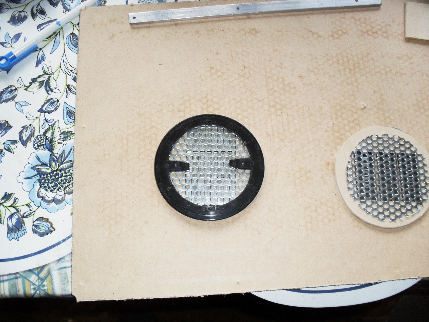

I have a pair of Technics EAH-820 and a pair of Peerless PMB-100 orthydynamic headphones. The Technics can be taken apart (I did). The diaphragm has an aluminium layer etched, which is difficult to reproduce. You can see it in this other thread:
Technics EAH-830
Also the magnets are flat ferrites with holes, and an alternating pole magnetism. There are paper spacers, and the plastic frame holds all together. The magnets are mounted in a repelling fashion against each other, so that the flux lines are parallel to the diaphragm, perpendicular to the wires.

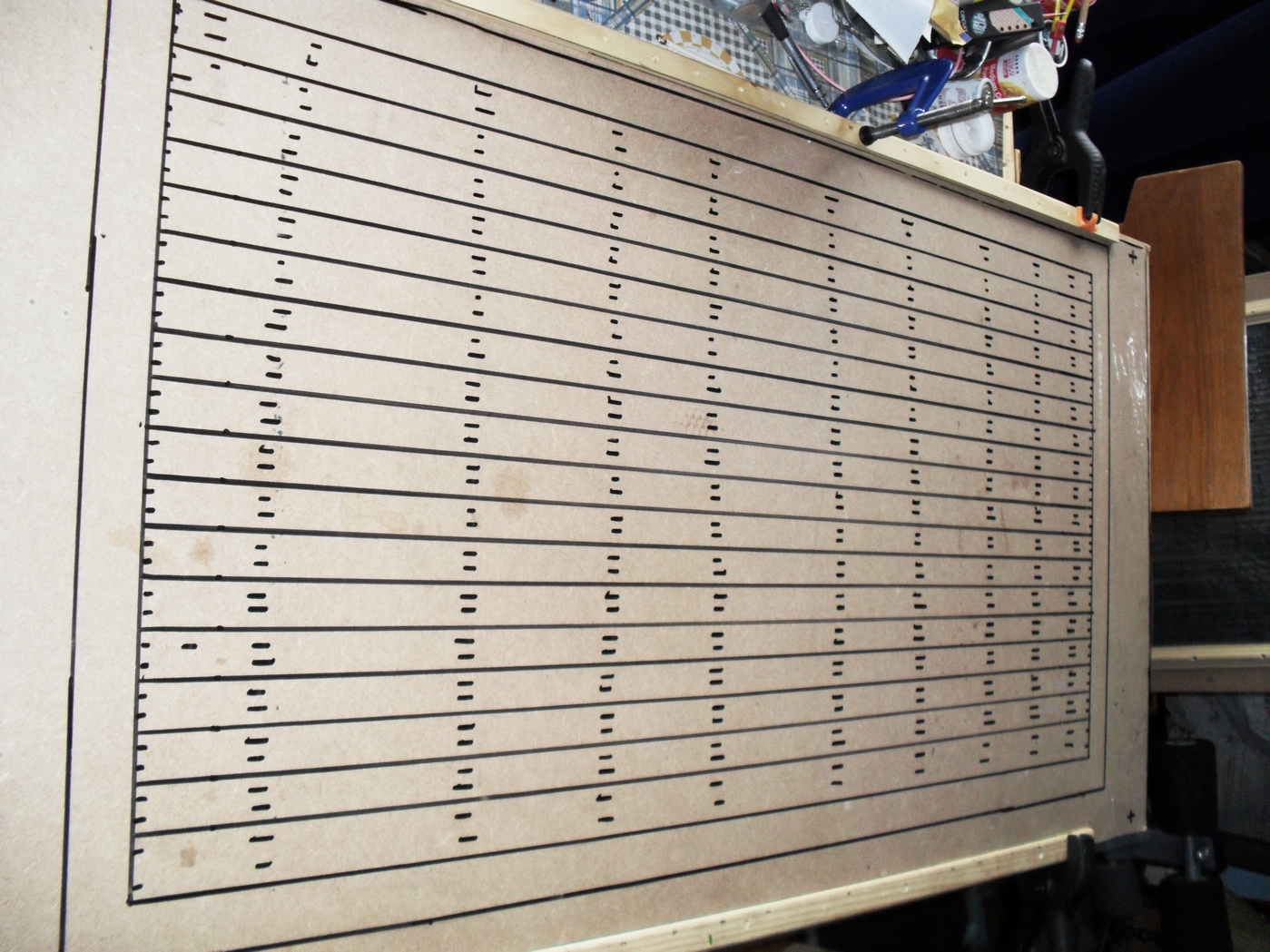

PLANAR HEADPHONES.

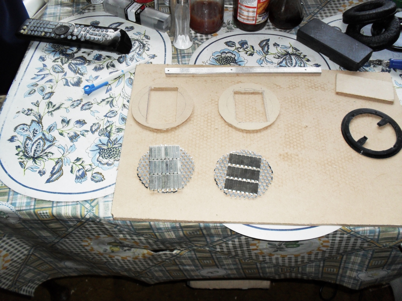

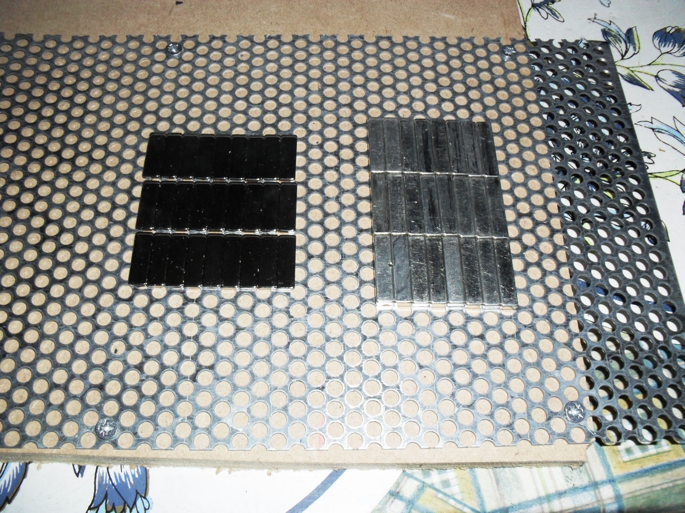

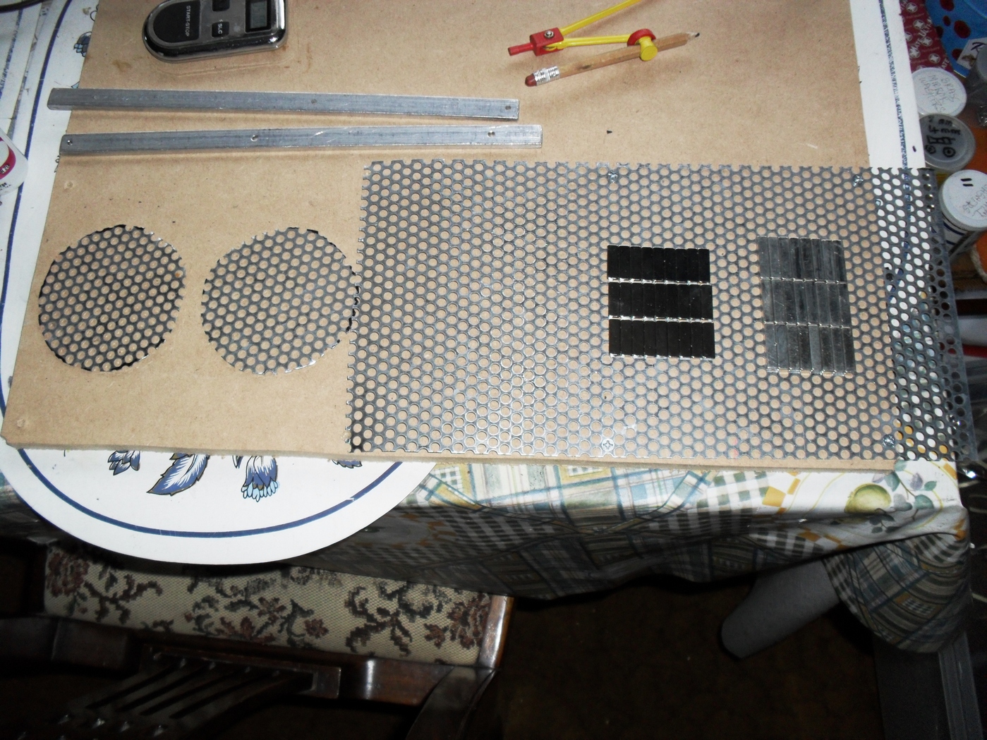

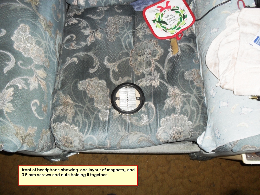

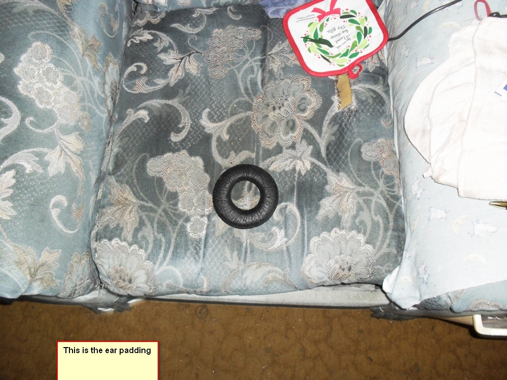

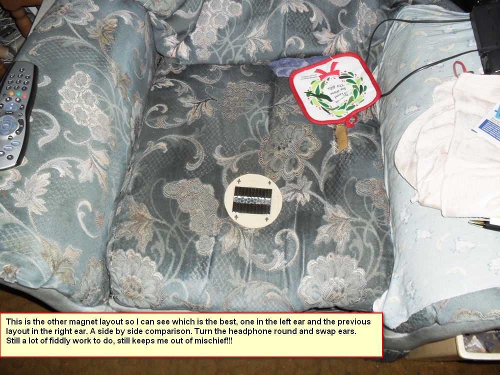

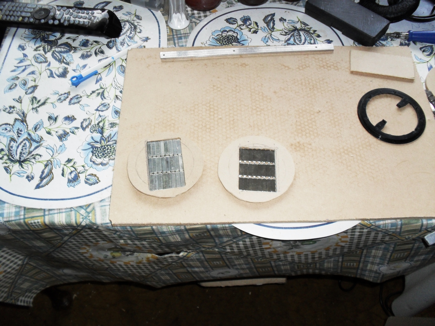

I did start a planar headphone using an old headphone I had,using 2 different magnet layouts, but got sidetracked with something else. Never finished them. See photos!

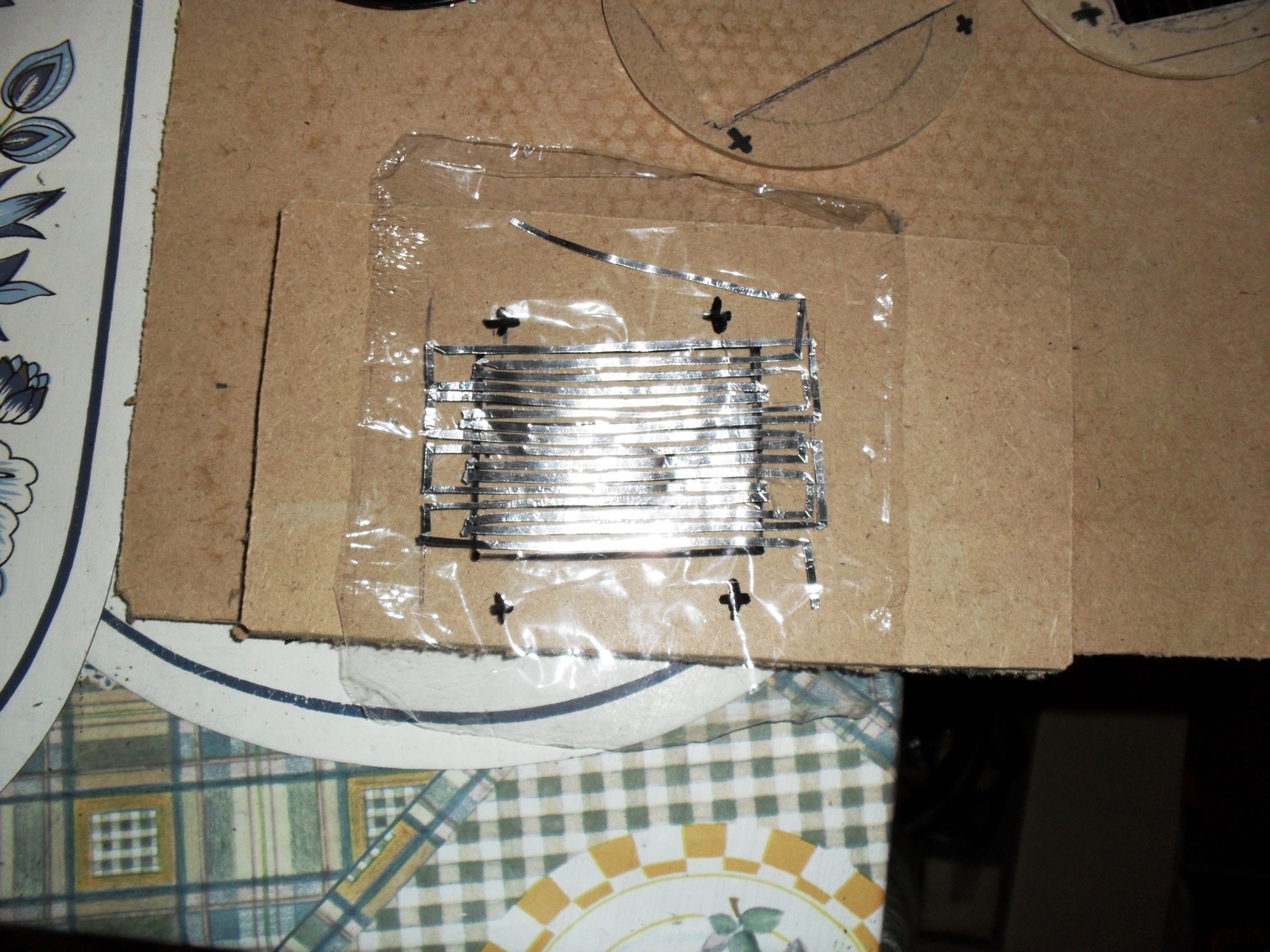

SOME MORE PHOTOS

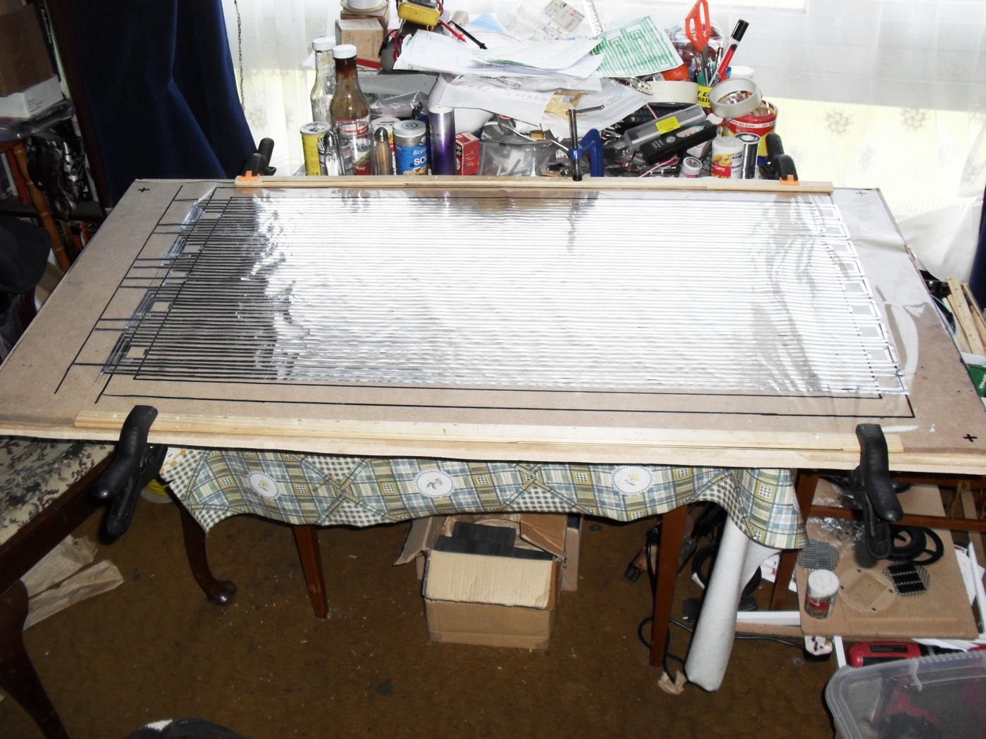

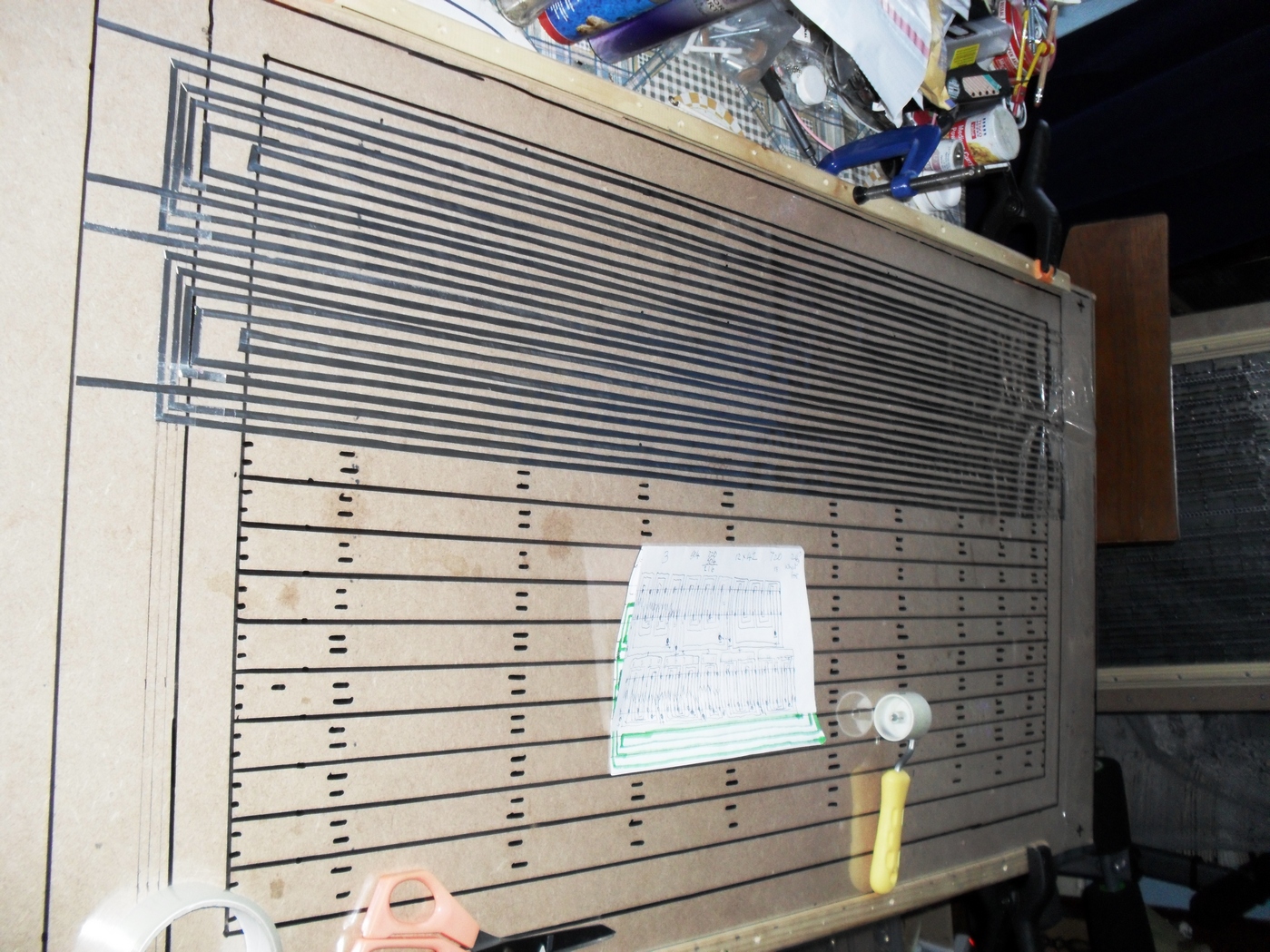

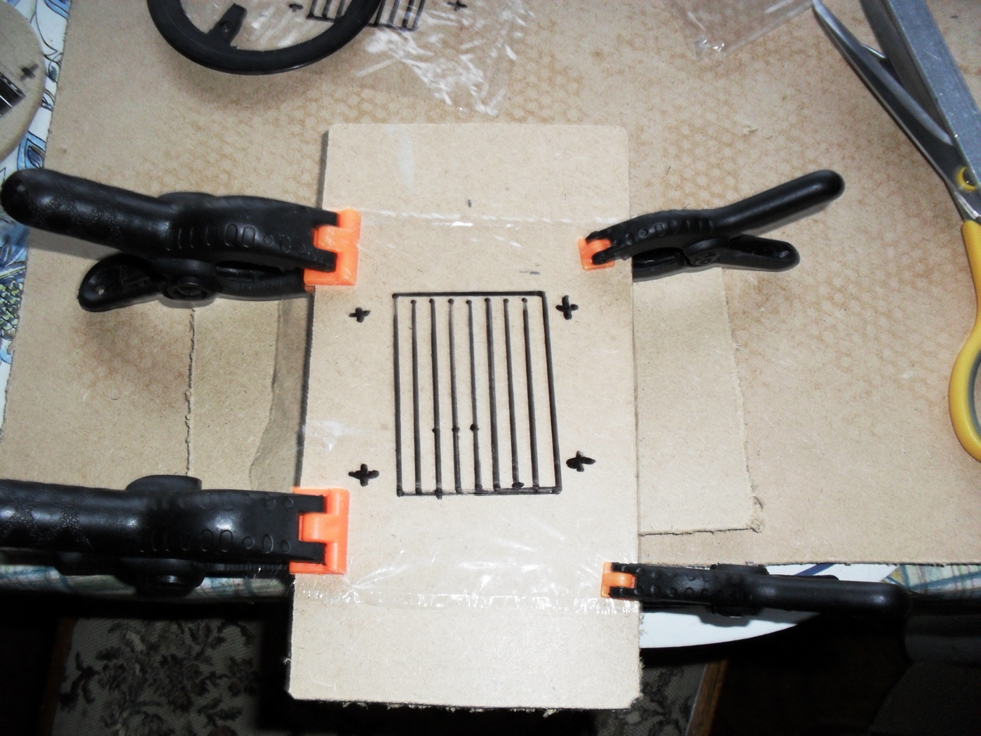

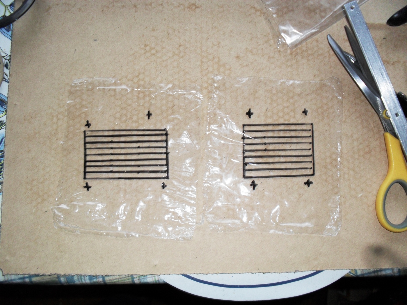

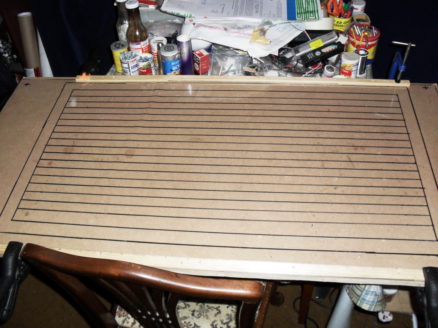

They are very fiddly to stick the foil to the thin diaphragm, especially at my age(73)!! It's easier with the full size diaphragms, although it does get harder when you use 6 um mylar!!!

Henry: That looks awesome. Got a couple questions, though. What's up with your circuit layout? I'm trying to follow it and it looks like you've got current running opposite directions in very near proximity. Also, you planned on only having magnets on the rear, correct?
Anyway, really cool and I hope you finish the project. Ear speakers like a Stax Sigma could be interesting taking this route, imo.

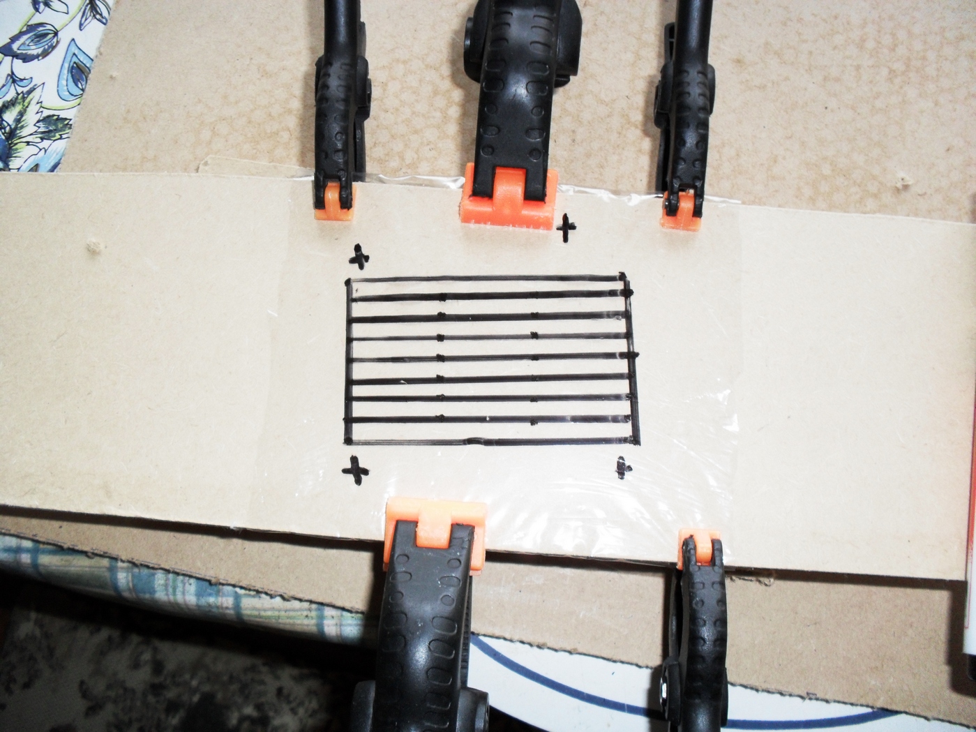

This layout is the epsilon layout, which uses the whole area of the magnets to improve control and sensitivity, the foil direction goes in groups of 3 i.e.3 up 3 down, 3 up on 1 magnet and 3 down on the next. Yes magnets on the rear only.
very interesting design, so you were going to have magnets on only 1 side of the headphones as well? also what is the foil in the diaphragm made of? and one more question, please excuse my ignorance for i'm trying to learn, but why push all of the magnets together so close? on most planar headphones i've seen the magnets are much more spaced out

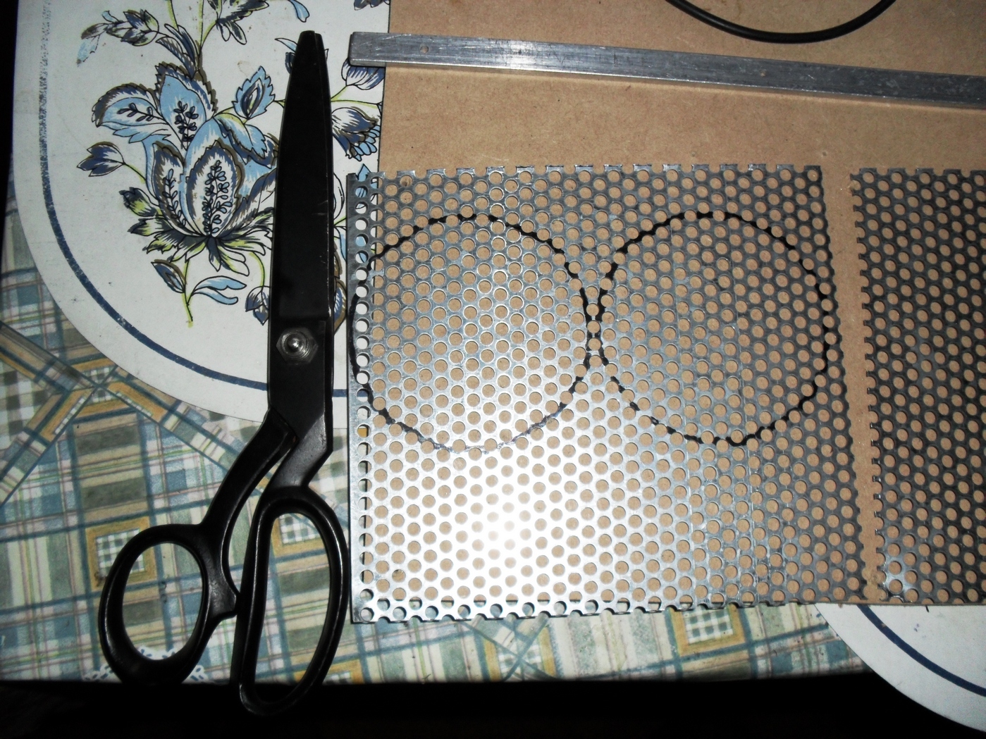

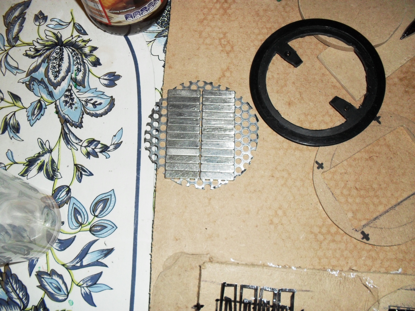

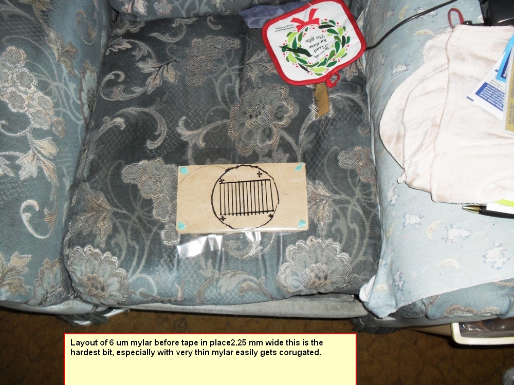

Yes only one layer, aluminium foil cut to size with scissors2.25 mm wide, started out as 9 mm wide burglar tape from CPC. Easier to place magnets on perforated steel sheet otherwise you have to glue,if you use gaps. Which I have tried on bigger planars, never again.Also you get more control and more sensitivity, especially in the bass. The bass on my planars is tighter and more solid than the bass on quad 57's and 63's, I have both and was very disappointed with the plummy and resonant bass. I would just stick the foil on mylar, as I do with all my designs, have built over 30 full range planars using foil. Done a few more rebuilds with thinner mylar (down to 6 um), and different layouts. The latest being the epsilon layout using both ferrites and neos of different widths and thickness. Started 20 years ago, and I am still learning and rebuilding. Keeps me busy and keeps my brain working.All the best.

CONTINUATION OF PLANAR HEADPHONE DESIGN

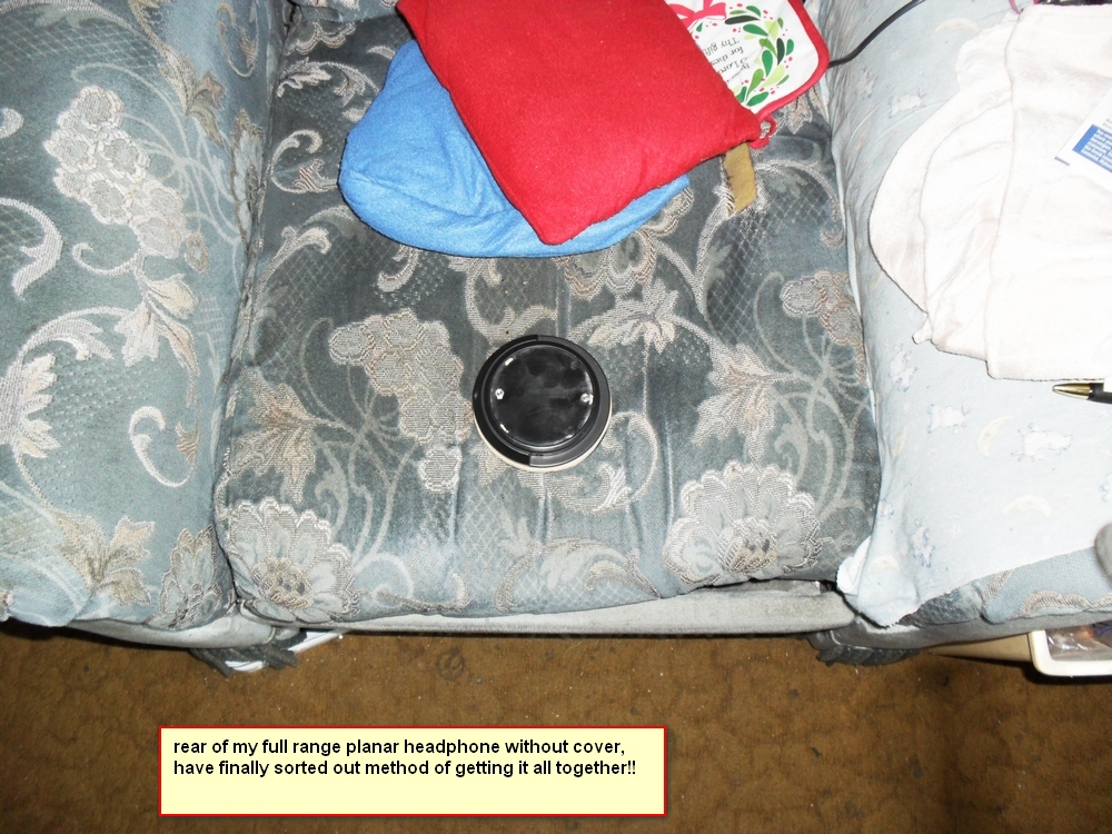

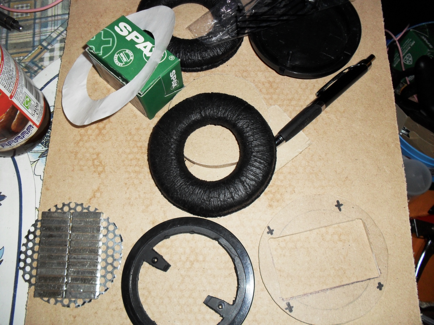

Have done some more work on the headphone I started a while back. Have sorted out method of fixing with old headphone I dismantled. So just a matter of time and enthusiasm needed to finish the project. Have to be in the mood.😀
