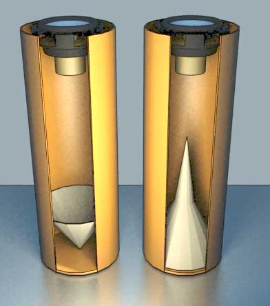

I started to work on omni speaker too. some of you are using sonotubes for enclosure. I tried it yesterday. pipe resonance causes extremely rippled response, multiple peaks in impedance curve, plus distortion is MUCH higher then one measured free air. stuffing alone can't defeat those ripples there must be some kind of diffuser on the bottom or tube. maybe something like in attached picture.

MisterTwister,
You might found the following patent of interest: link
The abstract is in English but the rest is in French. The same principle is used in the LS from Venus Acoustic in order to supress most of the problems caused by back waves. The bass reflex port shown on the pictures can be removed, but the pyramid (or the cone) marked 7 on the picture must be there according to the invention.
Etienne

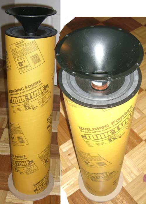

tube length is 33in, woofer is seas h511, tweeter is dayton nd28f-8 I don't know crossover frequency yet, maybe I let this woofer run full range, it's nice poly cone without break-up and listening axis is 90' and I'm making enclosure sealed.
maybe it's not a real omni speaker though, see attached.

MisterTwister said:
matejS, quater wavelength of what frequency?
resonant f = c / 4L
f = cca 100Hz
Your tube will resonate at around 100Hz. I would make tube a little but longer and set crossover point at 100Hz (or increase crossover point). Like Linkwitz did - see http://www.linkwitzlab.com/Pluto/construction.htm
Yes, you will loose LF - that's life 🙁
If you will try it, let me know how it works...
EDIT: oh, another thing, did you calculate directivity of the speaker? 6" speaker it will radiate "omni-directional" up to cca 1000Hz (to be perfect to a little less than 500Hz, but 1000Hz is acceptible, i.e. ka=2). Larger speaker (piston diameter) speaker is less omni-directional. I guess you've noticed lower sound level of high frequencies, right? 😉
