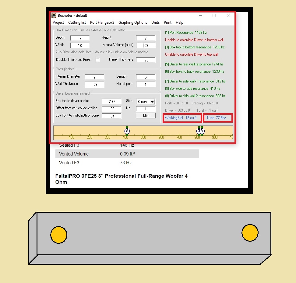

I just remembered that I've got a pair of Faital Pro's laying around.
So I'm going to probably make a box like what you see in the pic below.
It'll fit nicely in the middle of the bar counter where I usually play darts at.
Will probably make some cigarette and beer holders along its outside perimeter. hahah
This Bluetooth amp I'm considering is way overkill.
But oddly enough it's hard to find options from sellers based in the USA.
I don't feel like waiting three weeks for something to ship from China.

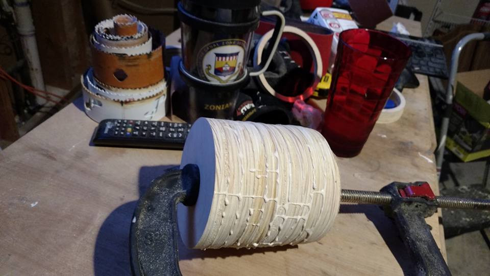

Still considering enclosure type options.
Will probably go with sealed in 6" PVC.
But I'm worried the batteries and digital amp will get too hot.
On the flip side, I'm worried about size if I go ported.

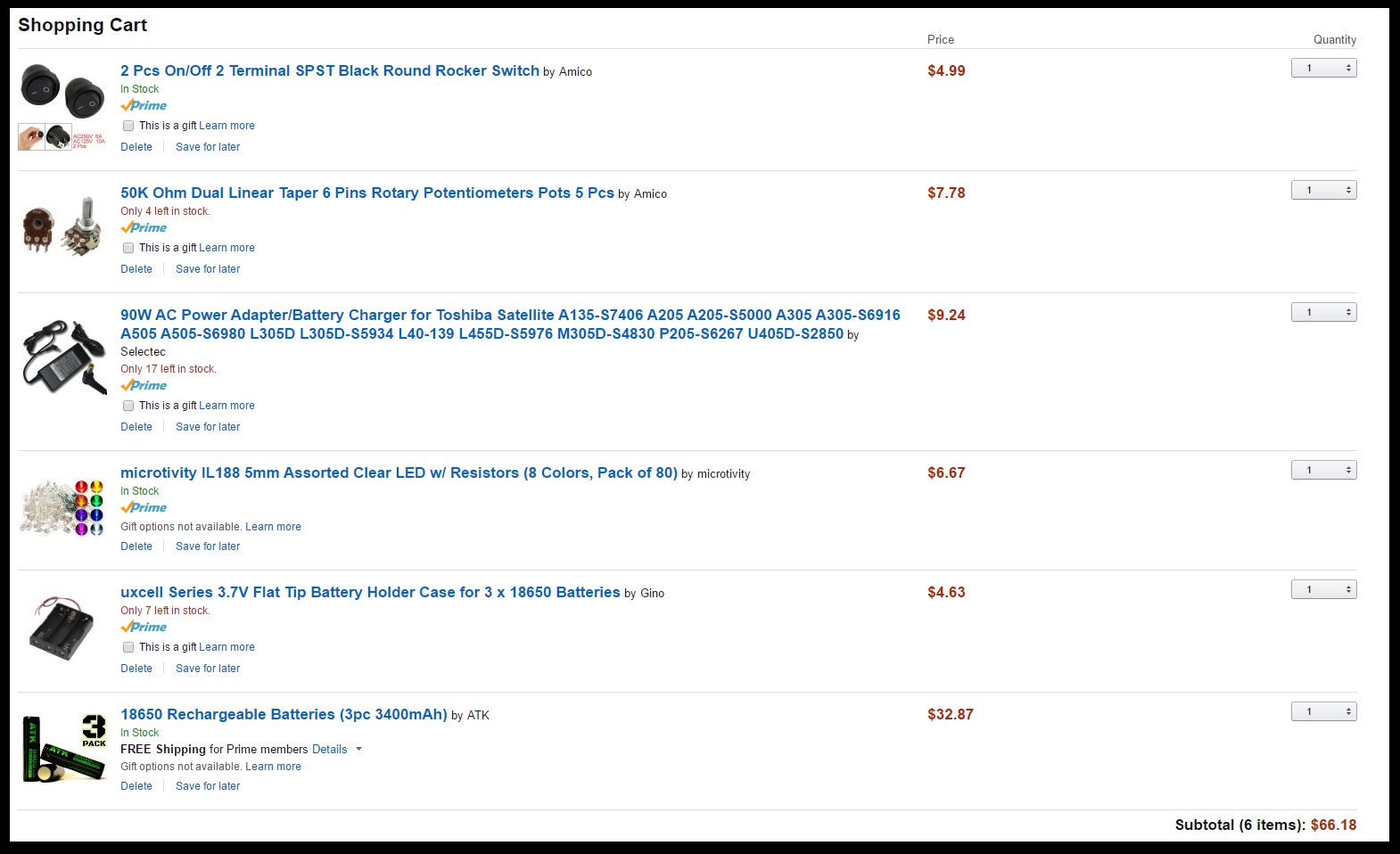

Consider the budget blown, fully blown.
Accessories from Amazon in pic below are now on the way.
Crap, I forgot to buy a volume knob though.

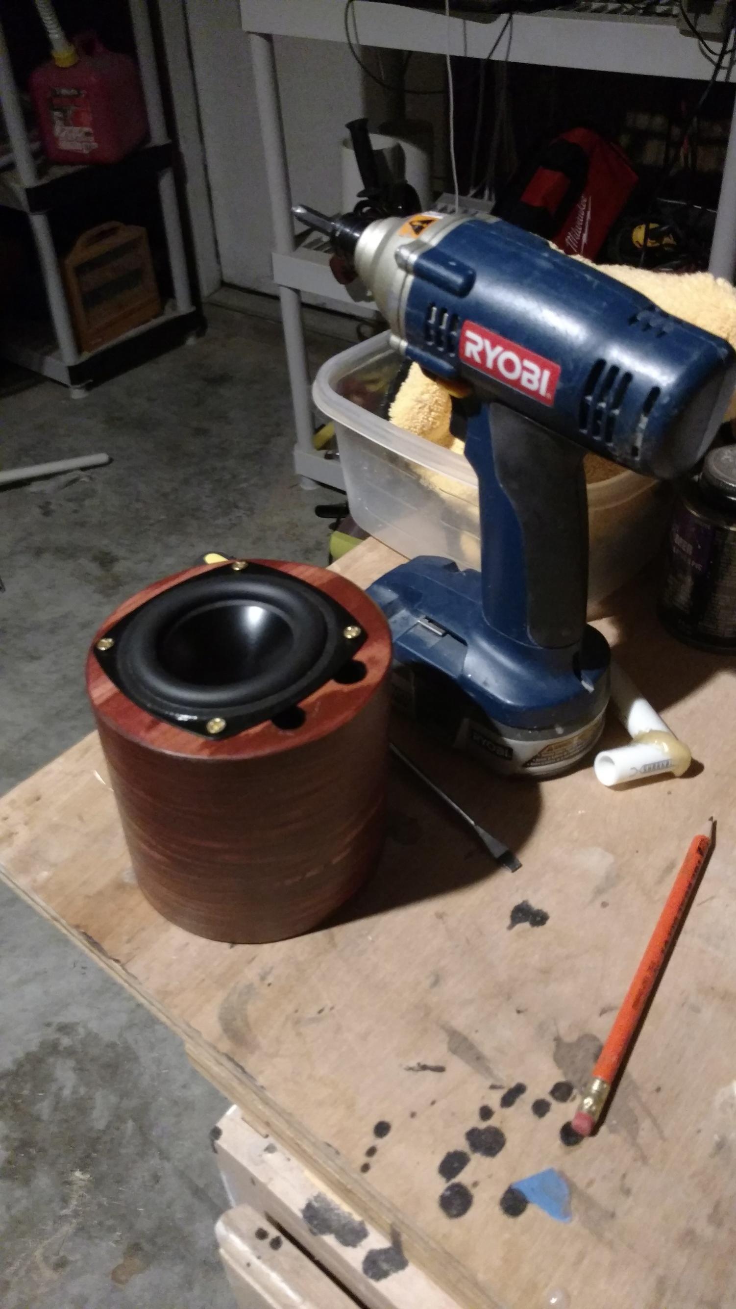

The first try was a total failure.
I messed up my dimensions somehow and ended up with an enclosure somewhere about 0.02 cu.ft. tuned to ~90hz.
Either my efforts at making the stereo Line Level signal mono or the cheapy digital amp sucked, or my use of capacitors was incorrect. More likely it was a combo of all the above, especially the enclosure size.
Bass is very congested and almost sounds like the driver is blown (it's not).
Tell you what though, it pushes some air even at 10 watts. I quickly found air escaping under the driver mounting location. Got that one leak sealed up but it all still sounds awful. 🙂
Anyways, since I'm going to build an entirely new enclosure, I was hoping someone could give me some advice on the smallest possible vented enclosure that will sound good out in an open space, down to about 80hz.
I mean, .1 cu.ft. is too large. hahah, I really need to get as close as possible to .03 cu.ft.

Right now I've upped my size to 1.5 liters (0.05 cu.ft.) tuned to 70hz.
It's larger than I want for the current purpose, but.... ugh.
Will probably start cutting holes today or tomorrow.

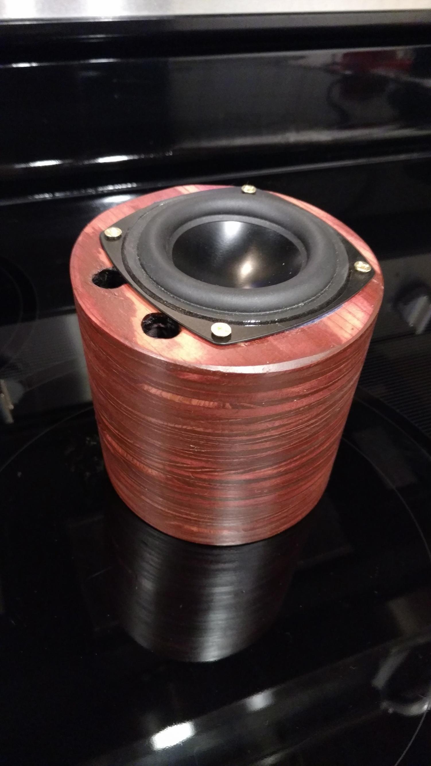

The failed build...
Yes, the port obstruction attributed to some of the failure. 🙂
Also not super happy with the stain.
I wanted a nice bright red, kind of like the old Onix Rocket speakers like you see in the third pic.
