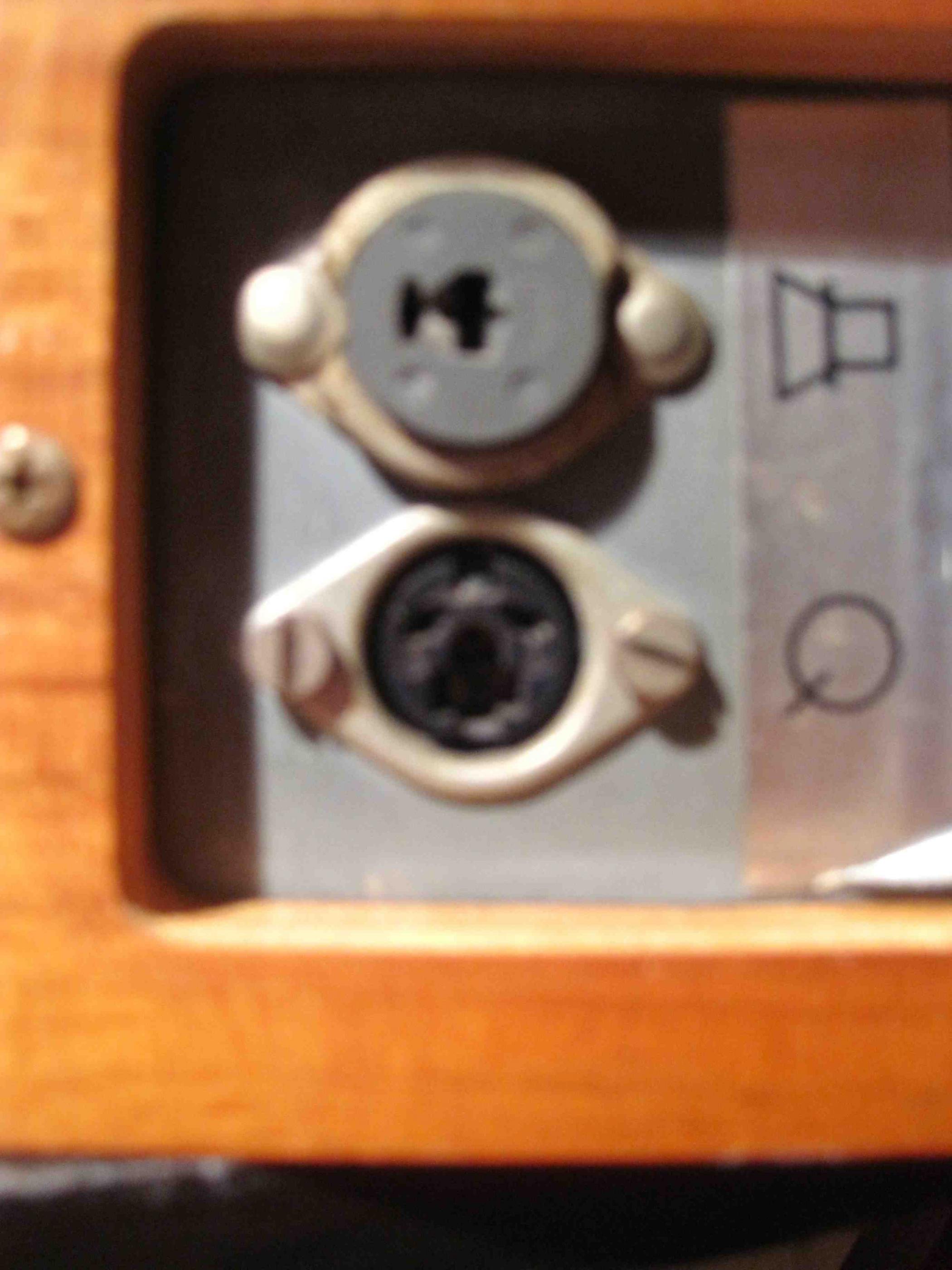

It sounds like you need to know the pin-out of your strange connector. If you can provide a pic of it, maybe people can help you out.

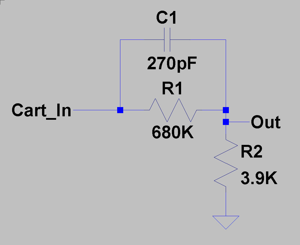

Ceramic cartridges provide inherent RIAA equalization as a function of their design, so you do not need (and should not) plug it directly into conventional RIAA equalized phono inputs. Normally you would use a line level input with a high input impedance (solid state amps generally do not have high enough input impedances, but many tube amps will) - in some cases older amps provided both an input for a ceramic cartridge as well as a magnetic cartridge which simply inserted an RC network between the ceramic input and the magnetic input circuitry. You might be able to find the details for such a network and make an adaptor..
Despite some of the schematics showing simple resistive dividers on the web this is not really what you want to do. (Excessive cartridge loading and inaccurate frequency response is likely)
Here is one possibility for a network that should provide the right EQ and loading for a ceramic cartridge using a conventional magnetic input. Originally from Audiokarma: AudioKarma.org Home Audio Stereo Discussion Forums - View Single Post - Moving magnet and ceramic phono inputs
You definitely want to grab the signal at the cartridge as you will get stereo and avoid the obviously low quality SS signal path in this thing. In the short run its a good way to get your feet wet with vinyl, in the longer run you will probably want to get a better TT with a magnetic cartridge.
Note that I have not tried this network, but it should work to at least some extent with most magnetic cartridge inputs. Some tweaking may be required. I would build this on some perf board, and use the closest value 1% 1/4W metal film resistors and a 5% polystyrene 100V cap. One required per channel.

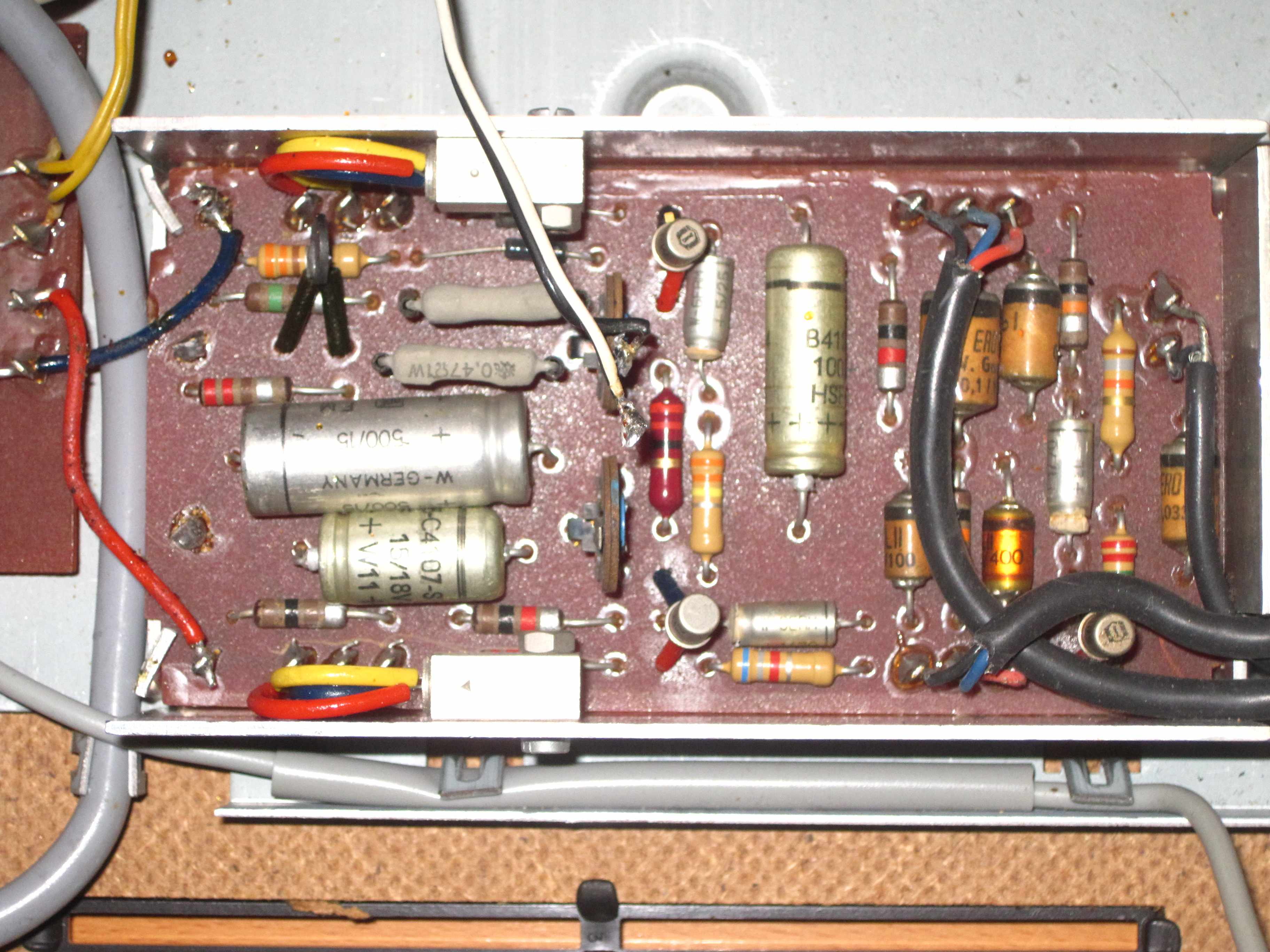

The purpose of C12 is to block any DC voltage to the output, in other words, it is an AC coupling capacitor. As you have determined C12 may be bad. You should replace all the electrolytic (metal can) capacitors because after about 40 years or so they may be very leaky and pass DC voltage or even open circuit and not pass any voltage (the electrolyte inside the capacitors dries out after so long). Also check that the potentiometer (volume control) P1 makes good contact and is passing a signal, an old volume control often has poor contacts (you can try wiping it back and forth to clean the contacts or if that doesn't work, spray cleaner solution inside).

Thanks. I was already familiar with the dual-reference.com website, but indeed, no pics of the H1010SV. I've attached some more pics of the turntable (turntable with speakercase IMG_0916.jpg, weird connection (under the 2pindin) IMG_0915.jpg, cartridge IMG_0935.jpg). About grounding: I've noticed that all the connections are in some way grounded to the (metal) back of the pot-meters (volume and tone). So I could try to attach my RCA-connectors to one of the grounding-cables that run from the connectors to the pot-meters' back. Changing the cartridge may be an option, I don't know enough about turntables to know if this would be possible. Picture of the tone-arm and cartridge also attached, perhaps you could say if this would be possible? That would be a nice solution indeed!
The thing with the "strange connector" is that it has 5 connection points: two are used for right/left signal that comes from the cartridge, one is used to connect the grounding cables that come from the cartridge (don't see anything else attached to that point), one has nothing attached to it and the last one is used to attach the cable that comes from the volume pot. So, this made me think: if I solder the new cables directly to the cartridge (ignoring this 5-point connector), volume control on the turntable won't be possible I guess? I can control the volume with my amplifier of course, so in the end, that's not really a problem, just want to make sure I understand this correctly.
By the way: if what you say is right (which I assume it is 🙂 then I didn't connect my RCA cables to the 2 DIN connection points the right way. I connected the center left cable to Pin1, center right cable to Pin2 and two grounding cables to the metal chassis. So probably I did something bad, but since I will leave the 2 DIN connectors alone, it's not that important anymore.

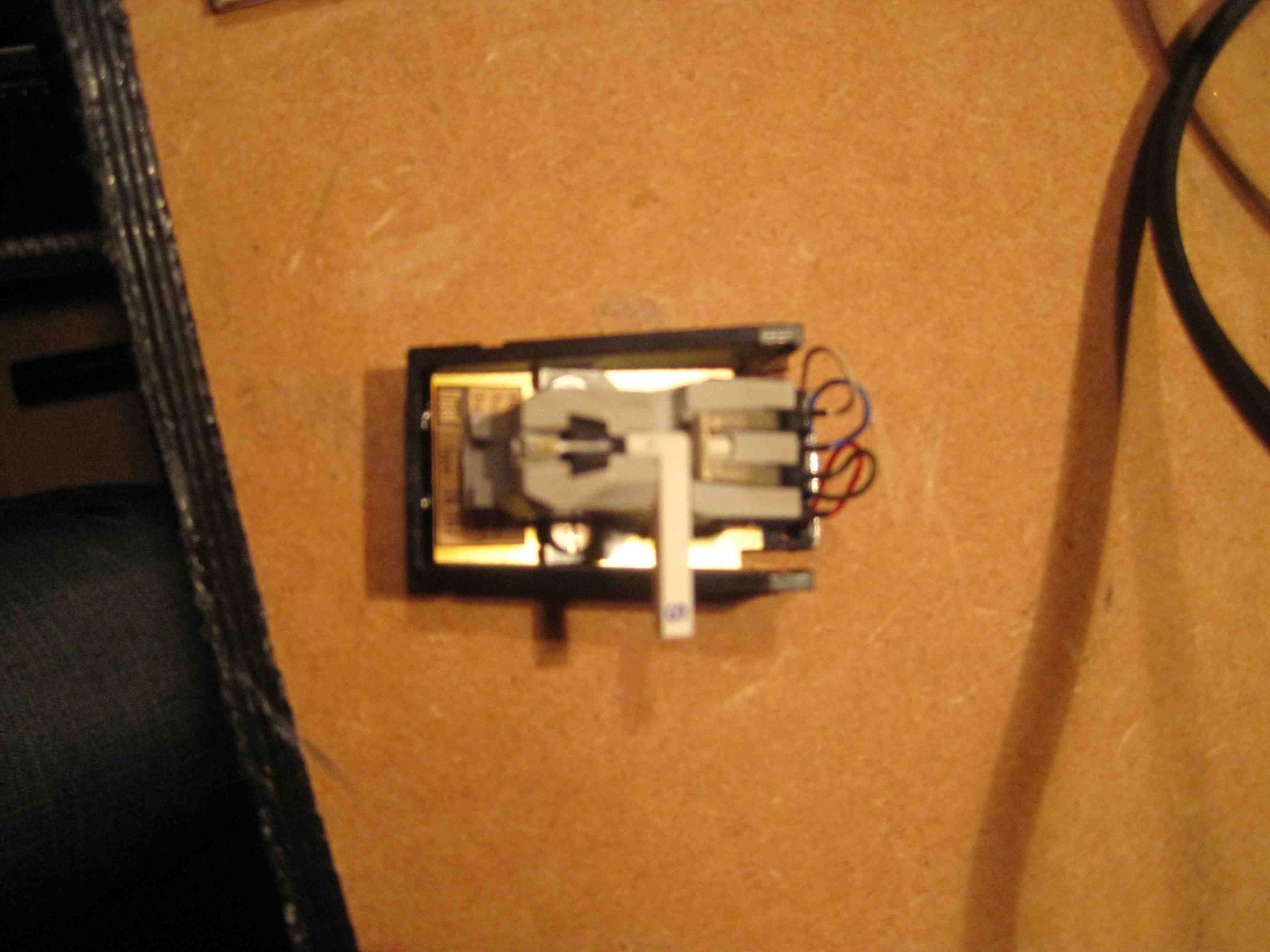

If I can't change the cartridge, this seems like a very nice option. Take two cables from the cartridge, connect them to two of these networks (thereby connectiing the grounding cables from the left/righ cartridge signal directly to the turntable, right?) and then take the output of the two networks, connect two RCA plugs and try it on a phono input, right? I should be able to do this 🙂

This is also nice to know. Contact at P1 seems good, if I don't use the amp-network in the turntable anymore, changing the capacitors might not be necessary, since I'll probably take the signal directly from the cartridge, but it's nice to know and might come in handy...

It's been a while since my last post, but I just wanted to let you know it finally works! 🙂 I've replaced the ceramic cartridge with a magenetic one (as you suggested), soldered RCA cables to the inside of the turntable, replaced the old (completely worn out) cables that ran from the cartridge through the tonearm-pipe to the inside of the turntable, connected everything et voila!
Thanks a lot for all the help; I'm now planning to relubricate and re-adjust some of the mechanical parts, but I'll probably start a new thread about that!
