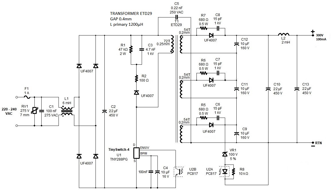

Some time ago i stumbled upon a broken DVD player which contained an interesting easy to build SMPS module. The heart of the module was the TNY288 chip which I de-soldered and after some reading of datasheets and downloading of the accompanying application found in Power integrations site, I managed to calculate and build a very easy and basic 300V 100mA power supply ideal for experimenting with tubes.
The schematic is straight forward and the construction of the transformer easy and basic. The ripple at the output at full load is less than 15mV which I believe might go even lower with some experimentation but at least it is acceptable.
Moreover, the output voltage can be lowered to any level by changing the zener at the output. For example, for 300V out we need an 100V zener, for 100v output we need a 33V zener.

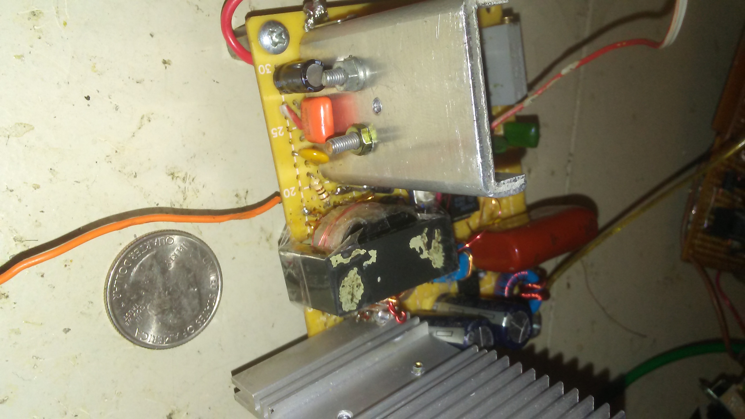

No I did not modeled any dedicated pcb, just a common perforated pcb and components from other smps.
The 817 optocoupler is possibly the most commonly used.
This is a shot from the pcb with a TO3 transistor for size reference.

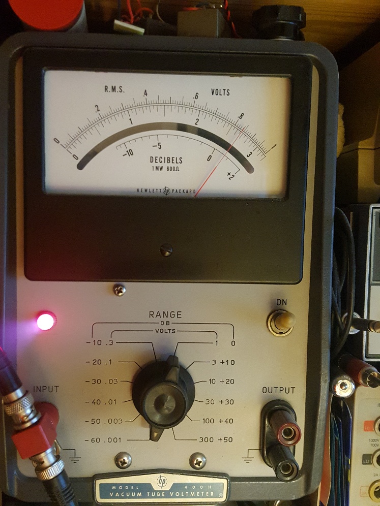

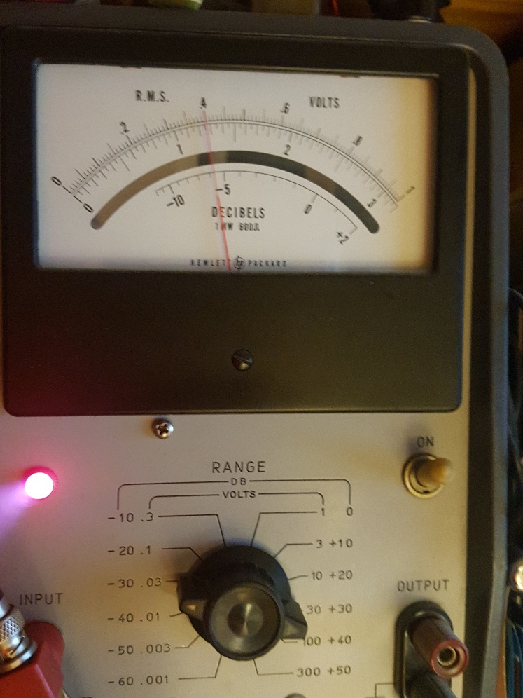

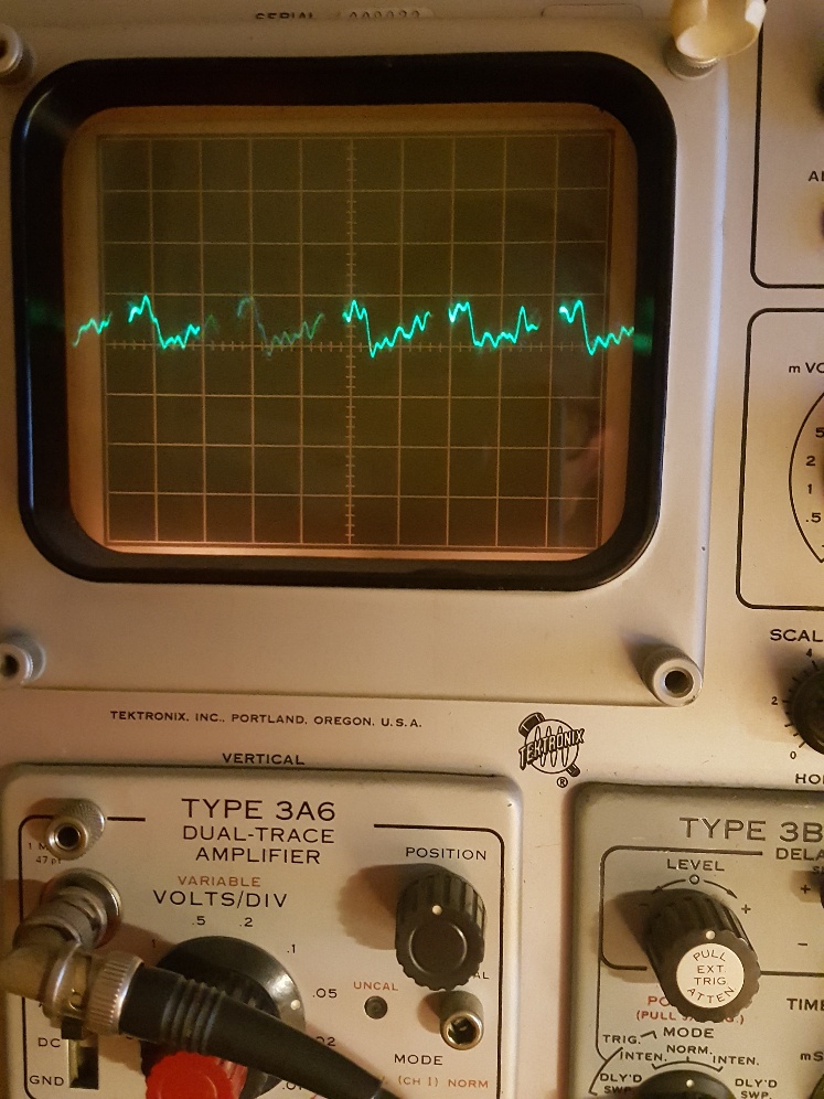

some measurements
So, since it is Sunday afternoon and having some spare time, I took some measurements with my very old scope and mV meter.
So at 1 mA there is less than 1mVRMS ripple.
At 100mA (full load) there is less than 15mV RMS ripple.
All in all, to me this seems a good outcome, especially considering the simplicity of this smps, as well as the fact that this is the first try with no attempt to optimize the outcome and the filtering.

Capacitors are correct types for their positions, the board is experimental perforated with copper and will eventually lead to a dedicated design with better creepage.
The insulation is 3 turns of 0.1mm mylar film between primary and secondary.
Between secondaries 2 turns of 0.1mm mylar film and all this impregnated (not vacuum) in polyurethane varnish.

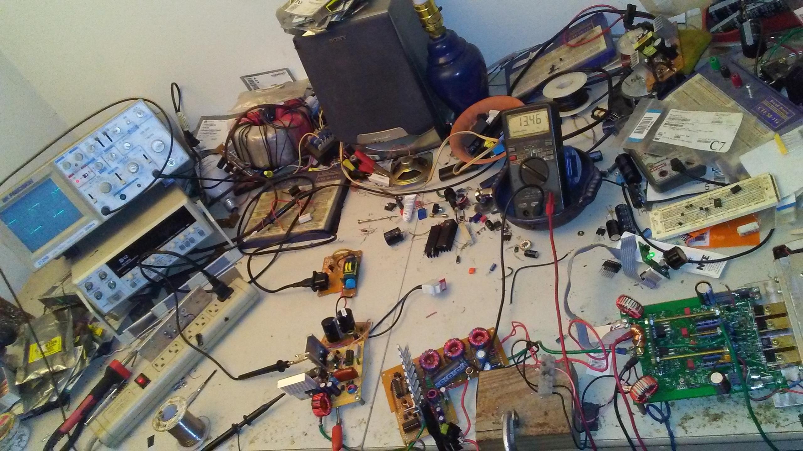

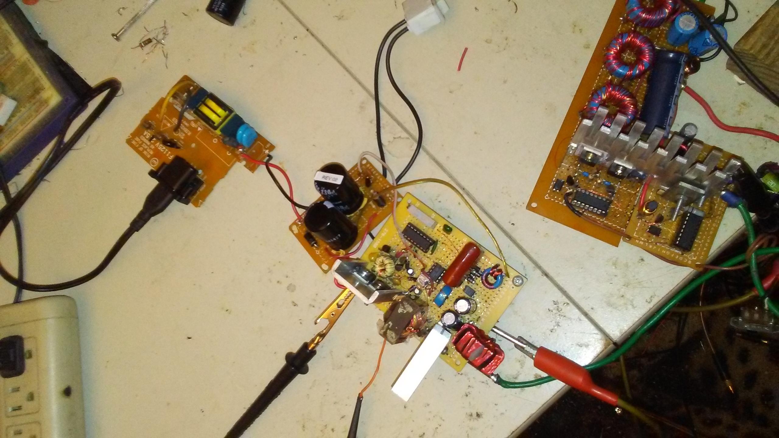

I finally did get to the step of connecting directly to wall outlet in this small experimental converter. Output for 12VDC like a car supply from 120VAC. Asynchronous half bridge. Transformer a bit undersized, but it is what I had scrapped out of some old broken junk. Ha!

What is the purpose of C5?
Cheers
Ian
It is used to prevent or reduce primary to secondary differential mode noise interfering with the feedback loop.
Ideally it should be placed between/across the 'ground' nodes of the opto-isolator.
For safety purposes it should also be a Class Y capacitor.
The given circuit does not show as such but the value of 220pF might be indicative of its nature... it will be a blue ceramic disc capacitor.
You may also see examples where that particular component has an RC network in parallel with it in order to damp ringing.
The circuit in this thread does not itself make reference to mains/chassis ground so you would have to assume that it is Class II, double insulated.
You might see that there is a bit of a dilemma, here and elsewhere, in terms of input and overall filtering in respect of Class II.

The circuit in this thread includes a similar input filter but omits the Class Y capacitors... no mains earth. C1 is a Class X2 device and, in conjunction with uncoupled inductance in L1, filters differential, Live to Neutral, noise.
Leakage inductance in common mode chokes is small but you get to use big Class X2 capacitors.
Common mode inductors have big Common Mode values because the Live/Neutral currents cancel and that lets you use small Class Y capacitors.
You are forced to do this because they represent a source of or path for Earth Leakage, people killing, currents. Probably not as important as tripping earth leakage circuit breakers.
Of course if you design for Class II, double insulated, then you do not need to test, in regulatory terms, for Common Mode, Ground, noise... there is no Ground.
I suppose that works if you have some problems getting your supply to pass the relevant standards.
However if you include components to nominally, incorrectly or otherwise, deal with such cases you are, in effect, offloading the responsibility onto the end user.
That circuit is the output from the Power Integrations (chip manufacturer) simulator. It does not cover specific safety requirements, just the general case. The type of cap (Y cap) is given in the BOM output from the simulator. Many of the specific components listed in the simulator output are no longer in production.
