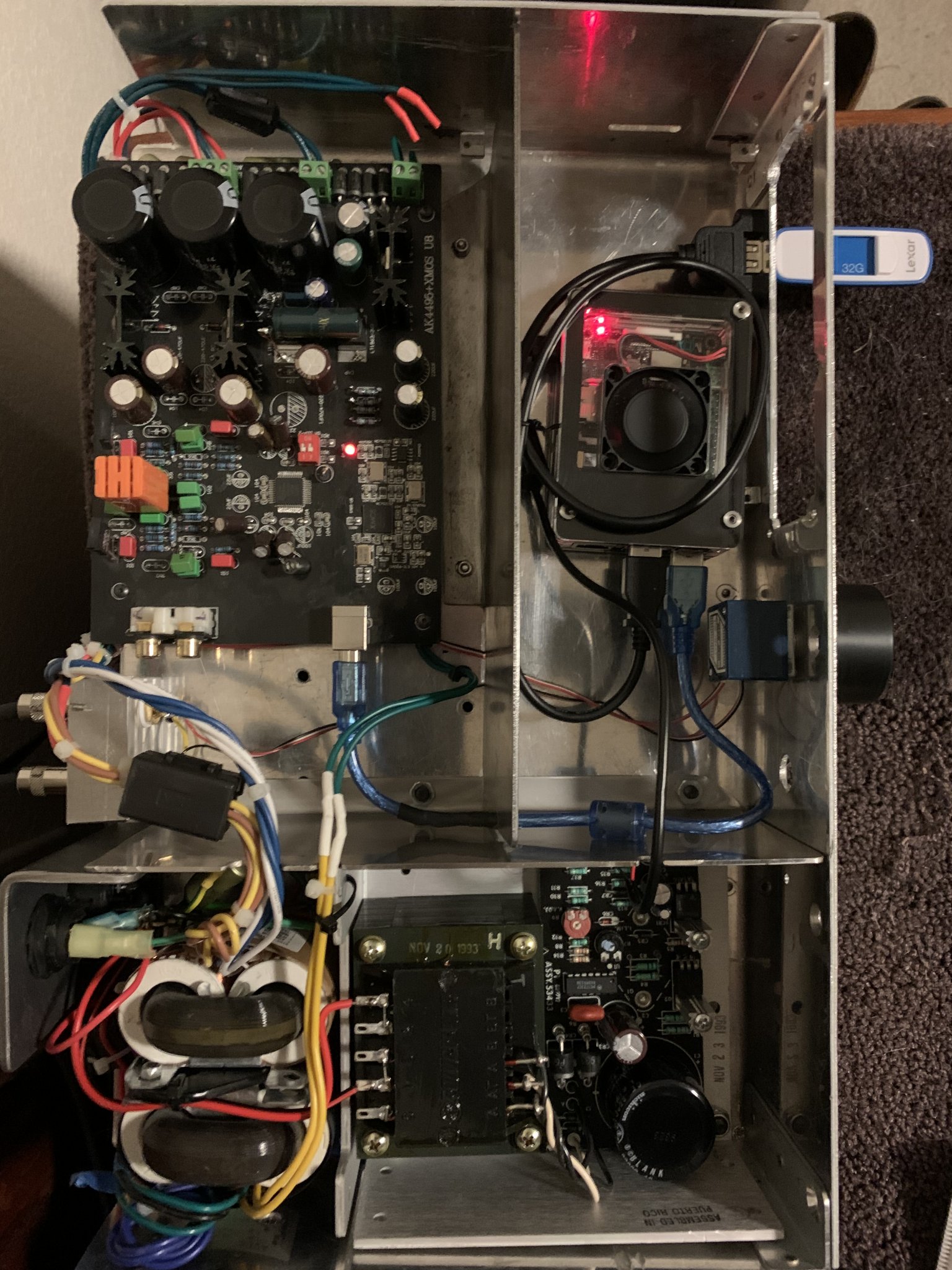

I've been wanting a NAS streamer (renderer 🙄) and internet radio for a while.
The 'problem' seems to be I already own a good amplifier with a perfectly serviceable AK4490QM DAC. I have no requirement for a streamer wit a built in DAC.
Also, I find streamers a very bad investment : the technology advances so quickly your few thousand USD/EUR/UKP investment in a high end unit will be worthless a few months from now since it's old hat.
So I started with a Pi, tried, Moode (edit : not Roon, I'm an idiot) and now I'm testing Volumio. I've tried several PC hardware based solutions, like Audirvana, JRiver and a few others, but I find them inefficient and mostly clumsy. I like the Pi thing.
Now I want to start upgrading the Pi setup. I've bought the IanCanada Station Pi and the Dual Linear Pi, and a nice toroid. This I will assemble first. It should be pretty much plug and play for the existing Volumio Pi.
I just can't seem to figure out what the next step would be. I think it would be cleaning up the PI USB with some kind of isolator ? I've seen the Ian Canada one, but it looks a tad expensive.
Are there cheaper alternatives you could recommend ? I would like to stick with the USB, as it offers the fastest datarate (384 kHz), and I use the coax and optical inputs on the dac for other things.
What would you recommend ? I'm staying away from supercaps and batteries for now.
Thanks, Pete
Okay. So isolating the USB at low cost may not be so easy. There are some cheap USB isolators on ebay and or aliexpress, but they are not reported to work all that well. Allo makes a thing called USBridgeSIG, which is an RPi equivalent with low noise isolated USB for a dac. Other people have modified RPi to run on linear power supplies which has been reported to reduce noise effects in dacs.

As I understand it, the Allo is a complete Pi3 unit. I have a 4, which I am now upgrading the supply side of. I would like to build on that.

Compared to CD or even vinyl the thing has no oompf. The music is very clear and detailed, but it sounds too thin somhow. like some of the mid is missing. I dunno...I'm just faffing about.
Thin sound has been a problem with some dacs. Can't say there is necessarily any one thing that fully fixes it. IME there are usually multiple contributors. FR is not usually involved and a midrange EQ boost does not usually fix it. Its more like there is some distortion and or some signal-correlated noise involved in making everything sound a bit too bright.
That said, fixing ground loops, SMPS noise, USB noise ground and +5v noise, output stage design and implementation, shielding the dac PCB in a steel case, etc., may each produce some improvement. By the time all that is done I would probably just as soon want to start over from scratch.
Maybe other folks will have some suggestions that aren't so wide ranging.

Might be worth trying an Asus Tinker Board, with Volumio. That arrangement is what was used in the turn-key Volumio streamer. The usb implementation is better in those vs the Pi.
Could still use the Pi for home security system maybe?
A decent 5v power supply is a Power One HC5, are usually available on the auction site for $40.

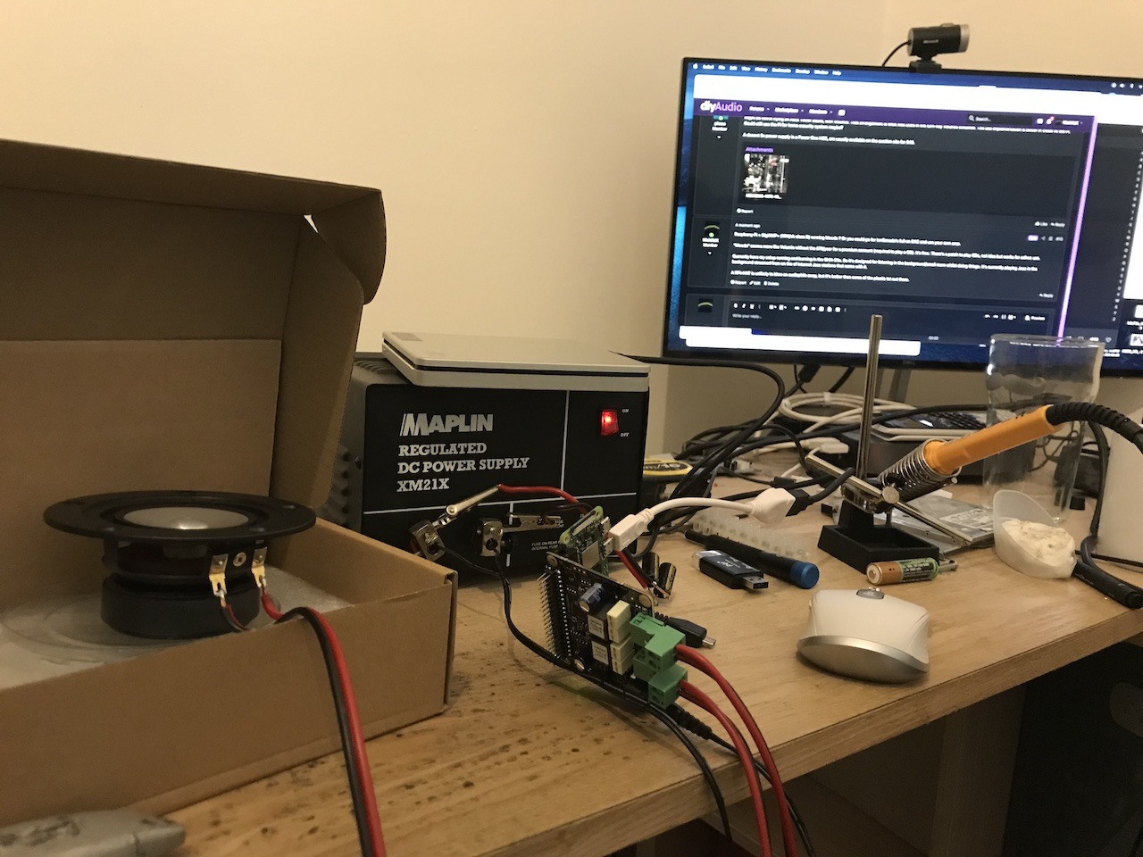

Raspberry Pi + DigiAMP+ (18W/ch class D) running Moode ? Or you could go for IanCanada's full on DAC and use your own amp.
"Moode" seems more like Volumio without the £70/year for a premium account (required to play a CD). It's free. There's a patch to play CDs, not idea but works for adhoc use.
Currently have my setup running and burning in the CHN-50s. So it's designed for listening in the background/small room whilst doing things. It's currently playing Jazz in the background streamed from on the of internet Jazz stations that come with it.
A RPI+HAT is unlikely to blow an audiophile away, but it's better than some of the plastic tat out there.
Just trying a set of caps over the power to provide some additional smoothing. Old regulated supply is a little slow I think.
