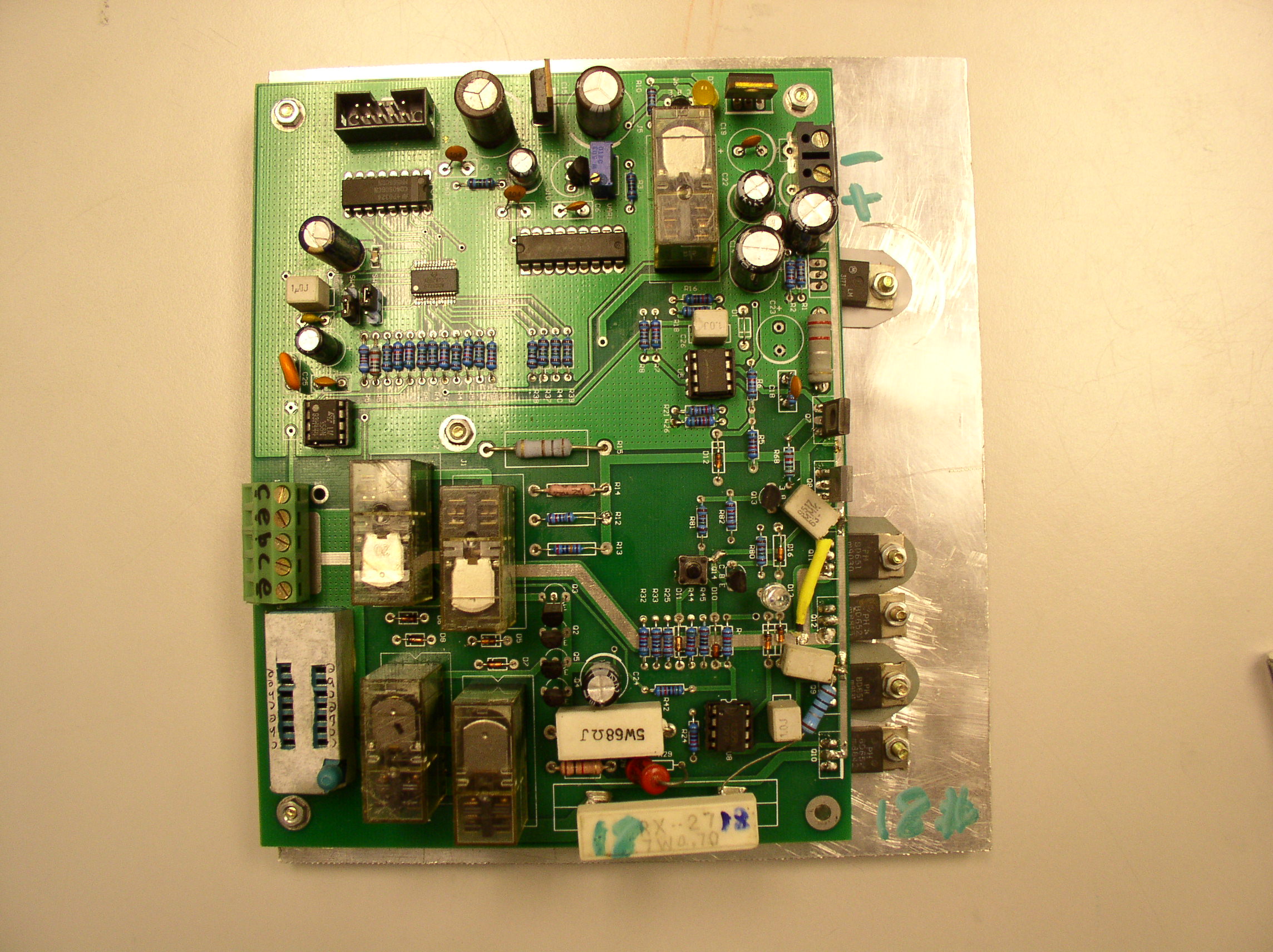

So it is unlikely we shall go further with this, even though we have own own version of the 2-board design almost done.

Thanks for the suggestion. Still want to make it. I'll try to make a low current version first.

We were just planning to duplicate the one with Locky_z with improved hardware.
Making your own means writing your own software.
Too much effort for us to do from scratch.
The hardware is not the difficult part.
Patrick
Patrick
Then we have perfect fit, because we have the hardware part done.

This LT1990 circuit needs bi-polar supply to be able to source & sink current.
On top of that if we want to measure a BJT at say 3A with a hfe of say 20, we need to be able to source or sink 150mA. Then a booster stage is required anyhow, and we are back to a circuit not dissimilar to the original by Locky_z.

If you're talking about a curve tracer's gate/base drive, I once used a Howland-type voltage-controlled current source type of architecture, with a push-pull (BD139/BD140) current-booster amp inside the feedback loops (driven by the Howland's opamp's output). Input was a calibrated voltage staircase waveform of switchable polarity, with selectable step size. Output was up to 150 mA or 15V, and could be switched from current steps to voltage steps by switching in a Caddock precision 100 Ohm power film resistor to ground, right at the output. It eventually worked very well, and was able to get to 150 mA, but just barely. If I did it over I would probably use something like an LM1875 (or whatever) for the current-booster amp stage.
by the way, National has a "how to" of Howland current sources on their website. AN-1515 -- must reading by Bob Pease. Also -- Apex Ap Note AN13 on VCCS, Tex Instr datasheet on the REF200, and the ADI ap notes on the AD8276.
I've used the LT1990 with 2SD669A/2SB649A up to 100mA, and in the other direction, it's accurate down to the tens of picoAmps.
This is what the original circuit uses.

Tom,
May I pick your brain ?
1. What device should I include as DUT for a CT, if I design from scratch ?
(FETs, BJTs, diodes, ZDs, Triac, passives, what else ..?)
2. What other features would you like if we were to make a USB version, other than outputting data to text or excel files ?
