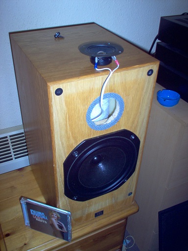

I'm fascinated by what you are doing there, sfhobbles. I have had a similar experience myself. Like you say, the speaker disappears. 🙂
There's actually good reason to think there might be some science behind it too. It's common enough in filtering that a 90 degree phase change occurs. But whether that is strictly a phase phenomena, or a right angled physical alignment is open to debate. The root of -1 called i by mathematicians, or called j by engineers (to avoid confusion with current) can be interpreted either way.
For sure, the tweeter actually does very little above 3kHz, maybe adds a a bit of air. I tested that by turning it upside down.
Personally, I'm gobsmacked how good these speakers sound with the tweeter pointing upwards. It looks like I have forgotten to screw it in. Have we reinvented the omnidirectional speaker? I really don't know! 😀
