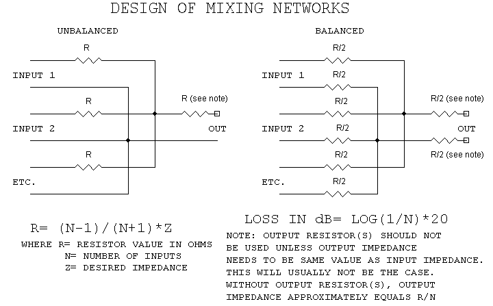

I want to build a basic stereo mixer for my pc, so I found this indestructible that has resistors in between each source and that got me wondering if I could use a dual pot instead and have control over the input volume. Maybe I can use this for a multi mic setup. What pot should I use and will my idea work?
You can have dual pots as it is stereo.
