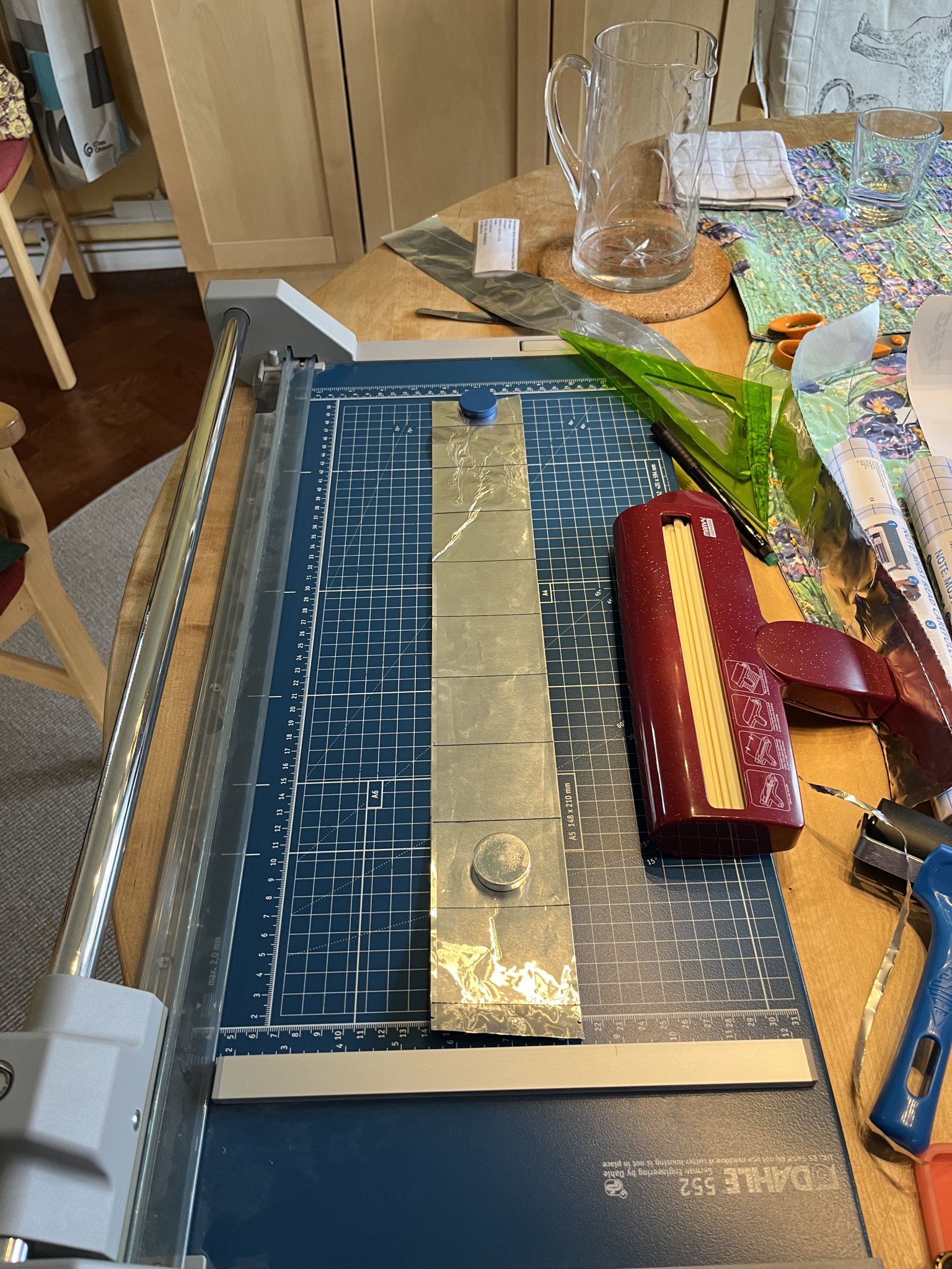

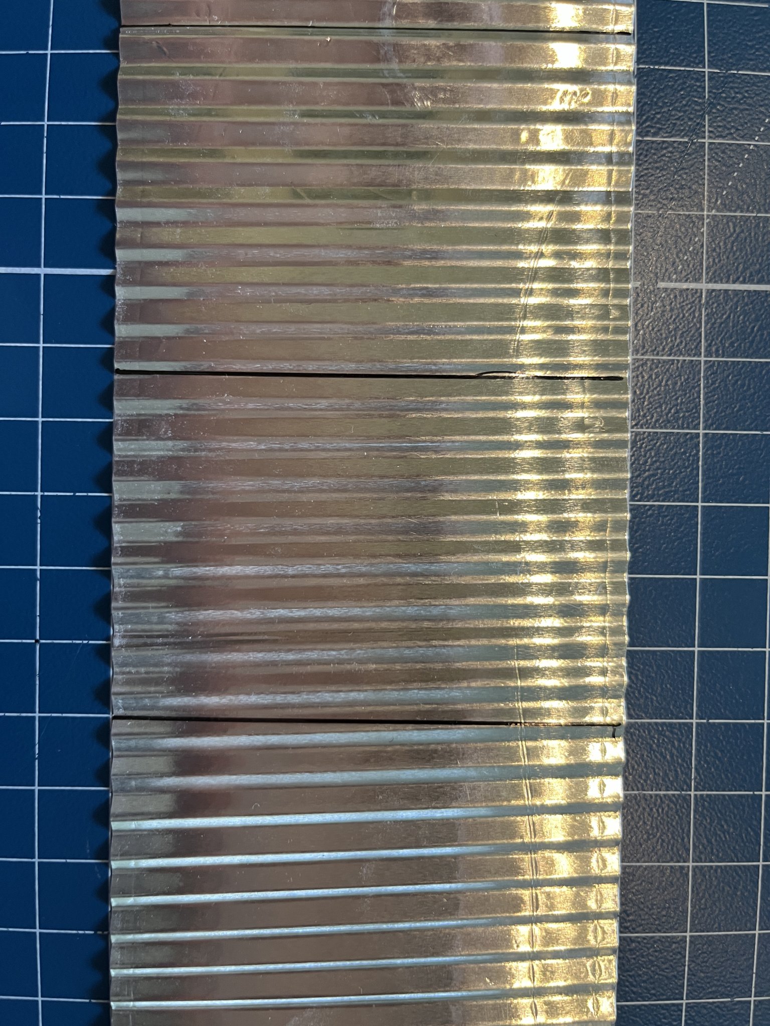

I bought the same corrugator you linked to in your thread @solhaga and it seems to work pretty well. It corrugates to roughly 1.5 mm peak to peak which is more than I'd like but by stretching the foil slightly I can turn it into 1 mm peak to peak. There is a risk, however, that the after-stretching will not be perfectly uniform so I might steam ahead with designing my own corrugaror. I bought some ball bearings with big enough inner diameter such that I can print the axles on my 3d printer without having to worry that it would snap.

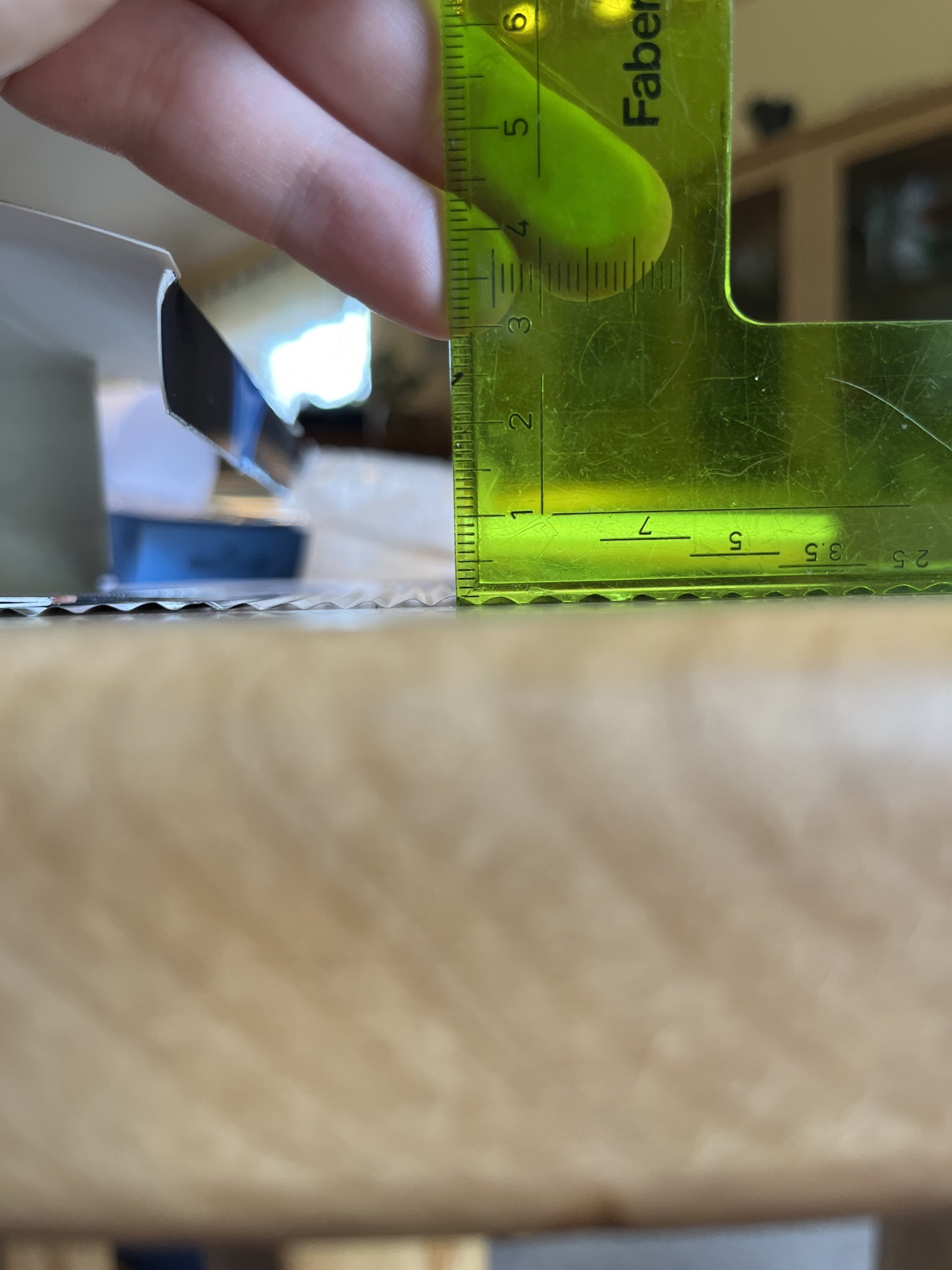

I also learned that I will have to be careful when corrugating to ensure that it is corrugated perfectly parallel. I'll need to devise a technique to ensure that. One idea is to tape the membrane edge to a table and then stretch it while corrugating closer and closer to the taped edge. Or to build a feeding mechanism.
I also learned that I will need to property stretch the mylar before applying the aluminum foil. The membrane in the image looks like **** but it worked well enough to calculate how much length is lost from the corrugation.
The black lines are 5 cm long. With a 1.5 mm peak-to-peak it got reduced to 4.4 cm, when I stretched the peaks to to 1 mm it is reduced to 4.6 cm.
Yes, I've noticed that skewness too. My idea is to have guides that ensures the membrane to be fed straight.

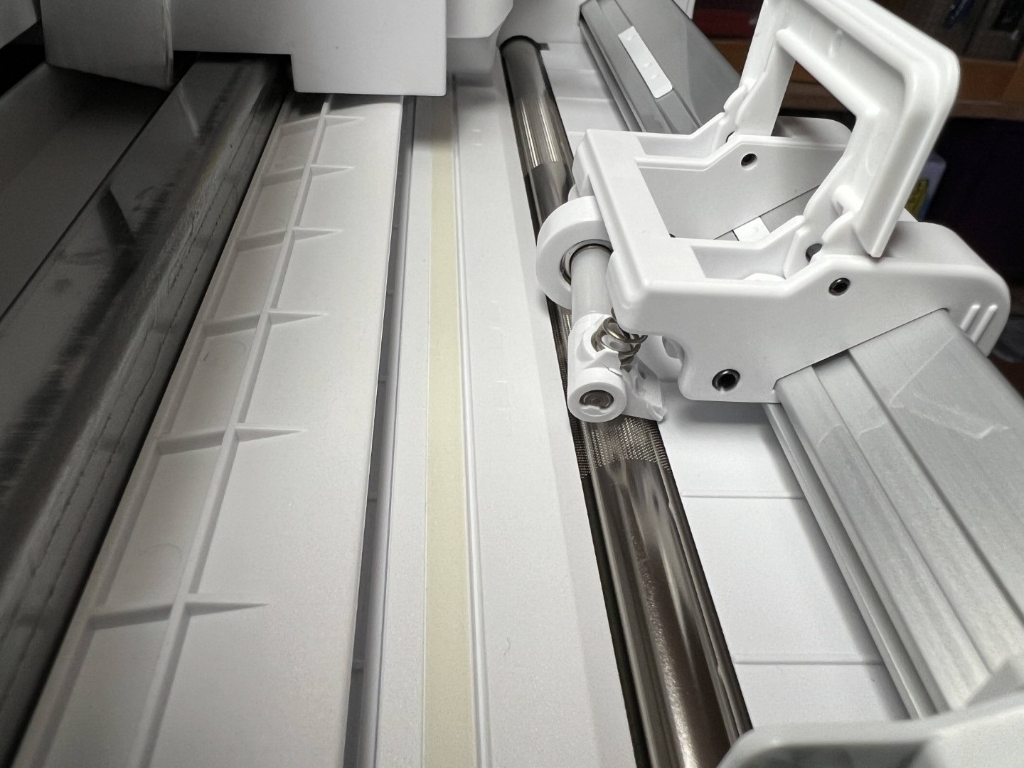

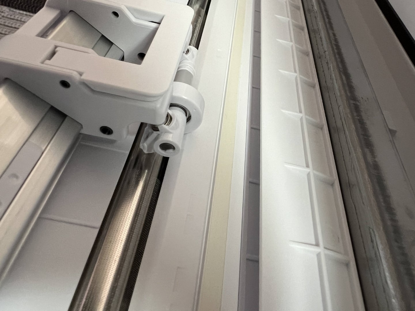

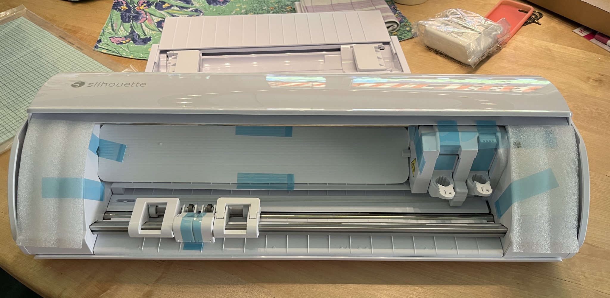

Have you got the Silhouette Cameo 5 yet?
I had to send mine back, when unpacking I discovered that the adjustable right roller was broken:
Too bad as this is the USP of this cutter. Appearantly the black Cameo 5 doesn't suffer from this weakness.
I guess the properties of the plastics are different; always use black zip ties you know.
Or I'll make my own as you are planning to. Here's some inspiration.
But I wonder if the precison of the coggs along the whole length of the corrugator will be better than the Uchida corrugator.
I just dismantled the corrugator. I carved away some debris on the cogg endings and lubricated it all with silicone spray.
So now it rolls smoother and possibly straigther.
The thing does not have bearings, it's plastic against plastic, so I don't except to be a long term solution anyway.
It'll be very hard to keep a straight feeding of the membrane, in my case it is 230 cm long, holding the corrugator with left hand and cranking it with the right.
But, I think the cogg rolls can be repurposed. They are sturdy enough with a steel tube inside them and I also think it'll be hard to 3D-print anything sturdier and precise.

Nope, haven't received the Cameo 5 yet. I think I will this coming week.
Sucks that yours was broken, I hope you get a replacement as soon as possible!
And I guesstimate that as long as the 3d printed corrugator is designed to take account for any weaknesses due to printing (such as large inner diameter ball bearings to allow for large printed axles. Maybe also selectively print some parts with 100% infill like the axle + the teeth) then I think it will be strong enough to not be a problem. We are after all corrugating really thin mylar / kapton + some aluminum foil here, nothing really strong. And if we feel uncomfortable we could always just oversize it even more to compensate and make the corrugator stronger.
I think the problem will rather be the feeding mechanism, or rather how to ensure that the membrane is fed into the corrugator perfectly straight.

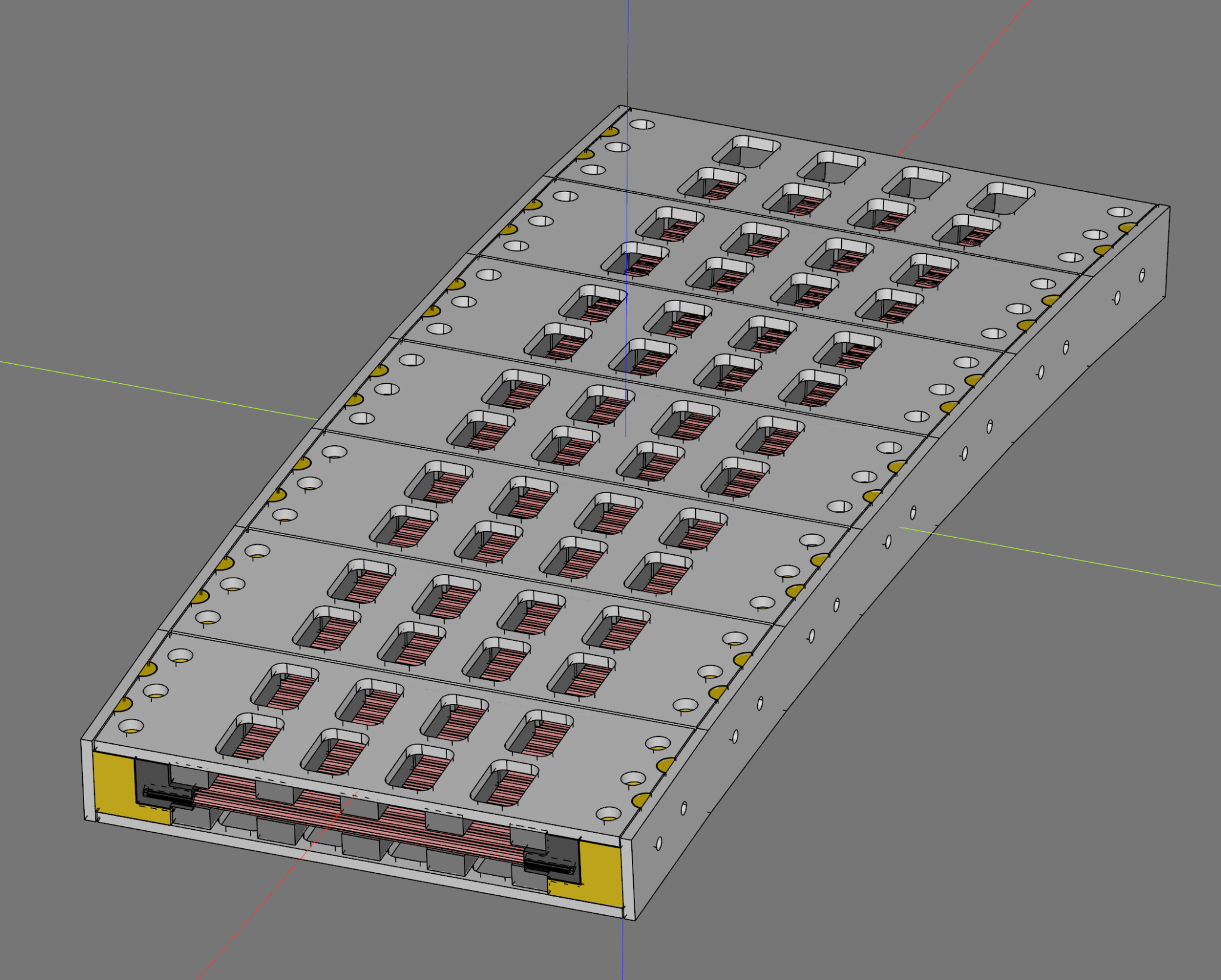

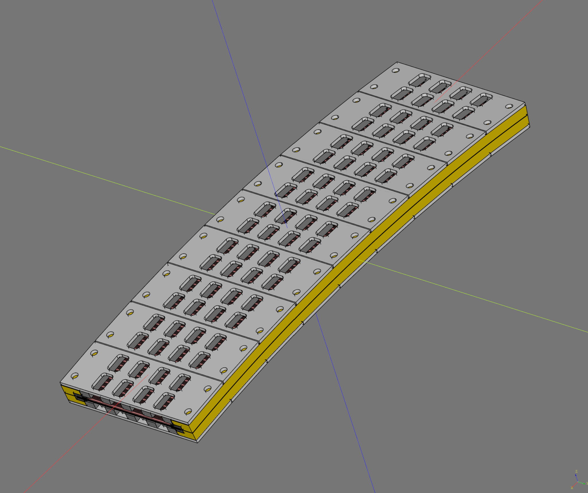

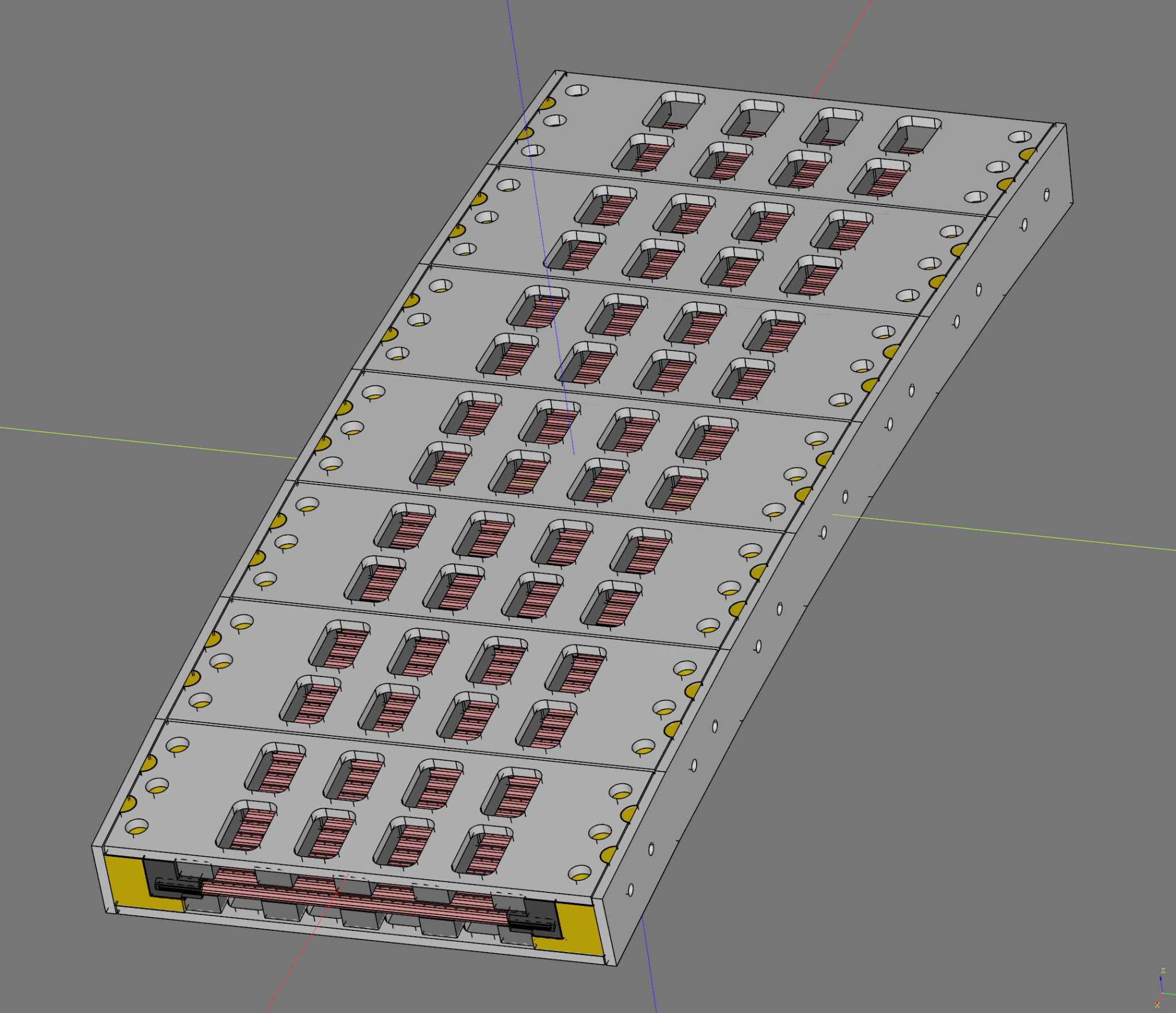

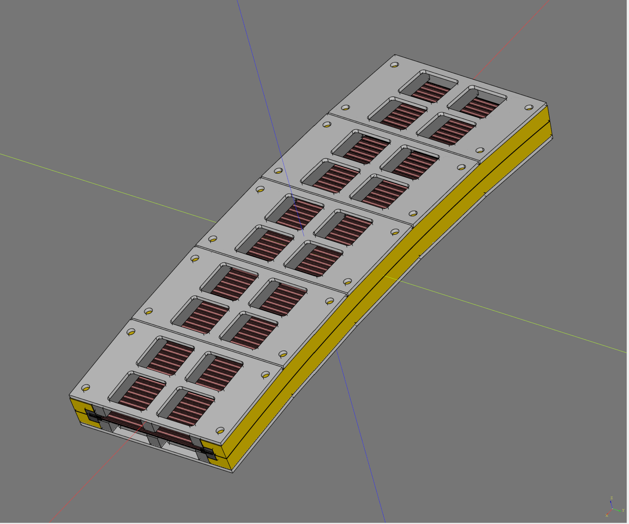

Drawings but with segmented steel plates.
The smaller is with 5 rows of 12x5x3 mm magnets. The bigger is 3 rows of 40x5x5 mm. More rows of smaller magnets are probably better but might as well try both 🙂
I also want to try with plastic pole pieces, will probably be worse but would be interesting to measure exactly how much worse. Will it just decrease efficiency or will it change the distortion specturm too?
If I order enough laser cut steel plates to cover ~ 50 cm of push pull drivers of:
5 rows: 12x5x3
5 rows: 12x4x3
7 rows: 50x3x3
3 rows: 40x5x5
It will only cost 204 € from fractory which isn't that bad. I'll wait a day or two, then re-check all my measurements and if all looks OK I'll probably send away an order for the parts.

You are correct that if I go plastic I will probably need to get creative and add supports like this. I might need to add similar supports on the outside too.
I'm thinking if I can get away with 1.5 mm or if I should go 2 mm. They will not be as stiff as if they are curved and I don't have the tools to add flutes either. Maybe I should go thicker, but then the helmholtz resonance gets lower. It might be a good idea to add the plastic supports even on the steel plates. It will make everything slightly stiffer and also reduce the inner volume which will push up the resonance.
I made my parametric CAD model spit out the inputs to calculate helmholtz resonances:
5 rows of 5x3 mm magnets, 1.5 mm steel: 10300 hz
5 rows of 5x3 mm magnets, 2 mm steel: 9400 hz
3 rows of 5x5 mm magnets, 2mm steel: 7400 hz which makes sense since the magnets are much taller.
5 rows of 5x5 mm magnets, 2mm steel: 7200 hz.
I guess the thicker magnets would make sense if I go 5 rows but skip push-pull and instead go single-ended. A 7200 hz resonance on the rear should not be a problem. Might be worth testing.

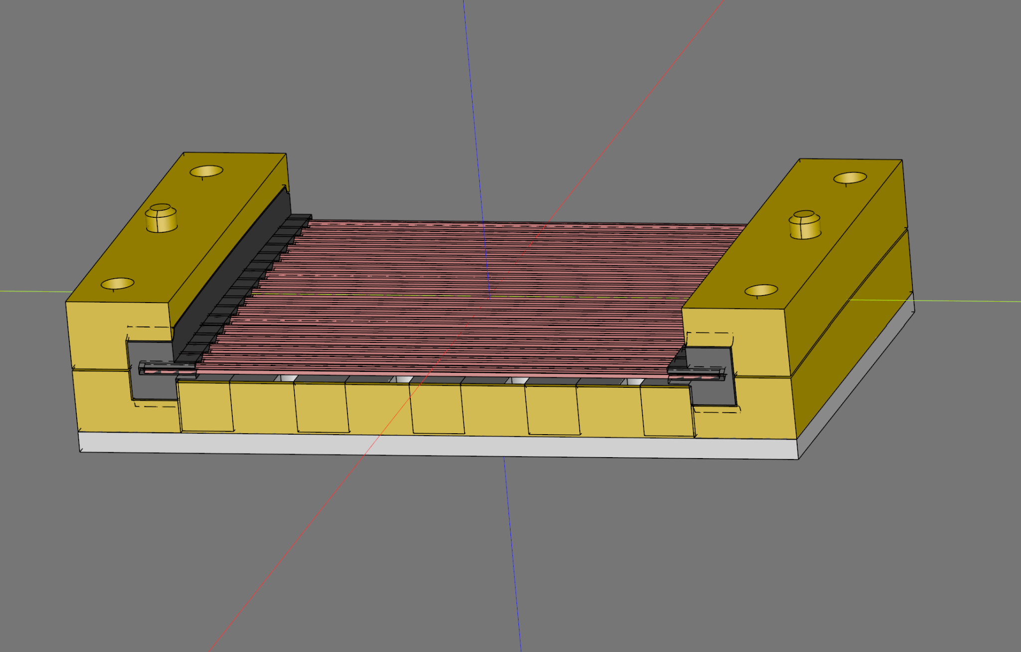

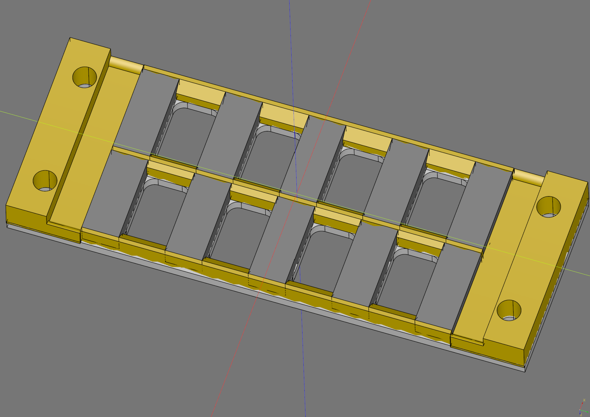

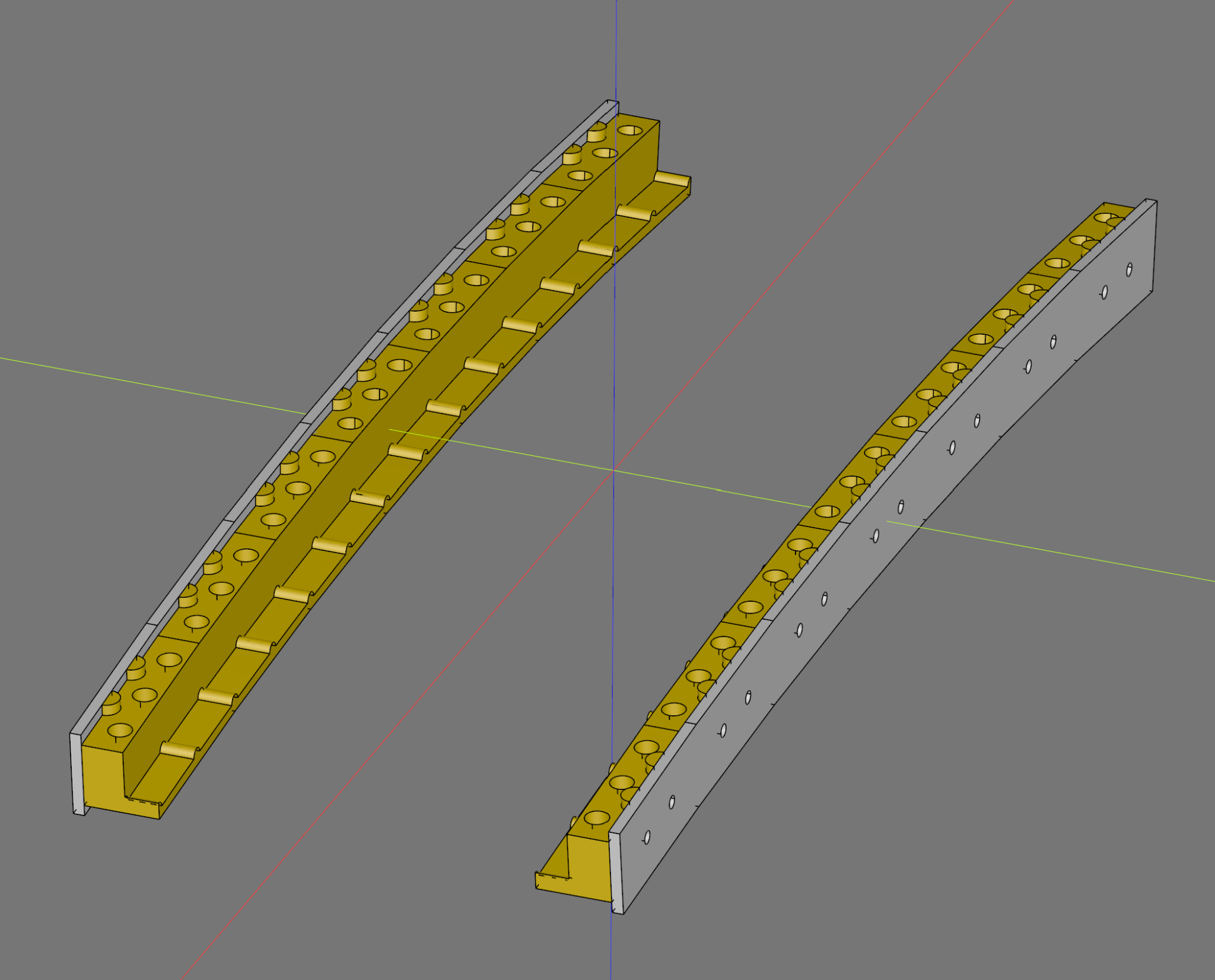

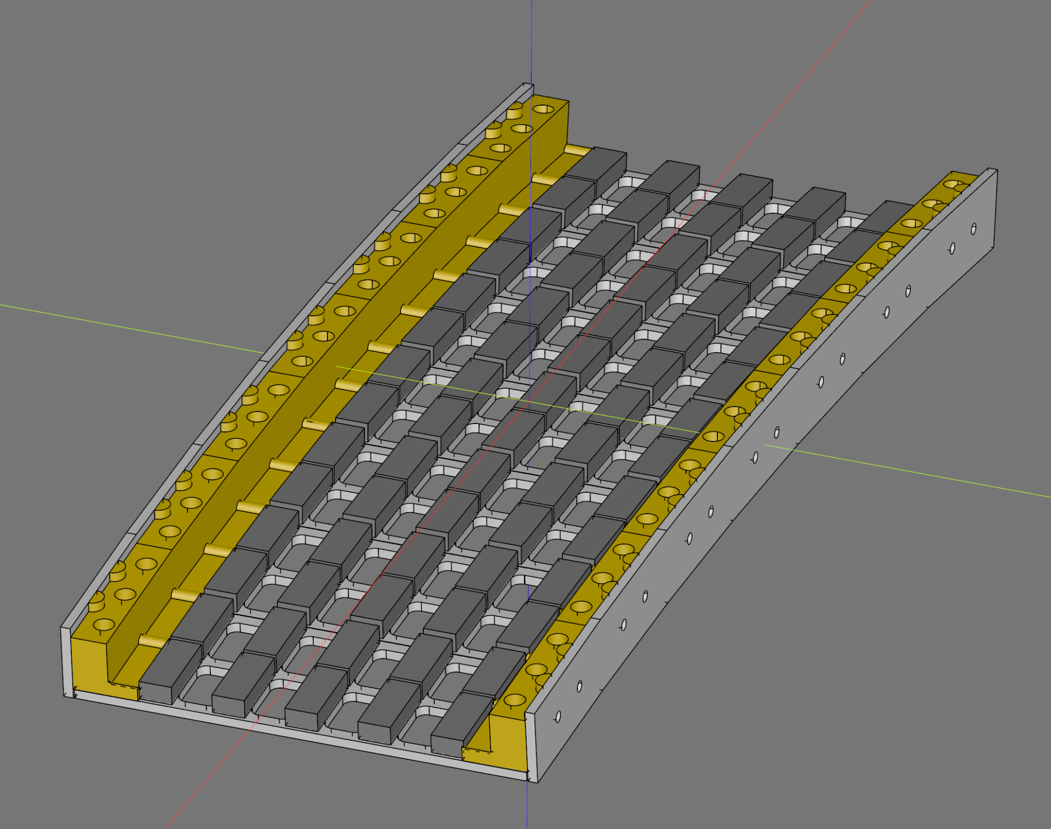

Getting close to ordering a test batch of steel plates. Since the top-rear plates are segmented the only thing keeping the curve is a tiny printed part which probably isn't ideal. I'm toying with the idea of adding an extra steel plate on the edges which is glued on top of this plastic part to add some strength. The small holes on the edge is just for small 1.75 mm filament pegs to index the part when gluing.
I also simplified the internal design such that the edge (yellow) is a single part. Also I extended the gasket to the top.
I've also been thinking of how to screw everything together in reasonable steps.
I'm thinking of mounting the parts in the following order:

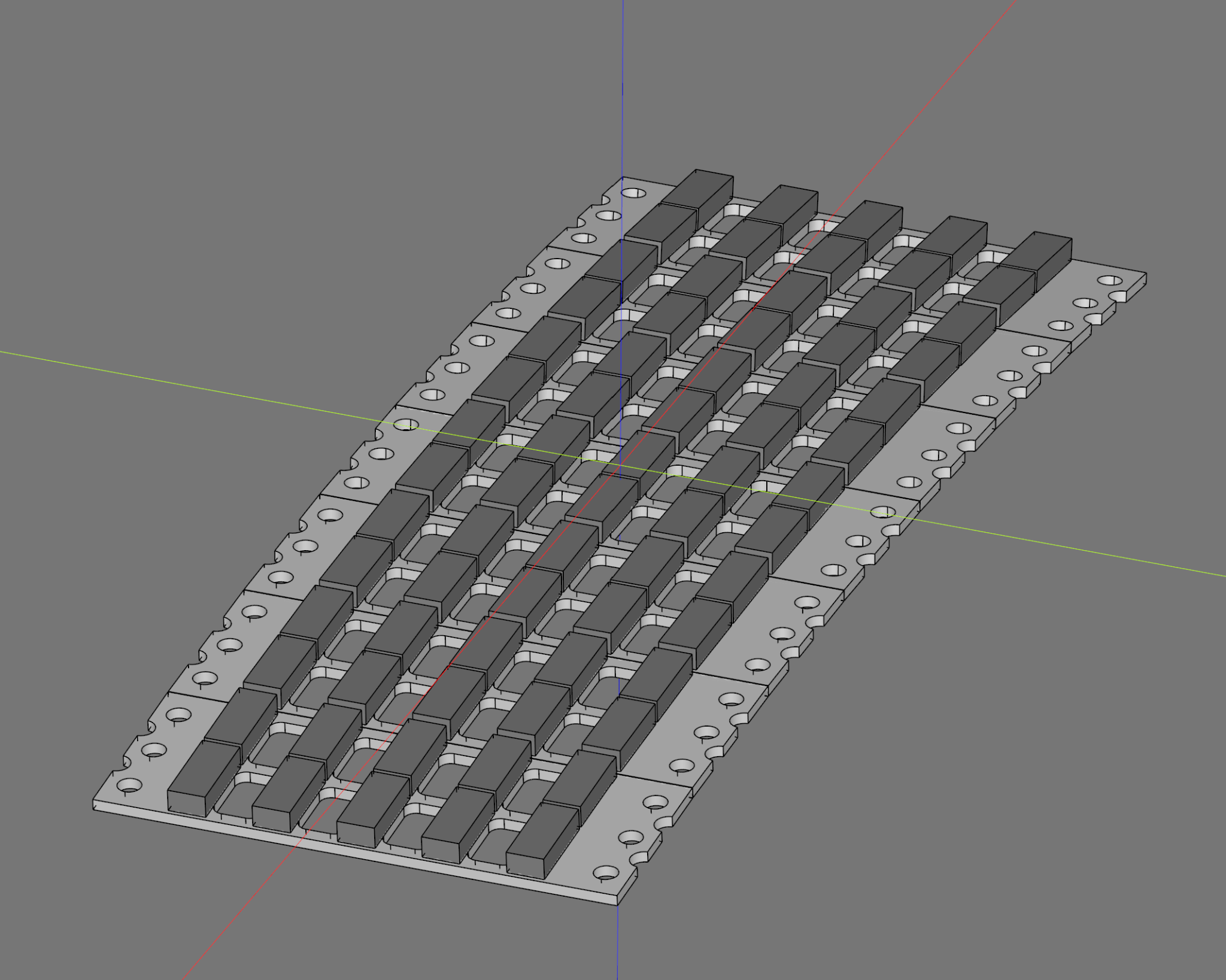

- Glue the magnets to all the top and bottom steel cutouts. This will need some helping jigs to ensure magnets are glued exactly where they should.

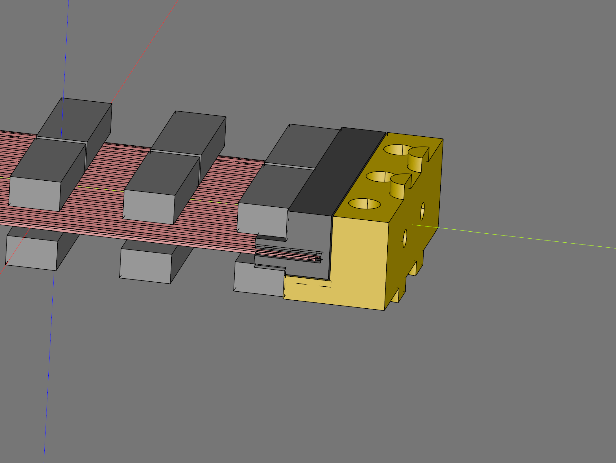

- Glue the edge steel support to the 3d printed edge part. To index the steel plates add some small filament pins. If there is any excess after the glue has dried just cut it off.
- Add threaded inserts to the middle holes where all the sheet metal parts will screw into in the 3d printed yellow edge part.
- Screw all bottom steel plates with magnets to the yellow edge parts.
- Push the black gaskets into the membrane and lay down the membrane + gasket on the bottom + edge. If all goes as planned it should fit like a glove.
- Add the top steel sheets with the top magnets and screw them tight through the two outer holes of all the sheet metal parts. After this the inner screw that screwed into the threaded insert can be removed, the outer two screws should be enough. The inner holes can then be used when mounting the driver to the enclosure.
Also, I did receive my Cameo 5 the other day, I havent turned it on yet but looks like it arrived in one piece:

Is supporting a corrugated membrane on the long side really a good idea? I mean, that bend that is needed to move the membrane is really opposite of what the corrugation is trying to mitigate, no?

Great idea with the guiding pegs. I will have protruding screws from the front to guide the back plates. This as it will take a lot of force to force the back plates in place.
1. Yes , a jig is essential. And also to keep in mind the polarity of the magnets.
3. I doubt that threaded inserts will hold. They are also hard to insert perpendicular.
4. As TNT commented: will there be enough free play for the membrane? Or, will the gasket be compliant enough?
5. Then there's no free play?
6. Beware, without any extended guides starting from a safe distance, it is were easy for the back plate to slide sideways and then you'll have a squished membrane and two plates that are almost impossible to take apart, at least without any serious damage.
Beware when you move the pinch roller. I'll get my black Cameo 5 in a couple of weeks.
