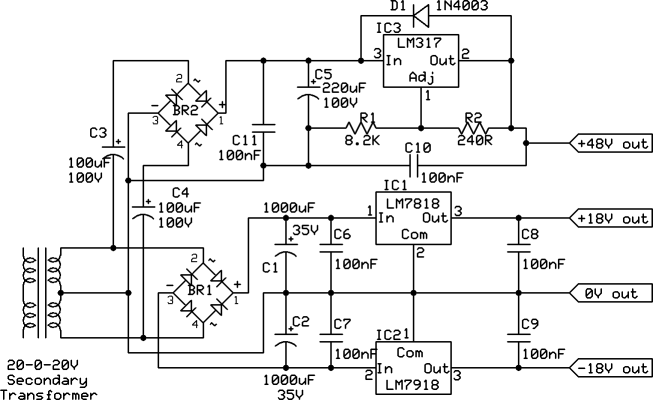

The actual Power supply I use is the same one used in the "Green Pre" which is also simular to the "Five fish" power suply and many others...It uses the Basic Datasheed implementation of the LM317/337 regulators and use a voltage tripler and a lm317 for the Phantom power....
For the Life Of me I can not find a schematic or PCB design for the PSU but I"m sure there is a schematic for the five fish PSU at there web site.....
as for the INA217 I have setteled on a pretty basic implementation , no Ballanced outs, No DC servo...Just go by the datasheet schematic and implement the features you want and omit the ones you don"t....Remember to use a good quality output cap (about 470uF) if not useing the DC Servo....
Without the DC servo and Ballanced outs you can make a PCB that is extremely small.....
Cheers
PS: this PSU schematic is very close to the one I use accept I use the LM317/337 regs and not the LM7XXX series regs...

Hi Minion,
this Puwer Supply Schematic is pretty exactly what I'm looking for, only that I need +/-15V instead of +/-18V.
So I'm wondering if I could use a Transformer with 18V secondary output(and adjust the voltage regulators) instead of 20 in the schematic and still be able to get the 48V... Or would I have to change other Parts/values as well?

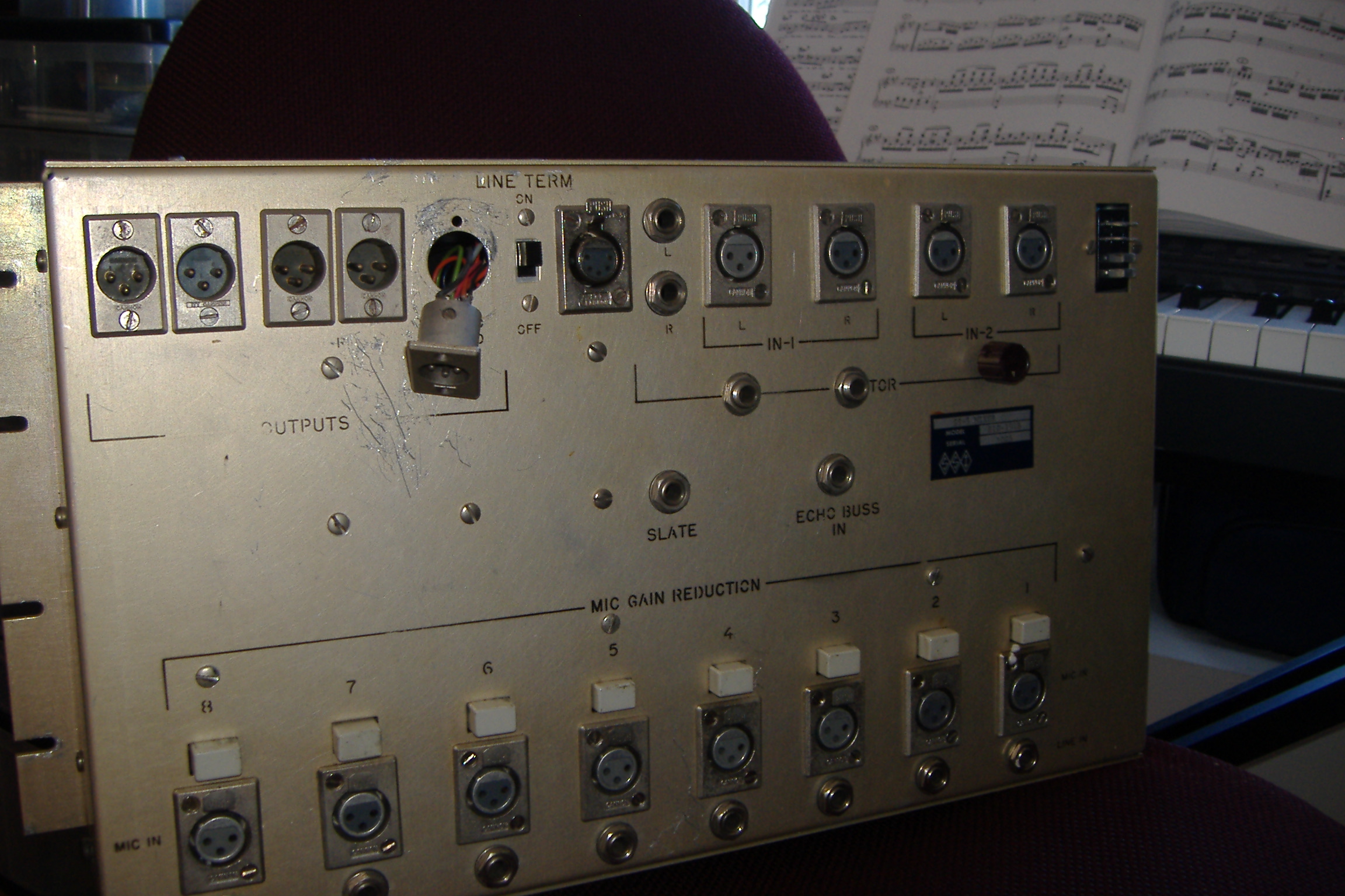

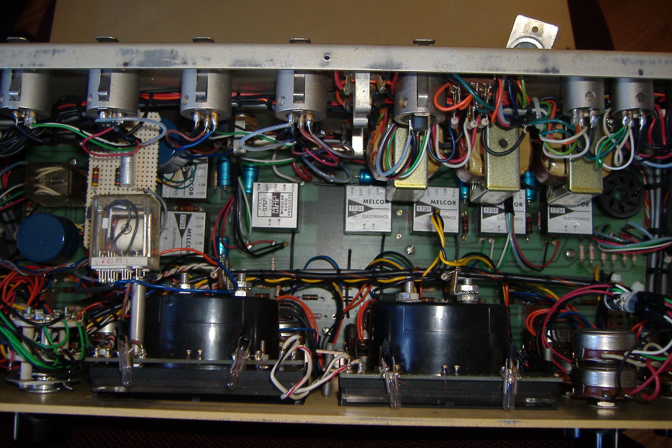

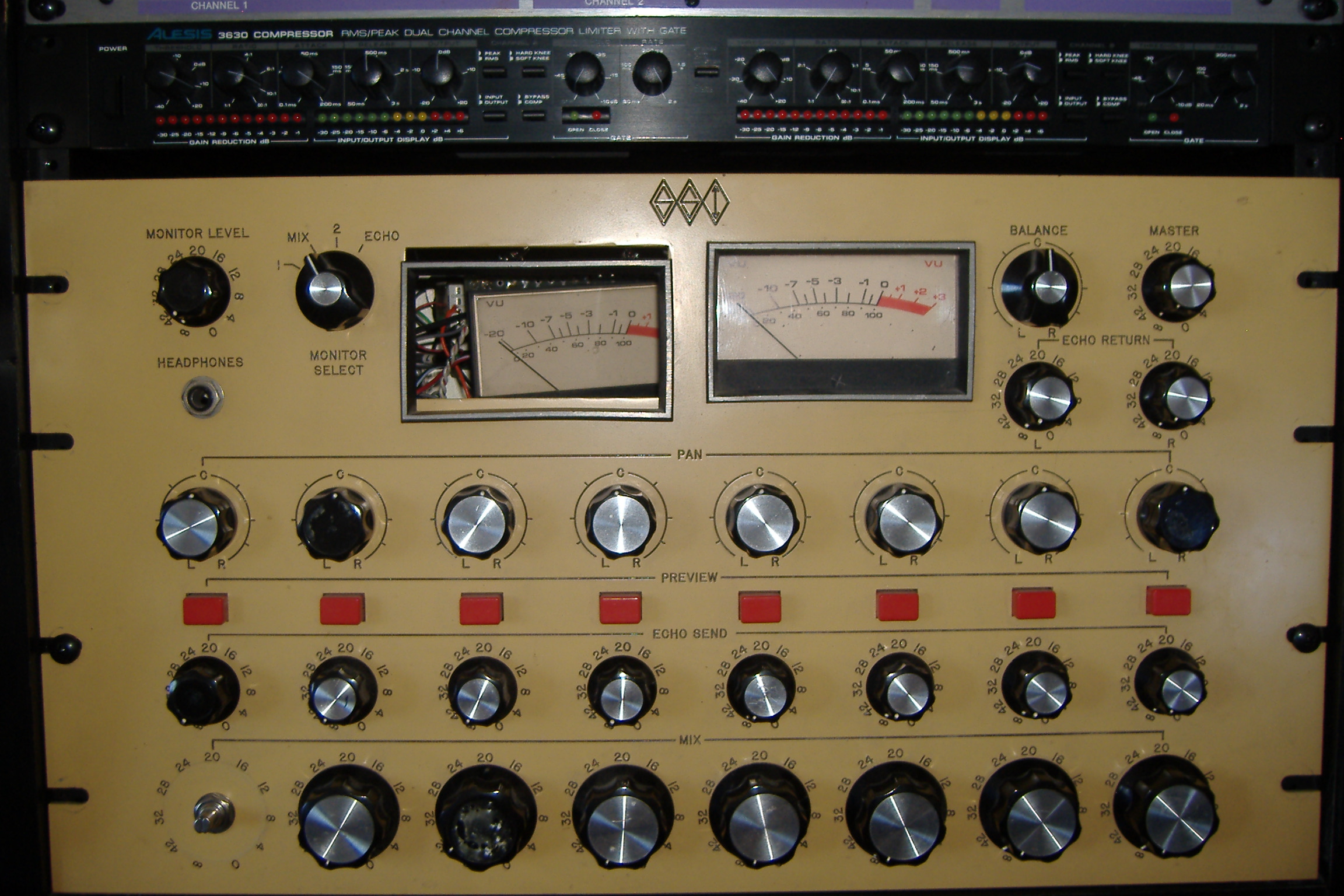

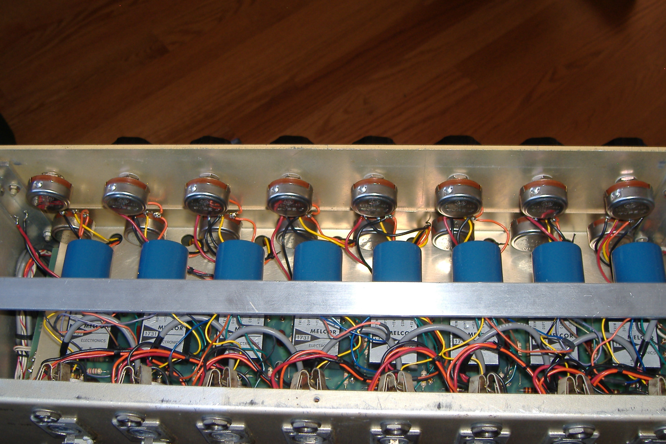

I am new to DIY electronics, so my knowledge is limited. I need to build a power supply that can do 48V phantom and +/- 15 volts for an 8-channel SSI mic/line mixer that I rescued from the trash heap of a local studio.
It has 8 Melcor 1731 opamps for the channel mic in's and 6 more driving the line outs (I think).
Would the schematic above provide enough juice for that purpose? It's been a long time since I have taken an electronics class, but I think it is OK to have more amperage available than the circuits will need. Is this the case or am I mis-remembering? Would a pre-built supply such as this be a better way to go?:
LNR SUP DBL OUT 12-15V CASE E - HDD15-5-AG
I will also need a 24 V supply for the meter lights, but that is not really critical to get this thing working.
I have attached some pictures, if that would be helpful. First is from the bottom looking at mic/line inputs, second is front, third is from the top looking in, last is the rear panel.
Thanks much in advance for any insights you may have.
