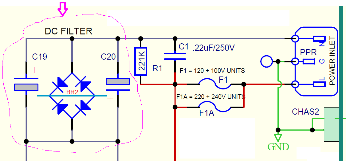

So from some research I think that there is likely DC on the mains, quite a bit, or that there is some signal at higher than 60hz. Or both. Unfortunately I only have a DMM, so i'm not sure how to test for either of these. However, I'm going to be moving a lot over the next few years, so it occurred to me that I might as well just build something that deals with both.
I've found plenty of circuits for DC blockers, seems like some diodes and large capacitors in parallel is the way to go for that.

If you read Rod Elliott's article on Mains DC Blockers, you'll see that the circuit Rod recommends has the exact same parts list: a high-current bridge rectifier, a few capacitors, and a chassis & mains connectors.
Thanks all, I've read that article a couple of times and it is very good. I've decided that I'll put DC blockers at each device, as following his formulas I can get bipolar capacitors in the appropriate size and ratings for each device cheaper than 2 polar capacitors of twice the capacitance in series for a global solution as I was originally thinking.
We are talking about DC blocking of the mains feed to the transformer Primary.
The capacitance there must be enormous so that the impedance presented to the 50Hz is kept very low at normal transformer currents and low enough such that the diodes don't turn on when maximum power is being delivered to the speaker.
The capacitance requirement is complicated even more by the short duty cycle of the primary current. It mirrors the charging current in the secondary to rectifier circuit.
Expect C of 5mF to 10mF. I don't think 5mF bipolar electrolytics exist.
Though I could just parallel the same caps as a global solution I guess, so never mind. The effective ripple current rating of n identical caps in parallel would be (ripple rating)*n right? As for any given load and frequency the current would be divided equally. For different values you would have to account for capacitive reactance and other differences between them.
High end amplifier manufacturer Bryston, includes a Mains DC Blocker as part of the internal circuitry inside their power amplifiers. They publish the schematics of many of their power amp products on their website.
I've snipped out the relevant part of the schematic of their 3B SST2 amplifier, and (crudely!) circled the Mains DC blocker. You can see the difference between what Rod Elliott's site suggests, and what Bryston ships in their commercial products.
