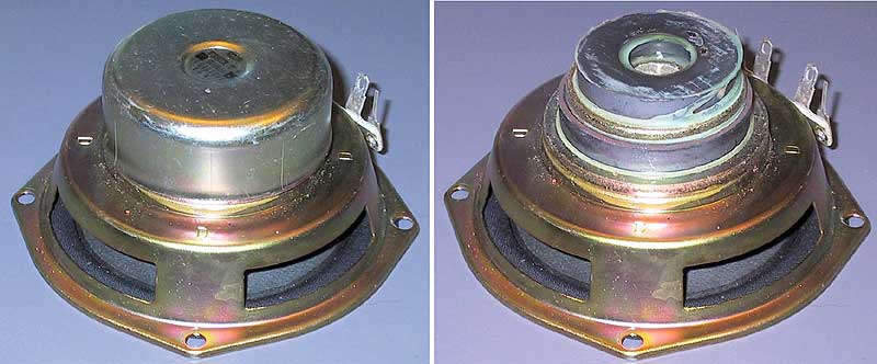

dhenryp said:
3. The shileding cups used by speaker manufacturers are almost certainly NOT made of mu-metal.
The cap on bucking magnets is just steel, and its purpose is to complete the magnetic circuit between the nagnet and the bucking magnet.
dave
