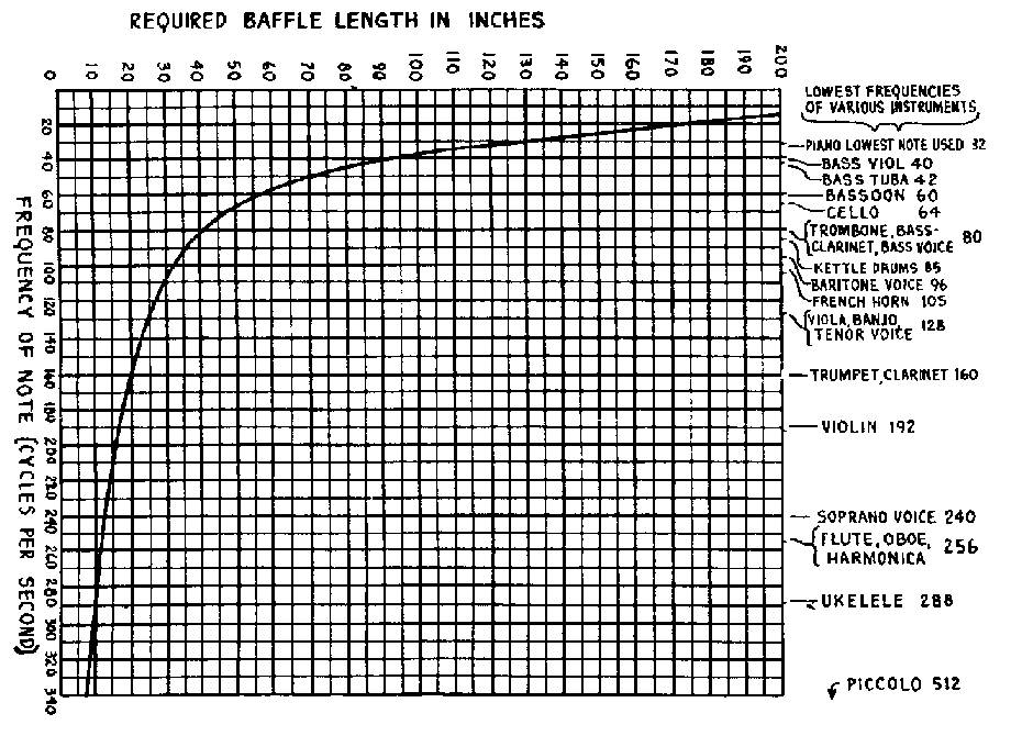

FWIW, I noticed much the same thing with an old pair of LESA speakers I owned which had open backs. Is there any possibility of doing even a "bad" bass reflex with this design? I assume you probably are not equipped to measure this driver's TS parameters, but perhaps you can find one of the old ubiquitous BR articles and see if you can come up with something approximately ok for this driver. You might really want to post this in the Loudspeaker forum.. Someone like GM or panomaniac over there should be able to help you.
Without knowing the TS parameters of the driver everything we do is a guessing game. Perhaps the Qts of the speaker is lower than we think it is, in which case, you can close the back to increase the Q (and the Fcb), or you can turn it into a reflex system. If you want a classic jukebox sound I would expect you would want a Q of about 1.5. But be aware that by whatever amount you raise the Q you also raise the resonant frequency. If Q = 0.7 and you raise it to 1.4 then the resonant frequency will go from 40 or 45 to 80 or 90.
If you have never experimented with WinISD I would recommend that completely. It is a good design tool and you can learn a lot by just playing with theoretical speakers to see what happens when you change cabinet volume or port size.

I had an astrosonic once, those 15" alnicos can do some serious wall shaking in the original cabinet. I believe it was about 6' - 7' long, about 1.5' deep, and about 2.5' tall. There was a piece of craptastic 'holey board' on the back, and if I remember correctly, there wasn't too much space behind the woofer, no more than 2'. It fired sideways out of the end of the console. There was an internal crossover to 2x Jensen RP103 knock-offs (i think motorola brand, dunno). Those cabinets were very thick solid wood though, not sure how that would affect the base extension. With bass turned up it shook the walls in not just my apartment but attached apartments as well (shoddy 1920s construction, though). Have you mucked around with polarity? If you're biamping and the signals are not in phase you will lose bass response, among other sonic qualities.
Have not tried reversing the polarity, but I don't think that has any affect on a mono system does it?? I'm only using one woofer.
No doubt that with both of the 15's that it shook the house, the poeple ( 16 year old kids..) at goodwill said that it "freakin rocked dude."
Anyways, thats interesting you say only 2' behind them. Maybe that affects the Q of the speaker? Maybe my chamber is actually too large :xeye:

I will try the pillow thing that you sugguested, may help damp the cabinet's resonations too. The woofer is powerful enough that my baffle is flexing with just the 4 screws in it, so I'm thinking I might have to upgrade to a 3/4" baffle with more screws holding the thing in place.
