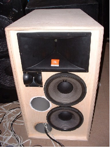

Just been testing enclosure for general sound quality.
It is made from 13 ply baltic birch and is tuned around 50 hz with 2 six inch diameter ports.
I have braced the cabinet walls extensively and used 2x2 braces front to back. I have tried to keep the braces fairly random as detailed in the 'loudspeaker Cookbook'.
The cabinet with drivers now weighs 80kg!
I have a fairly pleasing bass kick output at present but the mid bass is boomy and coloured. This enclosure doesn,t need to produce low bass as it is subwoofer supported. I do need a nice midrange sound.
Would anyone use stick on bitumen type pads on the enclosure walls?
I have fibre glass resin and matting to reinforce if necessary.
Have not yet used quantitys of fibreglass insulation, to damp standing waves.
Are there any other causes of this colouration of sound?
Thanks again.
Dave G.
Picture of box.
Just Bloody Loud
Hello Dave Goodhew,
Congratulations on your new cabs.
In answer to your mid bass boominess and colouration questions -
Fitting RC networks will go a long way towards curing this.
The drivers you are using have always been a bit mid bass barky, so good damping is required.
Also damping wool inside the cabinet, but DO NOT EVER use fibre glass wool in a vented cabinet.
If you are to run such a cabinet in good lighting/sunlight you will see puffs of glass fibre shooting out the ports on bass, and this is a very hazardous material - Polyester pillow stuffing or sheeps wool is a much better soloution, and economical.
Also large diameter echoey port tubes will allow mid bass colour - these can be lined with a strip of thin carpet to reduce this.
Are you sure the 6 inch ports are not too big, or too short ?.
Also the class of LP filter controlling bass roll out will effect the mid bass character.
Also use the star-quad extension cable I mentioned above.
Also is the mid horn flare 'quiet/dead' ?.
If these are rattly/excitable much colouration is caused.
Glueing deadening material to the outside of the horn will help.
Regards, Eric.
Hello Eric
Since that photo I have added bracing to cabinets, have also reinforced insides with a bit of glassfibre resin and matting to make extra sure.
Have large amounts of self adivesive anti drumming sheets of the type used to prevent sheet metal ringing. Does anyone use these?
Appologes for speaker cable exit through port, a supreme bodge!
I have ordered neutrik eight way sockets and plugs to keep it tidy.
Have you seen Drew Daniels comments on fibreglass he thinks it is the best medium to use! I wouldn,t like it all over the place though. I think there are a few myths flying around with damping material.
He states that fibreglass increases virtual box volume?
It is quite annoying as I have a bail of synthetic wadding material as big as me. This is called 'luxbond' and is a fire retardant furniture stuffing I would think. I am sure some manufactures still use fibreglass but you would know more than me on such a matter.
I would think these matarials would have a similar effect I might do a A/B comparason.
The crossover slopes are 24 db per octave linkwitz reilly, according to behringer!
The ports are seven and half inches long, they are six inches in diameter.
The box air volume is approx 4.2 cu ft.
