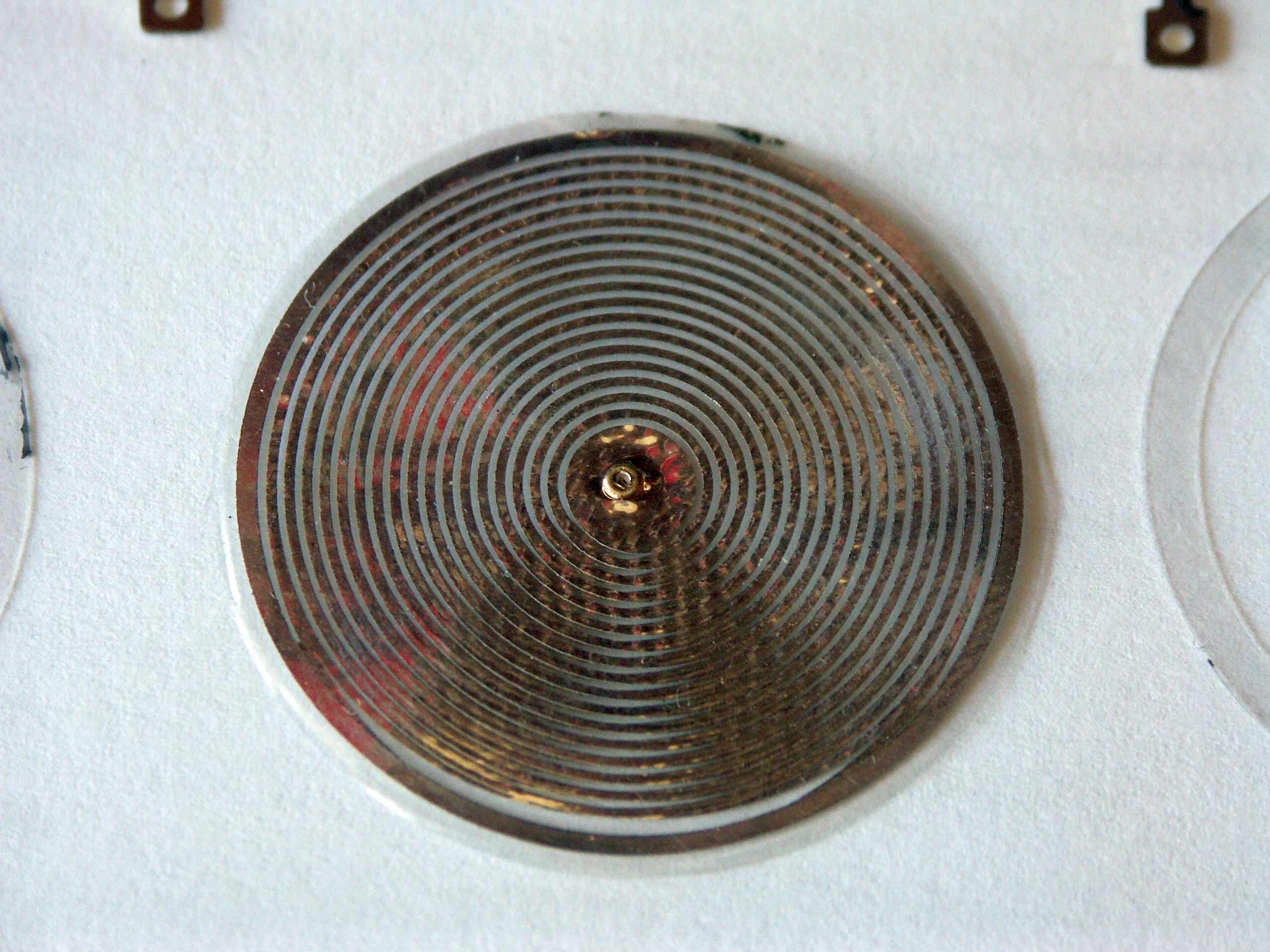

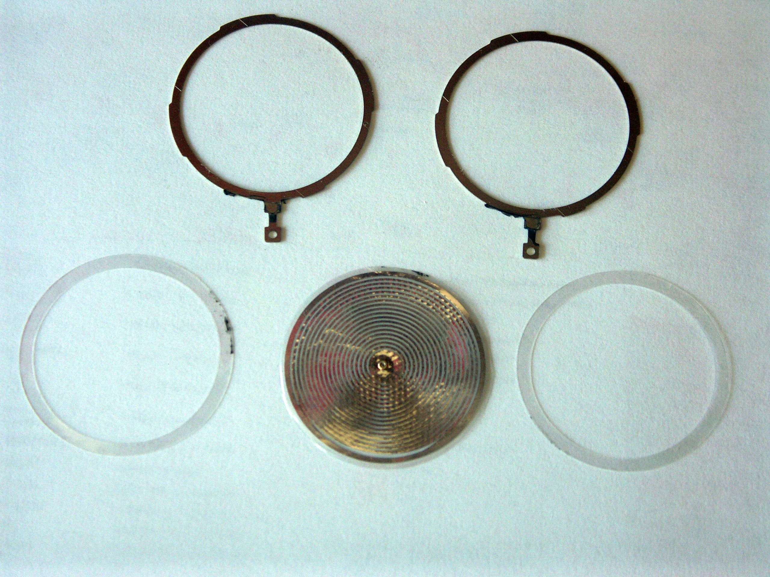

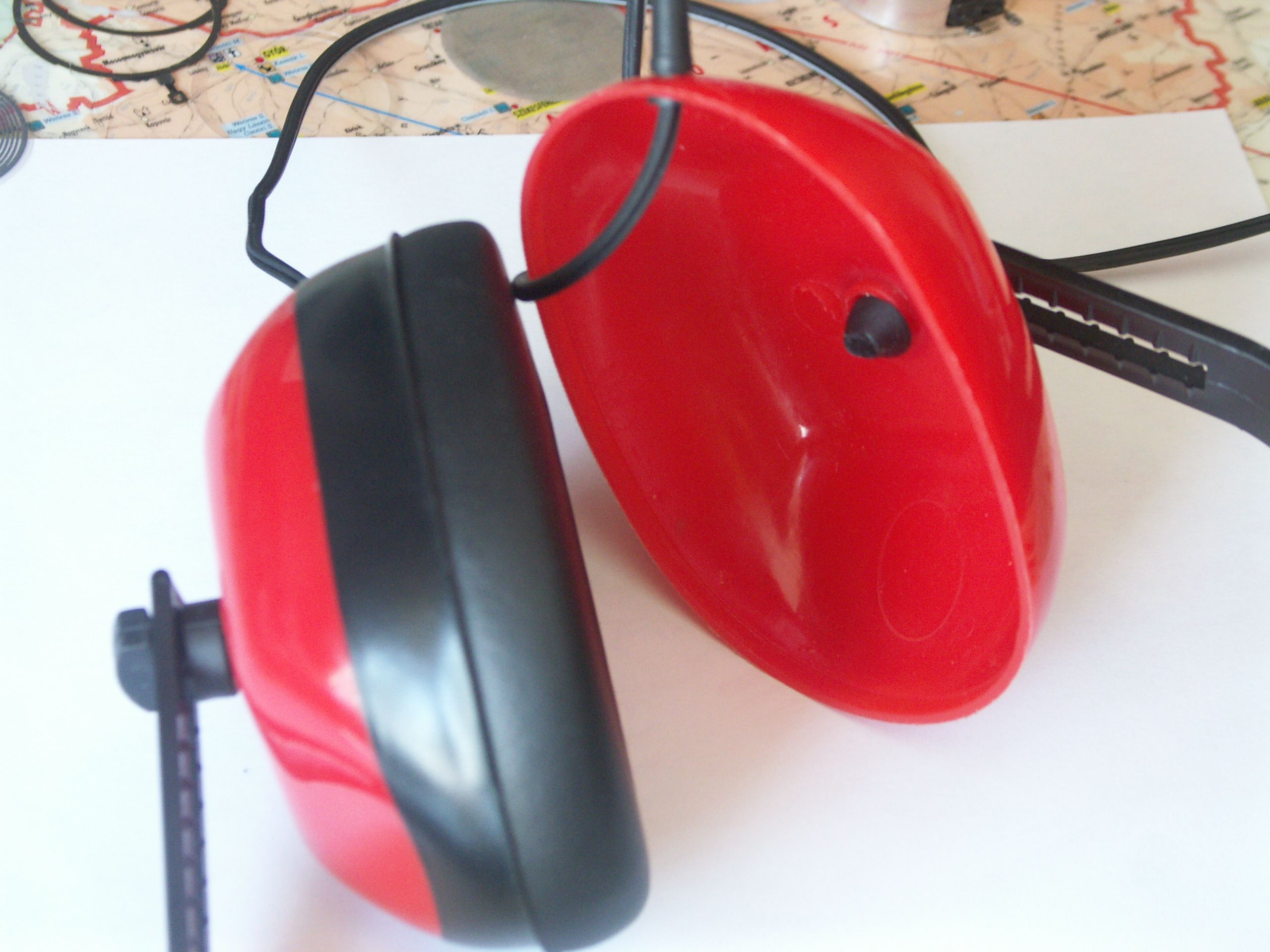

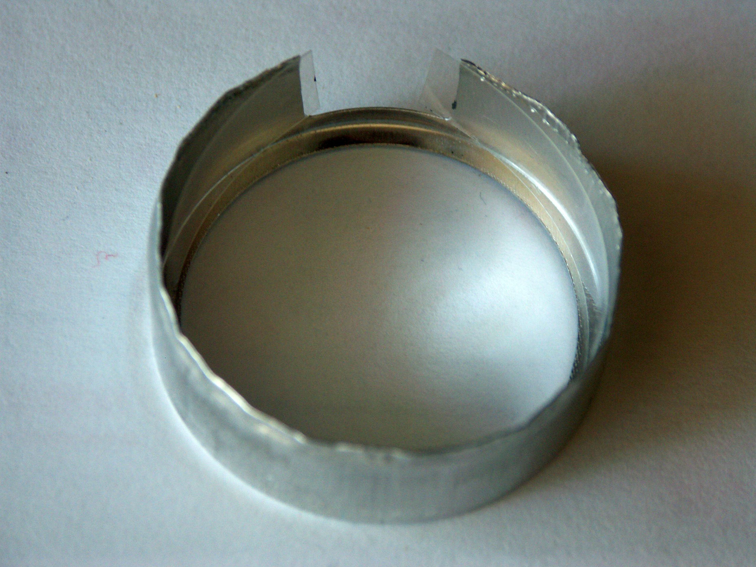

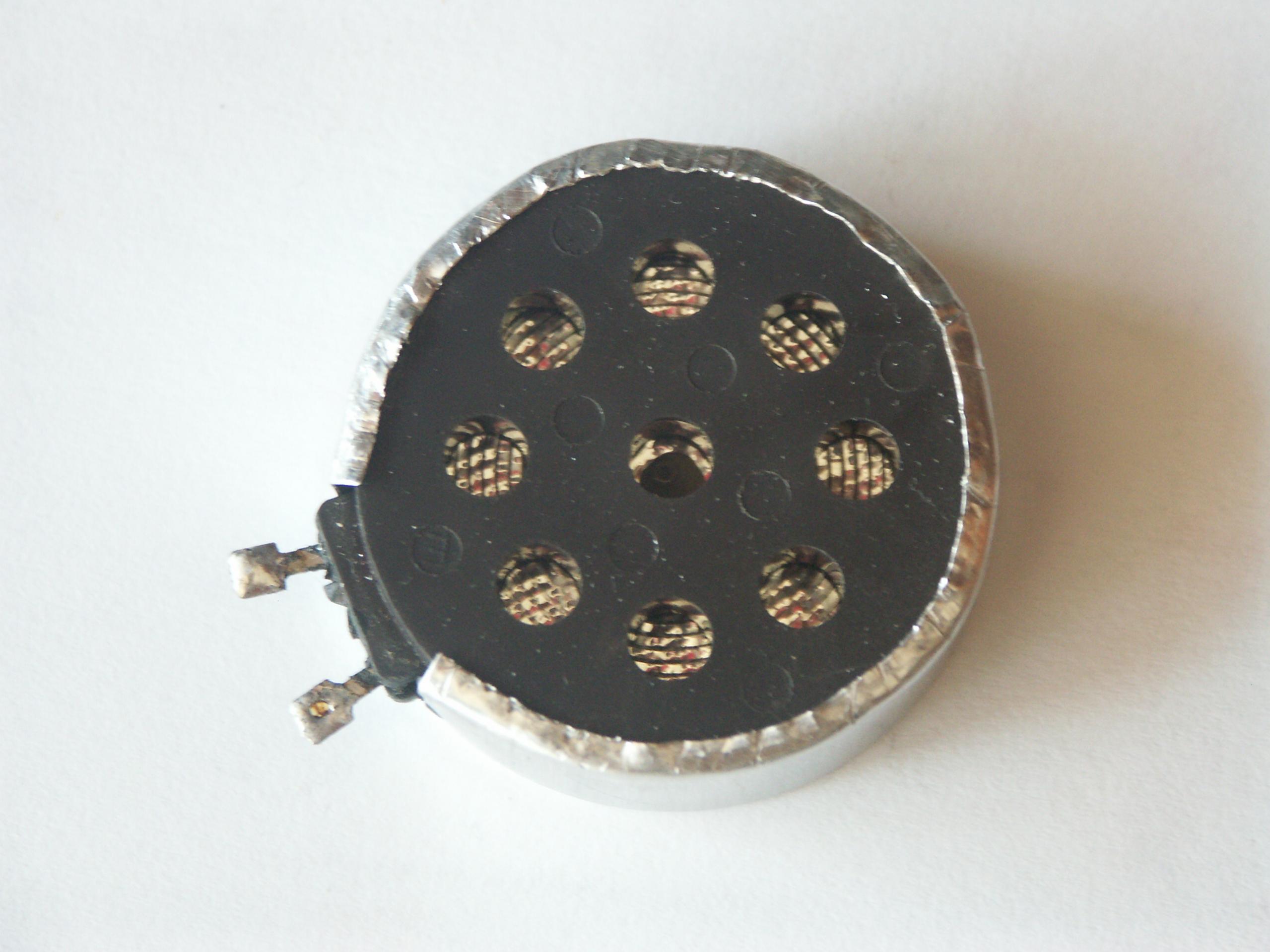

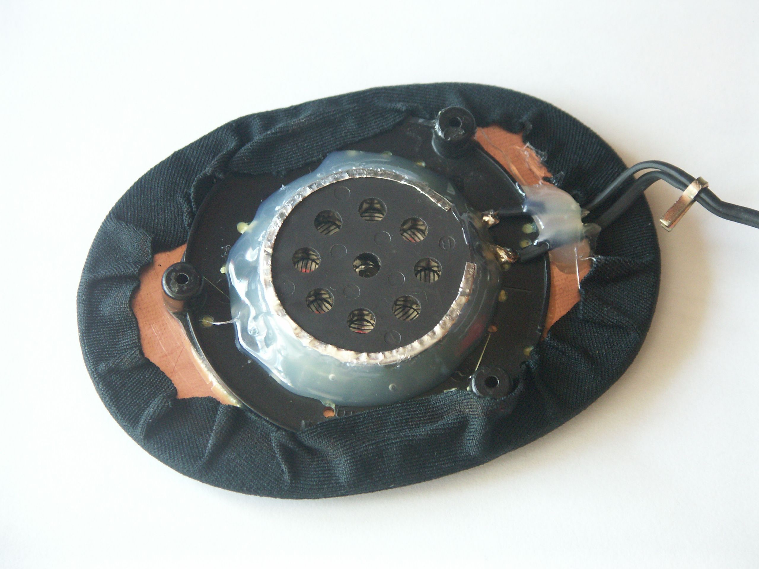

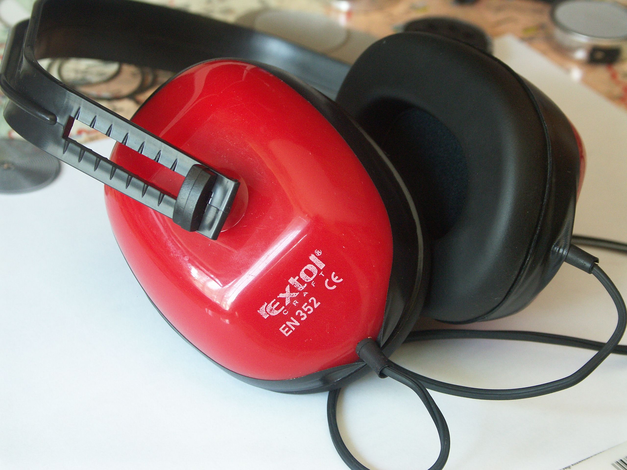

I am just building a pair of isodynamic headphones using these. My drivers are AKAI 4IT-SM3G, but they are identical to Sawafuji SZ-2T. They are 8 ohms and have closed back magnet. I bought four of them, disassembled, and used the perforated magnets at both sides, so I made two from four. The shell is a hearing protector. They sound great. I will publish pictures.

Hi Odd,
I assembled and listened to the headphones. The trebles are a bit accented, I would say it is best for rock music
. This is just an experiment how they sound in a closed shell. The driver is widely available in my country for about 1 EUR. Here are some links that might be interesting:

Pictures will come, just need some time.

Pictures
As promised...
As promised...
