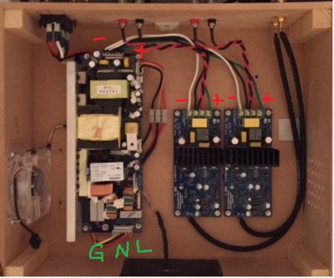

I have bought 4 of these IRS2092 boards off this seller on eBay and had no issue. Actually bought things from them 6 times, without an issue.
Assembled LJM L20D IRS2092 Top Class D Amplifier Board 200 250W 2 CL 183 HL | eBay
He has L15D, L20D and I actually bought L25D boards and been using them for over a year and they work great and I have used with 8 different pairs of speakers and will power them all without issue.
I currently use the Abletec SMPS, which outputs +/-53V, which gives me about 120 watts at 8-ohms, so plenty. Link to a seller on eBay.
http://www.ebay.com/itm/Abletec-900-Watt-peak-class-D-audio-amplifier-power-supply-53V-DC-UL-cUL-/251804683031?hash=item3aa0ba8b17:g:7pYAAOxySfBR7ZTP
Just remember it has a 5.3V and 7.5V secondary supplies, which have to have a load on them, or you will get some noise. Easy as putting a 1-watt 150-ohm resistor on those pins. $50 for amp + $30 for PSU +$50 misc and you have a nice amp for $130 IMHO. YMMV.

This board looks really good! I hope it will be comparable to the CDA at 1/3rd the price though. I'm happy to give these a shot.
Does this power supply do better than or as well as the Connex one(65$)? Also, can I power both the mono amps with just one of these boards? How would that work?

It actually works quite well, I can't speak to it being "better", but it drives any of my speakers 4/8 ohm without a problem very cleanly with no hiss/noise. I attached a pic of my setup. Basically you run +53, -53 and Grd to each board and then +/- to your speaker posts.
This was my 2nd try at DIY amp building, so it was pretty easy to figure out. Main thing is triple check all wiring, post a pic on the forum for verification if you are unsure about anything BEFORE plugging it in and flipping the switch.
