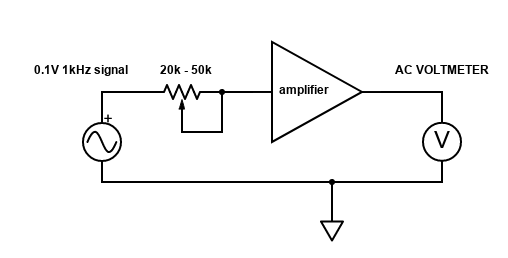

rayma Moderator Joined 2011 2022-06-10 11:24 pm #22 2022-06-10 11:24 pm #22 Something like this. You may want to use a dummy 10 ohm amplifier load as well. Attachments test2.png 4.8 KB · Views: 67
