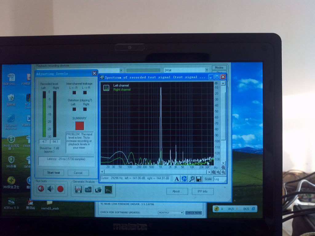

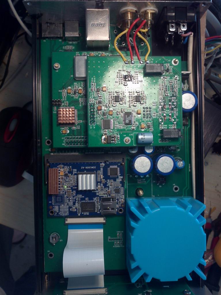

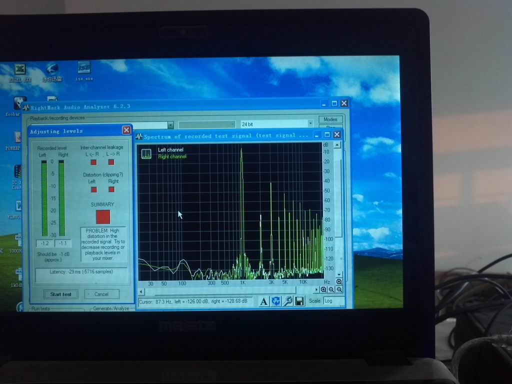

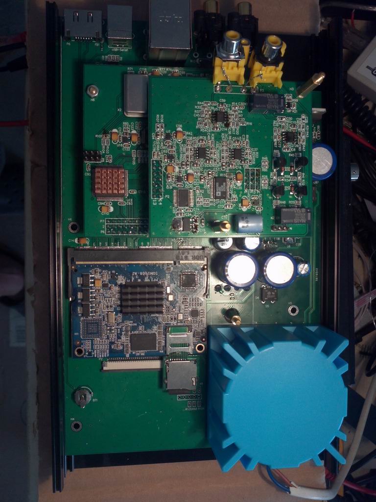

Hi, all
I'm back after months' work.
some pictures for you guys to see the working result.
one is final who PCB fit in case pic
one is initial DAC 1K fft (so you know why I could not deliver the machine)
one is the final result DAC 1K fft
