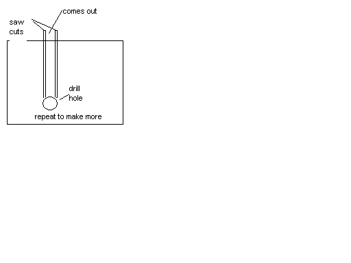

Why not try just using a large block of aluminum and cutting grooves in it using a table saw and a carbide tipped blade? I've done that with great results. Just make several passes to get it as deep as you want it. You can also make two deep cuts about 1/4" apart and use a drill bit to cut the bottom end out making a deep 'U' shape.

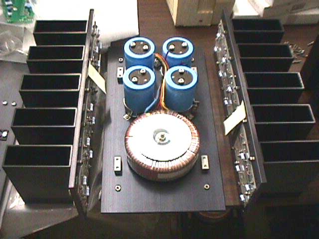

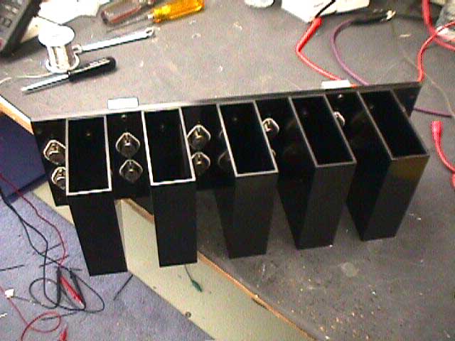

I bought a pile of square aluminum tubing once upon a time
Great idea Nelson!! That stuff is very readily available too. BTW: is that the famous Pass family kitchen table under that amp?

Nelson's idea looks much cleaner and if one needs more efficiency one can place a smaller size tubing inside the larger for higher dissipation. Its also very inexpensive and quick to build it up.
